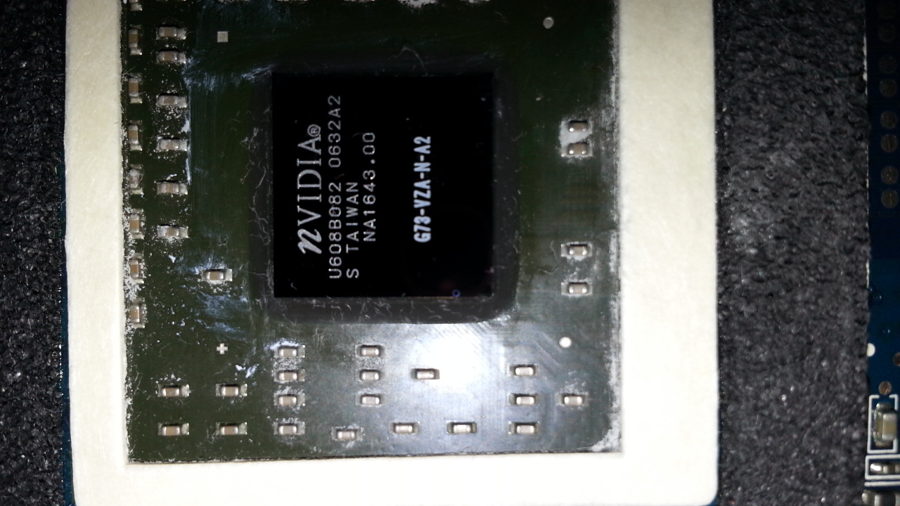

                                  Got it. Tore it down again and you were right. And on top of it the date code is 0632 not 0832 so this is probably original.
                                  I hit it with some heat but either this is too far gone or it wasn't enough heat (my wand can't effectively wet large ics). Reassembled and the symptoms had changed just not cured.
                                  Question on these bumps.. are they in the die or throughout the substrate as well ? Just for fun I'm going to try and hit it again and would like to know where to concentrate my efforts.

                                      Okay, that is a desktop chip. It happens to be exactly the one i had linked in the ebay auction above. So if you break it, you know what you need.
                                      The bumps are in the die, the black square. Concentrate all your efforts on there. Heat it for a good 3-4 minutes with the air set to around 10 o'clock and temperature to what you would normally set it to for, say, soldering a QFN chip with lead-free solder. In my case this is around 450C on the dial.
                                      Have a heatsink on hand or something else that you can apply some pressure with without burning yourself. When you lift the wand away from the die, apply slight pressure to the die and hold it there for a minute or so. Then re-install the card and test it. Should work, but remember it is a temporary fix, and how long it lasts depends mostly on luck.
                                      Avoid heating the substrate too much or it will bloat and short out the chip. Also known as "popcorning".

                                          Reflow did not help - symptoms remain unchanged. Though I'm not averse to doing this several times for the learning aspect (computer doesn't work anyway!) I'm loathe to keep disassembling this thing for a temporary fix. I'm still trying to find the type of ram used on the listing I posted above before I make my next move.
