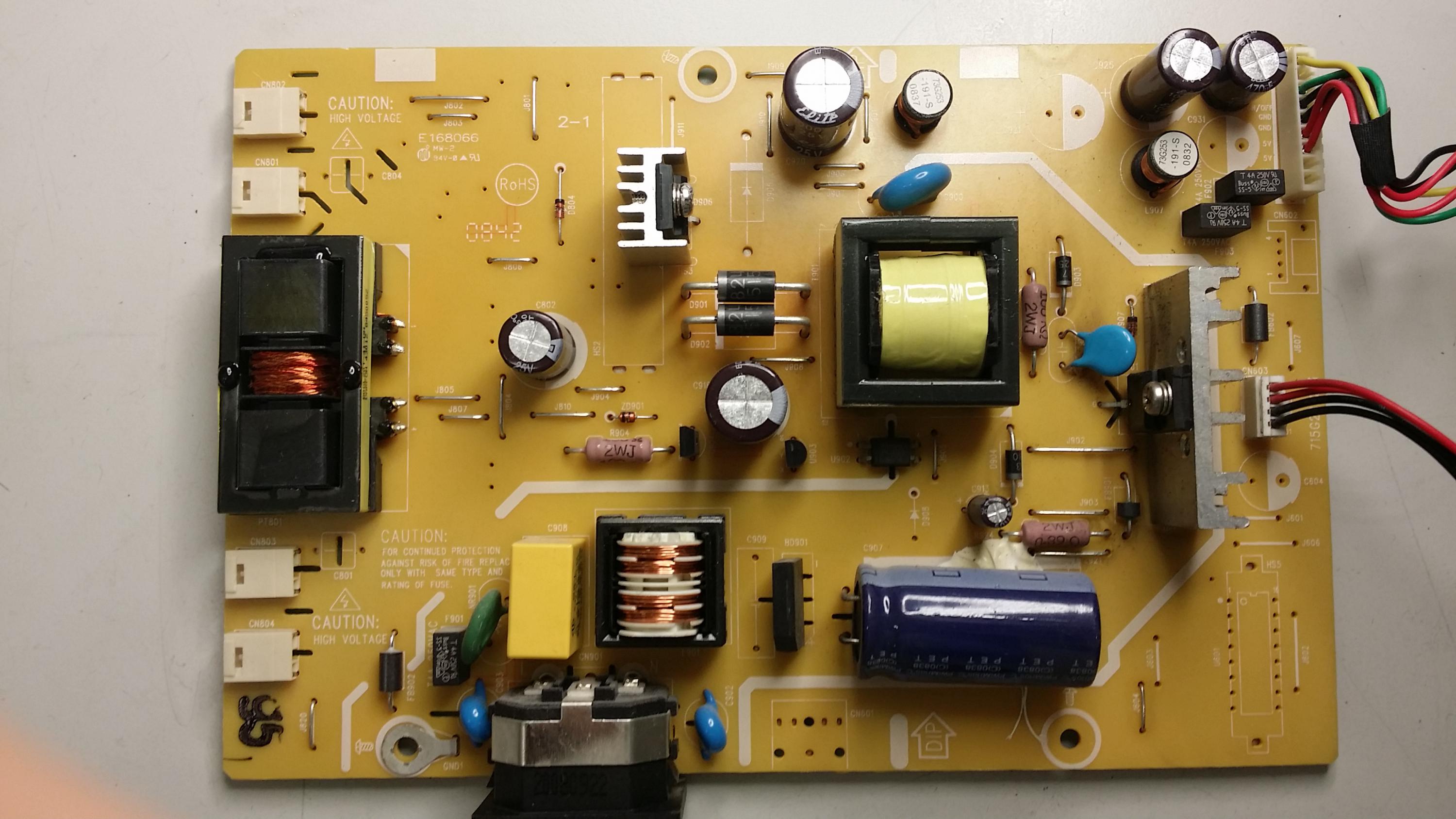

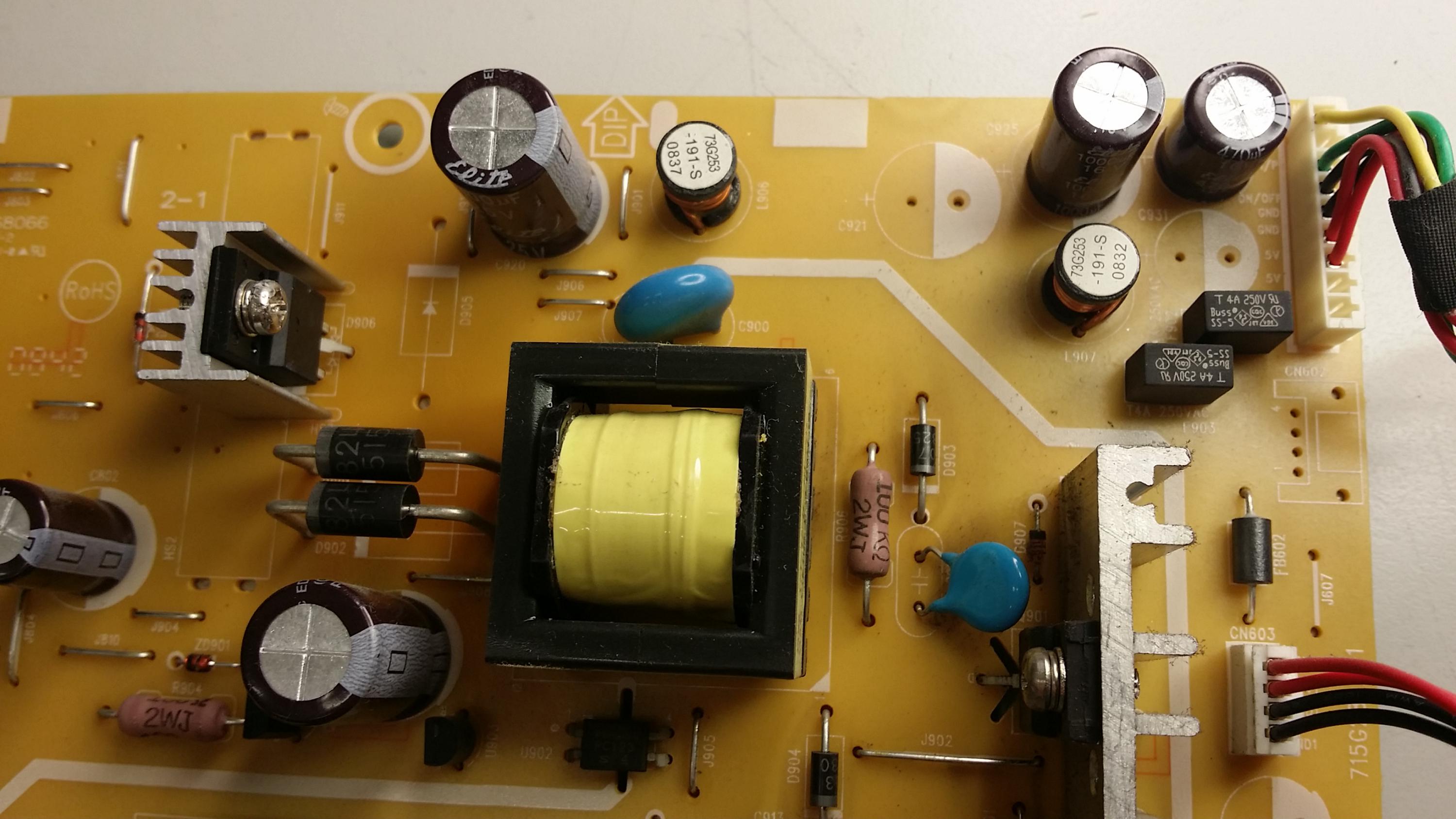

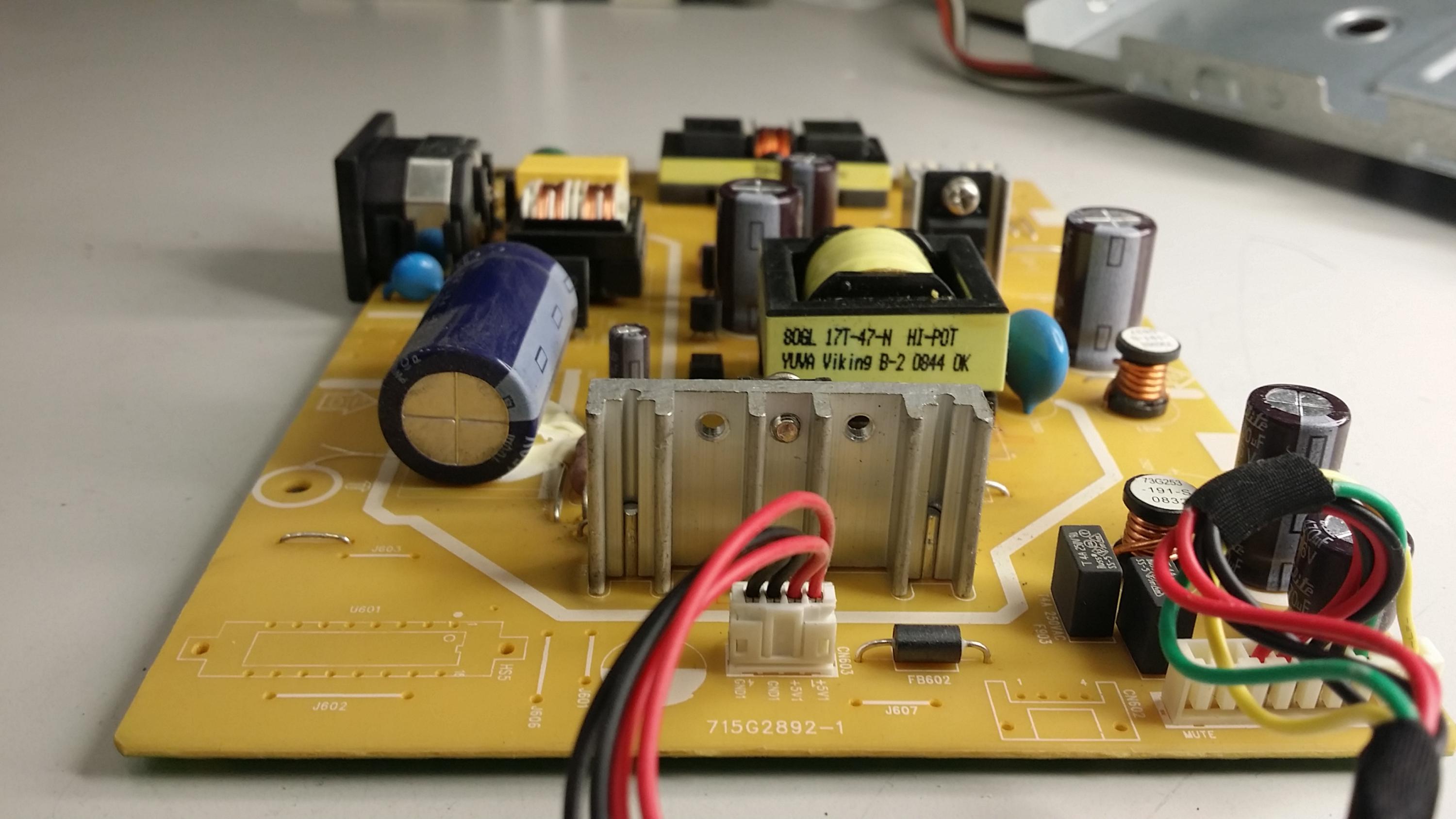

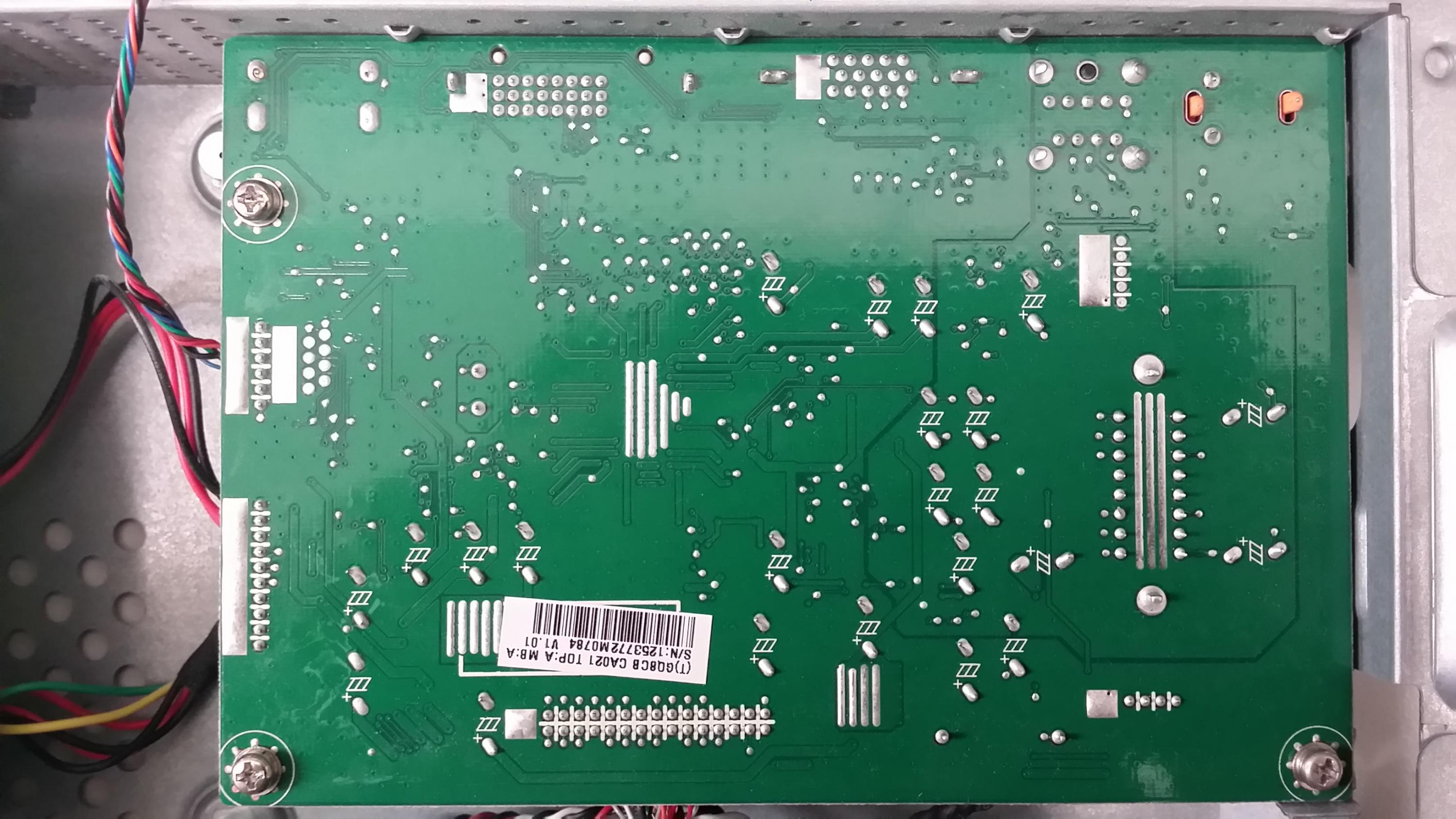

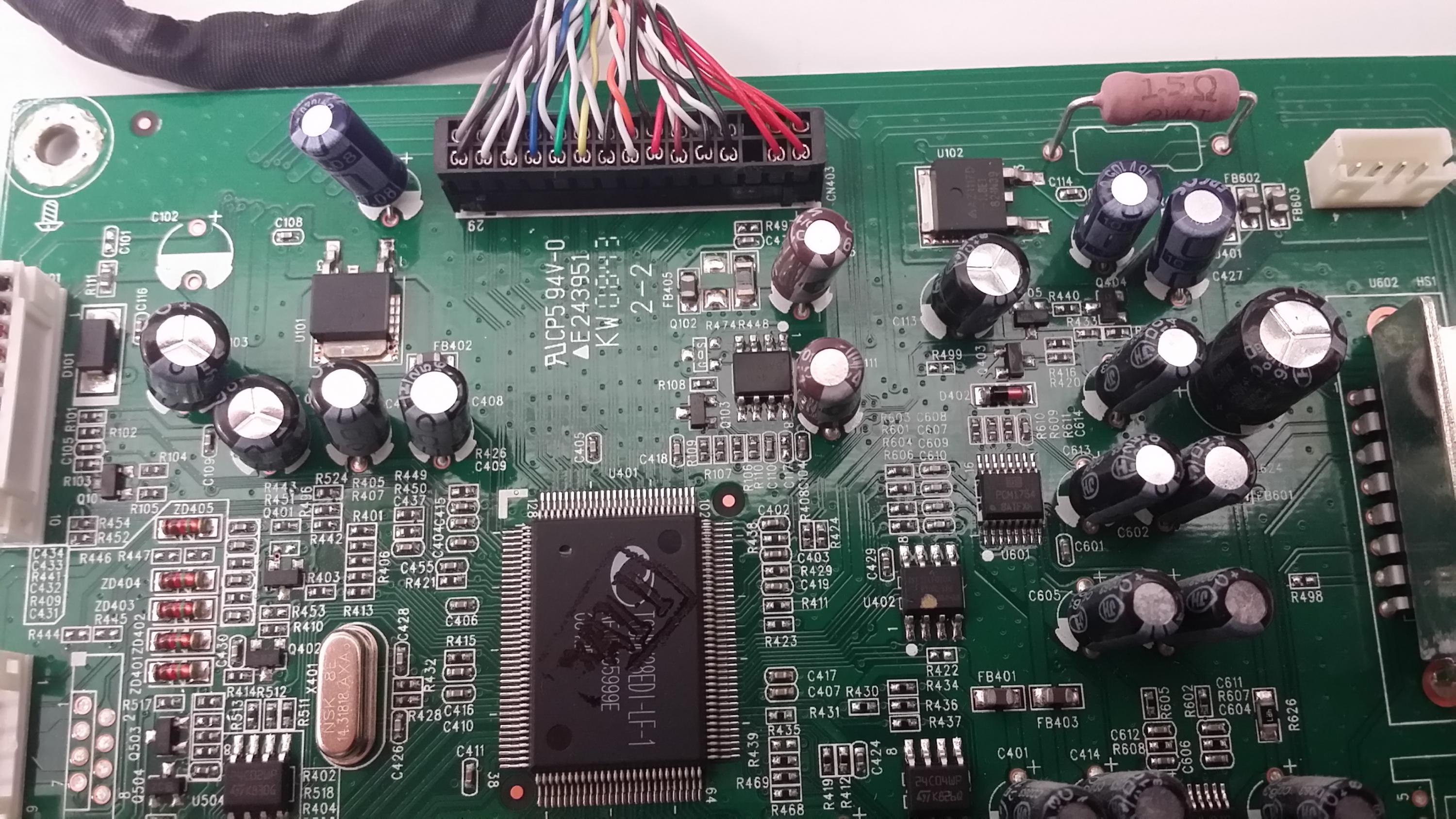

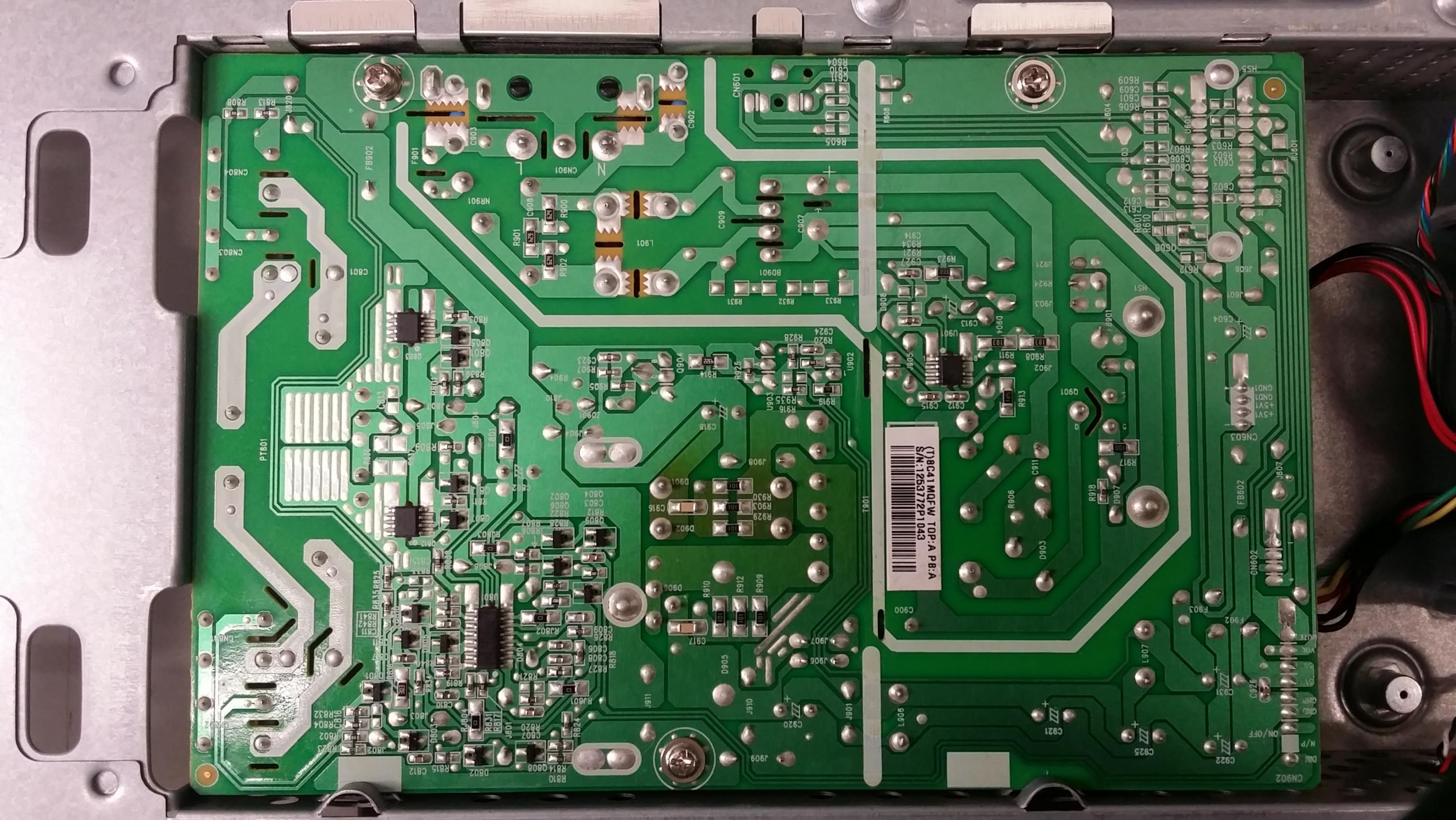

          Re: ASUS VH222H 21" : no power when LCD plugged

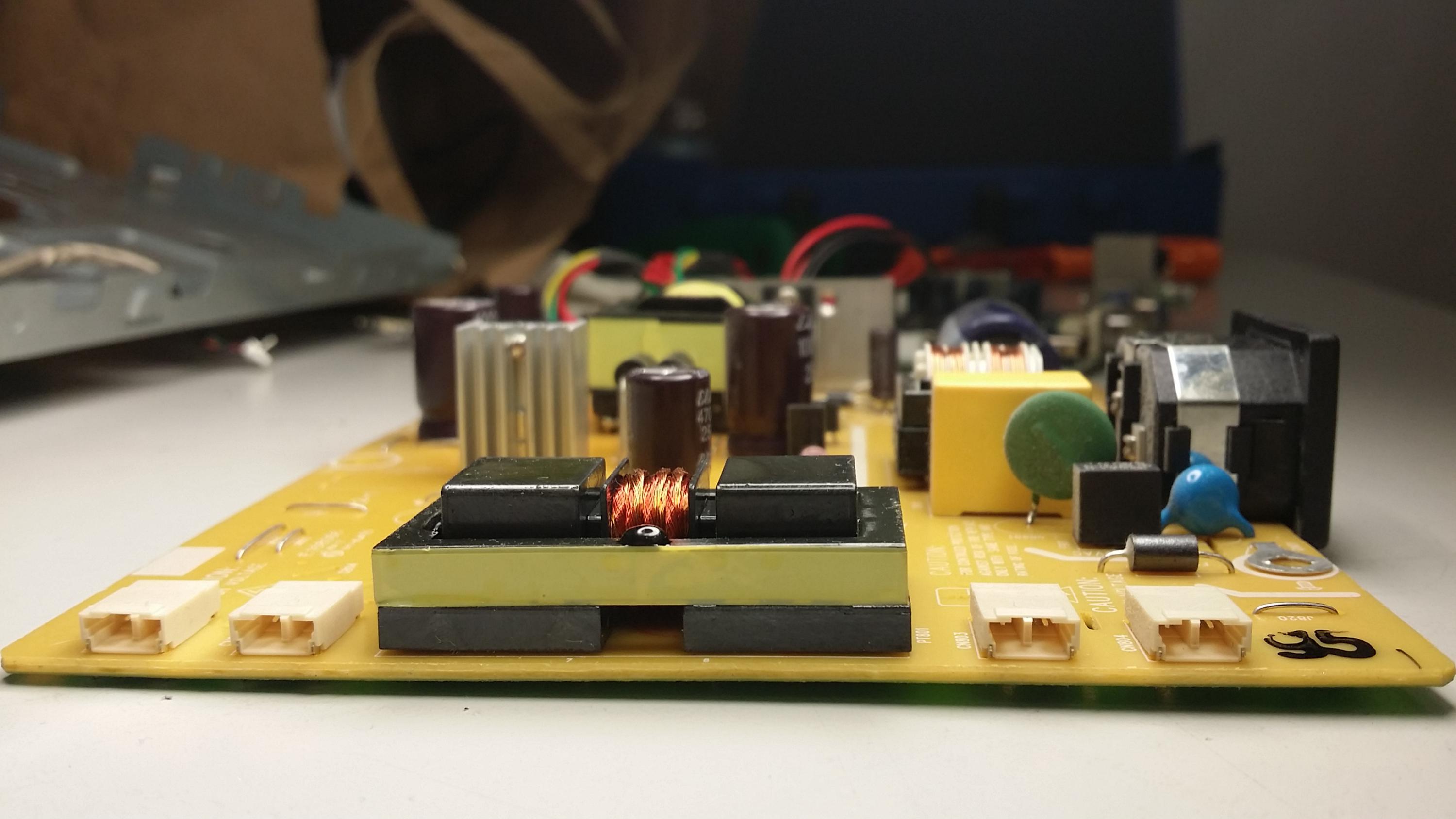

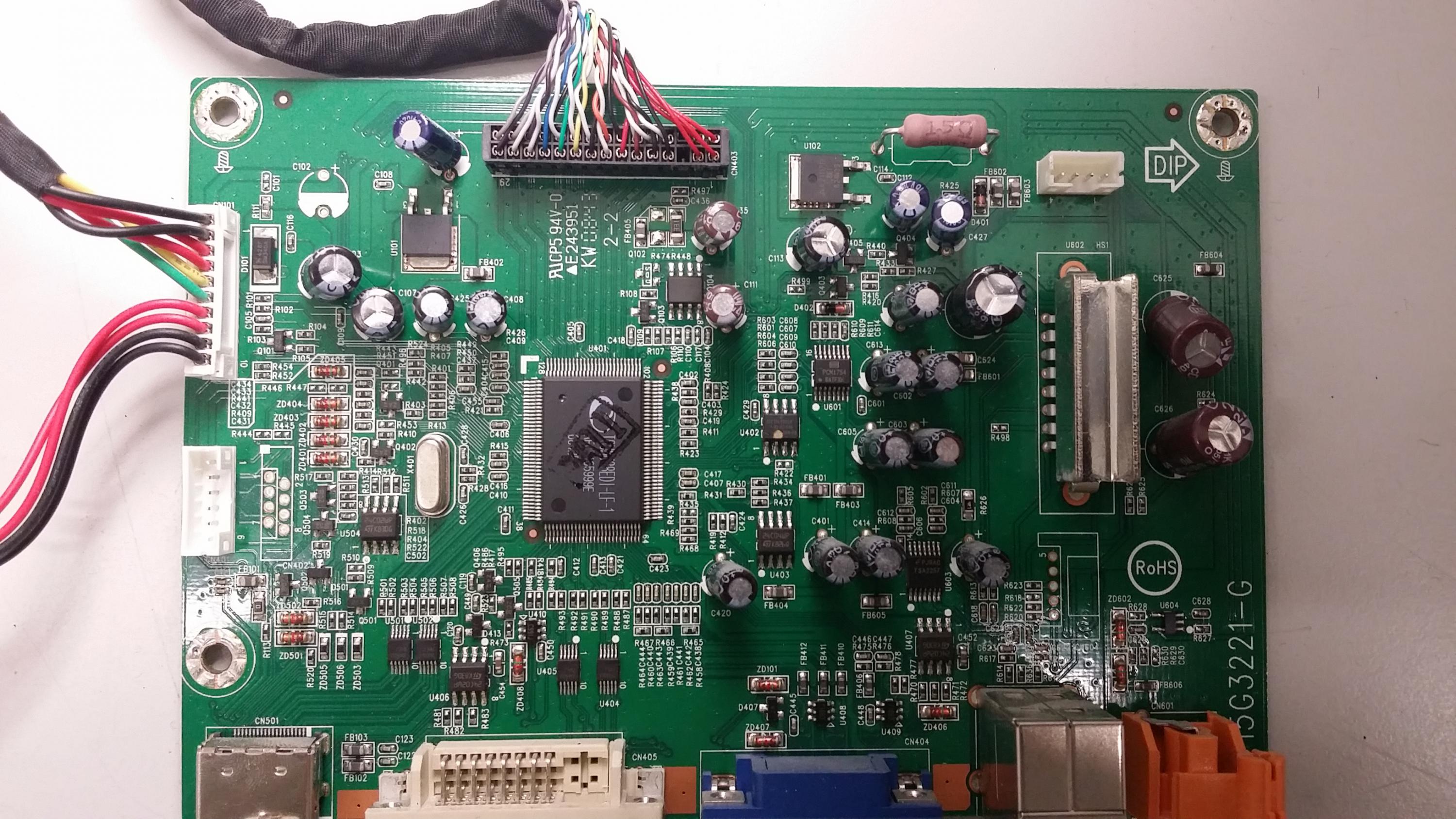

          Here there are my last pictures of the boards: Main Board and Power Board.
          It looks like there are no bad caps or other broken components.
          What is strange is that only when the LVDS cable is plugged, the monitor does not switch on.

            Here are a few pages with schematic diagrams of a similar power board
            @selldoor
            I really do not see how I can lead to short circuit in the LVDS cable or bent pins ... it is really crowded... How may have been broken by itself?
            It presented this defect suddenly and had never been opened before.
