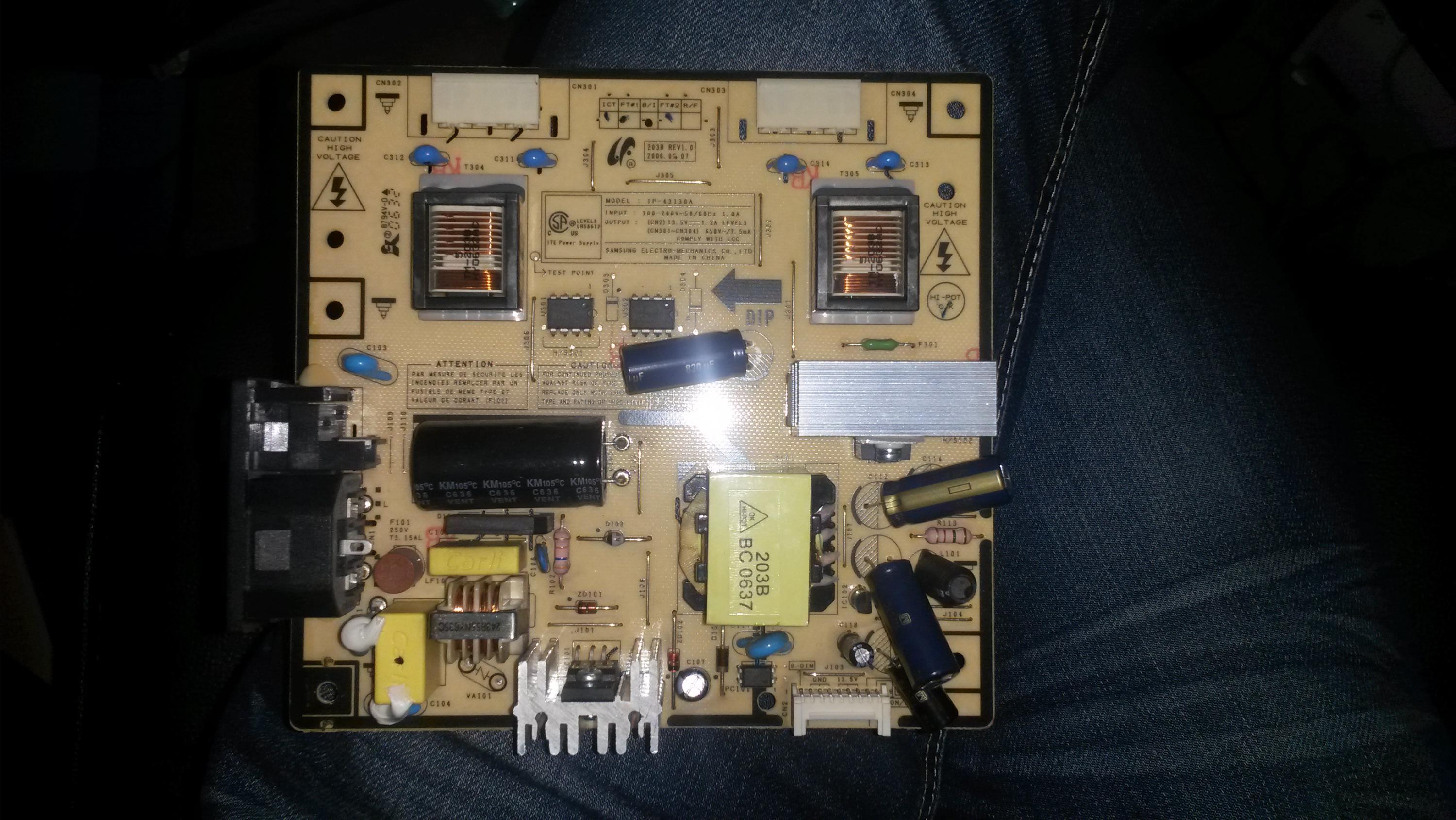

    Hi !
    I have a little problem with my lcd display since couple of weeks, my screen has become black suddenly, we can see anyway with a flashlight some icons when i push the button menu for example.
    I think the problem is the power supply board (i've attached the service manual), i have already change the bad caps but the screen is still black. May be it's the inverter or somehting else, i'm not so good in electronics, i just read a lot of thread like this and watch video, so i will try to be clear with my answers, i'm sorry for my english but i'm a french guy...
    so please help me

    Re: Black screen Samsung syncmaster 203B
    Check fuse F301,and F101 cap job doesn't look that great caps are too tall looks sloppy

      yes, i've bought caps in a electronic store who have only this type of caps and no shorter. So i have to twist them...
      If the soldering is good, it's ok no ? it looks like crap i know but i doesn't have a choice
        It's acceptable, but not optimal. Ideally you should get capacitors the right size. As long as nothing is shorting out or liable to short out, it's OK.
        The bigger potential issue is that the lack of choice in capacitors means you may have a series which is not suitable for the circuit. This is unlikely to cause complete operation failure, though.
        Likely the old, failed capacitors helped kill something else, you've solved the capacitor problem, now you have to find out what else went wrong because of them.
        We need more info. You say you get a black screen, but do you get anything else? Does the power LED come on etc?

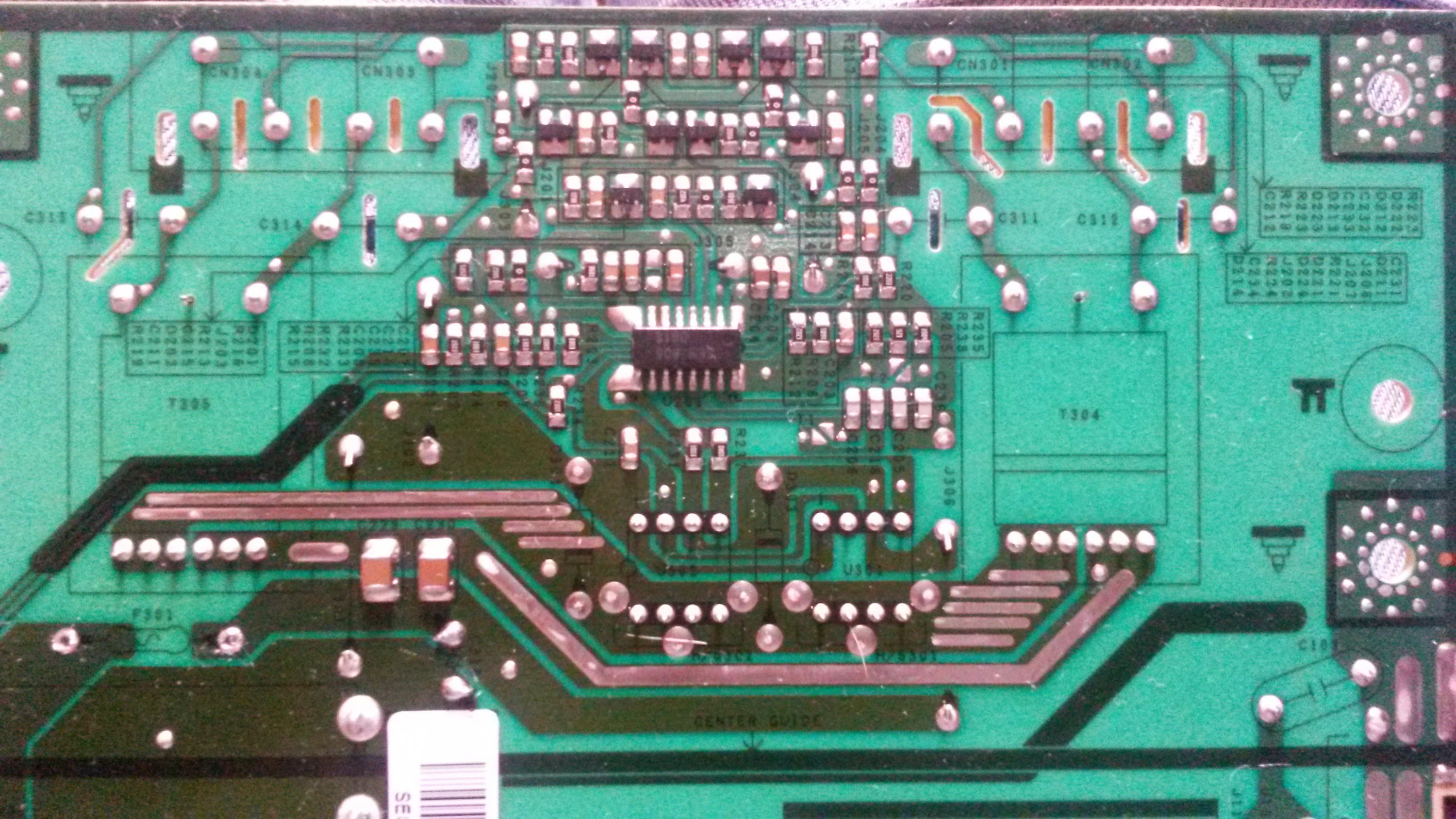

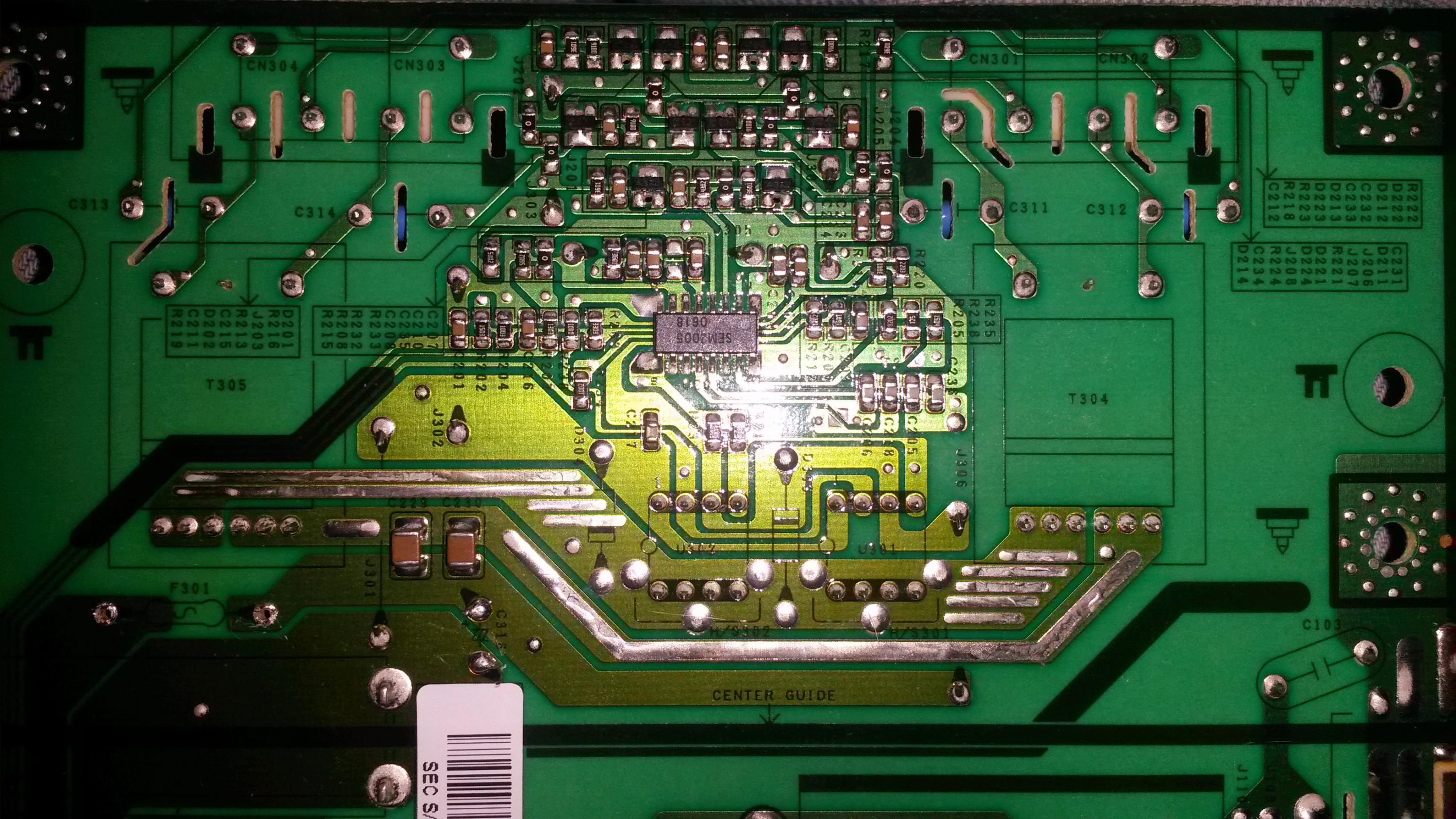

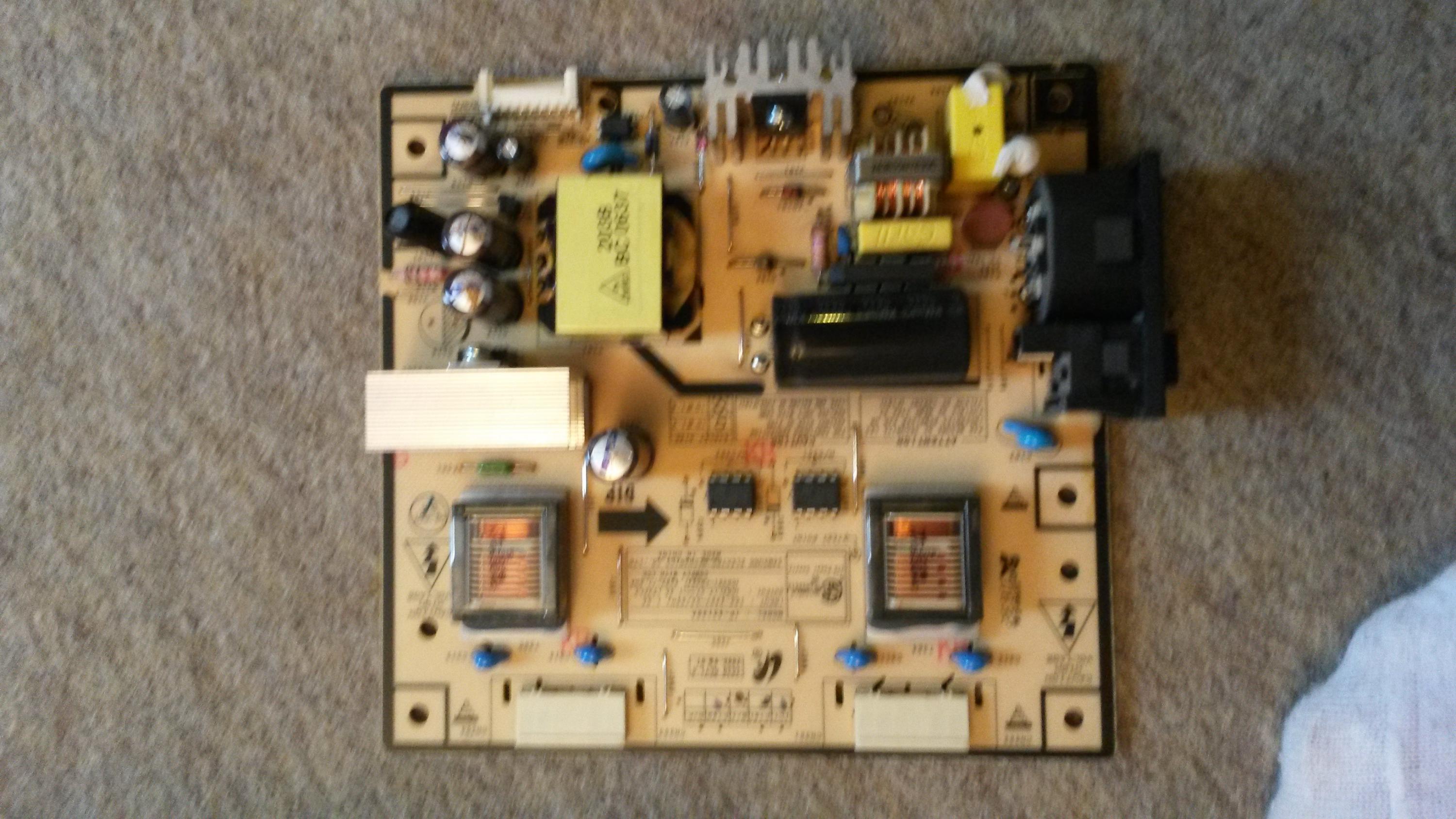

                  I found this http://archive.espec.ws/files/sem2005.pdf and this for the mosfet http://www.aosmd.com/res/data_sheets/AOP610.pdf
                  if it can help, and 2 pictures of the inverter part.

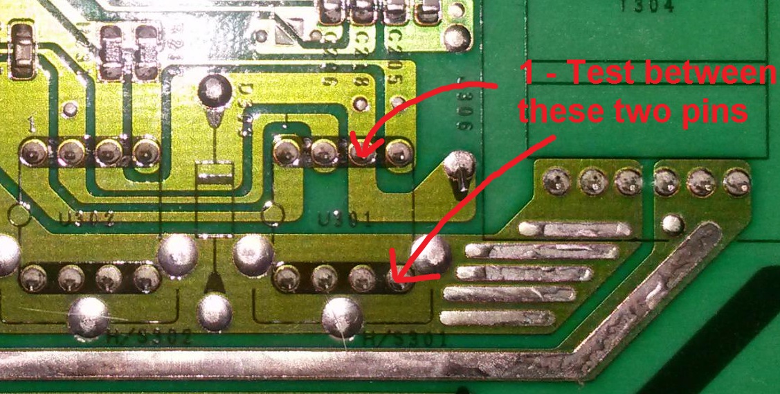

                    I would start with checking with diode test or resistance test across the power rails of the inverter (that is, across C316 - just after the fuse) If you get a low ohms reading, something is shorted and should be further investigated.
                    Of course you don't have to do this, but you will waste fuses if there is something wrong and you don't check.
                    I would check across those two MLCC ceramic SMD capacitors next to C316, the MOSFETs (check between the D1\S1 pins and D2\S2 pins, you should get only the body diode voltage drop when forward biased) You could also check between the Gate pins and other pins, there should be no connection at all.
                    -David VanHorn

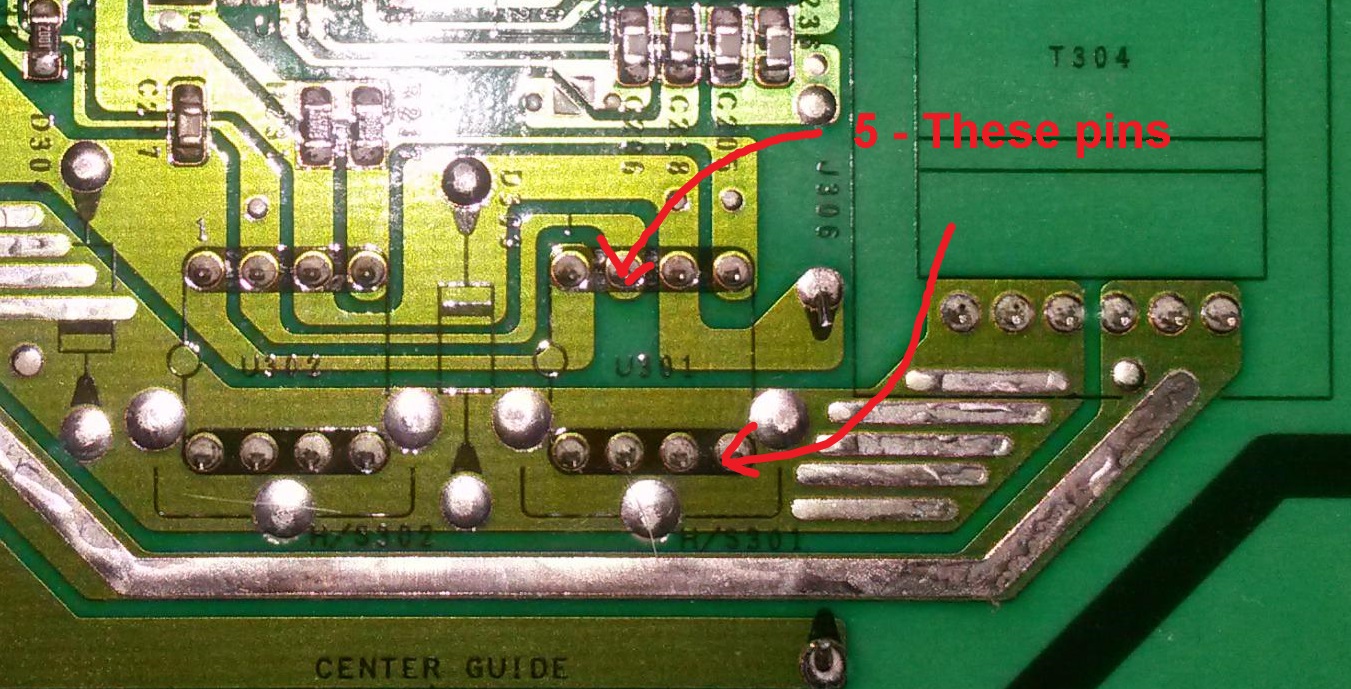

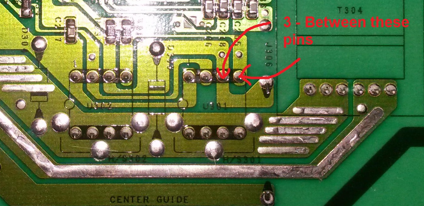

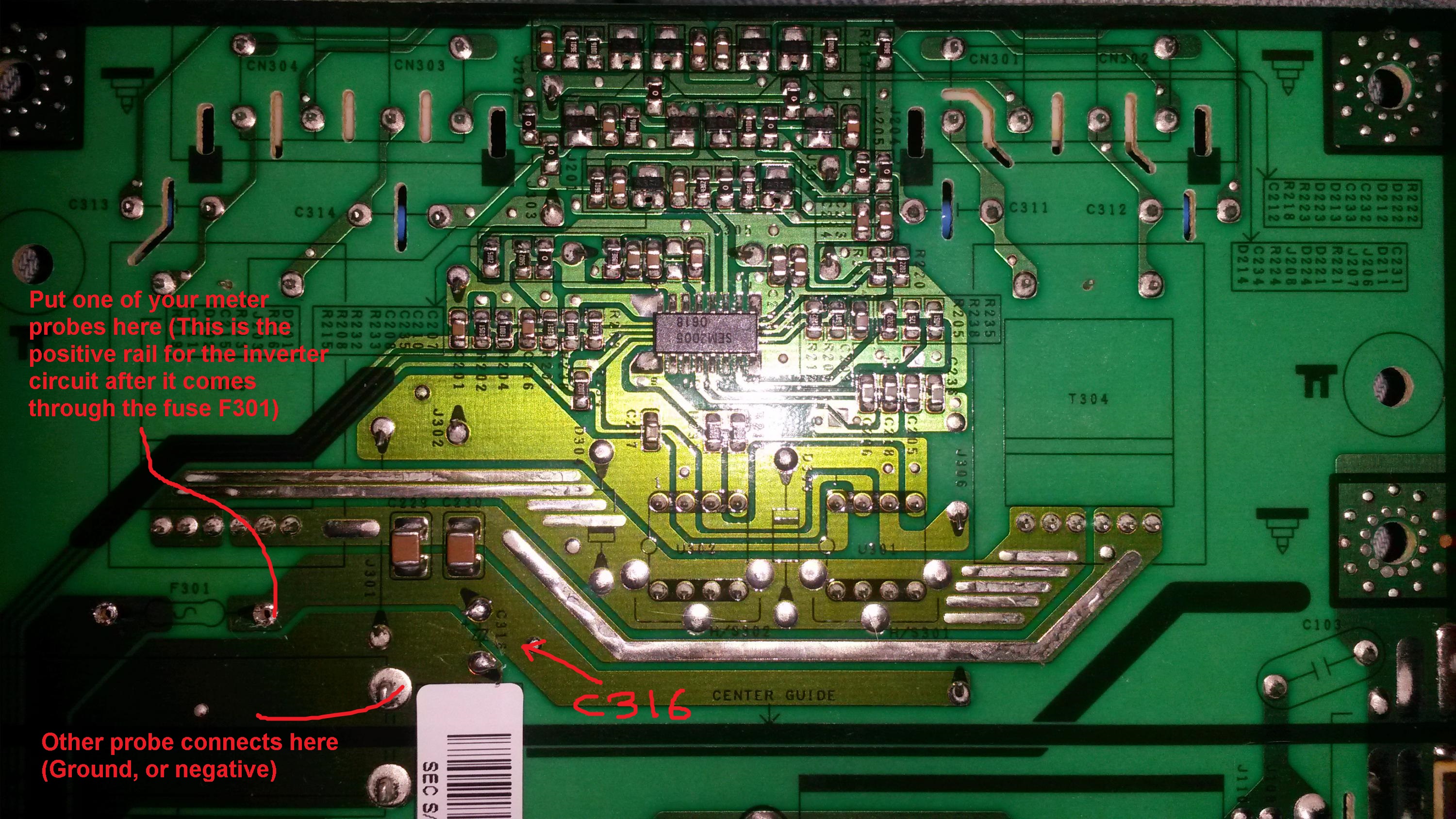

                        OK, no worries, I will try to explain... When I say 'measure across', I mean to put the probes of your multimeter 'across' the leads of the component - one probe on each leg.
                        Typically this is said when talking about a component with two leads\legs: "measure across the component" - OR talking about two points in a circuit "measure across the voltage rail" (Hope that makes more sense??) - I've never really had to explain this so I don't really know the best way to say it!
                        In any case: See the picture I've attached that shows where to put the probes for the first test (Set to low ohms or continuity test). Hopefully this will explain better what I mean by 'across C316'
                        -David VanHorn

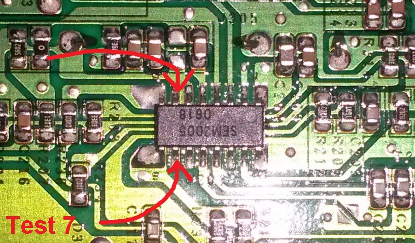

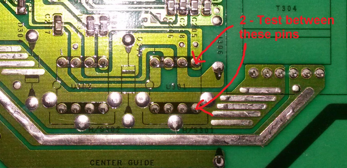

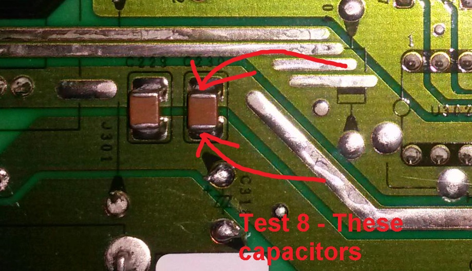

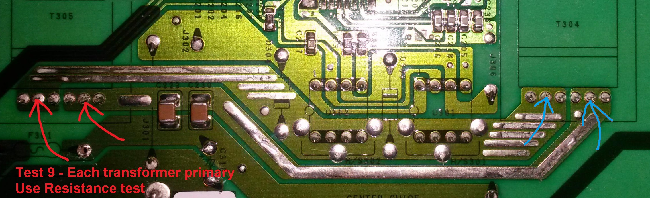

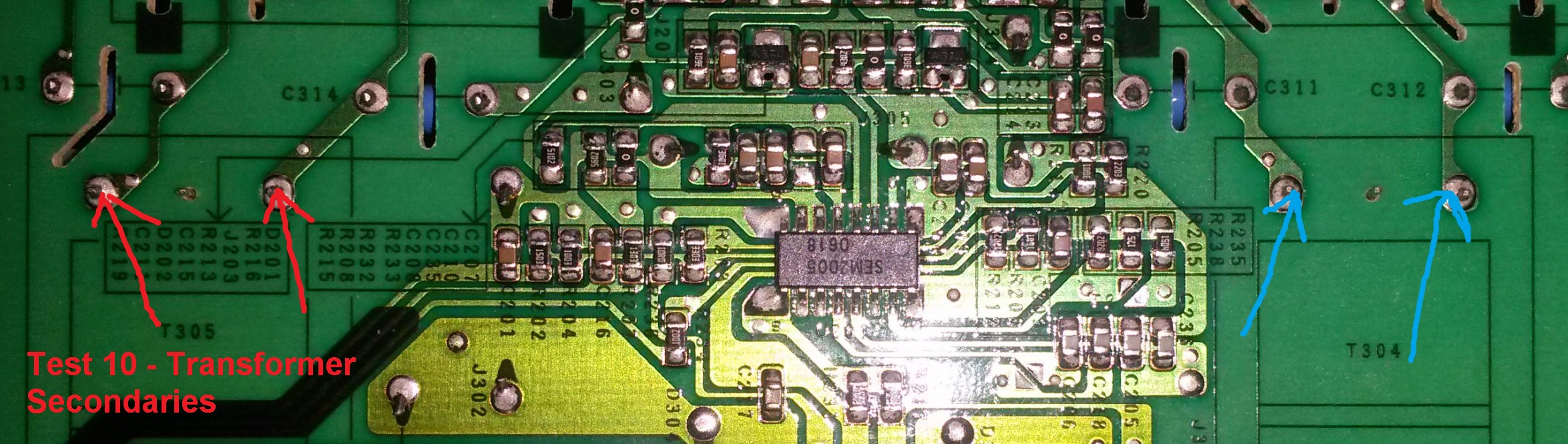

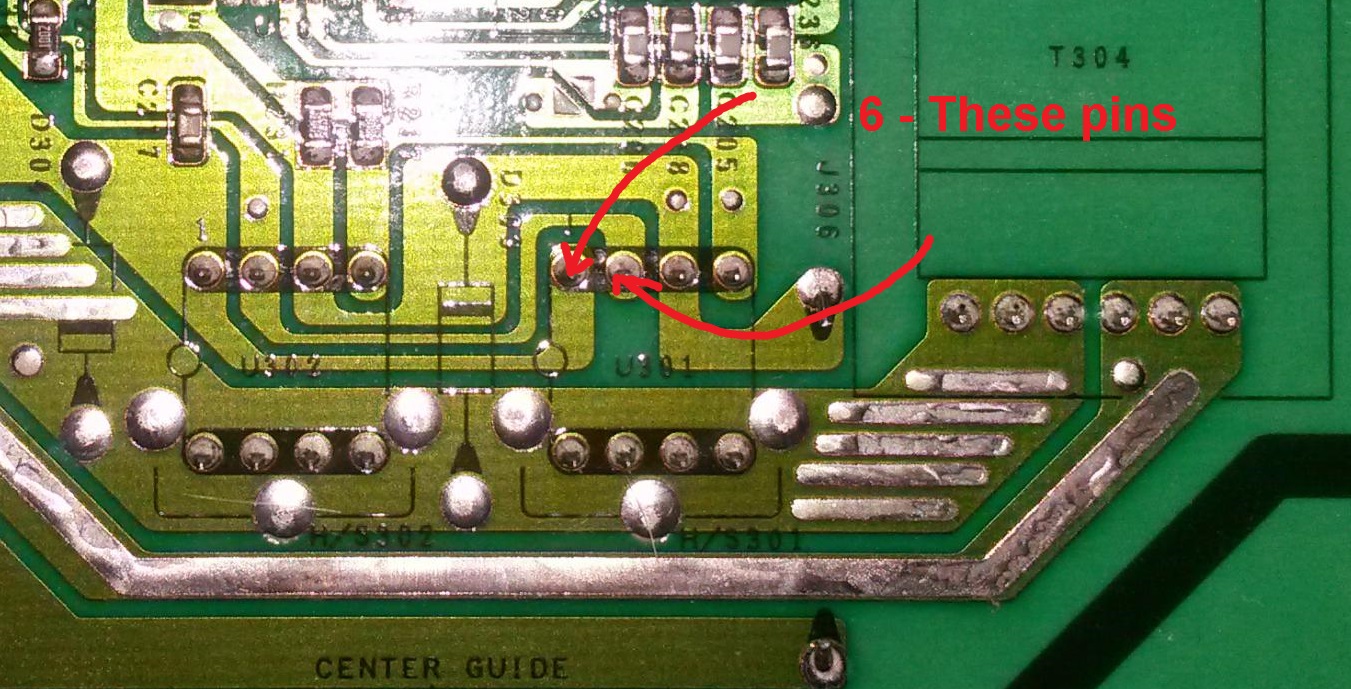

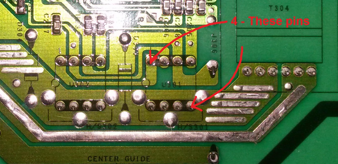

                                OK I have a list of 6 photos to test the MOSFETs. Use diode check mode, probe each pair of pins, and swap probes around so you check each pair in both directions. Do this for both MOSFETs.
                                You can also check the driver IC, ceramic capacitors, and transformers following the other photos. You shouldn't need to test both ways for these tests. Do the transformers with resistance test.
                                Write down the results and post them here. Hopefully it is easy to follow.
                                  Thank you for all this pictures very understandable, so here's the results:
                                  test1: overload; 636 (one direction; opposed direction)
                                  test2: overload; 1601
                                  test3: overload; 815
                                  test4: 193; overload
                                  test5: 1154 (not so sure my be overload too, various measures); overload
                                  test6: 783; overload
                                  for the other mosfets i've exactly the same results
                                  test7: 673
                                  test8: 630 (for the both capacitors)
                                  test9: 1ohms may be less (0.8)
                                  test 10: 1350ohms (red arrow) 1360ohms(blue arrow)
                                    Well it does not appear that any of those parts are shorted so that is good. I think you can try a new fuse and see what happens.
                                    With regard to the transformer primaries, they are normally quite low ohms so that is OK.
