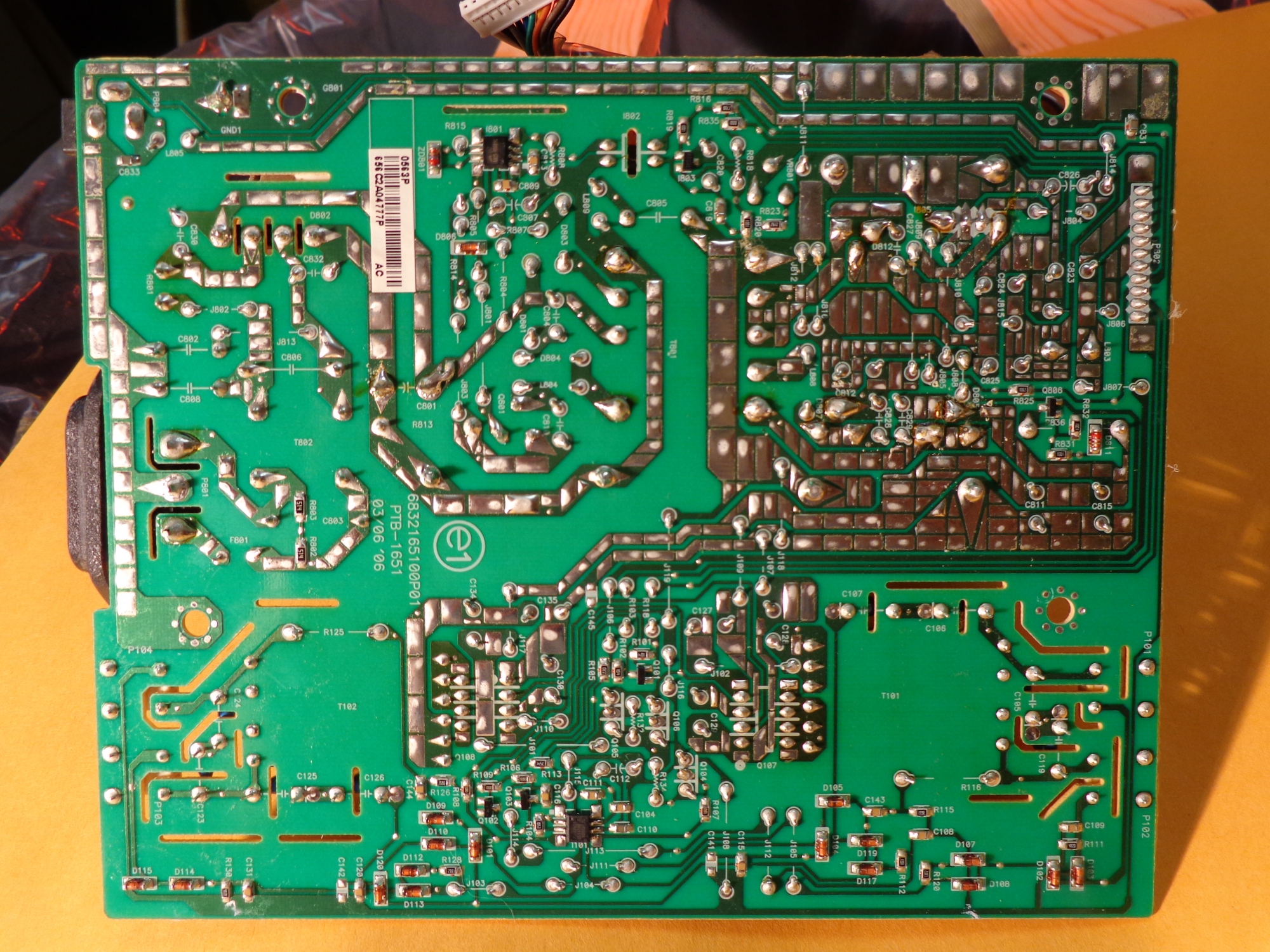

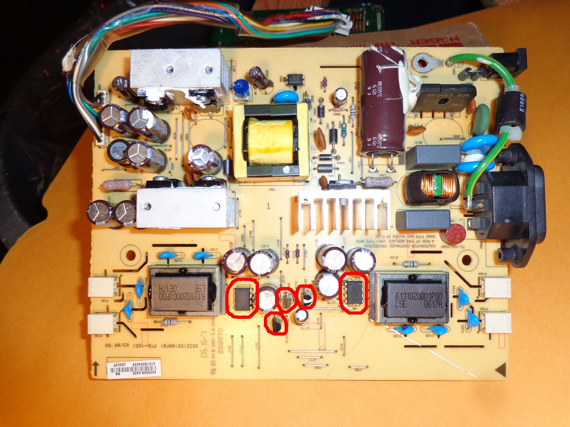

    Received most of the caps for the power board, so will change all I can and report back.
    • MEB
      • Sep 2013
      • 371
      Re: Dell 1907FPt - 2 Secs to Black
      Replaced all the caps on the power board except the 5 that were backordered. Thay look good and the ESR checked good. Connected together and all is like before, 2 Secs to Black.

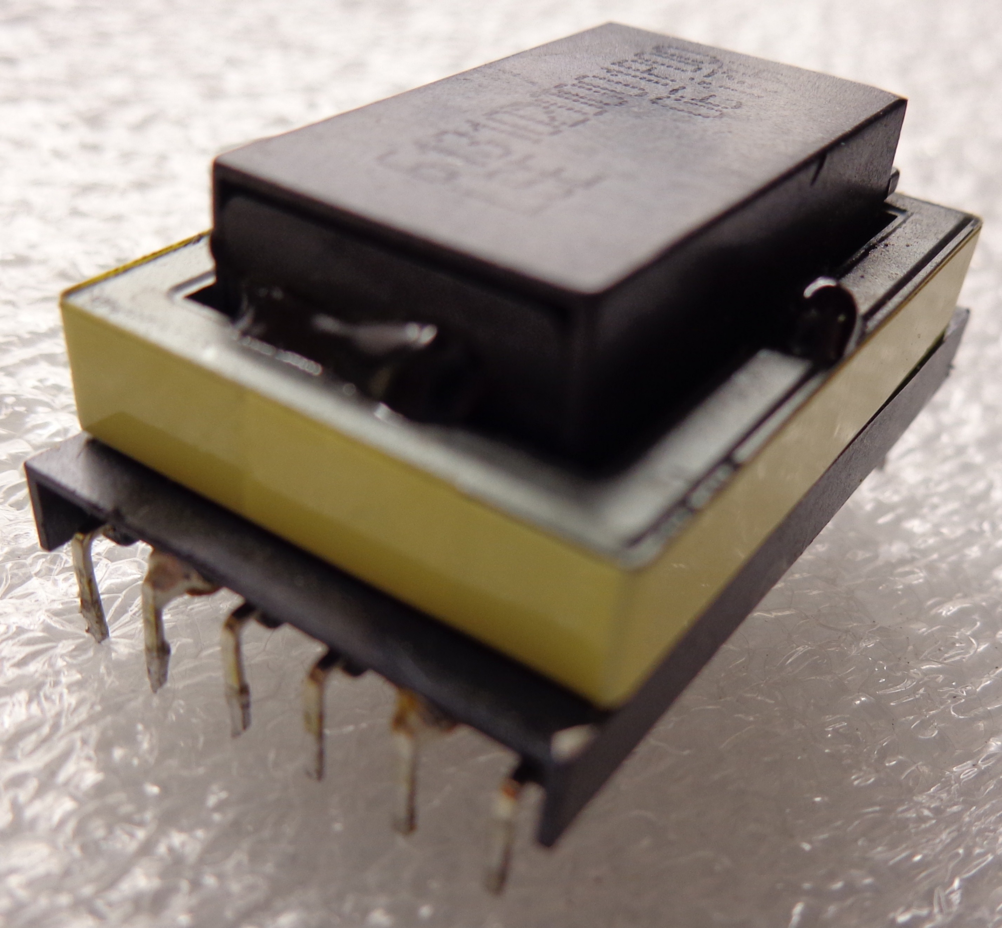

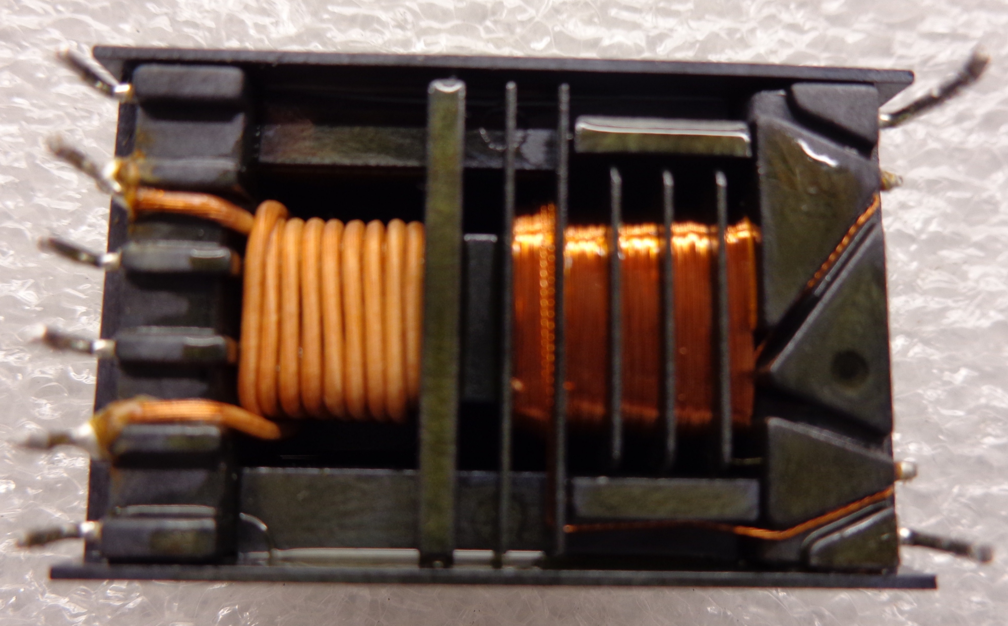

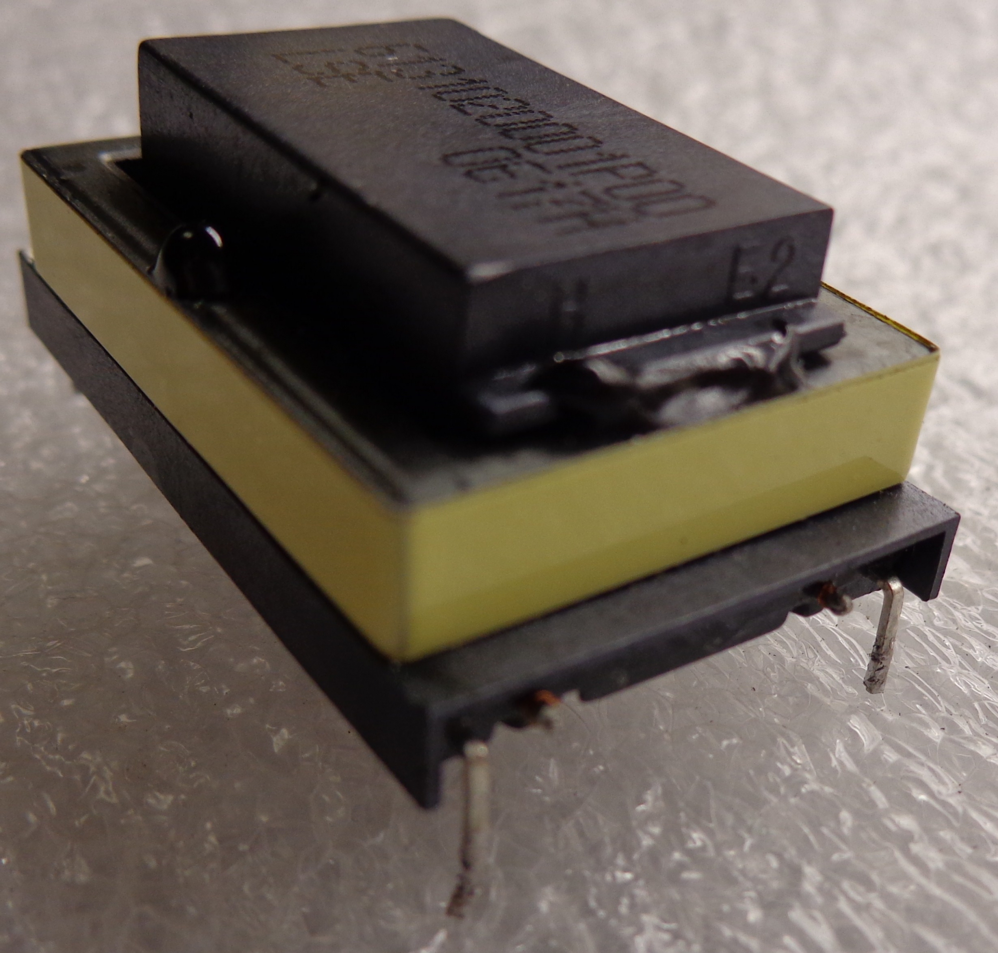

        You'll need to test the inverter transformers. Test resistance on the secondaries and see if they are within 3% of each other.
        • MEB
          • Sep 2013
          • 371
          Originally posted by MEB

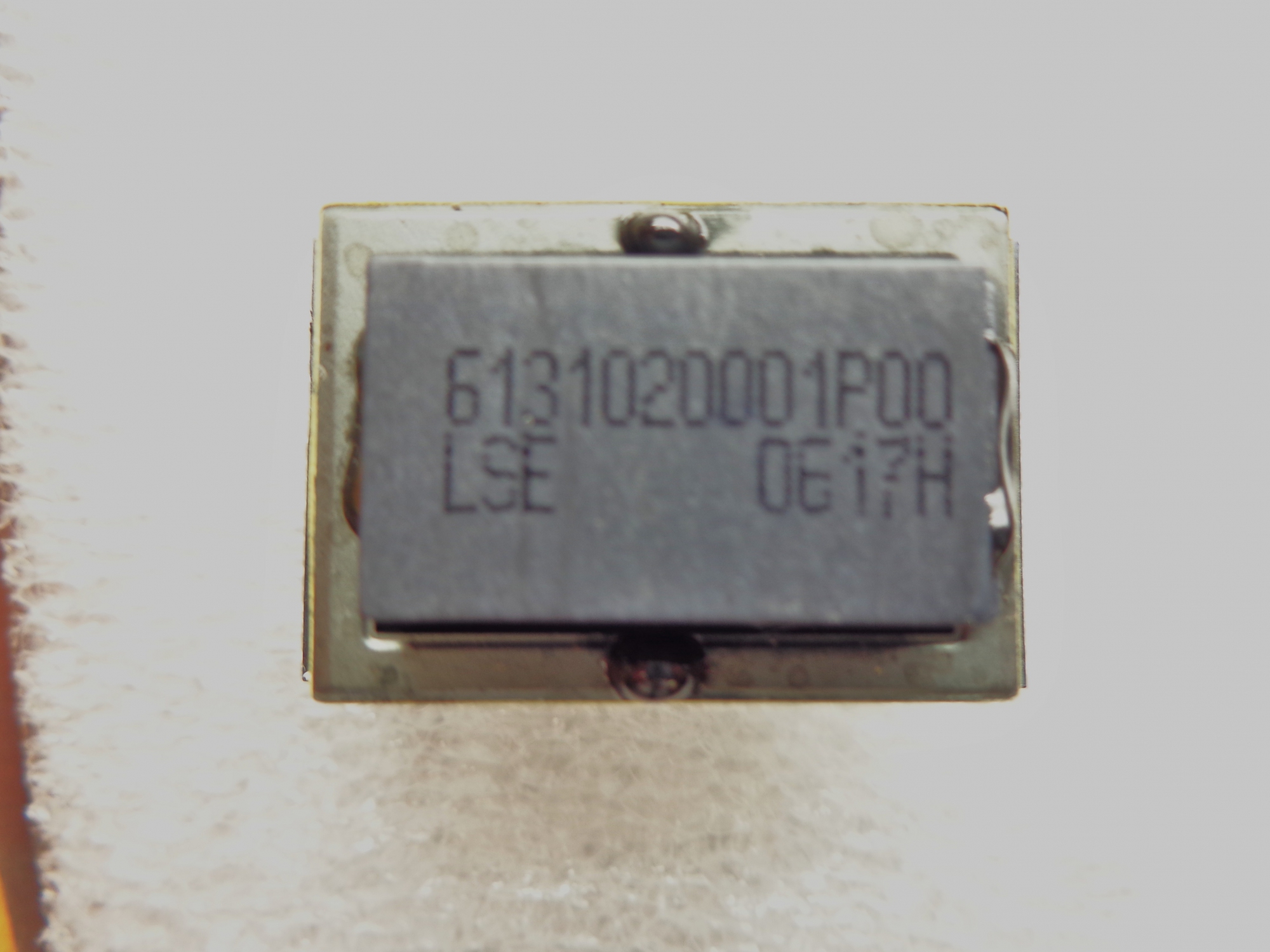

          I attempted to try to check the 2 inverter transformers, but don't think I know what I'm doing there without seeing inside one.
          Thanks Lumberjack. Well I guess its time I found out how to test a transformer. Previously I tried using retiredcaps instructions, but at the time I was confused, because there were pads under the transformer that were not actually connected to the transformer which caused my misunderstanding. So I removed one of the two from the board (T102) and things became clearer. I included some photos which may help some guy like me someday. Now the primaries on T102 read .3 ohms and the secondaries read 465.2 ohms. Now knowing what goes where I tested T101 in circuit and got p = .3 and s = 472.5 which is within your 3% so I think I am good?
          If I don't hear back shortly, I plan to make a lamp circuit tester using Bud's instructions as I am not real sure about the way I checked the lamp circuit earlier. If his lamp lights up, then I shall be waiting for further help. Thanks again.
          • Lumberjack777
            • Dec 2010
            • 464
            I'm sorry, I got sidetracked. Yes. That's within 3%. There are other tests like a ring tester for them. But for now, it doesn't appear to be the inverter transformers. Sounds like the lamp tester next step is a good idea. Good luck.

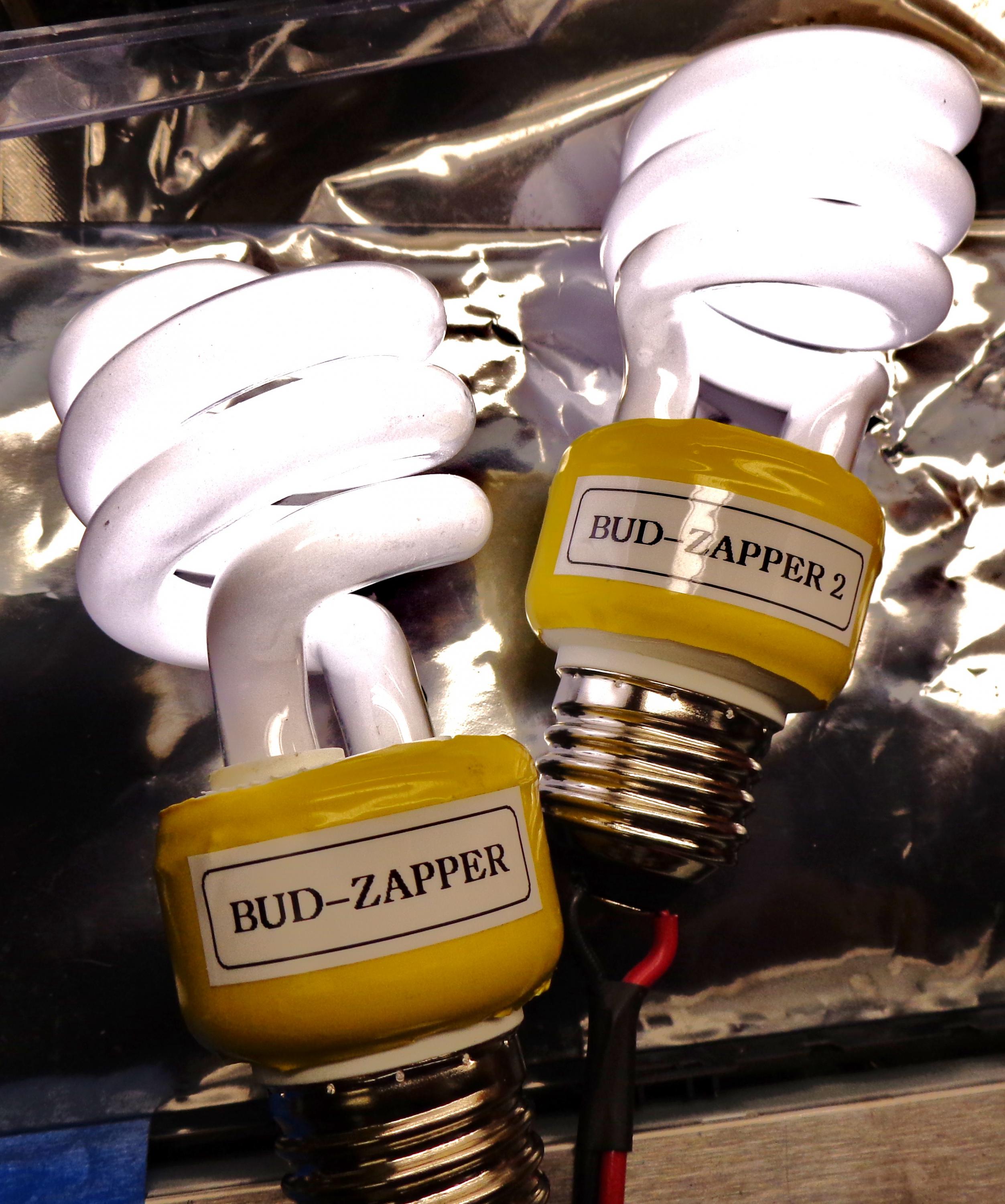

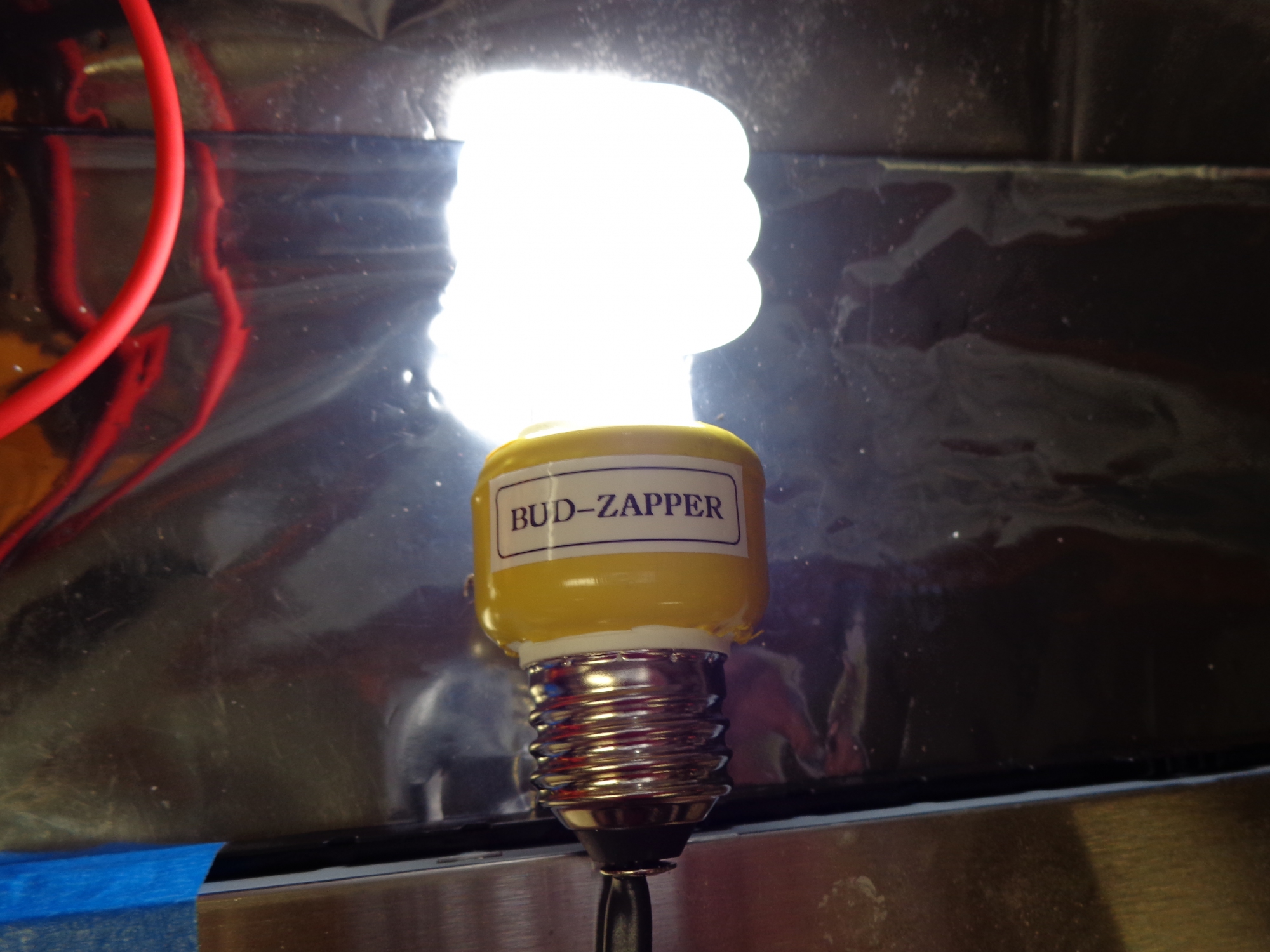

              Thanks for checking back. I have been wanting to do this for a while, so since I needed it now, I made the "Bud-Zapper". I enclosed a photo as I am pretty darn proud of it. All credits to the inventor. Hope he doesn't sue me! Note: The lamp base has no function, but I kept it cause I liked the chrome look.
              Anyway, I replaced the lamps one at a time with the "Bud-Zapper" and as neat as it is, I still got 2 Secs to Black.
              Oh, by the way, I received the rest of the caps and replaced them, so the Power Board has all new Panasonic capacitors except the big one.
              Really could use some more direction as I am not sure what to do next.
              Thanks.
                Bud-Zapper. NICE! hahahaha (I'm sure Bud would be proud. I hope he stops by to help out)
                Well darn it anyways. I was hoping this would be an easy one. You've done everything right.
                The next thing you need to check are the 5 components I circled in the inverter circuit. Looks like 3 transistors and 2 mosfets. Retiredcaps "2 seconds to black" guide shows how to check those. At this point, its probably one of those fets.

                  Nice! So you made two at least to test as a pair since there is possibility of having two bad lamps?
                  http://s807.photobucket.com/user/bud...ml?sort=3&o=11
                  http://s807.photobucket.com/user/bud...ml?sort=3&o=17

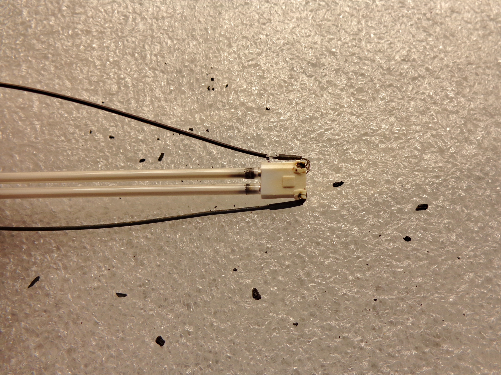

                        When you have the good test lamps plugged into the connectors with the bad lamps, it will stay lit. YES, you got it. That was a good idea budm had to test that. What's RARE is to have one bad one on the top and one on the bottom, at the same time. I wonder if the monitor was dropped or bumped? I have never had one on the top, and one on the bottom, go bad at the same time. ANYWAYS........ if you are absolutely sure; then you have 2 options (depending on how much $$ you want to spend, and how much effort you want to try)
                        Option 1 - (the easy way) Is to get 2 extra ccfl bulbs and plug them into the bad bulb connectors. Then tape the ccfls using like duct tape to the back of the lcd panel. The monitor will run off 2 bulbs and may or may not be bright enough for you. In my case it's always been bright enough. You could check the front of the screen with those 2 "Bud Zappers" plugged in and see if the screen is bright enough with just 2 ccfl's.
                        Option 2 - Disassembly of the lcd panel. This is a fairly long and delicate operation. Usually takes me a couple hours. And you'll need to buy some replacement ccfls. Keep track of the placement of the diffusion plastic sheets. Pull the ccfl holders out from the top and bottom. Pull off the silicone end caps. Solder in the new ccfl's. And put it all back together.
                        Now you see why I normally just choose to add a ccfl to the back. Plug it in and tape it, and send it on it's way. Takes me about 2 minutes.
                        Your choice

                            I figured you for an "on a mission" type of guy. I was the same way when I started out. I'd take things apart to the very last screw.
                            These monitors have 2 bulbs on top, and 2 bulbs on bottom. They light up the inside of a thick piece of plexiglass.
                            So then, what you'll need to do is..... Get down to the lcd panel itself. Then take the little screws out of the controller board. It will be flimsy and has colored tape circuitry that goes to the panel. Always be careful of the colored tape with the little board attached. Never pry on, or damage that tape carrier package. Now you'll want to pry off the outer metal frame. I think the lcd screen comes out next. Then pry off the outer plastic frame after that. There may be some tiny screws holding it in place, and wires from the ccfl's. You'll eventually get to thin plastic sheets inside. These need to be reinstalled in the same order. That's important. Then comes the thick plexiglass. The bulbs will be held in a sort of metal holder that runs the entire length of the monitor, on the top and bottom of the plexiglass. This usually just slides off exposing the 2 bulbs on each side. You'll see the ccfl's then. Maybe even see cracks or breaks. Then you slide off the end white silicone end caps from the bulbs. You'll probably want to get 4 bulbs, since you are already replacing the top and the bottom ccfl's.
                            I refer you here now because it explains the ccfl soldering process.
                            http://www.ccflwarehouse.com/lasotu.html
                            Check out the tutorials there. Like measuring the ccfl's for replacement. You might be able to find replacement ccfl's cheaper on eBay or somewhere else.
                            Assembly is just the reverse of course. Those lamps are very fragile and also contain mercury. Once I was replacing some ccfl's and wasn't paying attention and simply set my needlenose pliers down on the bench. Right on top of a fresh new ccfl. That's all it took to break that thin bulb into smithereens.
                            Somebody out here once said that ccfl replacement is patience, focus, and more patience. And I'd have to agree.
                                This is how I test the inverter using a pair of test lamps and how I take the panel apart.
                                https://www.badcaps.net/forum/showpo...&postcount=119

                                      The most cost effective way now is to salvage the connectors to the boards. Use any wire that you can find that is similar. (or the original) and buy bare ccfl lamps from China or somewhere. You'll need to measure or locate the ccfl diameter, and the length.
                                      If you were to buy the complete assembly with lamp, end caps, wire, and connector; it'd run you about $15 per ccfl.

                                        Hello, sorry I took so long. I looked around and found several chinese lamps on ebay, but they were all for quantities of 50 to 100. The price was still good but I didn't know what I would do with all of those and I was not sure what I was getting. Are those lots any good?
                                        Being my first lamp replacement on a monitor, I went ahead and ordered 2 sets with wires from ccfl warehouse. I was able to follow the instructions and the new boots were nice and soft and I was able to move things around enough to install them in the reflector things. I am still shaking though. I learned that next time I need to do a better job of identifying the way I keep tabs on those screens/diffusers or whatever they are called. There were some cutouts to prevent left and right switching, but if I didn't get something in upside down I would be amazed. Anyway, she lights up and stays lit and I had a great (but nerve-wrecking) learning experience. Thanks so much to Lumberjack and budm.
