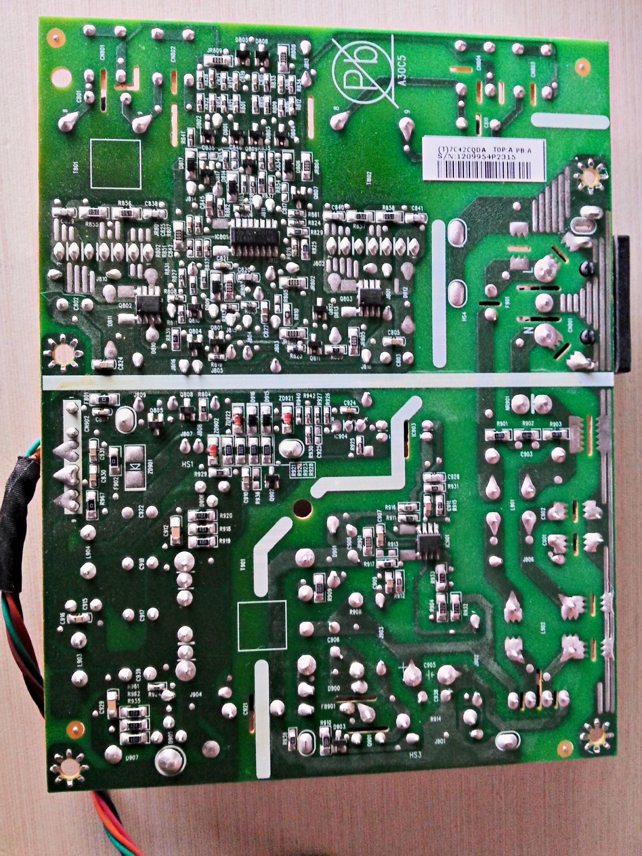

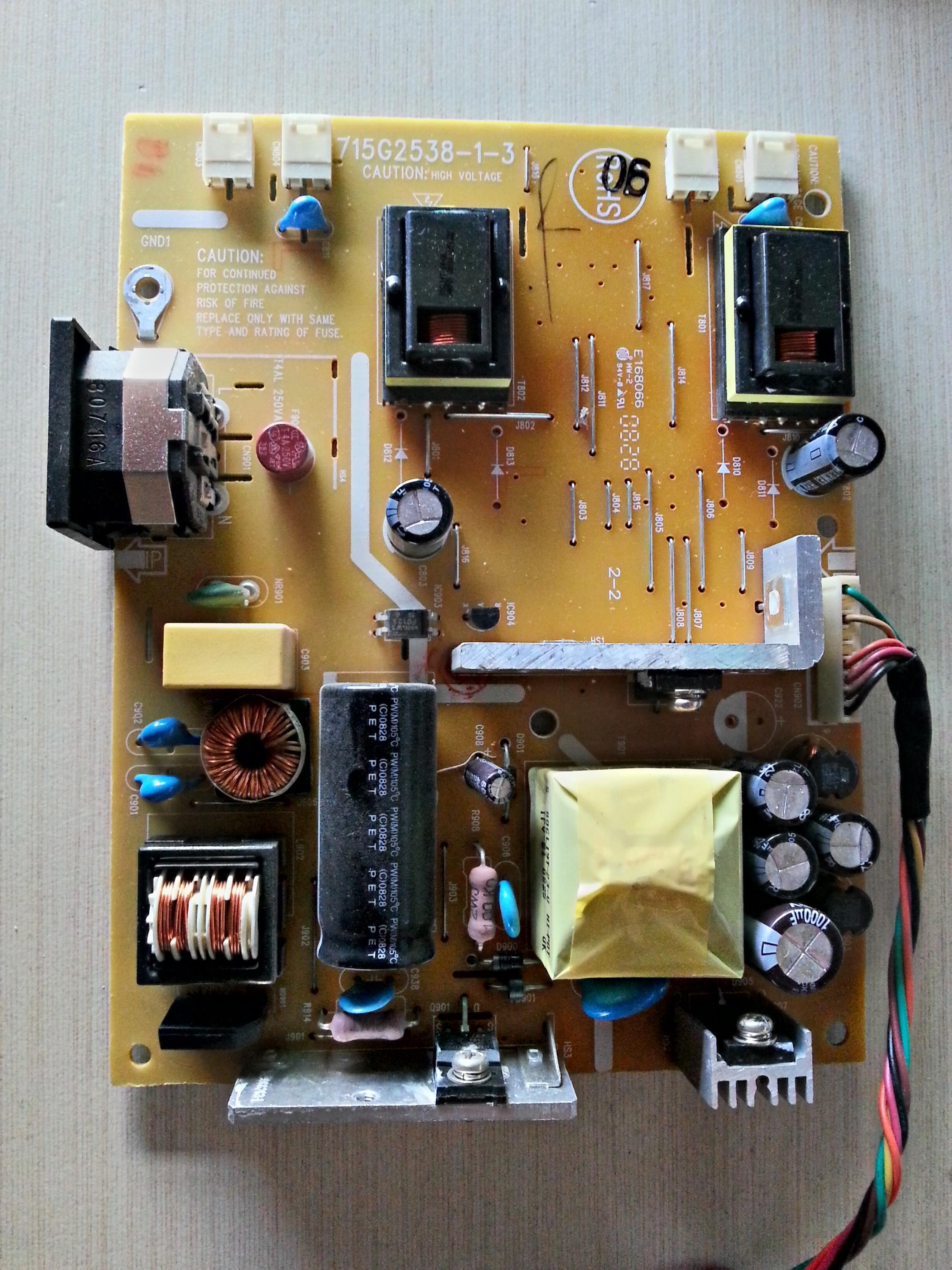

    So I have this Asus VW221. Its problem is, the backlight's not working at all. No seconds to black. It's all black right away. There's a picture on the screen, all OK as it should be, just no backlight.
    I opened it up, and there are no bulged caps, visually, nothing out of the ordinary. Little did I find about this screen and this problem, but some are talking about trafo(s).
    Here are the photos, and I hope someone will be able to help
    Re: Asus VW221 (model VW221d)
    Check the SMD fuses (F801, F902) by the connector CN902. If F801 is blown, then you may have bad Q802, Q803.

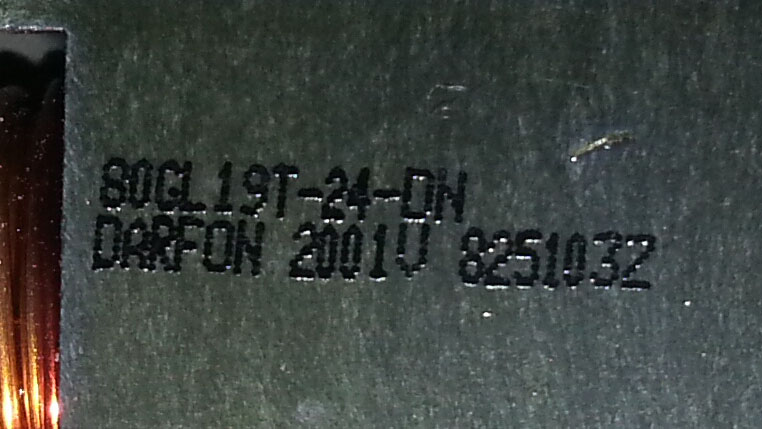

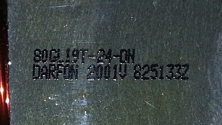

                  Can you provide the P/N as printed on the two inverter transformers so we can look up the pinout to check the HV winding resistance? Also get te P/N of the two SMD MOSFET so we can verify if they are OK or not.

                    Here's trafos.
                    Now, if I'm not mistaken, I see four mosfets here. One on the top side, a three on the bottom side. Which ones are you interested in?
                      There are only two power SMD MOSFET: Q802, Q803. They are Dual-MOSFET (two MOSFETs in one package).
