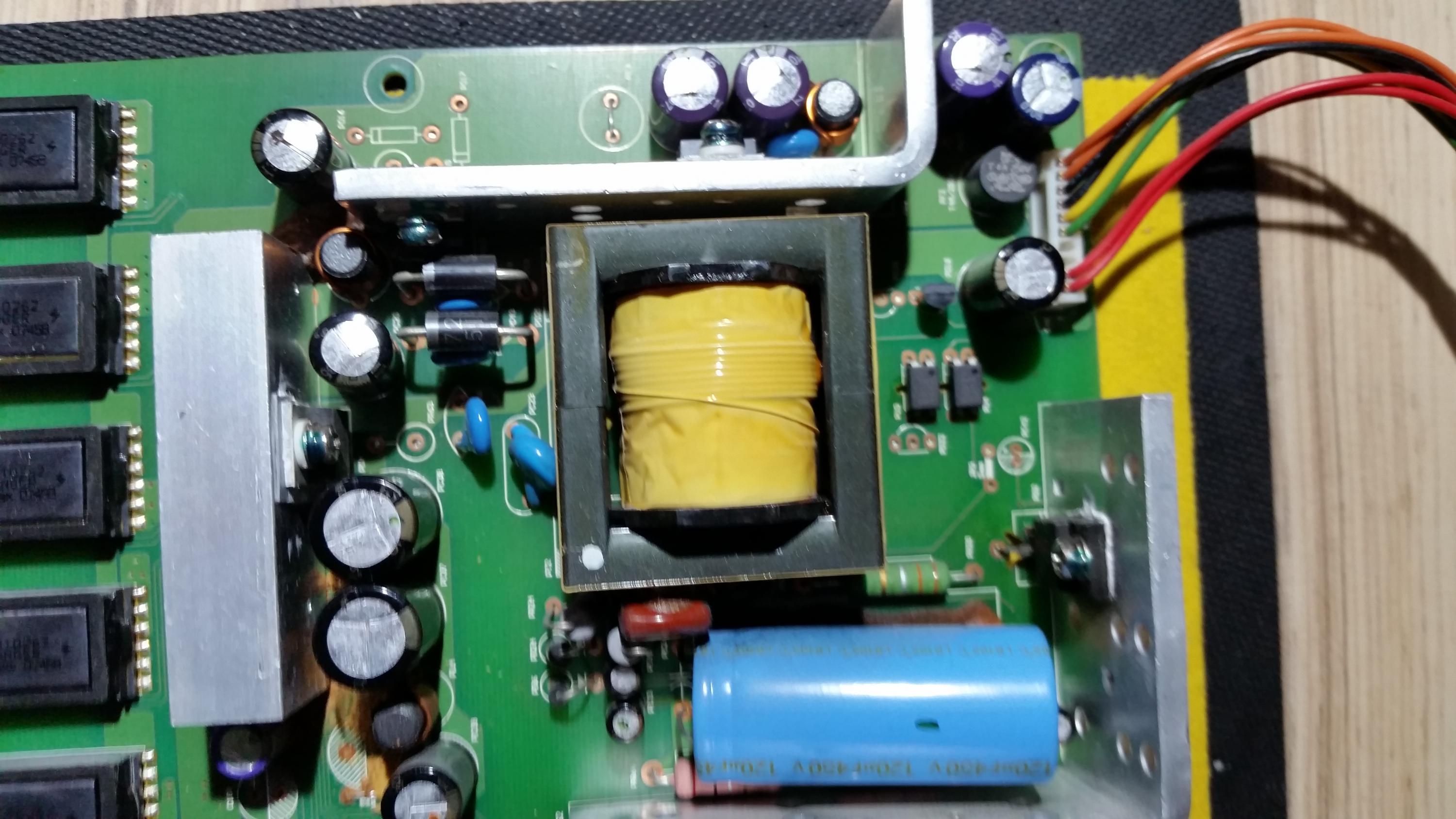

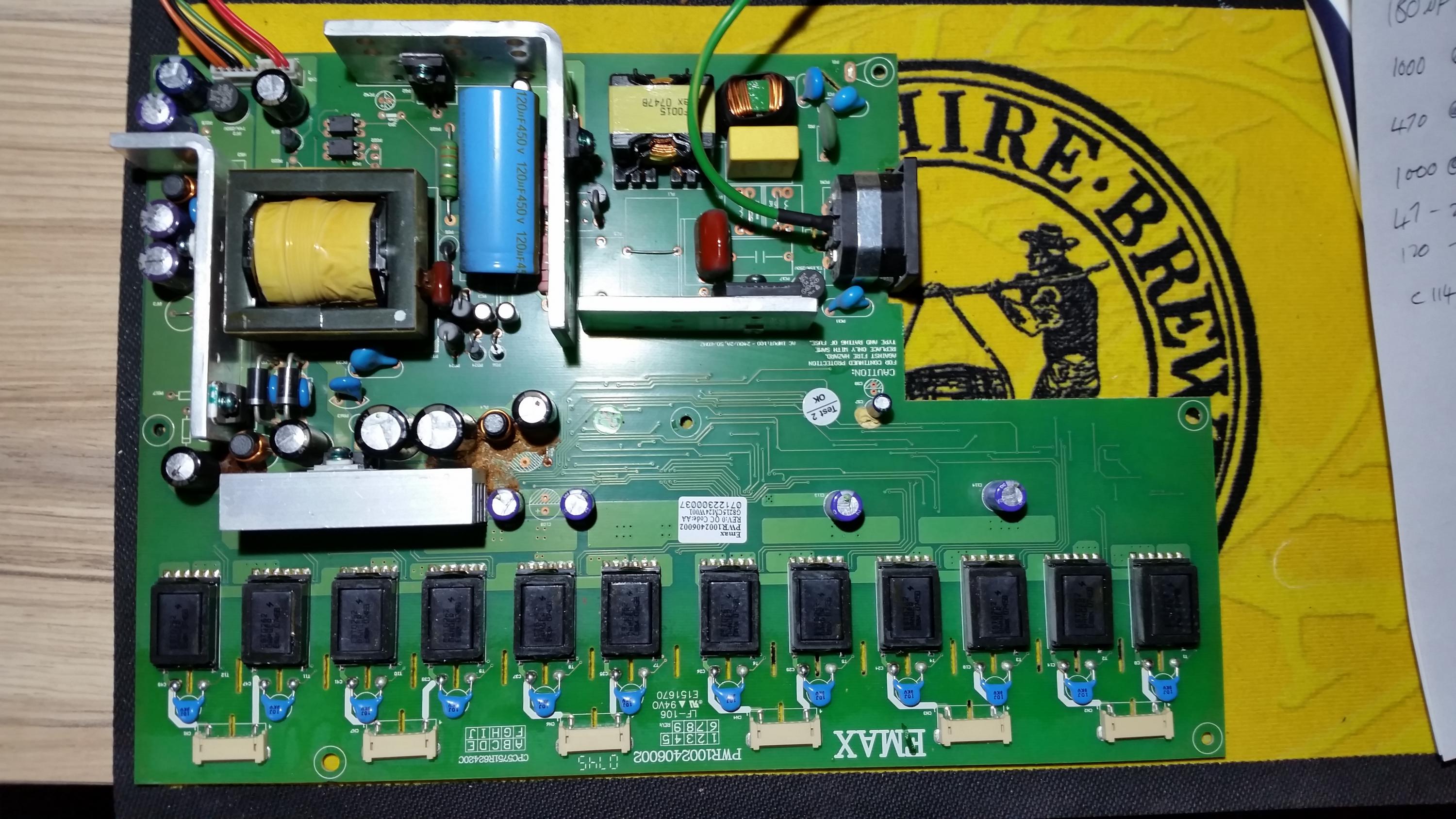

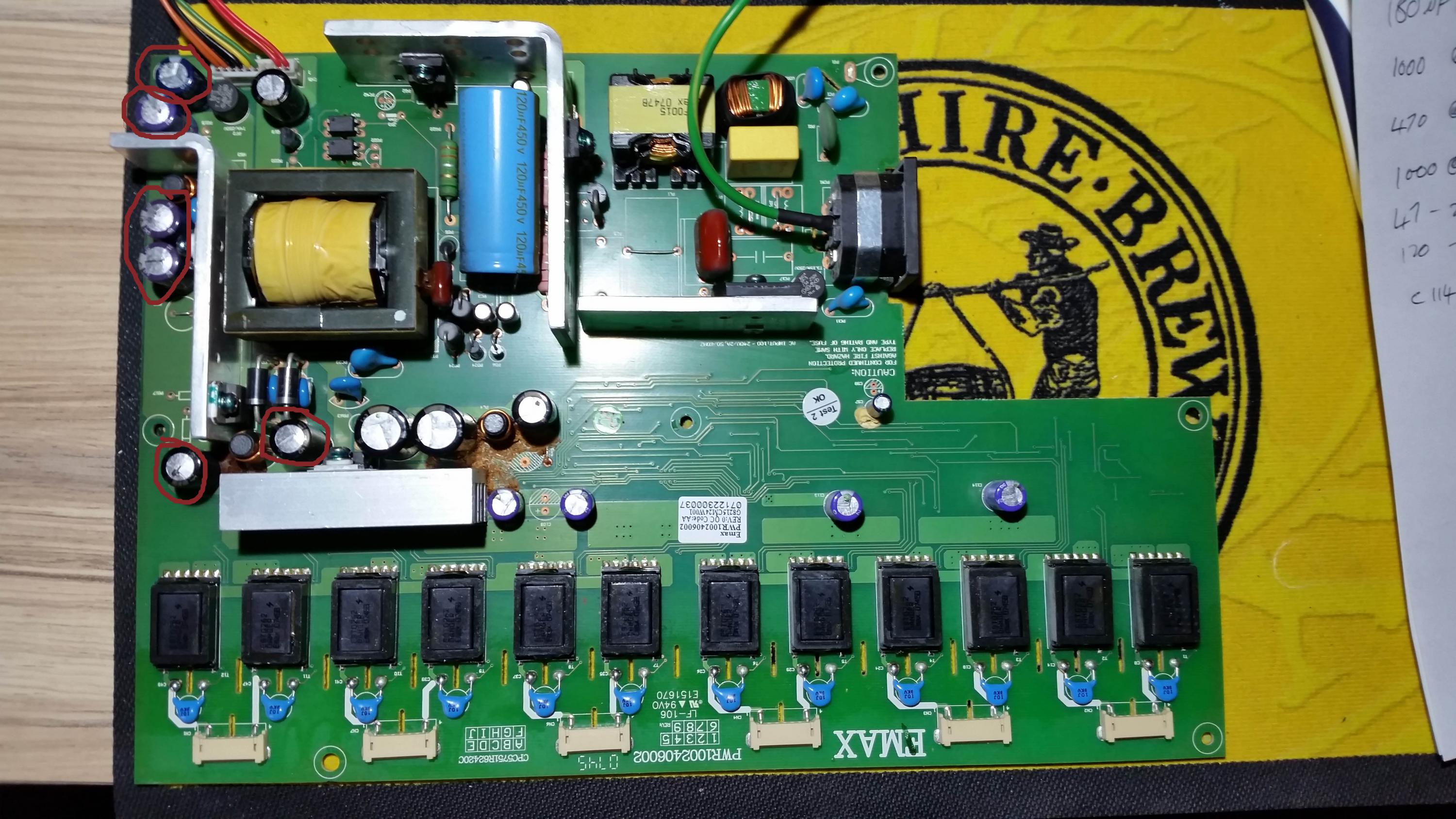

    Dgm l2442wd
    Got one of these from Ebay (£10.50).
    Power LED comes on, loud buzz from monitor and everything goes off.
    Opened it up and found 5 Hermei caps bulged and leaked. Have ordered replacements (panasonic FC series) for all electrolytics on the board - will update when fitted. Bulging caps circled in red in third picture.
    Strangely the 450v 120Uf cap was loose although still soldered so I replaced it with one from a dead Samsung power board.
    These are (usually) an excellent monitor with a PVA panel and were popular a few years ago as several places were selling them at a great price for a PVA panel.
  • pillboxhunter
    • Jul 2014
    • 30
    Re: Dgm l2442wd
    Caps detailed above replaced and monitor now working 100%
