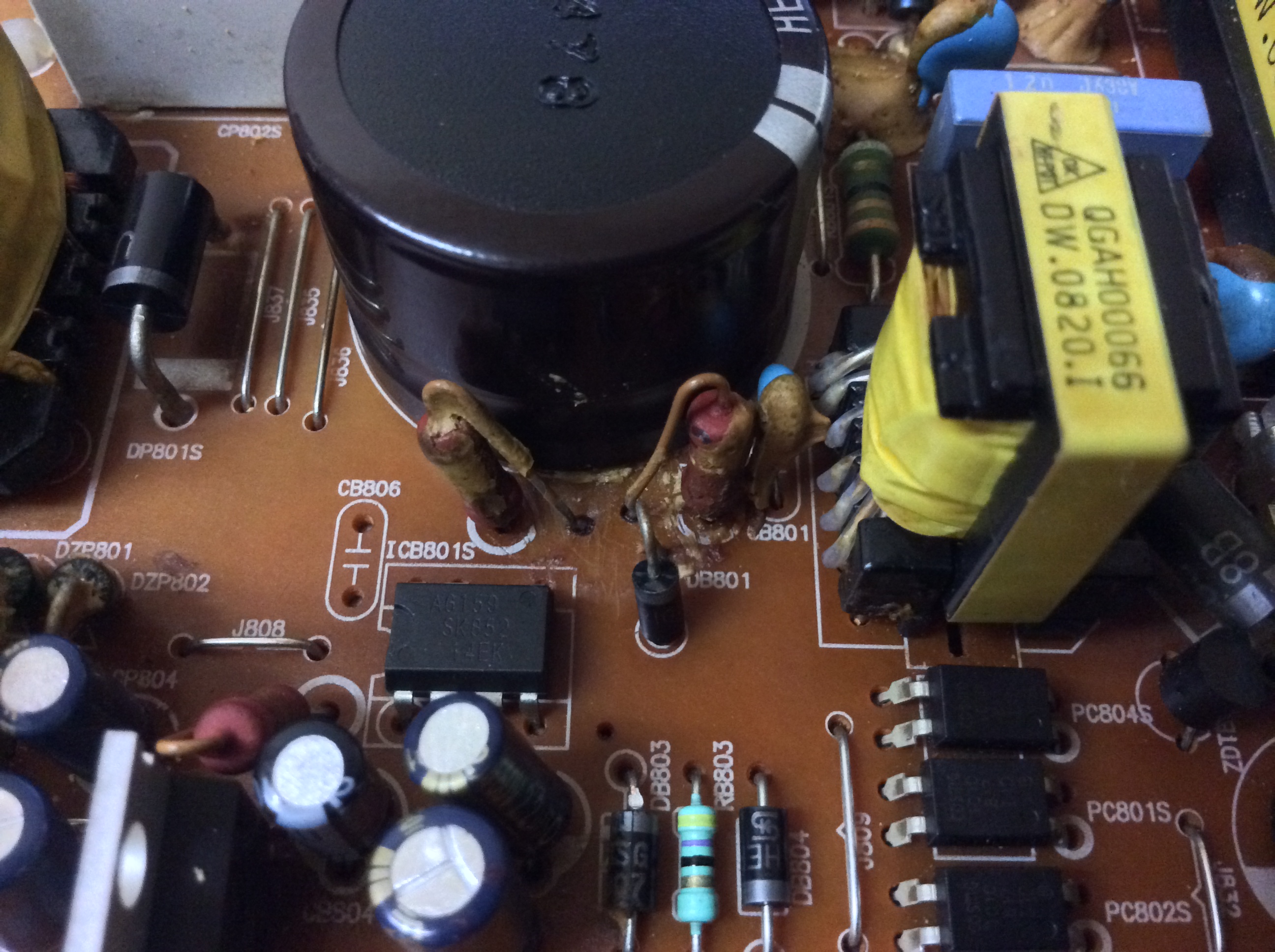

    Hello Every,
    I have an Samsung Syncmaster 245B+.
    The Display Button have an BlueLED.
    Then I power on the light comes up and immediately light goes off.
    The Screen stay black. I opened the case and no capacitors was blowing up, and looks good. I changed btw all capacitors but not the biggest one in the middle 450V 82uf. I cleaned the pcb and test it but nothing changed.
    I saw yellow/brown glue on the board but don't know how I can remove that. Read here about that i must remove it. The Monitor is about 5/6 years old and have an good 16:10 1920x1200px resolution and I want it to repair.
    My Multimeter was an present from an friend and not so good one. The V=== can only measure 250V so I buy newer one but it will coming tomorrow. So I cant measure the biggest capacitor yet.
    I test the two transistor DB801 and DB802 while this was also in glue. I removed it slightly with an scalpel and desoldering it to measure.
    Two transistors have following color (brown, black, yellow, gold) I think it is 10kohm +- 5%. One of them have 9,54 the other have 9,89 and I think it is good.
    Please, then one of you have an suggestion for me, feel free and give me a try and tell me.

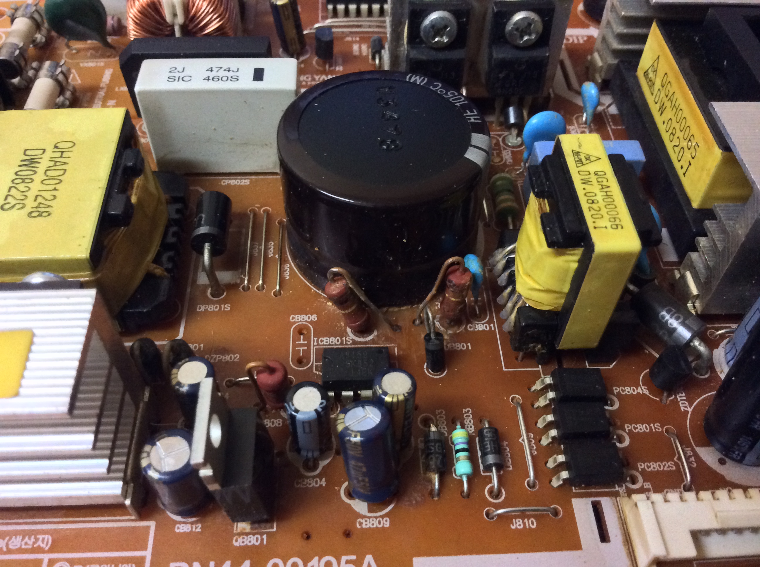

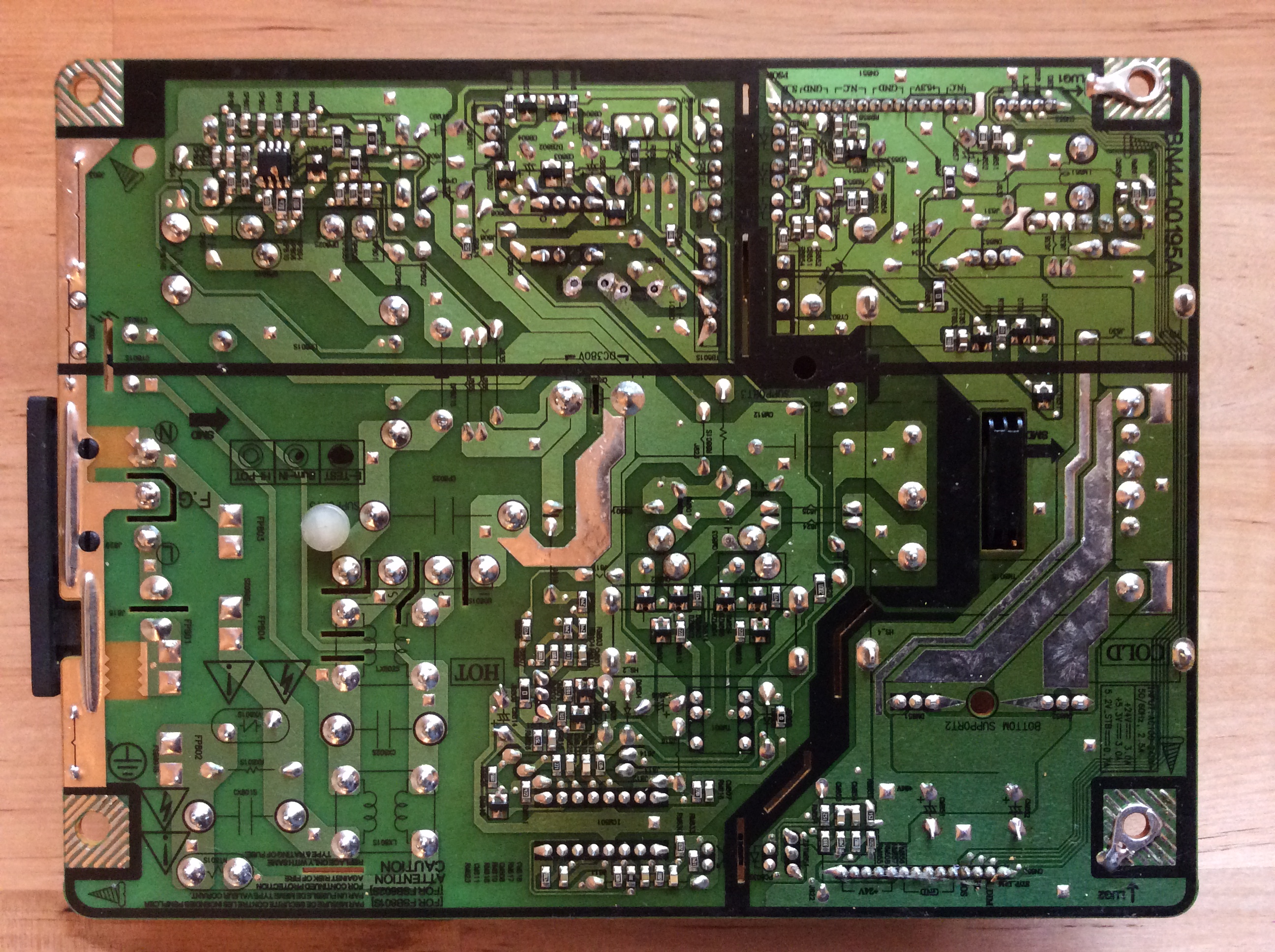

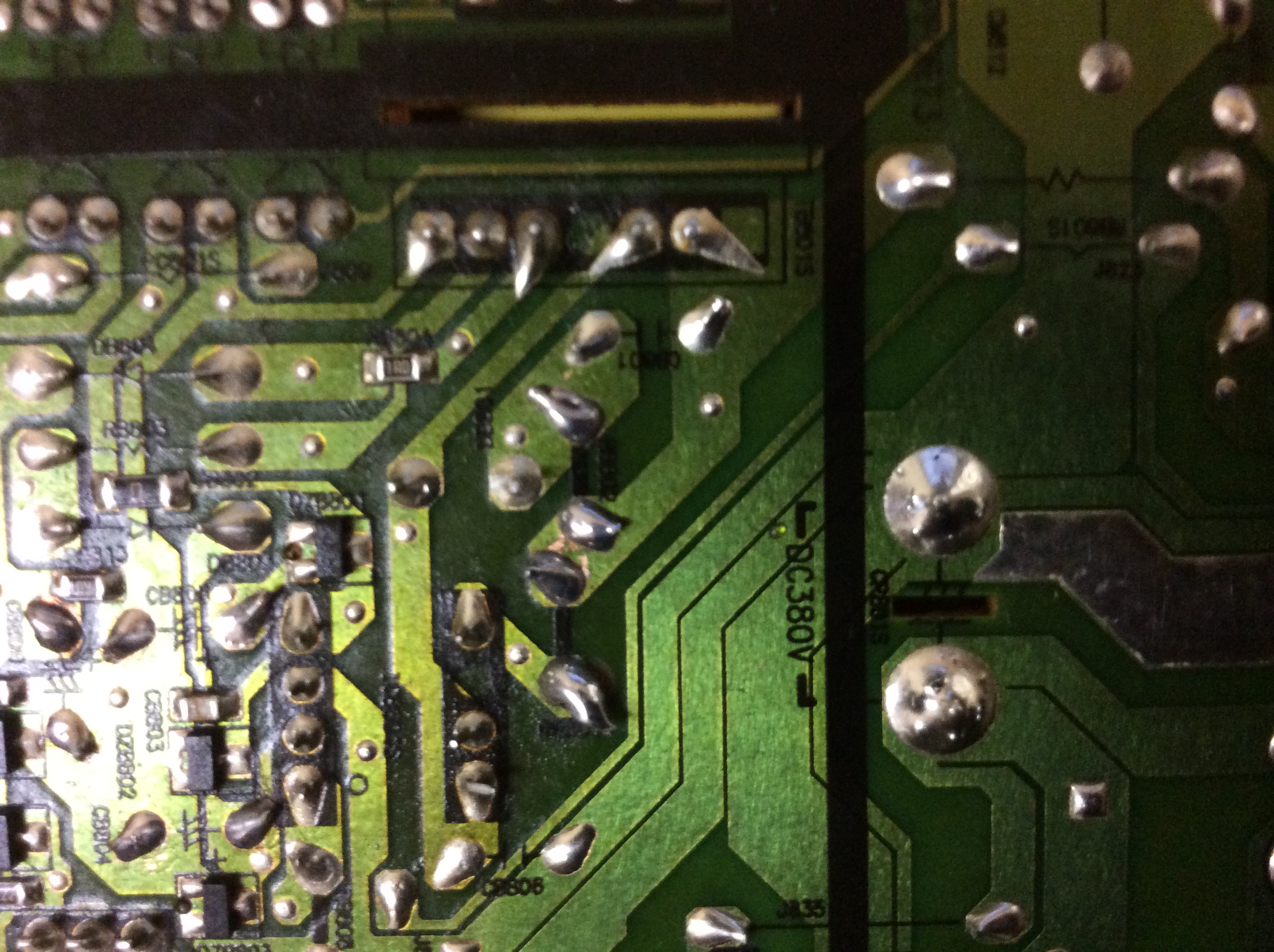

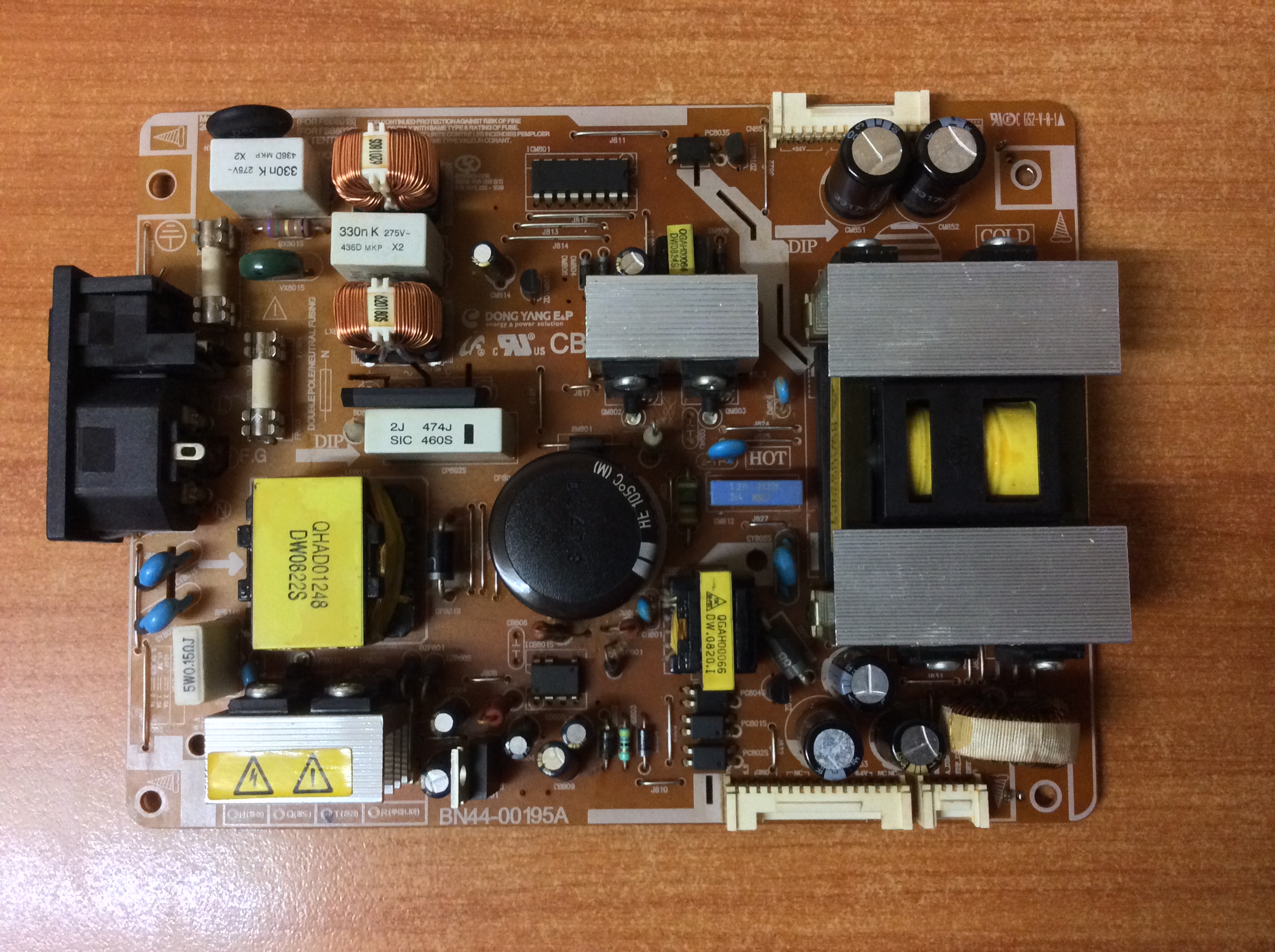

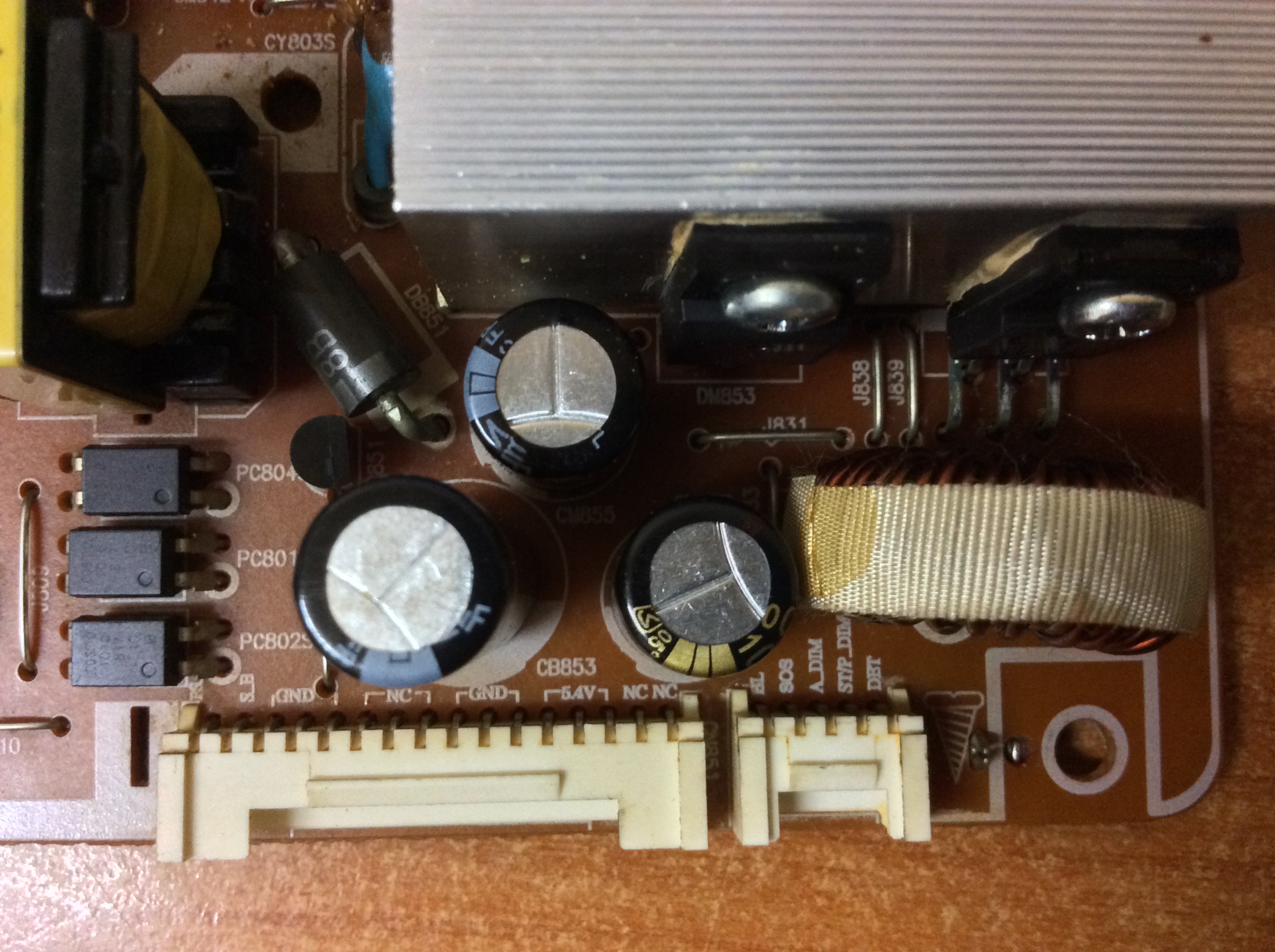

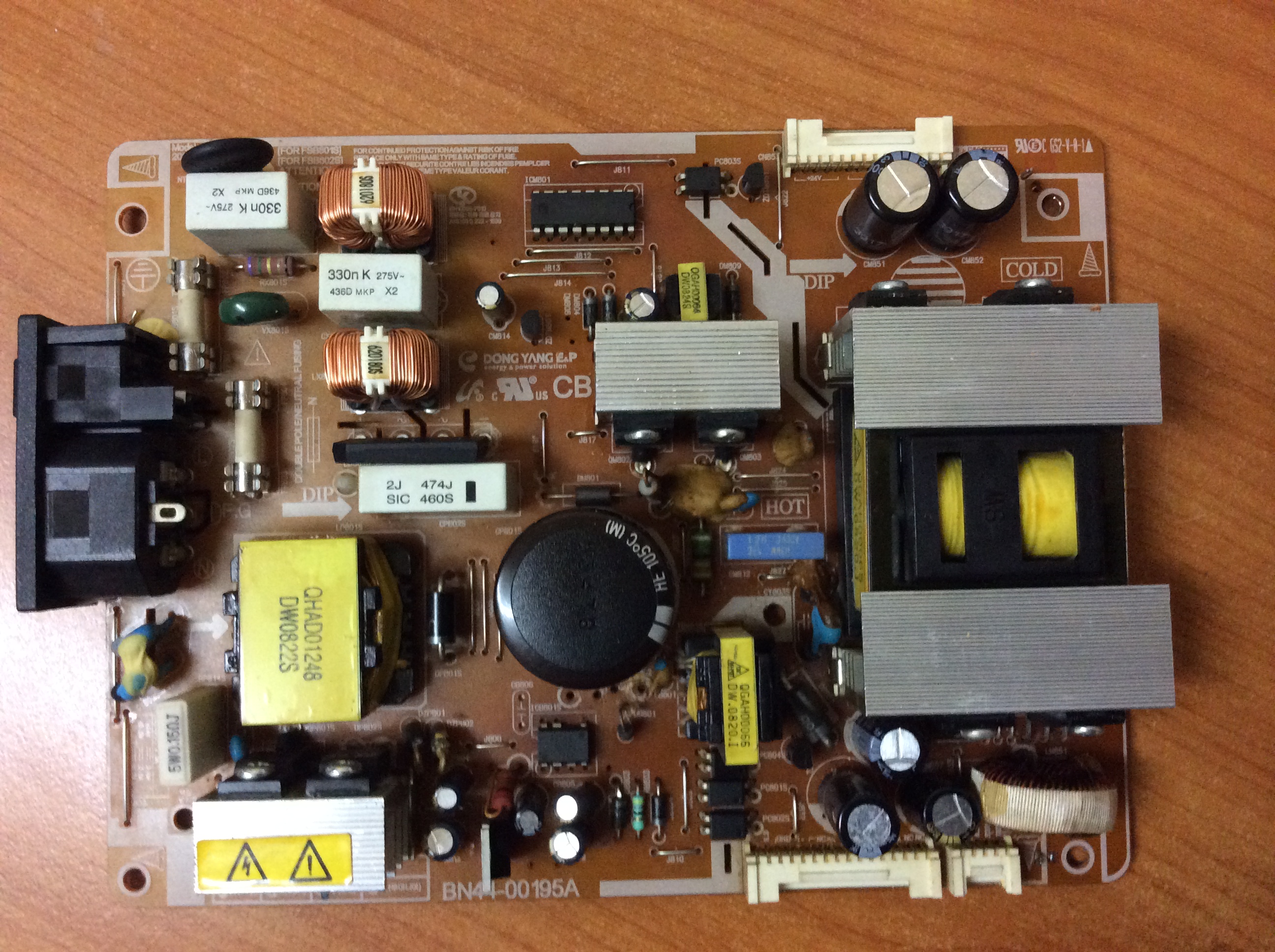

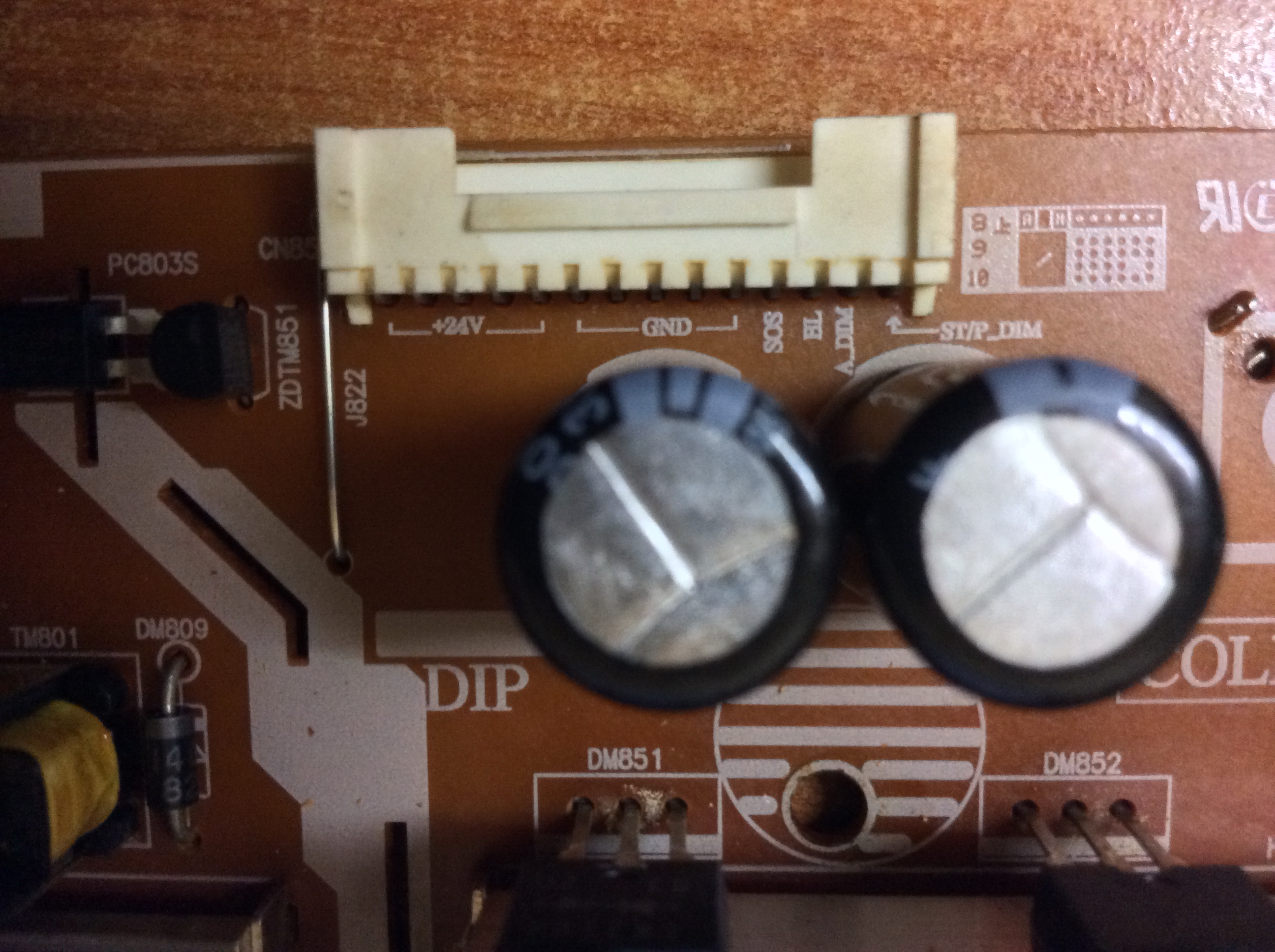

      Here are my pictures from the BN44-00195A PCB Board.
      IMG_0357.JPG - PCB Topside soldered 12 capacitors new not the biggest
      IMG_0363.JPG - PCB Bottomside soldered points
      IMG_0388.JPG - PCB out connector 1 GND|NC|GND|5.4V|NC ...
      IMG_0392.JPG - PCB out connector 2 +24V|GND|SOS|BL ...
      IMG_0393.JPG - PCB soldered RM801, RM802 Transistor after measured BOT.
      IMG_0396.JPG - PCB soldered RM801, RM802 Transistor after measured TOP.
      Hope it helps. When you need new detailed fotos feel free and quote me, i will make it and upload it.

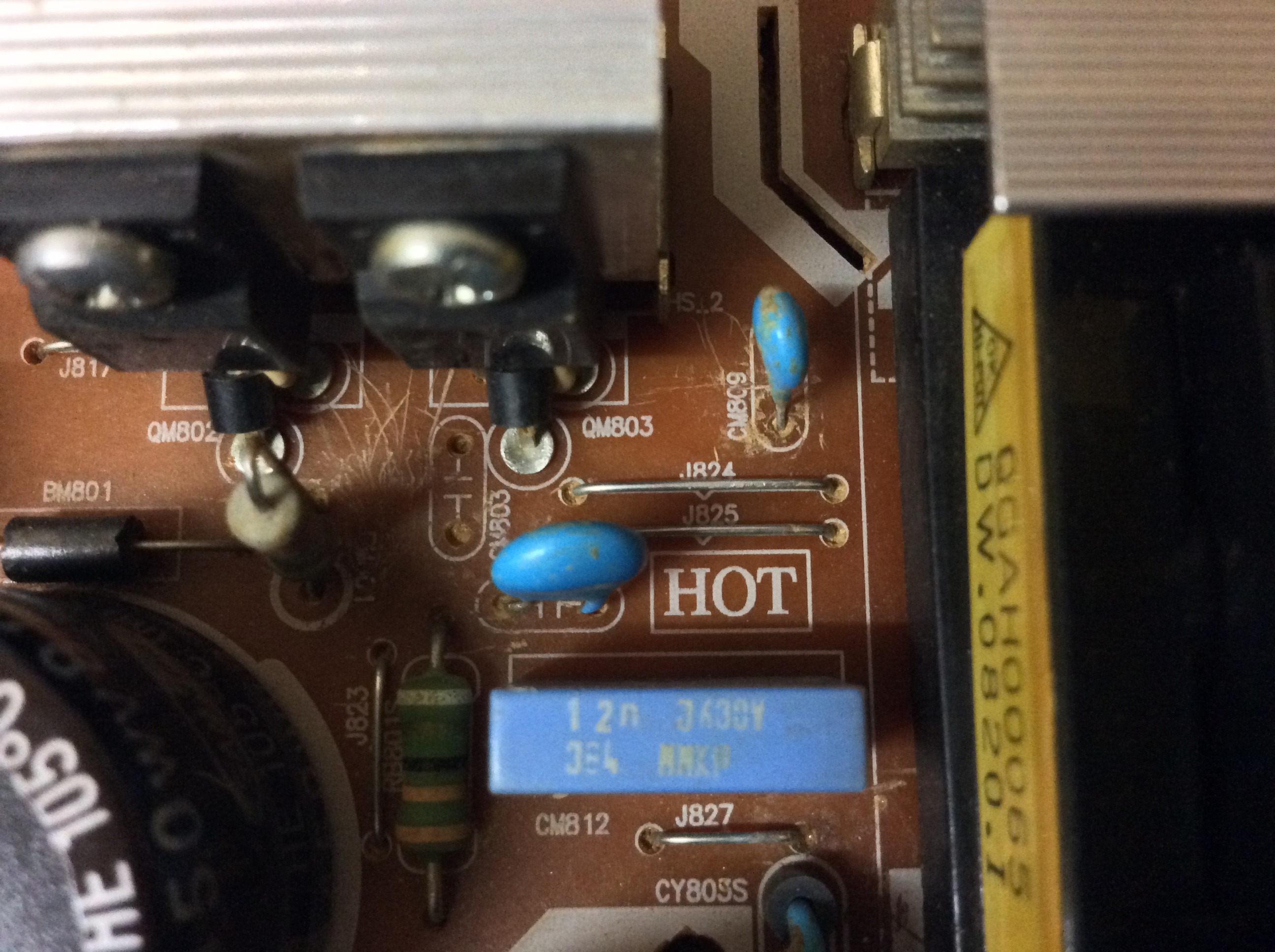

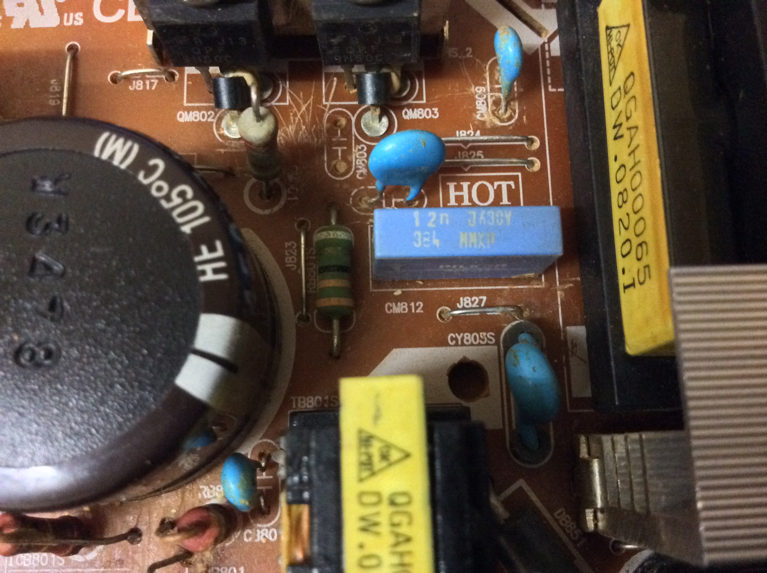

        It looks like you did not remove the glue on the 24V power supply high voltage section in picture #1 lots of glue on that blue cap which will burn out badly.
        This will happen if it not removed:
        https://www.badcaps.net/forum/attach...8&d=1390505083
        https://www.badcaps.net/forum/attach...5&d=1390505031
        https://www.badcaps.net/forum/showthread.php?t=34692
        The rectangular blue cap for the 24V power often lost its capacitance too which causes not to have 24VDC output.
          This is my question:
          Please can you give me an howto to remove this shitty glue?

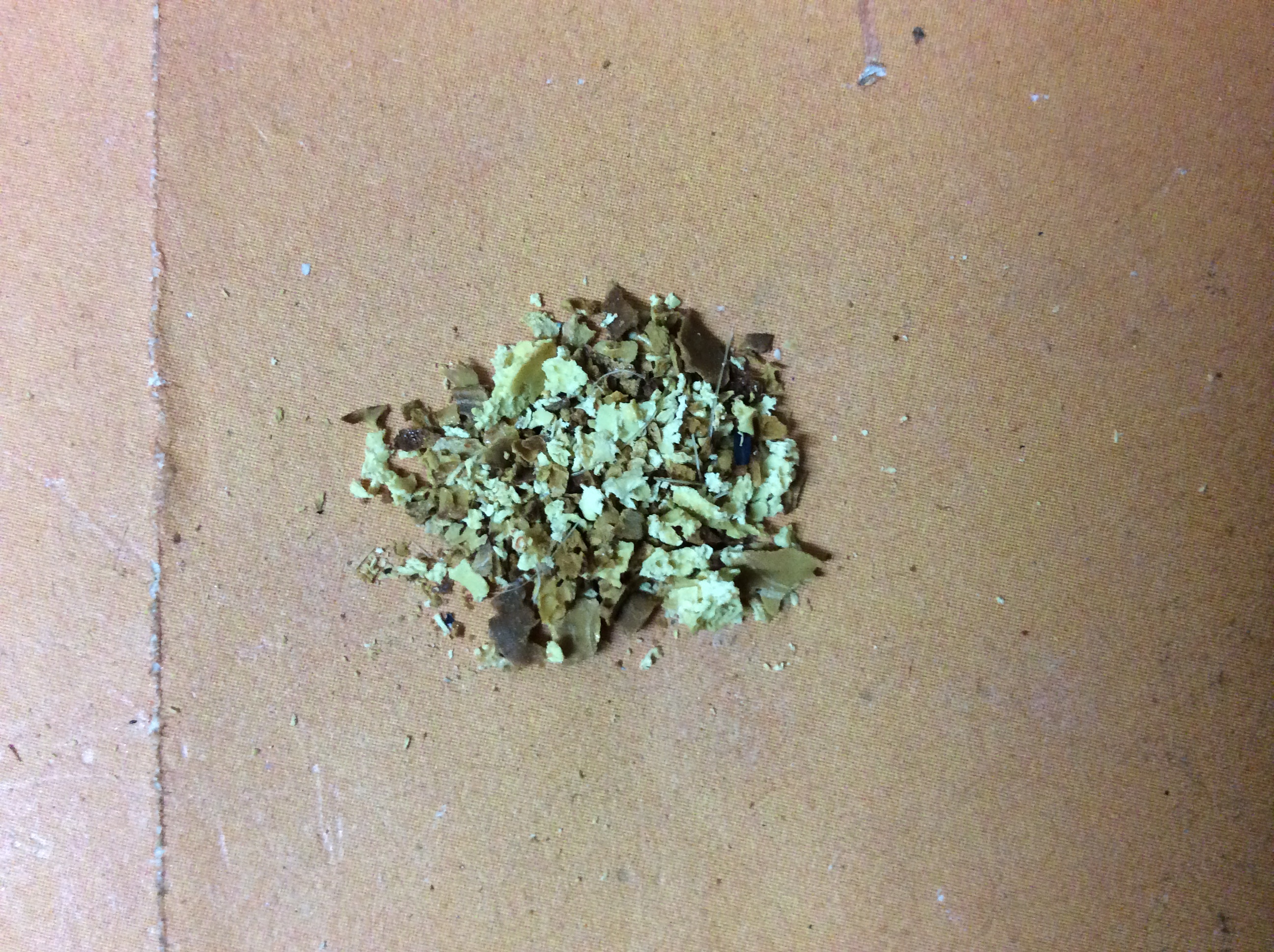

            after I waited a long time and no one give's me an direction how i can remove the yellow/brounish glue I try it self with ISO PROPANOL Alcohohl, Toothbrush and an little Clockworkscrewdriver. I hope i damaged my PCB not so many as it is.
            It takes about 2 hours and I use an magnifying glass. Look at the attached photos. It looks horrible but PCB Board is not so damaged. Today my new Multimeter will arrives to me and I can look closer and can measure.
            Hope now my work was not too bad.
              Re: Samsung Syncmaster 245 B+ not working
              I removed the hardened glue with small flat blade screw driver and small pliers, then use alcohol and stiff brush to get the rest off the board.

                Hi Every,
                I measured now.
                On the 5,4V pin I have 0.00
                On the 24V+ pin I have 0.00
                The biggest capacitor in the middle with 450V 82uf have 323V
                All other capacitors I had changed btw not the biggest one.
                Any suggestions?
