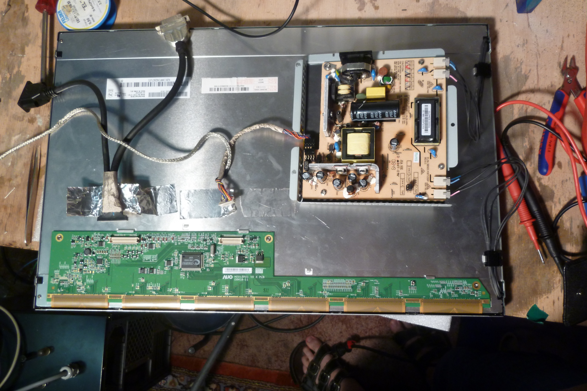

    I have an Viewsonic VW2010wb-EU (Modell No. VS11674). If I connect it to 230V-net only the LED lights orange (duo-LED, amber and yellow lights). It doesn't react on any key. So the light is permanantly on.

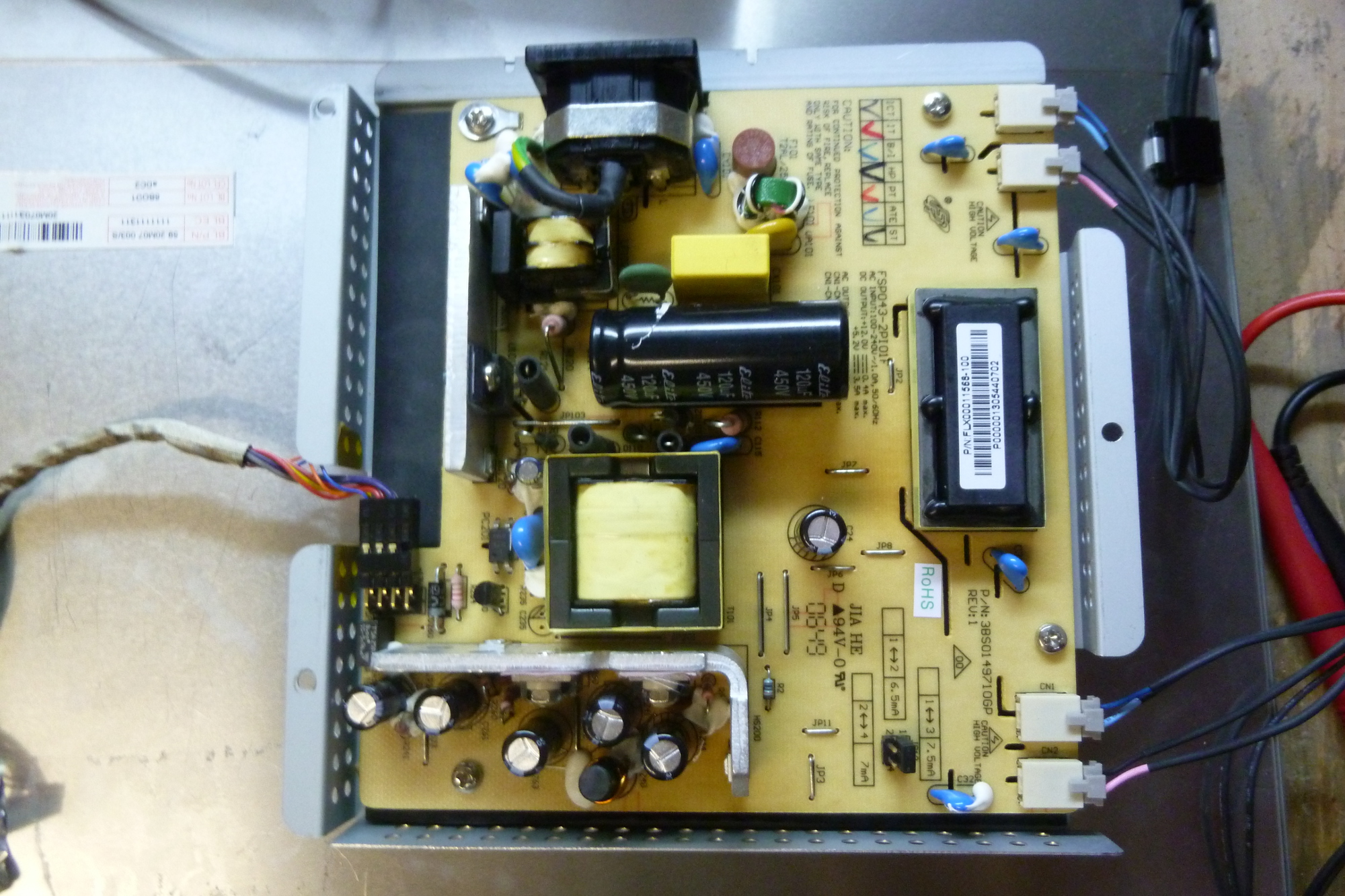

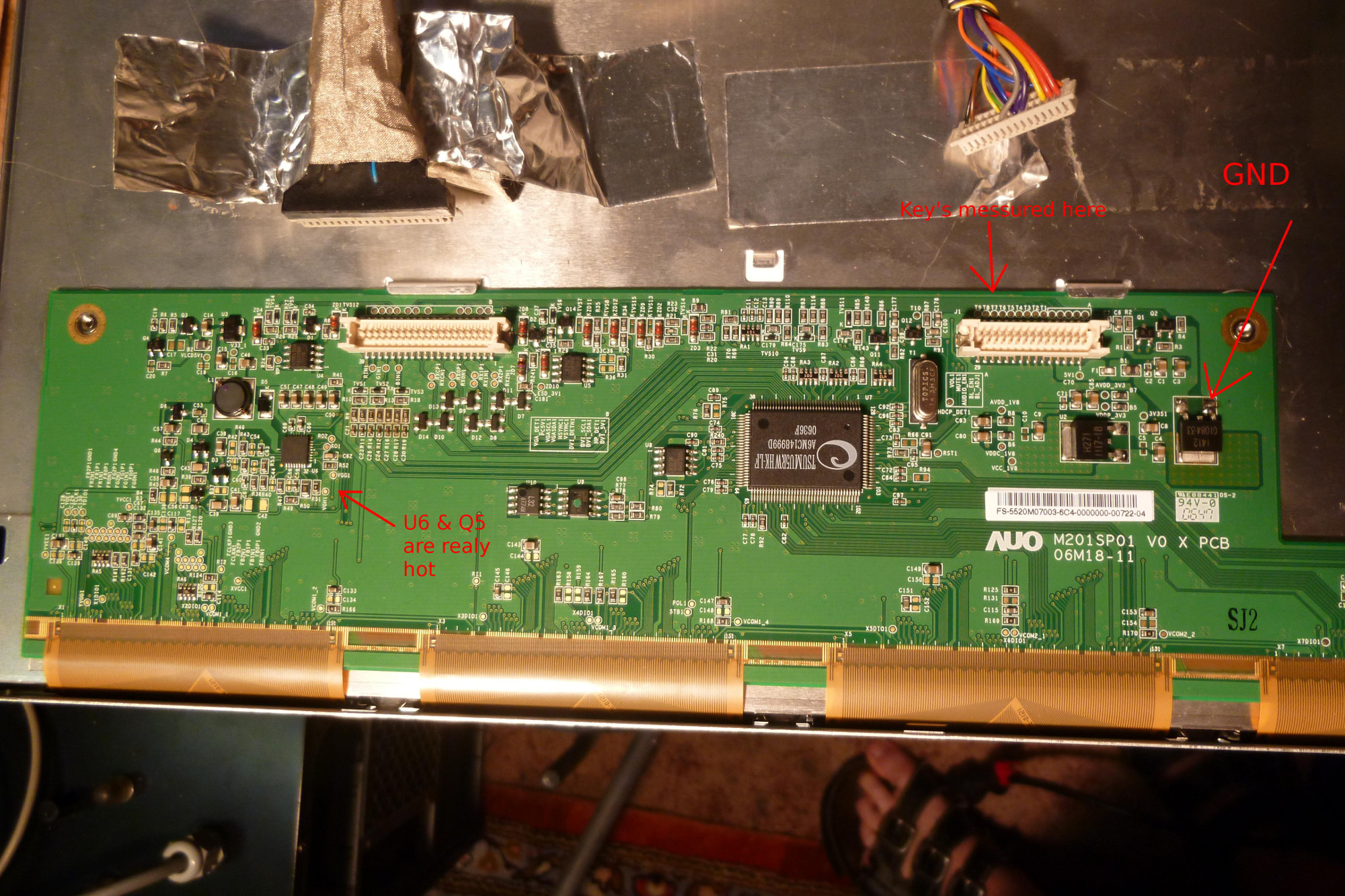

    The caps of the powersupply was swollen. The transistor Q5 and the stepup-controller U6 are realy hot. The PC recognize the display correct.
    I have done the following things to repair it:
    -change all caps of the powersupply (see picture, same capacity and voltage, low esr type, bought from local seller, i don't know which brand they are) -> powersupply seems to work ok now
    -change of the transistor Q5 -> no effekt
    -provide the 5V power over an external powersupply -> the same error as befor
    -disconnect the controllsignals for backlight an provide an external one -> the backlight works fine
    -messured the voltage on the crystal-pins -> oscillates at 14Mhz
    -messured the Signal of the keys -> they are ok; high if unpressed an low if pressed
    I do not know what I shoud do now. The schematics in the servicemanual I have are not complete. The part about U6 an some else are missing.
    Has anyone has an idea what the problem could be?

    Hier the Voltage that i messured at some (in my opinion) intersting testpoints. I used my oscilloscope, so the absolute precesision is about 100mV. If you need an precise value of a testpoint I can messure it again with my digital multimeter (precision about 10mV).
    5V Powersupply: 5.14Vdc 30mVac
    3V3S1: 3.36Vdc 6mVac
    VDDC_1V8: 1.83Vdc 4mVac
    V33_1: 3.56Vdc 4mVac (even though its named V33 a 3.5V LDO is used; in the schematic too)
    VLCD5V1: 5.01Vdc 50mVac
    RST: max. 50mV (highest peak)
    All the voltages are messured against GND (see picture).

            They are marked. In FSP043-...pdf they are on page 2 in sector D1 and named "DBRT" and "On/Off".
            The servicemanual shows the Pins on page 44 and named the signals BKLT_ADJ and BKLT_EN. The voltagelevel on both Pins is 0V. I think the controll-IC doesn't work korrekt and so the Transistorbases (service manual p. 44) of Q1 and Q2 were tied high about the pullup-resistor RA4 (service manual p. 47).
            But I'm not shure about the IC since the osscilator works korrekt.

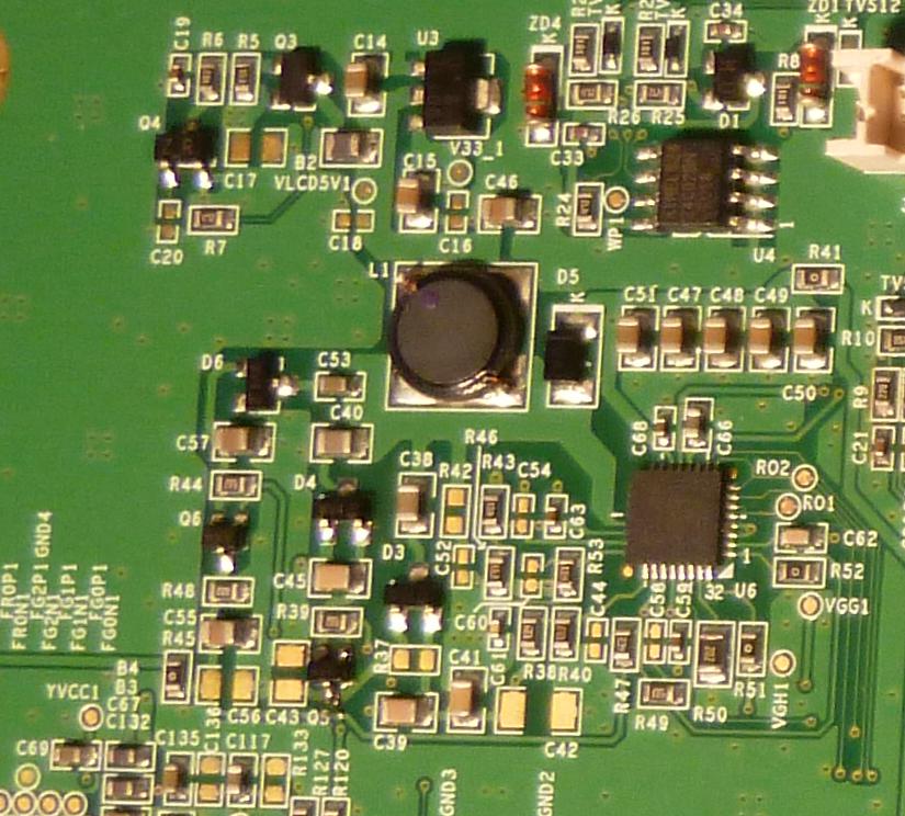

                  Can you do a close up pic of the area or Q5 and U6 and can you post the part numbers
                    Re: Viewsonic VW2010wb doesn't start
                    Nothing on screen, no menu, no picture.
                    Here is the areapicture.
                    U6 is an AAT1164 (datasheet in post 1). Q5 is an MMBT4403 pnp-transistor.
                    I dont think that the regulatorcircuit itself is broken. Either the Load is shorted or one of the externel components of the switching regulator. But I'm not shure. I have no schematics about this part.
                    The Board is part of the LCD panel. I have found a datasheet, no schematics. The only interissting page here is page 10. It shows the Functional Block Diagram. I think the DC/DC converter in the lower right corner of the PCBA is U6.
                    The panel is an AUO M201SP01 V0.

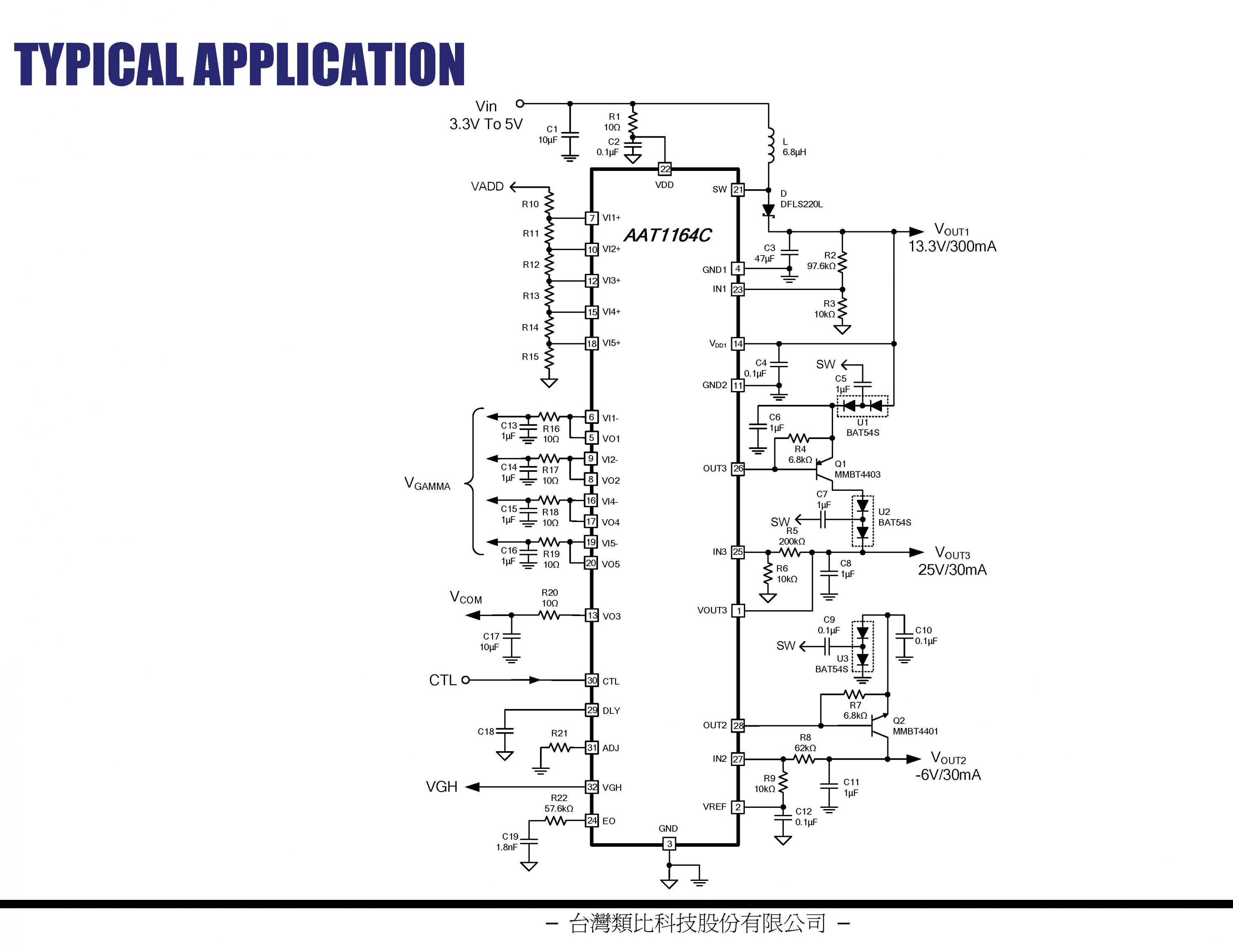

                        If you look at the application note page 2 of the ATT1164, you will see the two transistors Q1 and Q2 for generating the Vout2 and Vout3. I believe that Q5 and Q6 on your board are equivalent to Q1 and Q2 in the app notes.
                        So you need to see if the Vout2 and Vout3 as shown in the app note has low resistance (or shorted load that cause the IC and the transistor to over heat). You should trace out the connections which is more likely to be about the same as shown in the app notes.
                          BTW, this is the application circuit. You can also see 3 diodes and two transistors on your board in that section of the board.

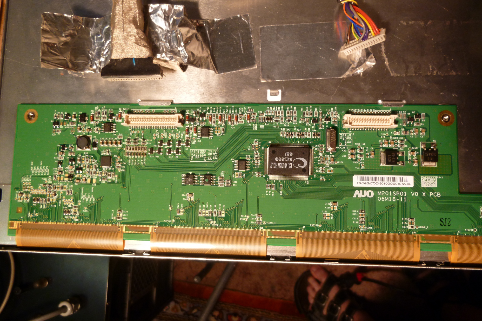

                                    It lives!
                                    The last 12 hours I spent in developing a flashtool for readout and reprogramm U8.
                                    At first I have seen that the vendor used an ps25lv010 instead of an sst25lv010. The difference is an reduced commandset. But this is not really a problem. I have read it out and found out that the first about 300 bytes were zero. After I reprogrammed it with the new firmware it was time for a test.
                                    The controls works fine, the backlight turns on and I see a picture.
