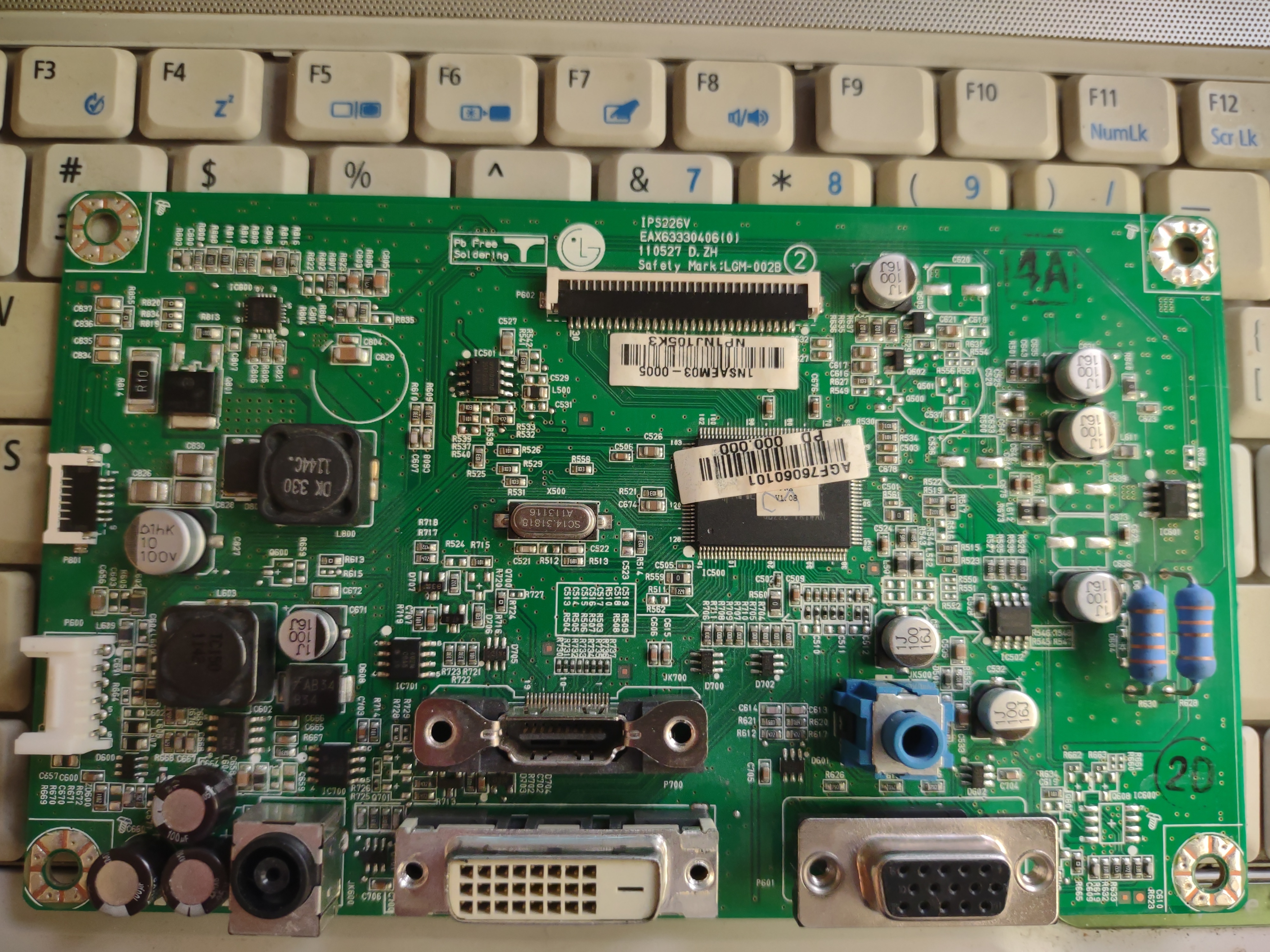

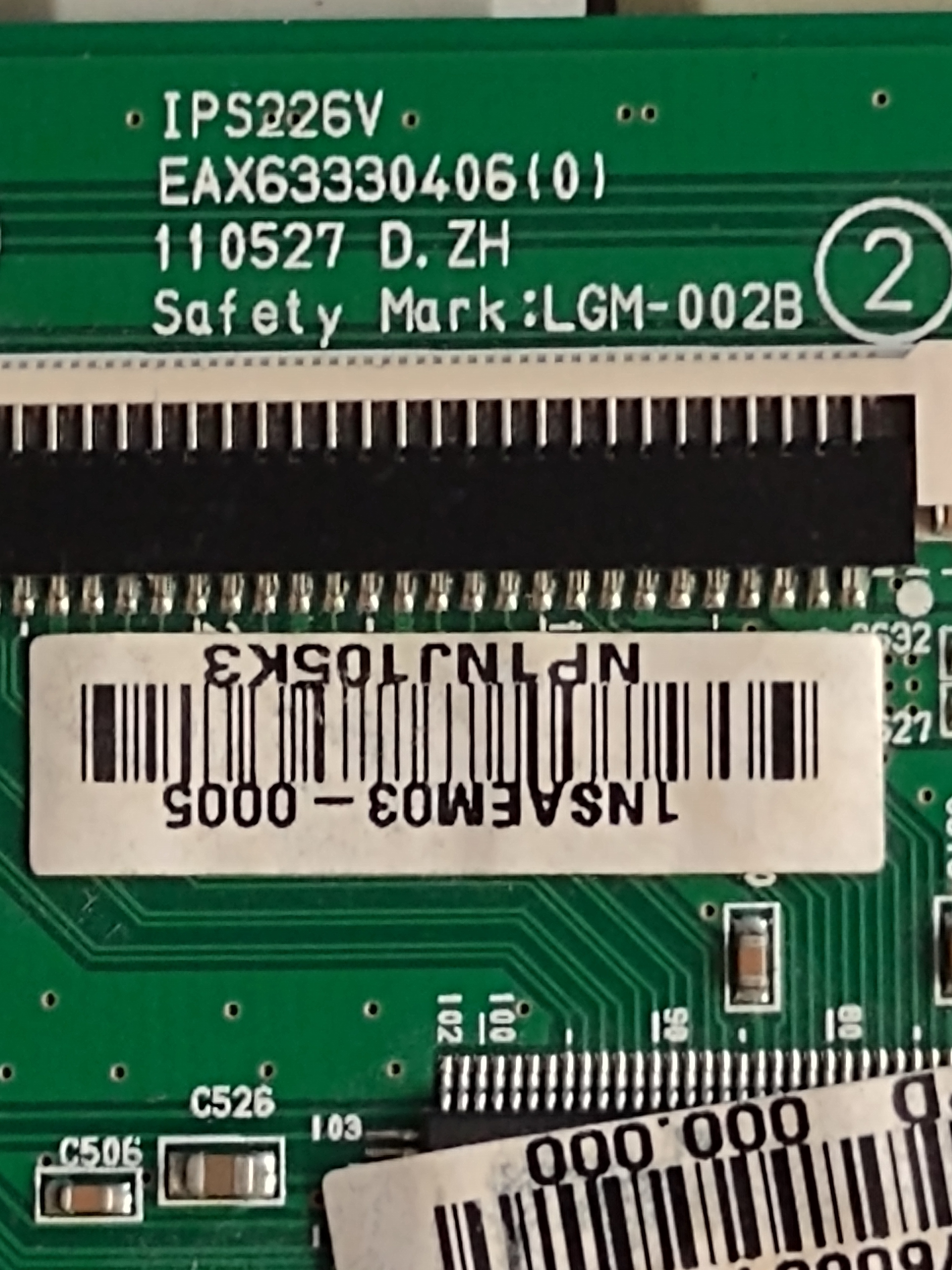

    hi...lg monitor is dead...it seems to have corrupted firmware...because it is assembled in my country it may have different model name around globe...i will send pictures of mainboard,lables and dump firmware that i extracted from faulty board with name old.bin...if you have exact board (its common on diferent lg monitores) please share it...thank you.
    ips226v
    EAX63330406(0)
    110527 D.ZH
    it has 25X20BW eeprom

    Try...dump EAX63330406(0)

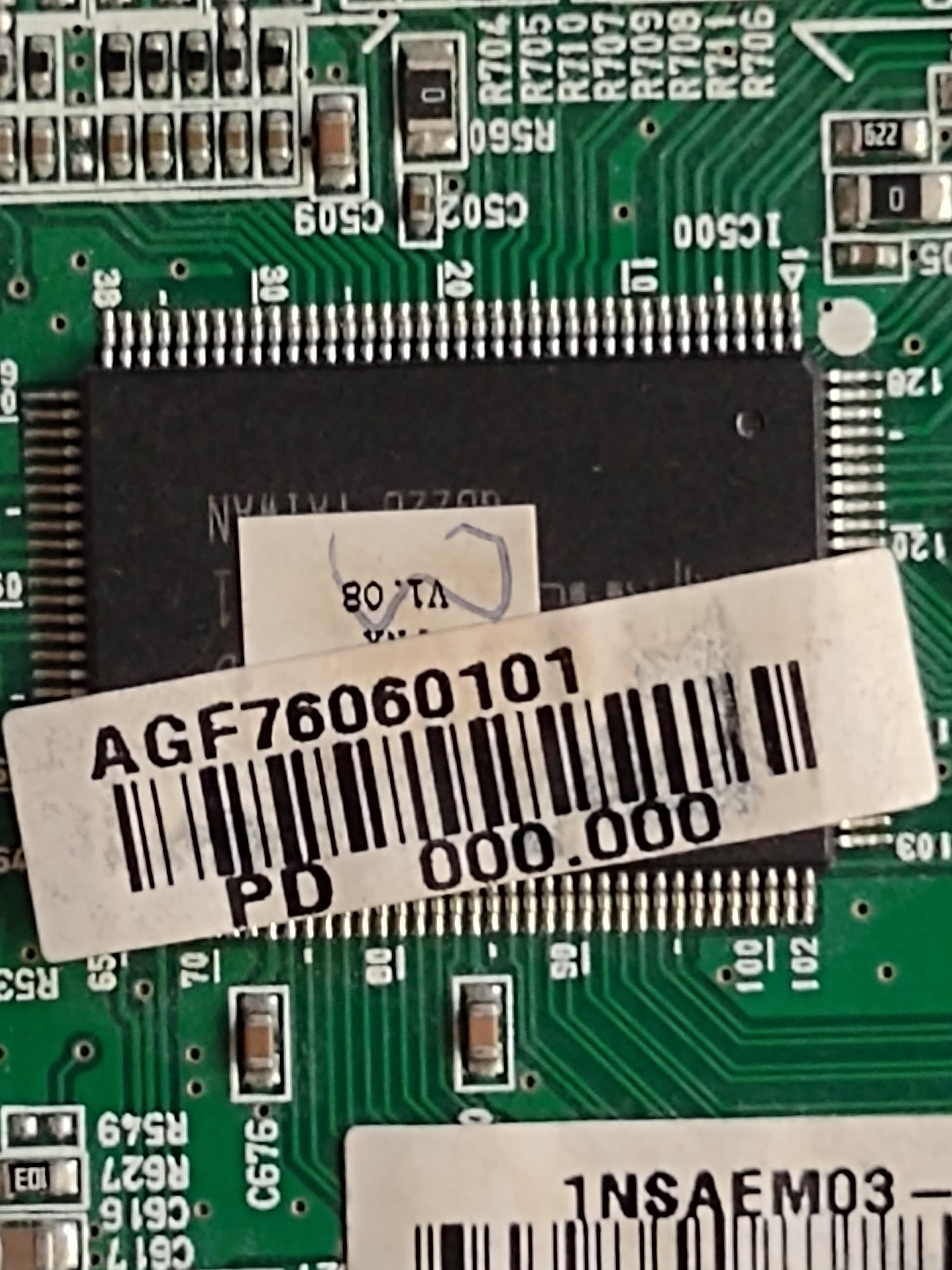

        many thanks for your time and sharing...i programmed with your files...both of them...i checked with my programmer software and it seems your files were for this mainboard however it doesnt turn on...i checked voltage on mainboard and they were ok...regulated voltages on cpu eeprom etc...perhaps culprit is cpu of mainboard...it is realtek (RTD24830D)...i have to replace mainboard if i can find it....cpu is not available in our market....again many thanks lotas.
