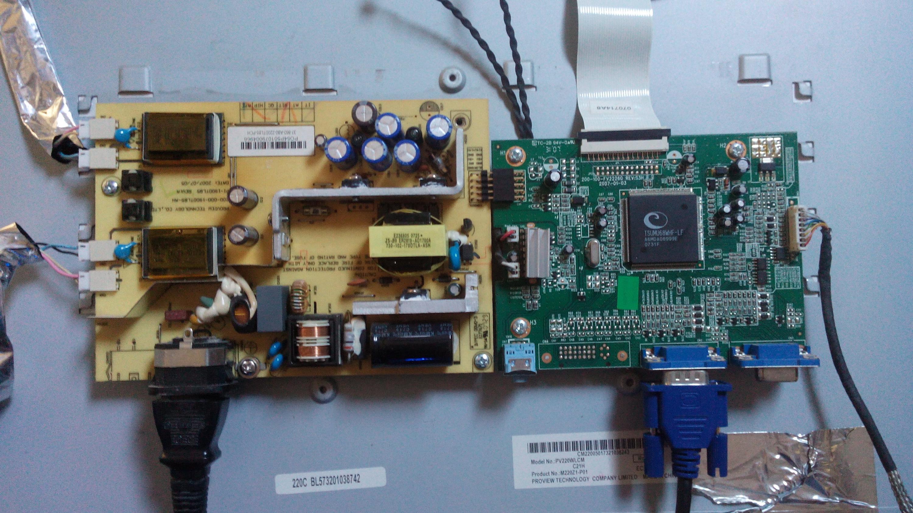

    Hello Members of Badcaps,
    Recently, I have bought this screen as defective. It is working for about 3 seconds and then it shut off (light keeps burning).
    And if I turn the brightness at low, the screen keeps working. I have attached a picture of the two boards.
    Any capacitors recommend to replace? There is also a high pitched noise from the power board.
    Thanks for the help,
    Joris
    Re: Packard Bell Maestro 221W
    I would recommending replacing all 9 lytics caps (the big one is probably OK) on the power supply board.

        Thanks for the help but after replacing all the electrolytic capacitors (include the big 100uF) the problem still occurs. The high pitched noise is still there but only in standby mode.

            If I switch the lamp lit connections, the problem still occurs.
            The noise is coming from a small capacitor left under to the yellow transformer (222K 1KV).
            Can this capacitor be the problem? And the value is 2200pF?

              May be a symptom rather than cause - yes it is 2200pF 1KV
              Can you post a picture of the bottom of the board. It needs to be really clear so
              do it it in halves or quarters if it helps to get it clearer.
              I think it may still be a problem with the bulbs - another test is try one bulb at a time
              and see if it flashes ( this is only a test for totally broken bulb which will not flash at all
              they will not stay lit but will jsut flash if not totally broken )
              When the bulbs are not taking any power that can cause the squeal.

                That's 2200pF or 2.2nF, with 1kV voltage rating. The symptom sounds familiar, reminds me of those HP w2228h (can google for this monitor's buzzing/hissing issues, plenty of them). A "singing" capacitor at the snubber section. Usually a lone standing ceramic disc type. Its called microphonics, and usually occurs with Class 2 ceramics (especially those cheap and poorly contructed ones). You can replace this with a better ceramic capacitor (such as those Murata safety high voltage ones), or with a metallised film capacitor with the same ratings (higher voltage rating recommended). As for the lamp going off, check the MOSFETs or transistors driving the inverter transformers. Also check the resistance of the inverter transformer secondary windings. A bad inverter tranformer and/or a failing MOSFET can cause lamp shutdowns...
