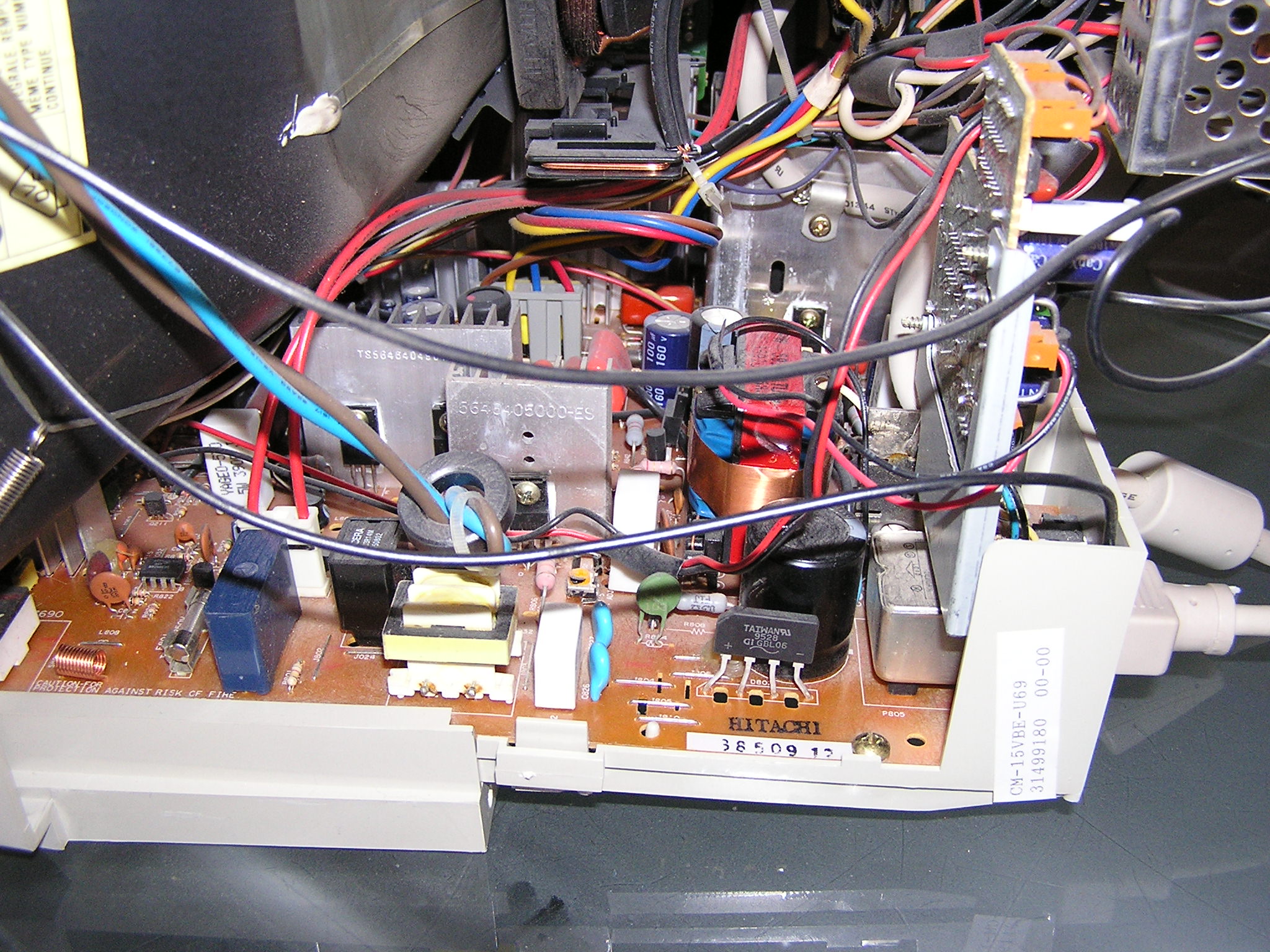

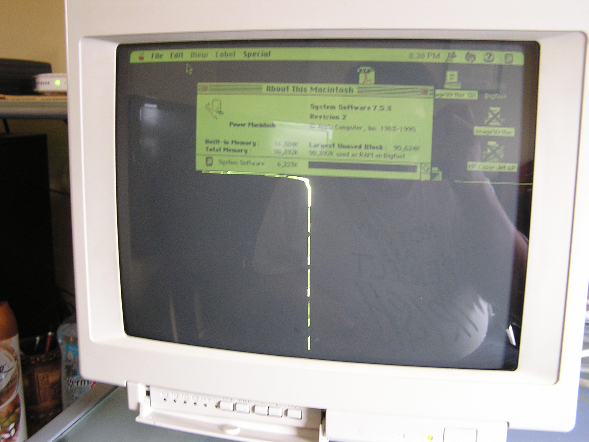

    Greetings, I will let the photos do the talking. It produces a loud high voltage buzzing noise, I heard a popping noise once and then the picture shrunk and then came back.
    I would like to repair this. Thanks for any and all help. Model is M2943 15" Muilt-scan. It's made in December of 1995 from a Mac 7200/100.

    Test all the hi-voltage 100-350V Caps in the power supply and Horizontal Output circuits....Most likely in the switching power supply circuit

      Andrew, do you mean to remove and test or just test for voltage? Were is the Horizontal output section?

        Problem solved:
        Bottom half of screen has no hori sweep. LED lights both green & amber. A: C001 470uf 16v on power saving dboard on right side of chassis.
