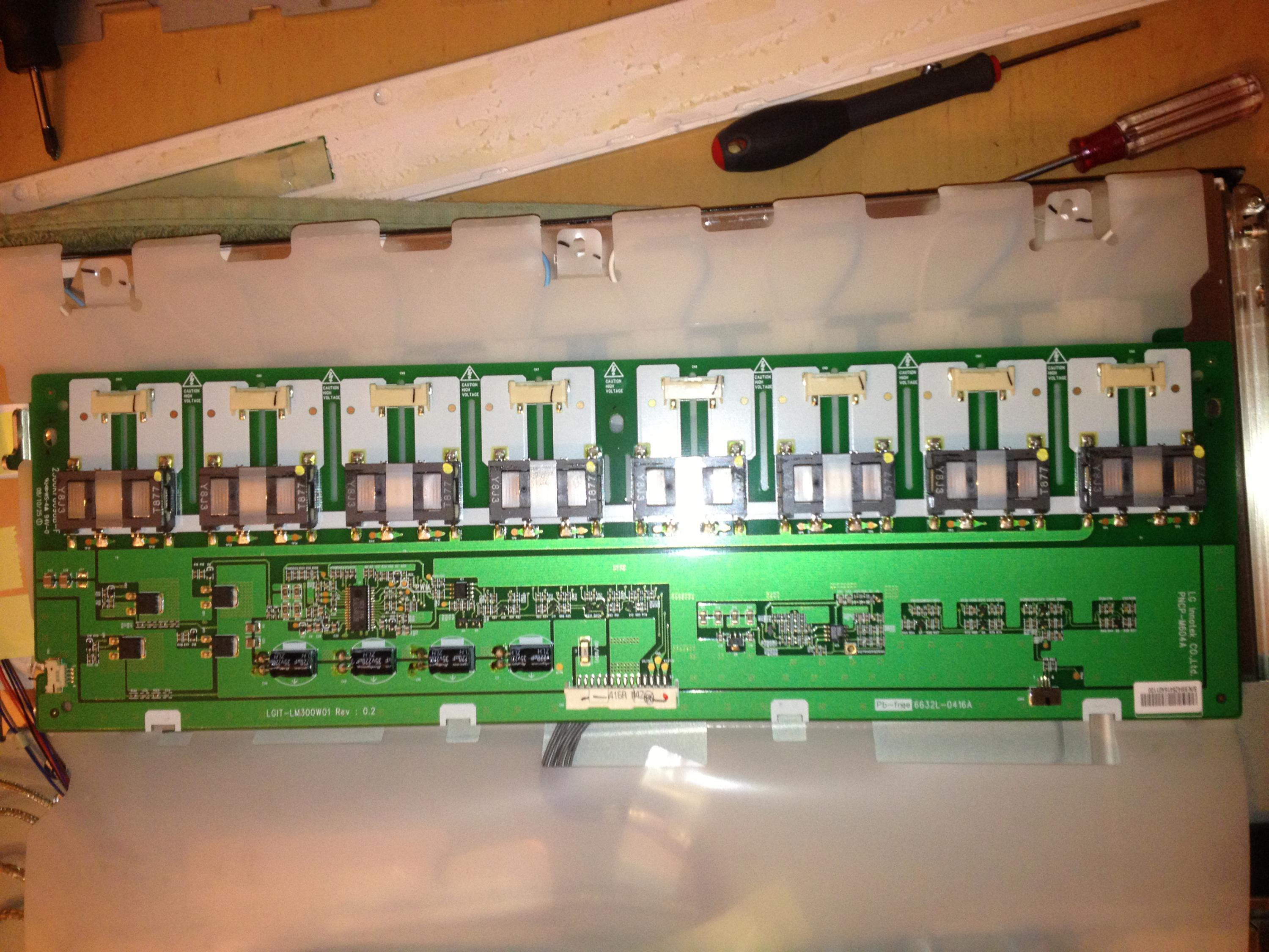

    Apple LCD 30 Turns off
    30-inch Apple Cinema HD Display
    M9179LL/A
    Problem soon as it is powered on
    Switches off striaght again.
    Then have to disconnect and reconnect power and same thing.
    Have isolated power to inverter board.
    Had a donor machine to swap boards with,
    Pictures attached

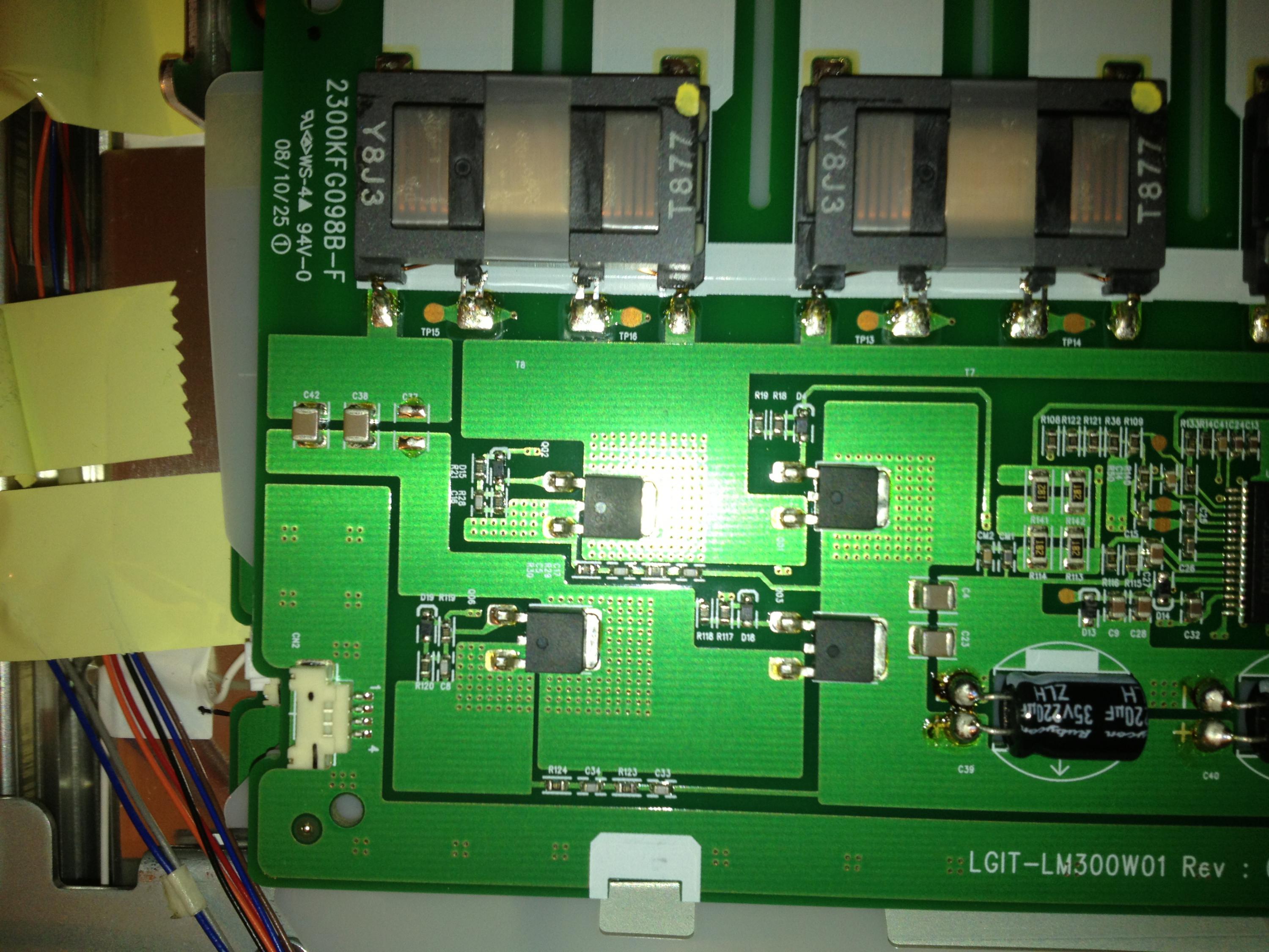

      Re: Apple LCD 30 Turns off
      Checked the Tcon board, everything is ok on that.
      Problem is on the invertor board, have been swapping out the boards to see which had the problem.
      Its on the inverterboard (shown in the pics).
      Caps look ok,
      Guessing problem is the caps or the mosfets ?

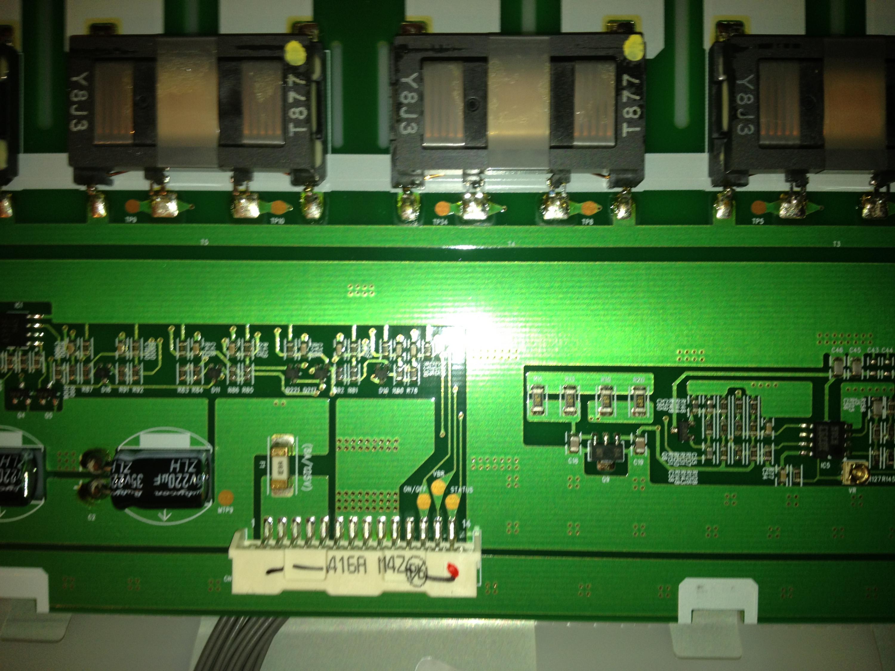

          It switches off or it goes black ??
          If the inverter is a problem the power led should flash 2 short flashes and 1 long flash. does it do that ?
          Does the screen light at all for a second or two ?
          this looks like the 2007-2010 model board.. which is not as good as the older model boards because everything works on one zone which means if one part goes, the whole thing stops working. The older ones were in 2 and 4 zones which was a much nicer setup.
          Check to make sure that the small wire at the small plug of the inverter is ok
          If you have a voltage tester, see if you have 3volts on VBR and 5 volts on pwr/on
          check the fuse for 24 volts on both sides
          if these are ok, you may have a bad transformer.. with an ohmmeter check the two pins on the bulb plug side for resistance. compare each to the other transformers to see if one is reading lower than the rest.

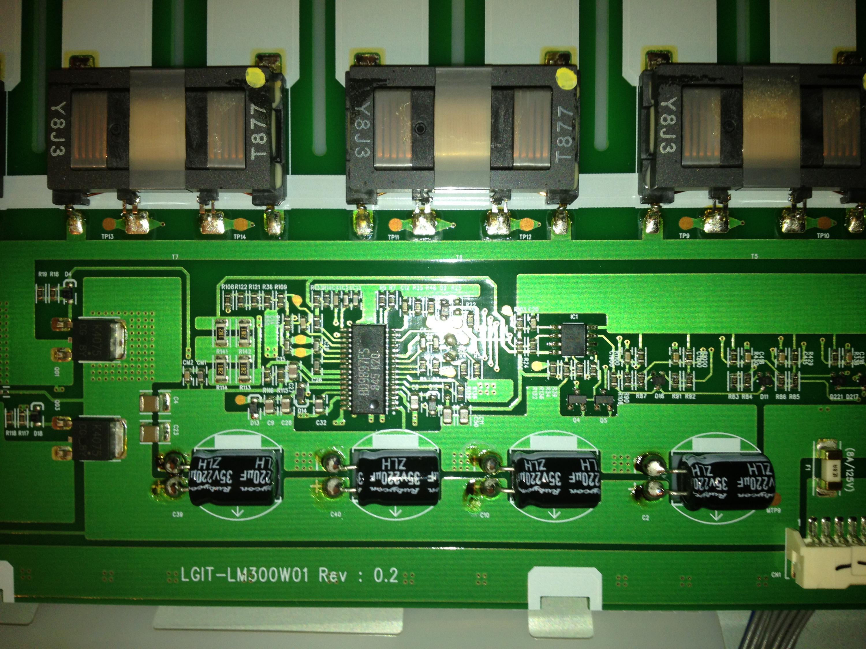

            • jetadm123
              • 2169
              Looks like you replaced the 4 caps with ZLH caps. So, we know the caps are not the problem. Possibly a shorted mosfet or bad winding on one of the transformers.
