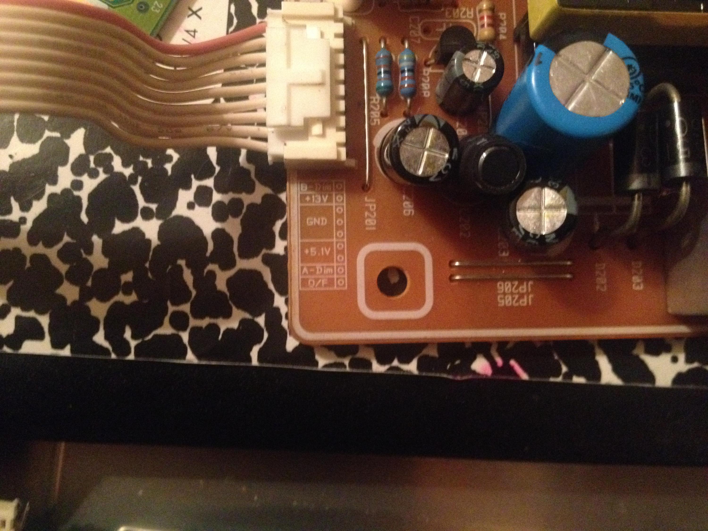

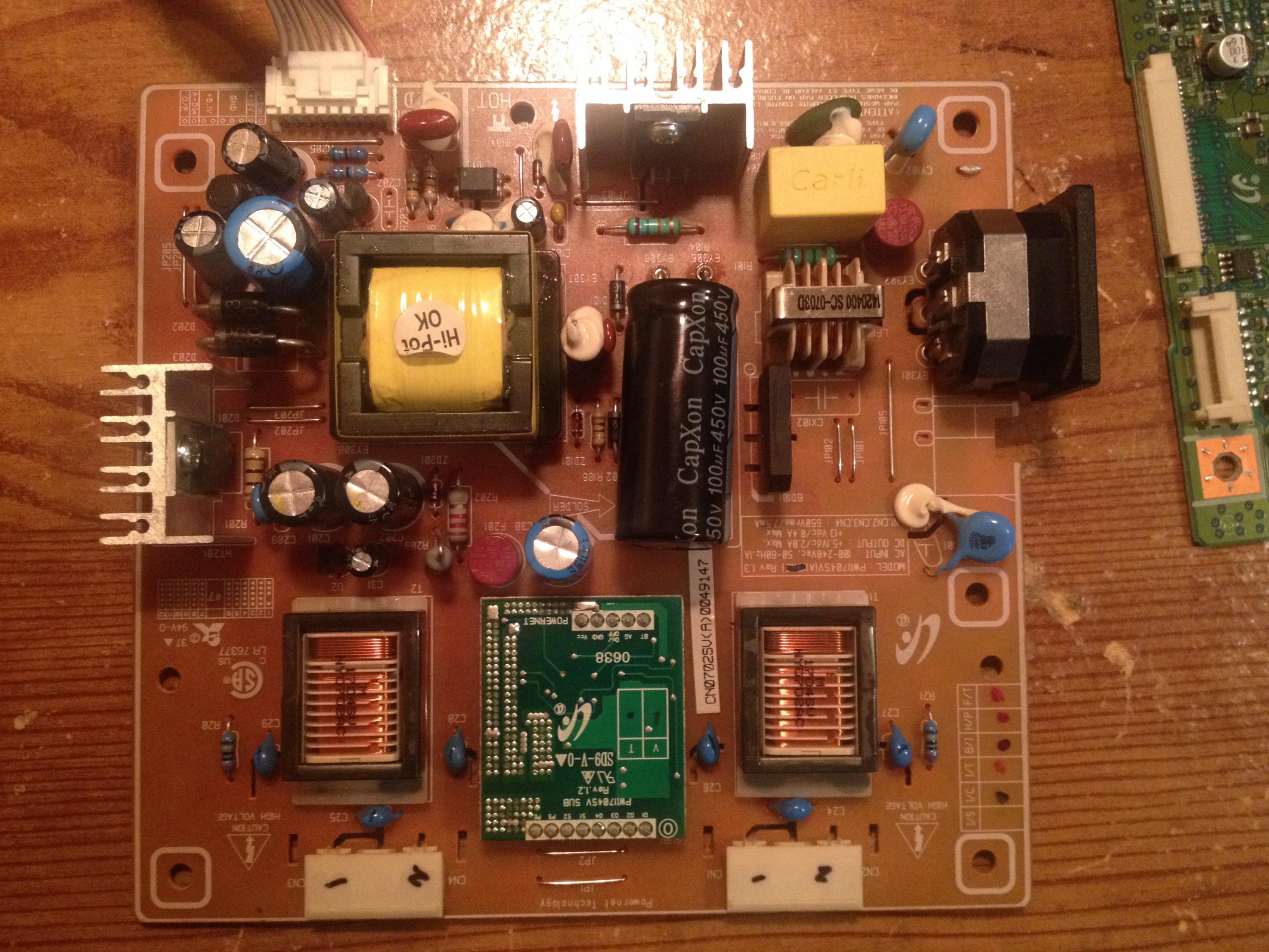

    My Syncmaster was having trouble starting same times take 5-10mins to come on, then one day i turn it off and it wouldnt come back on.. So I immediately thought it was a blown and i took it off and it sure was.. So i replaced those caps still wasnt getting any power or blue Led..
    i think the power supply is good, but im still new so im not sure
    CN201
    2.86
    15.05
    GRD
    GRD
    GRD
    5.14
    5.14
    0.13
    0.13

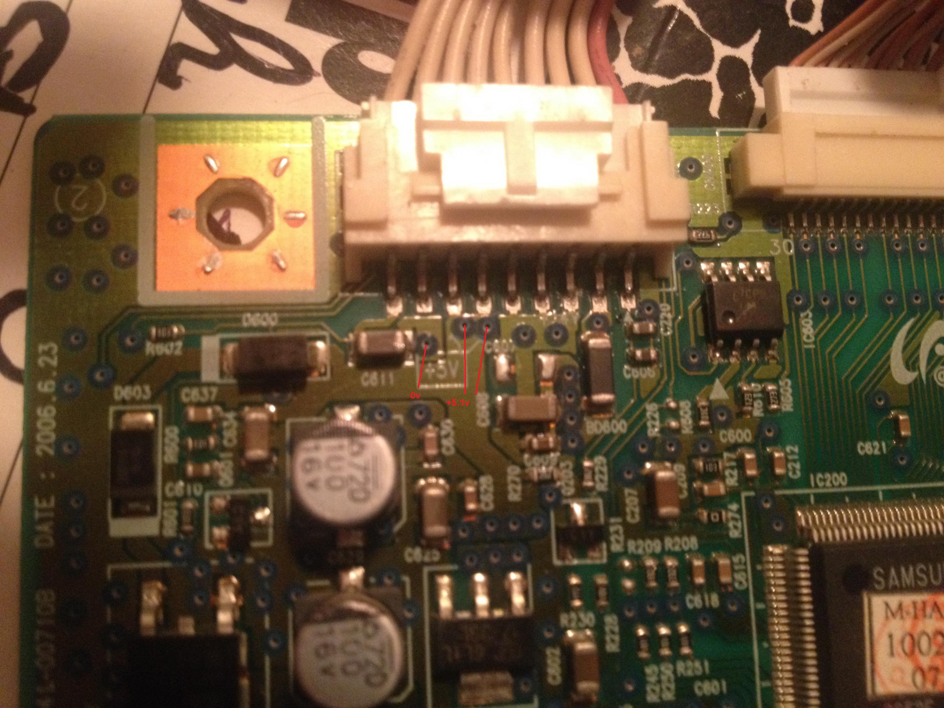

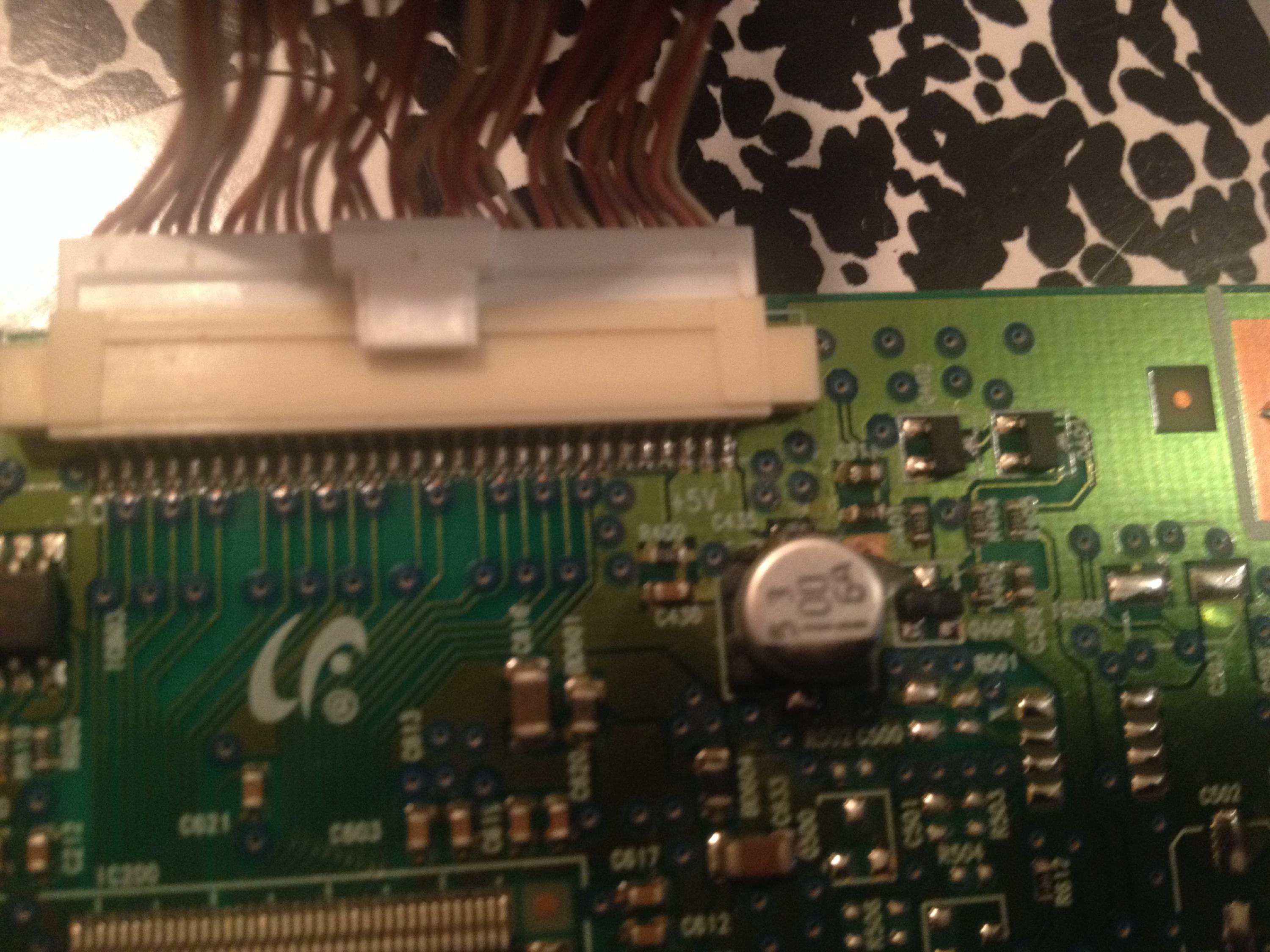

    and on the Main board all test points on back in white box are the right voltage expect for one on the front
    CN400
    Pin 1 should be at +5v (says the marking on the board) but getting 0.01
    anyone point me in the right direction.. would like to learn and fix it instead of buying the board

      Re: Samsung Syncmaster 940BW
      CN201
      2.86 (B-DIM)PWM Dimming signal
      15.05 (+13V) un-regulated (also used for the backlights inverter circuit, and since the backlights are not on the voltage is high)
      GRD
      GRD
      GRD
      5.14 (+5V)
      5.14 (+5V)
      0.13 (A-DIM, Analog dimming)
      0.13 (O/F) for backlights on-off signal to the inverter circuit, >2V = ON, <1V = OFF).
      So your power supply is OK.
      CN400 +5V is the switched 5V for feeding the T-CON board on the LCD panel assembly, in standby mode = 0V, when monitor is turn on and PC signal is present, then it will be turn on and supply 5V to the T-CON.
      The question is, before replacing the caps, you were at least be able to turn it on with several tries, but now after the caps replacement, you are no longer even get the power LED to come on. If that is the case, then I would the inspect your works very closely and any wires an connections.

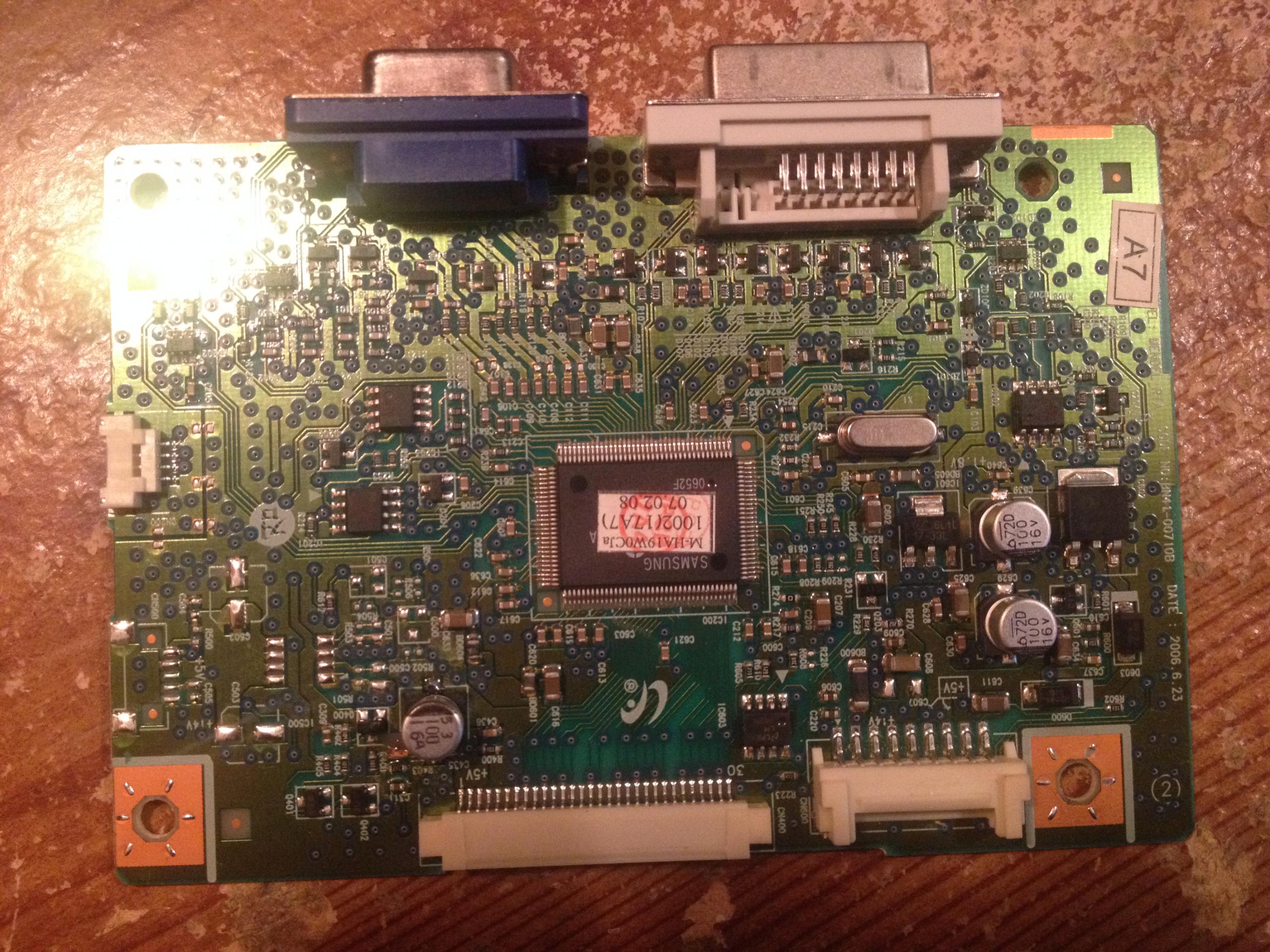

                gonna do a recap right now. already have some smd for it..ill let you know

                  did a recap on main and still no power

                    but the regulators check? Place the - terminal of dmm around the screw hole, then report each of the 3 pins of the reg. IC601 IC602, then with power off check in diode mode D600 D603, i don't think that you will find the culprit in theese but give a try..

                          ic601
                          1. 3.75
                          2. 1.80
                          3. 0
                          tab. 1.80
                          ic602
                          1. 5.14
                          2. 3.3
                          3. 0
                          tab. 3.3
                          d600
                          4.45
                          5.14
                          d603
                          4.45
                          3.76
                          • Davi.p
                            Hobbist Tech
                            • Sep 2009
                            • 4367
                            • Italy - Milan
                            regulators are good sorry, i think you have a software issue and is too hard to repair for me, as a desperate attempt try to access the factory menu by from off state keep pressed 2 of the keys then press power, another try can be hook the mon. to a pc and see if it recongnizes, then start a search for a sw to update firmware through vga cable, i don't know if it has some sense, try to reset the user setting by shortcircuiting some pins, (tell me all the p/n of the 8pin ICs), last try to find a replacement mainboard.
