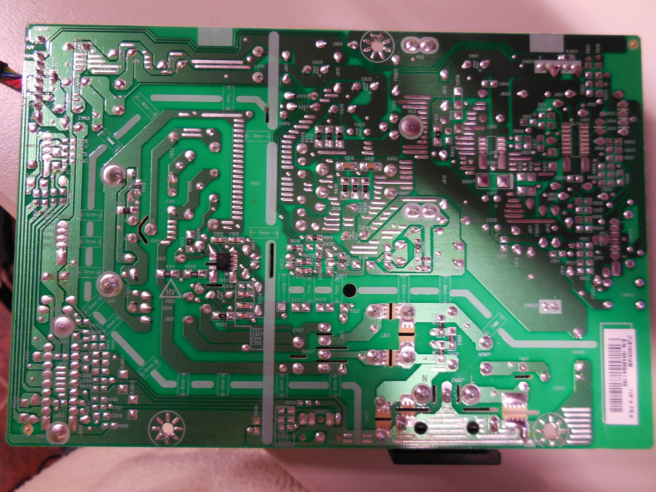

        A member with a 2407 found cold solder joints on the mains input. He resoldered those and replaced all the caps (except the big one)with low esr ones.
        Can you post good clear pictures of your power supply board - both sides.

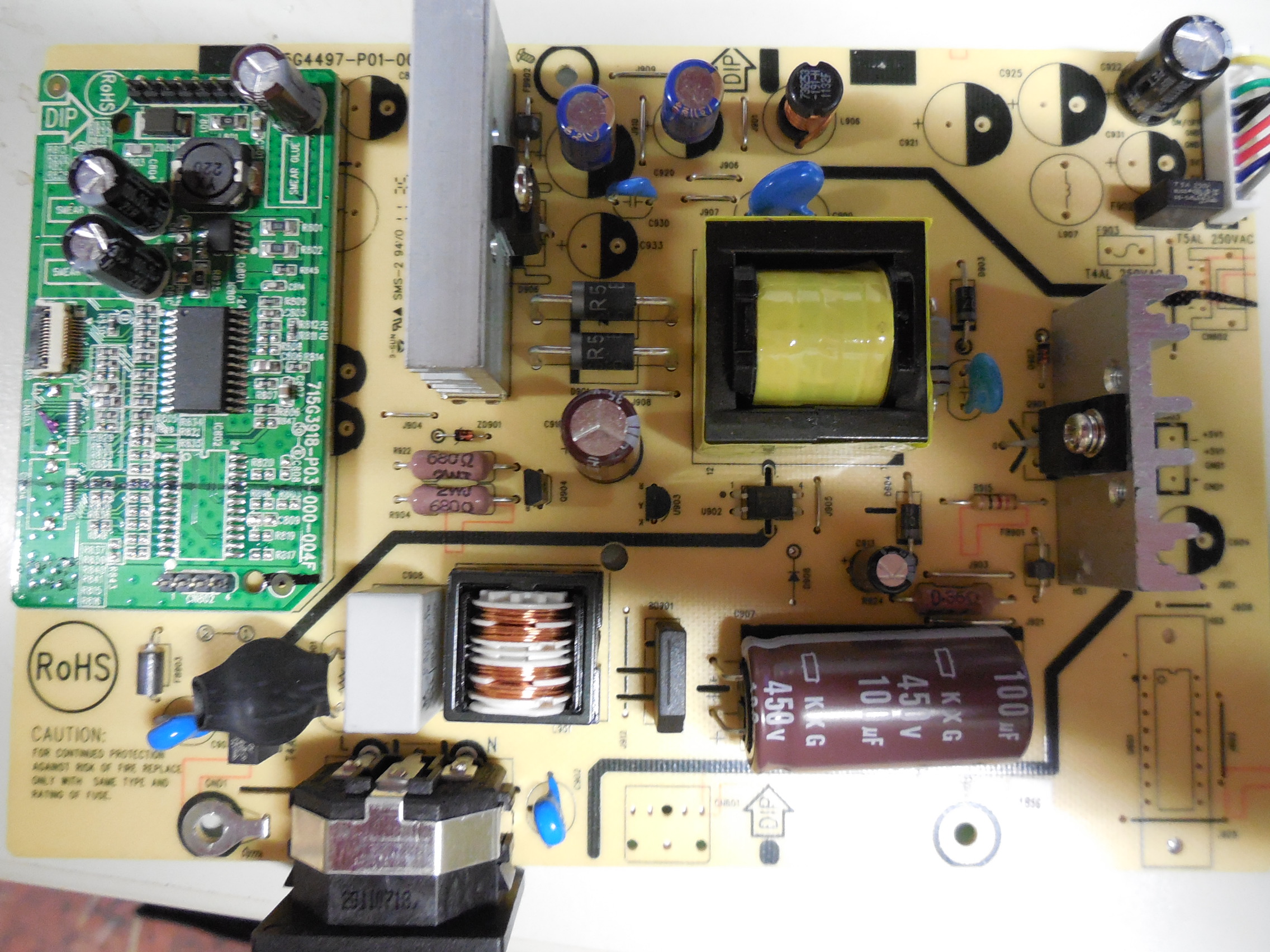

              Re: Iyyama Prolite E2475 - 2 seconds to black?
              Here are some pictures.

                I aasume,as I cannot see any Backlight connectors,that there is a separate Inverter Board ???and if that is the case, then does the Power led stay on if you disconnect that??

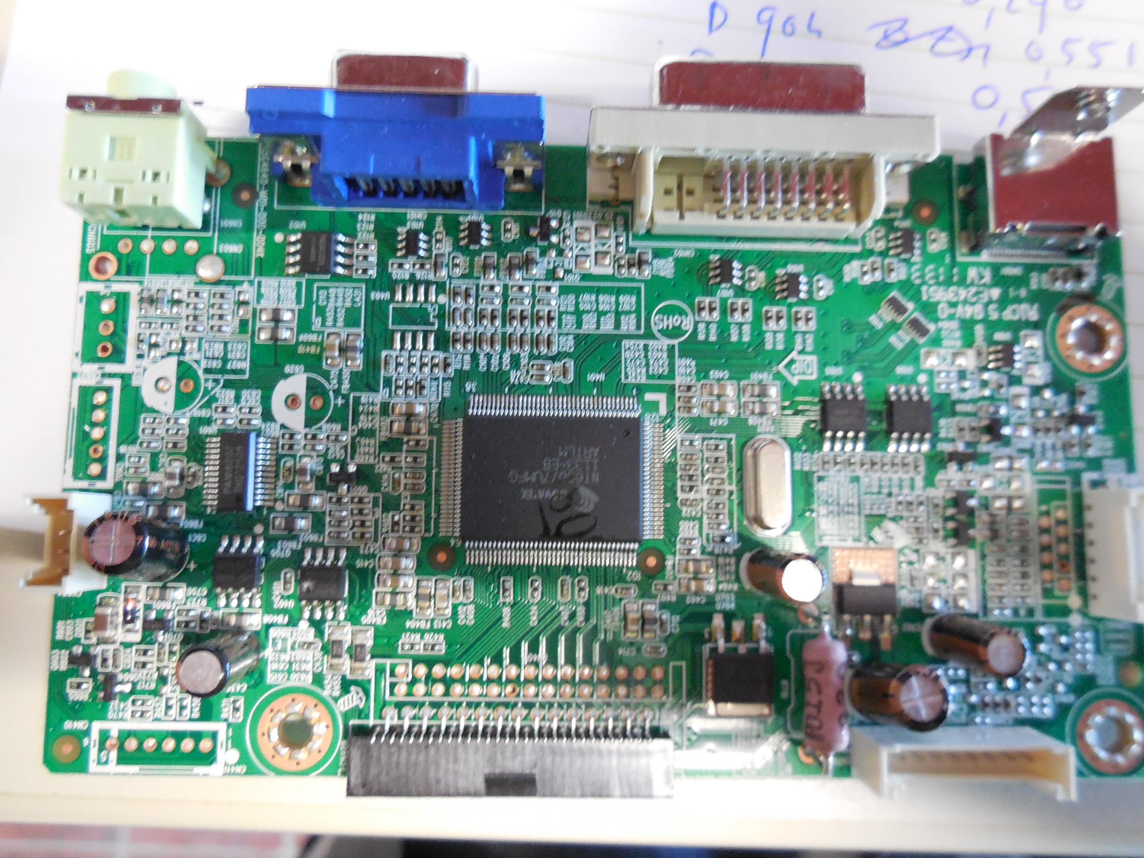

                  It's a LED screen so i dont think it has an inverter, there are only 2 pcb's in the display, i added a picture of the second pcb.

                      Maybe a component that can open with heat is the thermal reristor near the input of the 220vac, the one with heat shrink tube.
