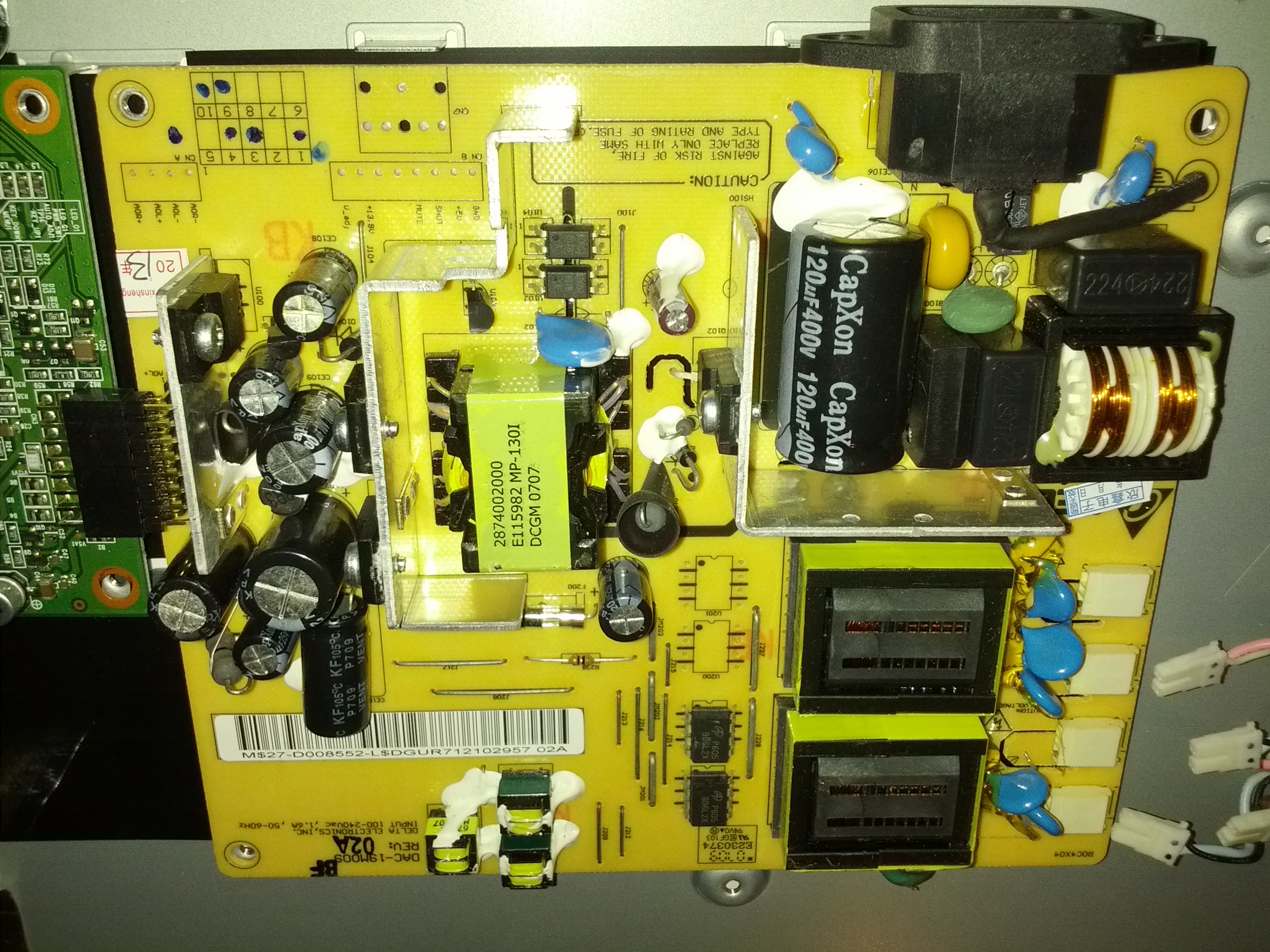

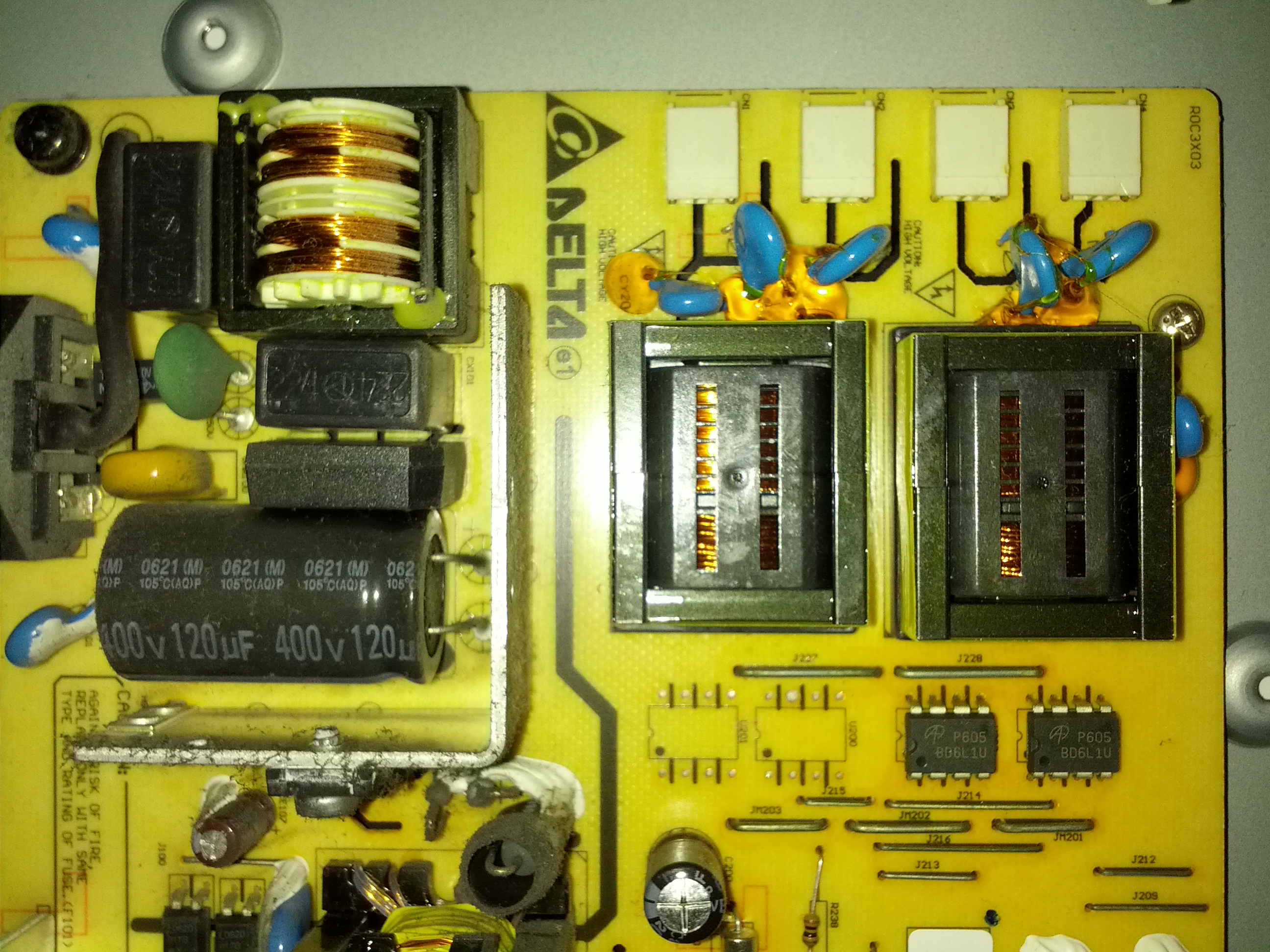

    I have experienced this "2 seconds to black" problem on my Acer AL2216W monitor a while ago and found this forum among the google search results.
    It took me a few weeks to find enough courage to open my monitor and look inside. I had tinkered with my PC when I was much younger but I had never opened a monitor and so I was a bit scared.
    But everything went ok and so here are the pictures.
    To any expert who reads this, I am totally unable to see anything of interest in the pictures, so if you can, please express yourself
    If the solution involves replacing bad capacitors (the website is called badcaps after all), I must admit that I don't feel quite up to the task. I don't have a soldering iron and have never used one. I am not sure I can manage to do this properly. And so I am more inclined to buy a new power supply board (or is that a mistake?).
    I had a look on ebay and I found a few but it's very misleading. Mine says clearly DAC-19M009, but there's none of that type on ebay. There's a few DAC-19M010 here and there but would they work with my monitor?
    Also, another website shipping these boards from mainland China shows products that seem to replace the whole family of DAC-19M0XX boards. I mean you can't buy specifically a DAC-19M009 on that website, or even a DAC-19M010, but you need to trust their "one-size-fits-all" product to replace whichever one you've got.
    Does that sound familiar to anyone?
    Could I replace my DAC-19M009 with another one, and if yes which types are compatible?
    That's a lot of questions, sorry but I'm absolutely new to this field...
    Thanks a lot for your attention!

    This might sound harsh but If you dont have a soldering iron and cant even be bothered to dust your boards down before photographing I think you are wasting your time -and ours.
    Assuming you have read the "sticky" guide to 2 seconds to black at the top of this forum you can see the many tests involved in establishing possible cause.
    Without doing the tests we cannot tell you what might be wrong but if you simply want to swap out boards in the hope that the problem is not with the bulbs then ask
    the seller of the board if it will replace the one you have- email them a picture and a close up of the board label area.
    There does appear to be some bulging to some of the caps but its not always easy to tell.

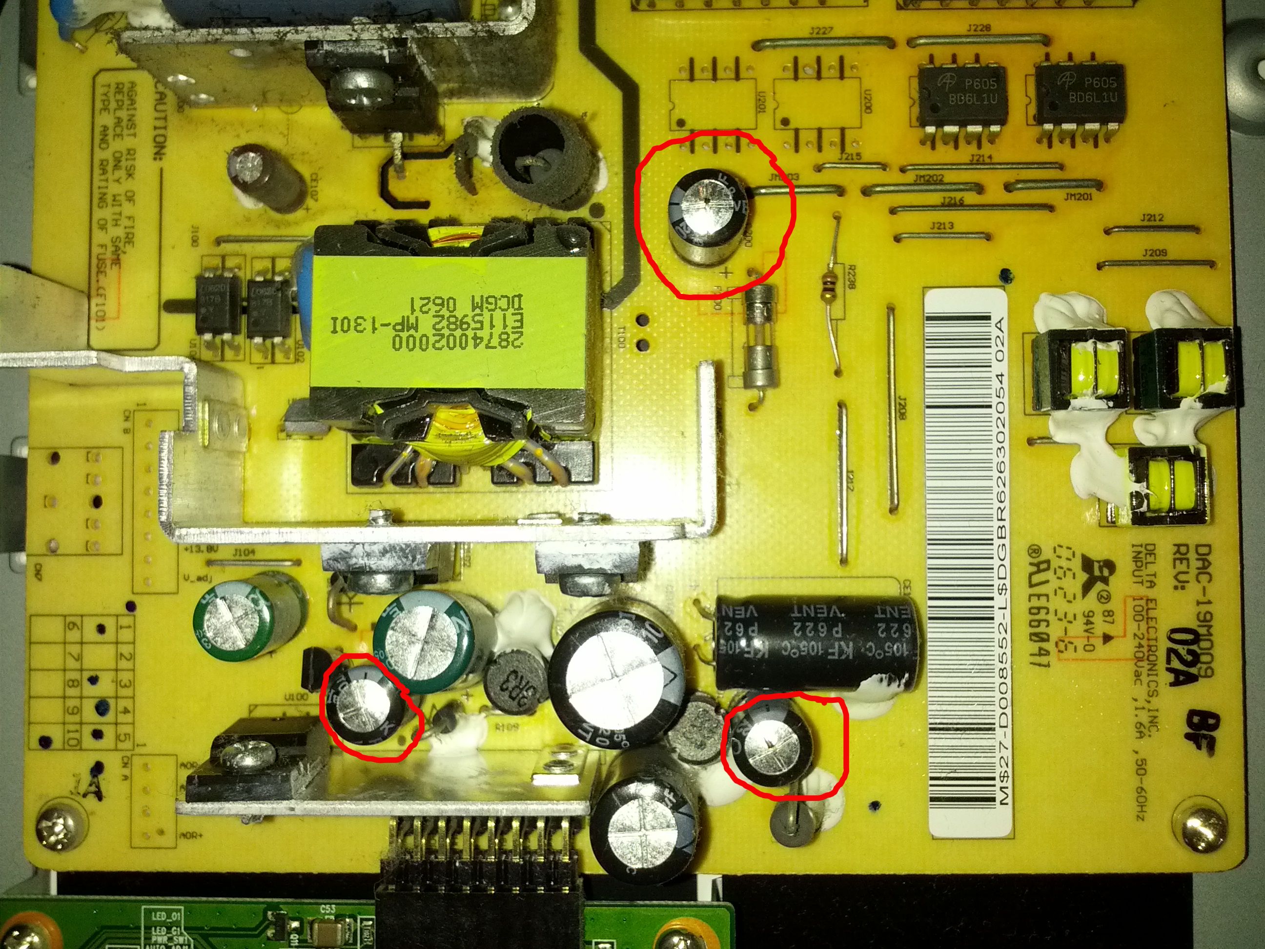

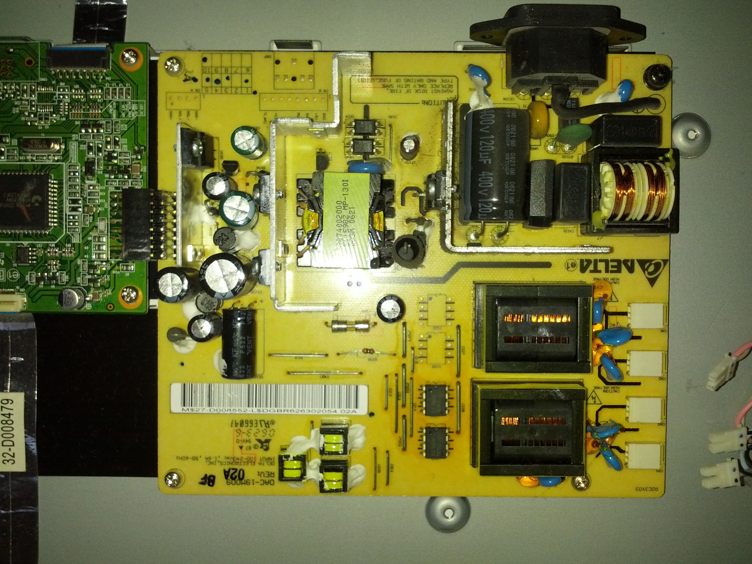

        It looks like you definitely have 3 bulging caps. They might all 3 be the same type according to your picture. And all 3 are bad.
        You need to find a friend that can solder in 3 new capacitors in the area I circled in red. You can also replace all the capacitors. But definitely replace those 3.

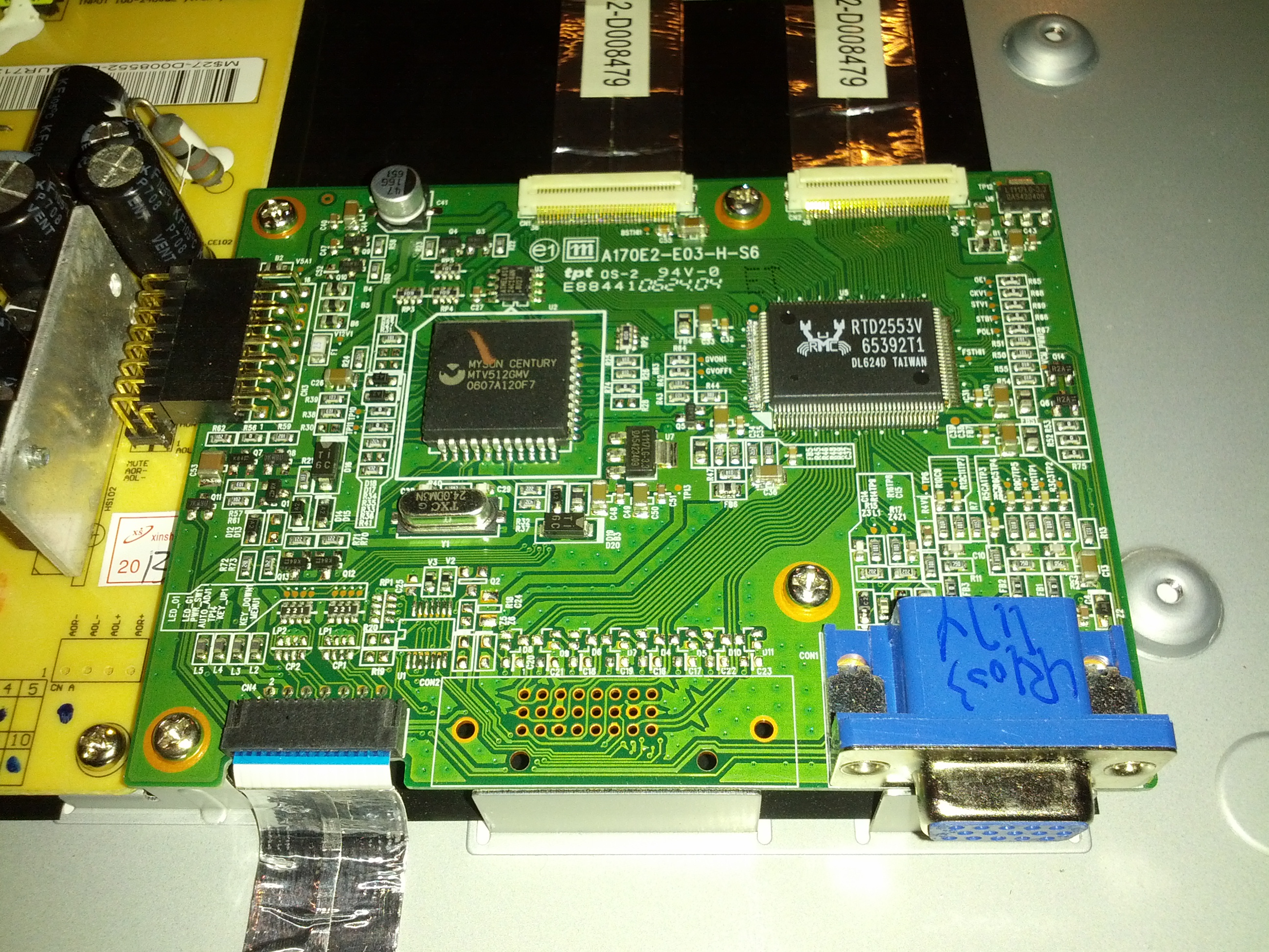

                    Hi everyone,
                    Some news from this Acer AL2216W monitor.
                    I replaced the board with a brand new one and...
                    The display went completely white when switched on and plugged to the computer.
                    So I opened the monitor again and checked all connectors, cleaned them (saw the "eraser trick" on youtube), verified that they were all completely pushed in, closed the monitor again, plugged it to the mains and...
                    The monitor went flashing white, back to black, white again, repeating this indefinitely while the green power LED kept blinking.
                    I read that this could mean a "failure of the power supply"...

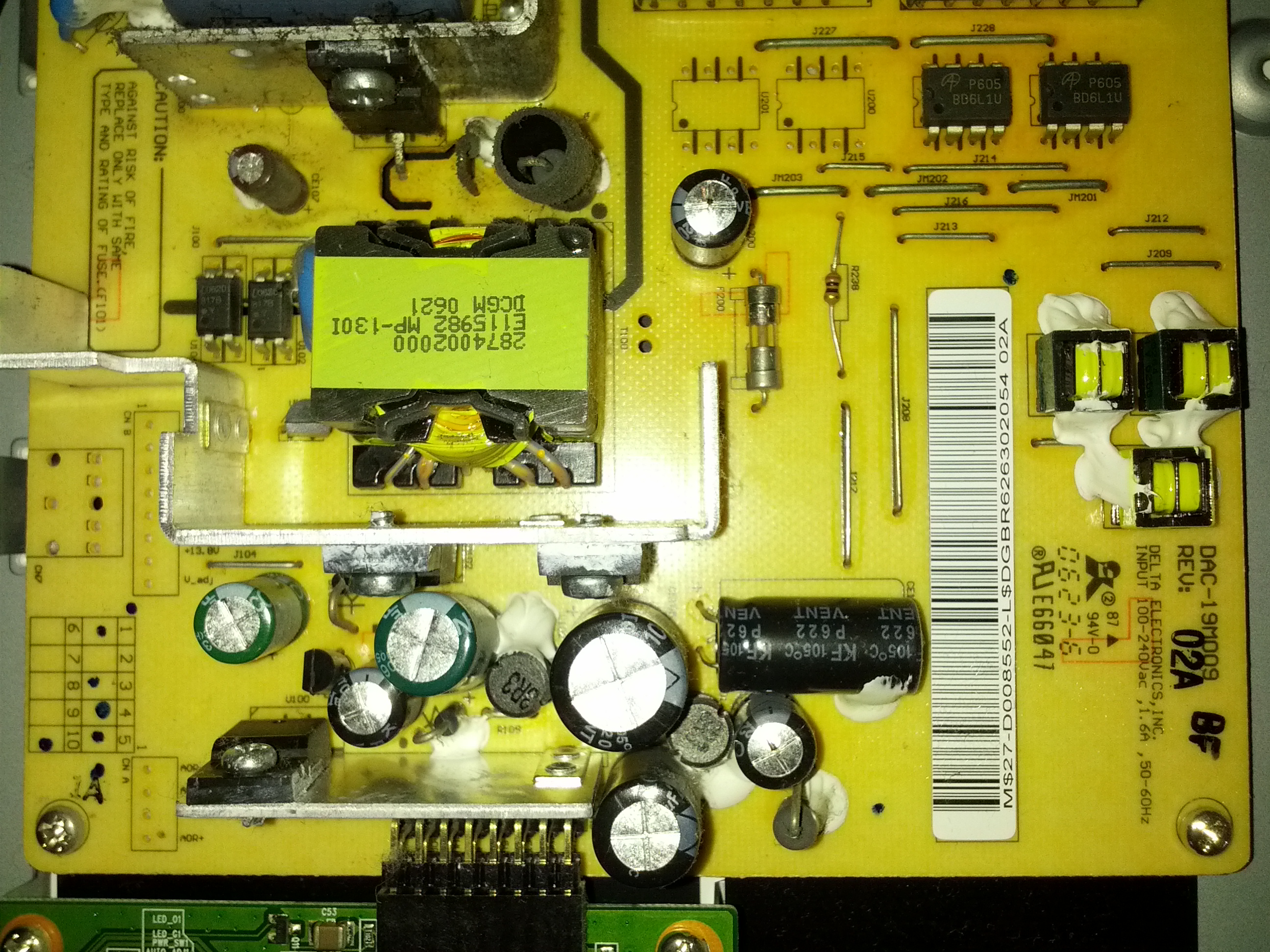

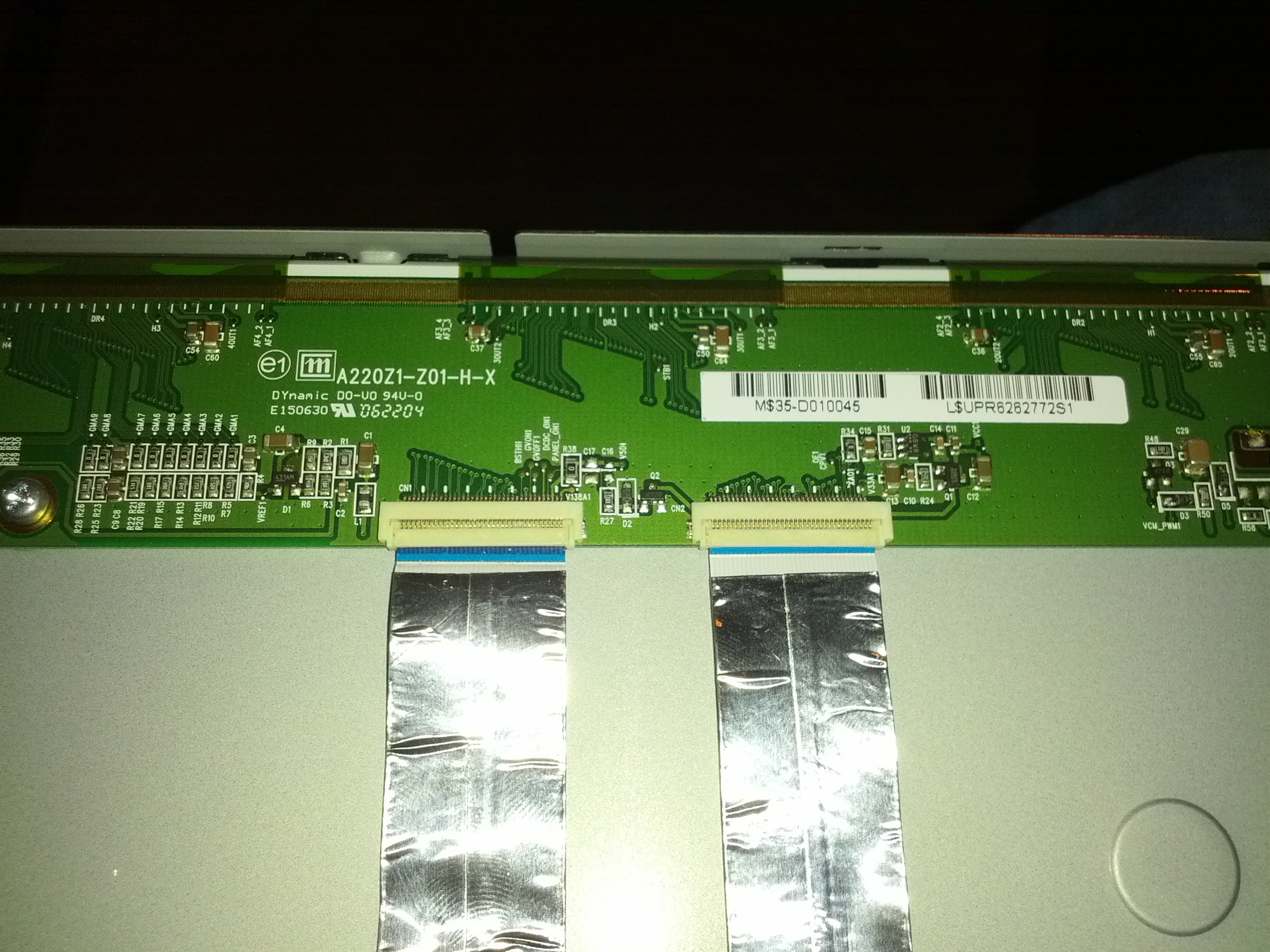

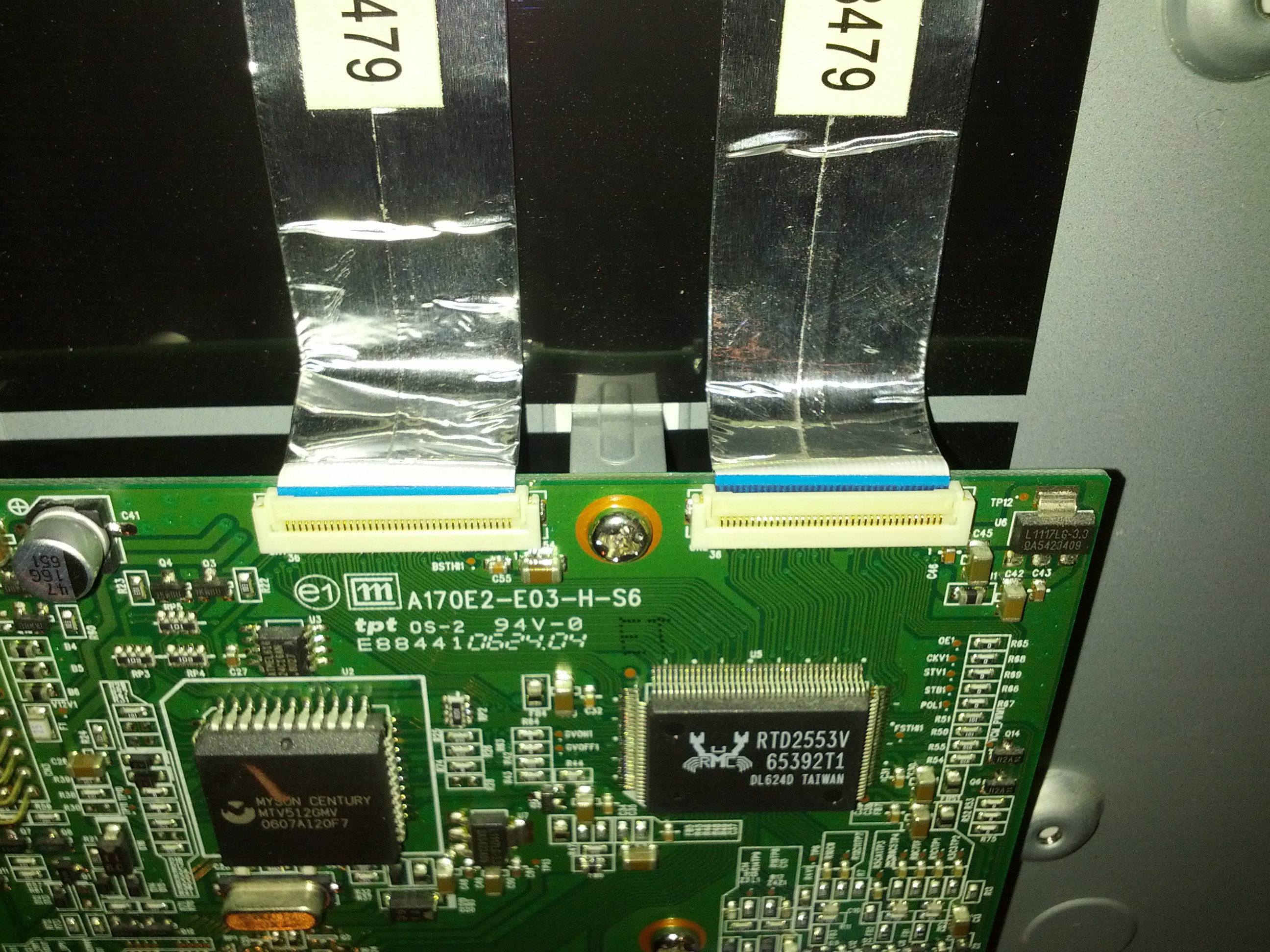

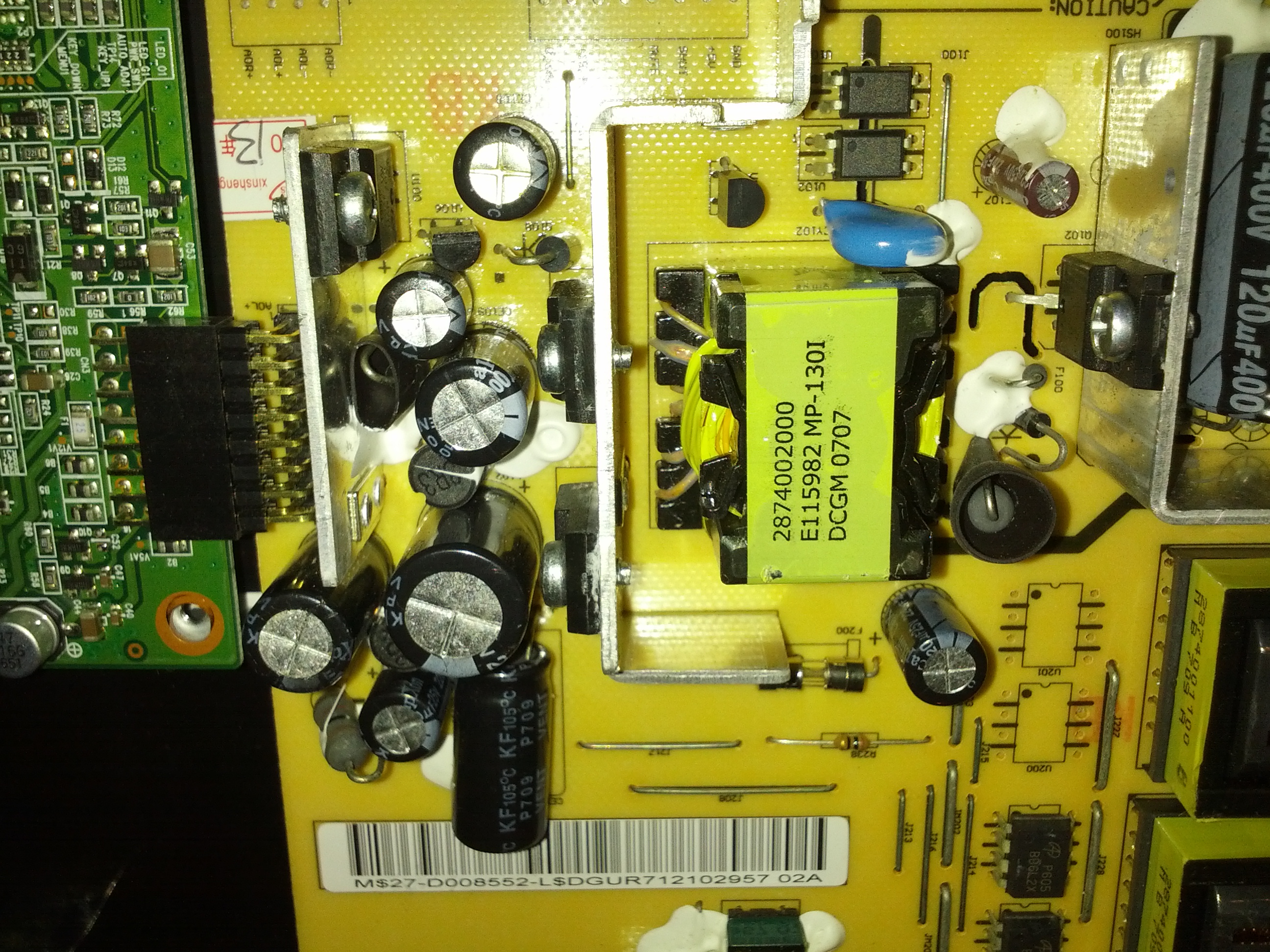

                    Just to check, I opened again, replaced the new board with the old - the one that used to go 2 seconds to black - and tried to power up the monitor again: failure. Won't even switch on at all. No power LED, nothing.
                    I tried the new board again, checking all connectors, looking for swollen capacitors (apparently none), taking pictures (see below), but it is still flashing white and black with power LED green and blinking...
                    I feel so dumb now. Did I damage something while I replaced the board or when I cleaned the connectors? Or was the new board defective?
                    Or is there a problem elsewhere maybe...?
                    I'm really clueless. Any leads would help.

                      Re: Acer AL2216W - 2 seconds to black
                      One of the cable to the panel is not seated as far in as the other one.
                      There is a small white fuse on the main board just by the connector to the
                      power supply. Can you test that. Also look for other fuses.
                      When it is all on and flashing can you get at that fuse and test the voltage on it
                      relative to ground.Does it vary when the screen changes?
