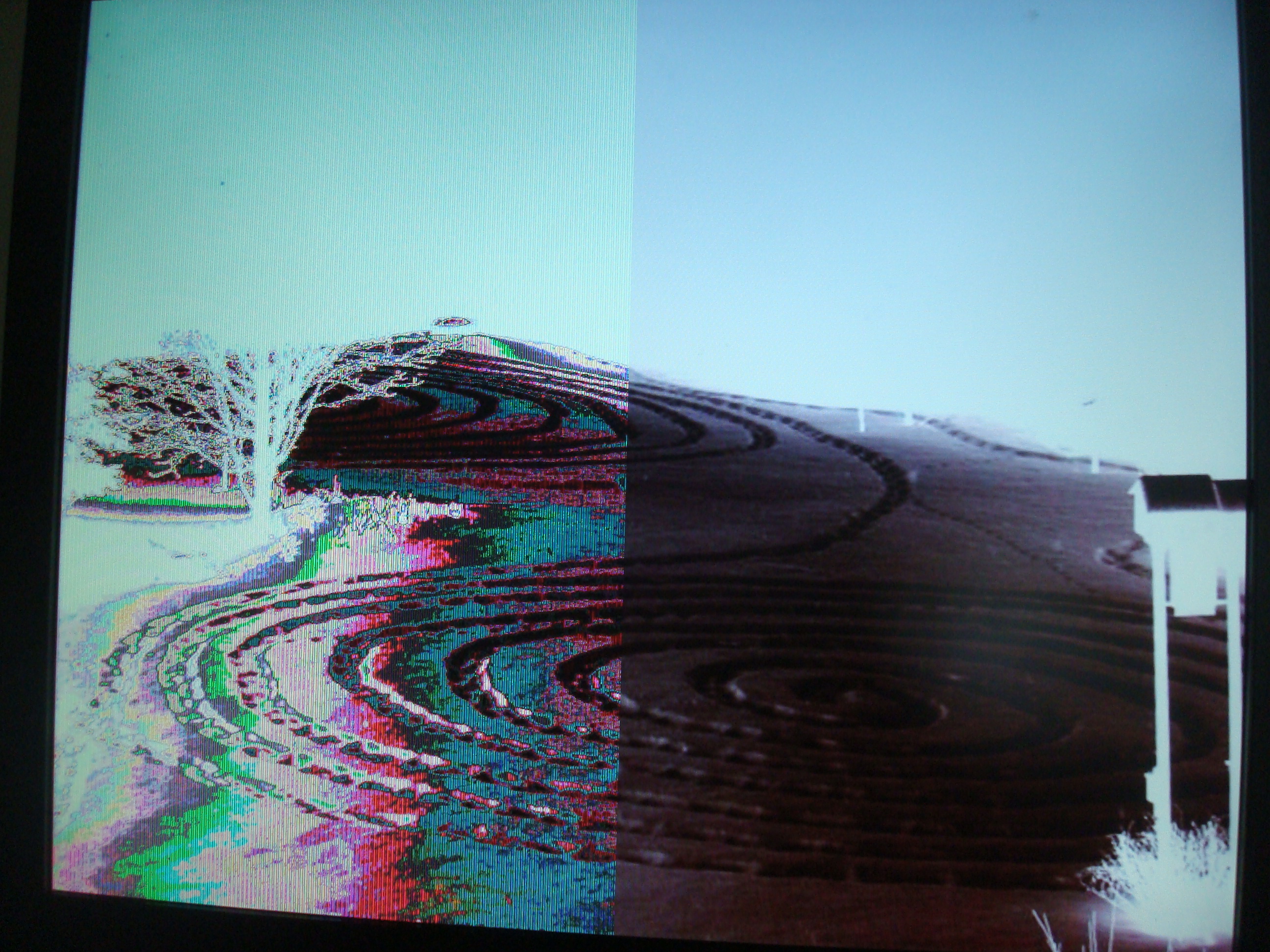

    I have a 10-year-old Acer AL1914 LCD monitor which suddenly started showing vertical lines over the left half of the screen. (See pic.) I have already recapped the power supply board. I also removed all of the electrolytic caps and diodes from the main board and checked them for capacitance and ESR. All seem OK.
    Is this monitor beyond repair? Does anyone have a main board they'd like to sell?

    I would probably look for a replacement Screen as opposed to the main board !!
