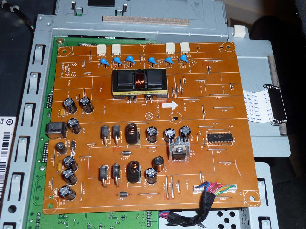

    Hi all
    My name is Chris and I am from Christchurch, New Zealand.
    I have a Dell SX2210B monitor with a power issue - this is a white 22" Dell Monitor.
    When you turn on the monitor it displays the no active signal box for about 2 seconds on the display and then turns off.
    This monitor has an external power pack which plugs into the power board of the monitor itself so not 220v going into the monitor.
    After taking the monitor apart I have found that the caps all look good. There was 10 x 25V 220u caps.
    When the monitor is apart you can actually hear like a shorting out about 2 seconds after power on.
    A bit like DSSSSSS DSSSSSS and then the power goes off.
    Just in case I removed all 10 caps (they all looked good to the eye with no bulging) and replaced them with new ones but it still has the same issue.
    I am interested in learning about the issue how to diagnose and repair this.

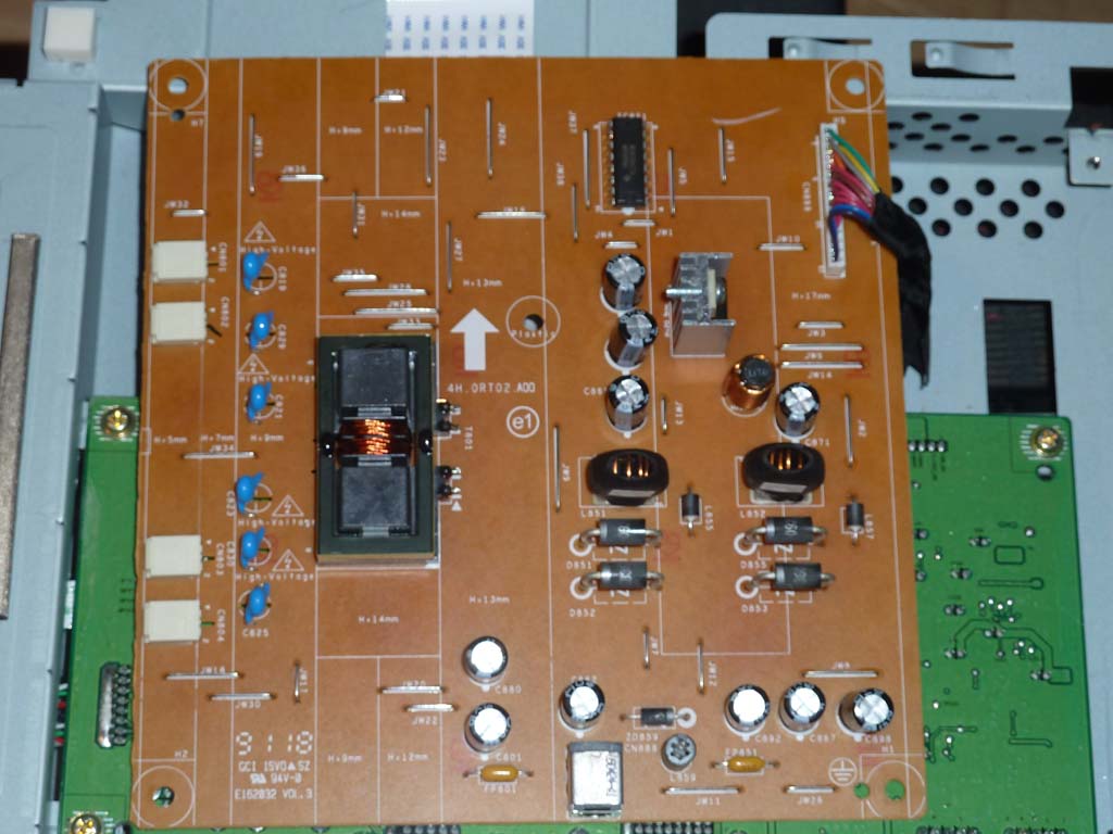

    I have a number of photos of the power board (this is where the sound appears to come from)
    The board is quite clean (i.e. not too busy) so hopefully someone will be able
    to give me some ideas on where to look for potential issues.
    Any ideas appreciated.
    Cheers
    Chris

    Chances are it is a bad lamp/wiring to it.Also please do not put photos on in-line,as this slows everything down,and a lot of members will just ignore the post because of that.Use 'Go advanced' below and then 'manage attachments'.If you have no spare lamps to test, then suggest you disconnect the lamps from their sockets,and then switch on and see if your DSSSSS is still there.

        I have done as you suggested and removed the lamp wires (CN801, CN802, CN803, CN804) from the last image above.
        No Dsssss
        I then put CN801 and CN802 back on
        Also no Dssss and I can see the no active connection image move around the screen.
        As soon as I connect either CN803 or CN804 or both the Dssss comes back.
        I do not know what this means now. Does this just mean the panel is dead? Or is this something that can be repaired cheaply?
        Can you actually run the monitor without CN803/CN804 connected? I have not tried this to see what would happen.
        Chris

          Take the lamp's connectors that are plug into the CN801/802 (which do not make DSS) and plug them into the CN803/804 to see if the DSS still there, we are trying to find out if the DSS is from the lamps or from the transformer.

            I have done as asked and the issue is the lamp - as the problem moves to the other connector.
            I am not sure now what to do - I had a quick look at the panel and was not sure how to proceed. I guess the lamp is faulty.
            Can you run it with just 1 lamp? does it make it dark on one side?
            Chris
              Re: Dell SX2210B - Power goes off after 2 seconds
              All the lamps have to be hooked up and working, otherwise the protection circuits will kick in. Getting to the lamp assemblies is not easy job.
