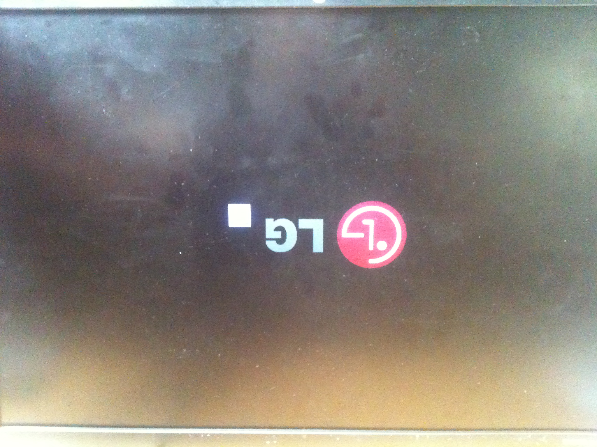

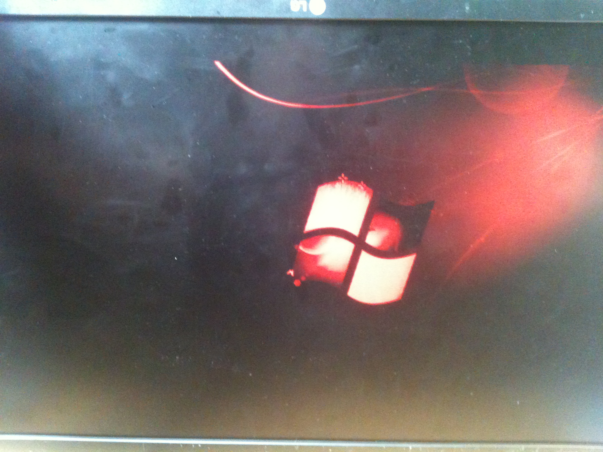

    Hi guys,
    i have a LG W2234S-BN that had the corrupt flash and would not power on, have reflashed the chip and the monitor now powers up fine and works,
    problem is that when i connect the vga the display is red as if the blue/green are all removed, but its not the panel as when the logo comes on its fine,
    im guessing the fault is on the input between the dsub and the tsumu chip.
    i have checked the parts on the input side but cannot find anything wrong?
    have attached pics
    any ideas?

    Wiggle you vga cable around. I've had vga cables fail before, and usually one color (R, G or B) goes intermittent. I guess its possible for more than one to fail at once...

      Hi thanks for the reply,
      that's what the picture reminds me of too, when a pin snaps in the connector but have already checked the cable as it works fine on another monitor. have also checked pins in the monitor female connector to check they are not broken either, i have continuity from end to end no problem, i will triple check just to be sure tho

          i have tried the ribbon cable, but i will triple check it again, was first thing i checked before i flashed the spi chip, but i will recheck all the connections are solid, dont think thats the problem tho as the main logo displays fine, perfect color and everything, even the menu displays ok,
          Darren

                  No dvi on this one have double checked all the suggestions so far and still the same, don't recall seeing a reset in the menu will have another look tomorrow, did use service menu to auto color and init the nvram,
                  I'm guessing that the bit that displays the logo on boot is the same as displays the graphic from the pc, thus eliminating it being a problem with the circuit between the panel and main board?
                  Is there anything that would make it display all color as red? Sort of combine the signals into one??

                        ok problem solved guys, was the lead!!!!! works on every other monitor i have here including tv's, but when i tripple checked the lead its self it appears that the gnd pins (5-10) are not connected!!!!!!!!!!!!!!! so i grounded the pins on the main board and vola pic perfect,
                        on the main board pins 4 and 6 are connected to gnd but 5,7,8,910 are not!! i guess all my other monitors must self gnd the pins together!!
