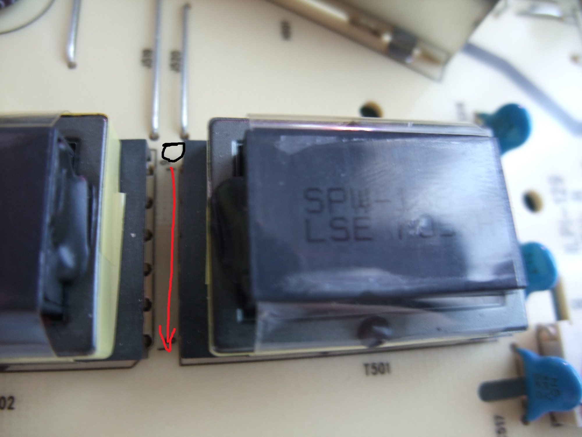

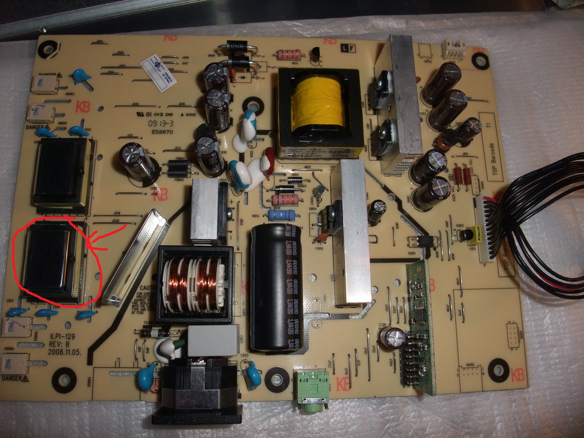

    I have here a Acer H243H Bbmid.
    2 seconds to black. you can see the picture with a flashlight.
    I replaced the caps on the supply board. It still doesn't work.
    I left it for a few weeks. on a new test it worked with a whisteling tone.
    I opened it again and then there was the 2 seconds to black again with that whistling tone. I got near with my ear and could locate the tone on the "red marked" piece.
    before the monitor shuts off it is flickering as the whisteling tone is.
    what can I do next to find out what is wrong?
    Is it possible that the whisteling piece is broken or can it be another part which causes in the marked piece the failure?

    It could be the bottom set of backlights that is causing the problem.You need to measure the resistance of the two transformer secondaries, and compare them !!

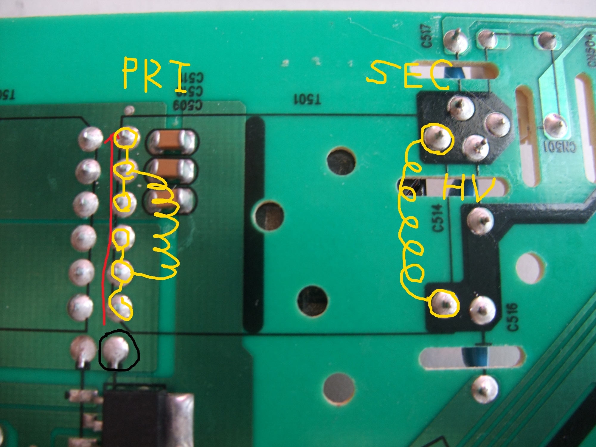

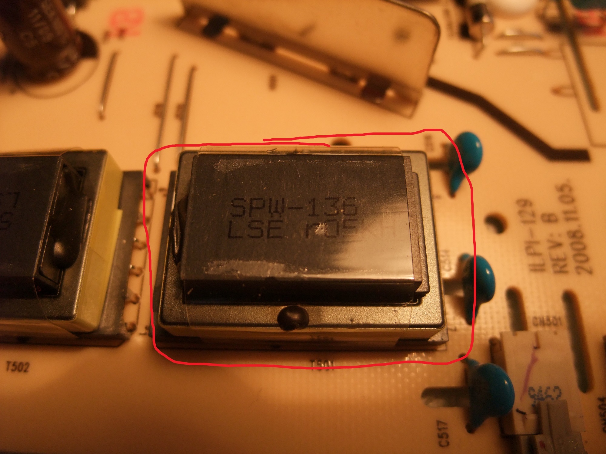

      I have red the tutorial, but I 'm not sure.
      Shall i measure like I marked in the photo?
      put GND on one pin (black) and measure the others (red)?
      how do i set my multi meter 200 ohm or 2k ohm.

        @mc, the high voltage winding is on the two pins on the opposite side of your marking, your marking is for the primary side winding of the transformer.

          Re: Acer H243H Bbmid - replacing caps not enough
          okay,
          but how can I measure the transformer.
          Where put the GND? on the side with my marking? so I can measure from primary to secondary winding. or only secondary winding?
          this is what I did not understand properly.
            See picture. Just measure at the two pins of HV Winding which is on the secondary side as shown.

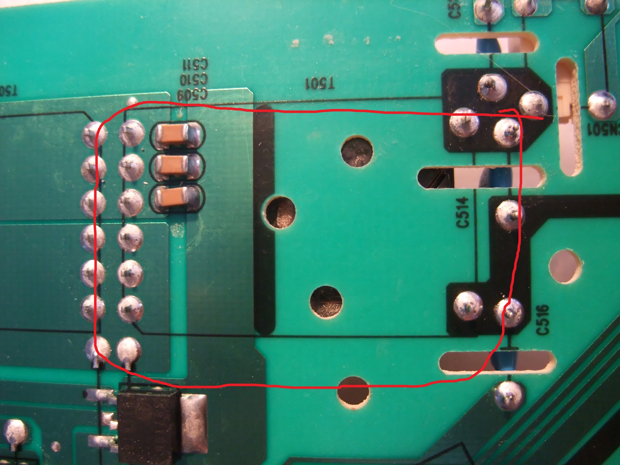

              Thanks for the help.
              I measured the HV winding on secondary side.
              transformer 1: 647 ohm
              transformer 2: 658 ohm
              transformer 1 is the one which made the noise.
              so they should be in the 3% tolerance if I understood it right in the guide thread.
                That looks good, suspect the backlight and/or its wiring

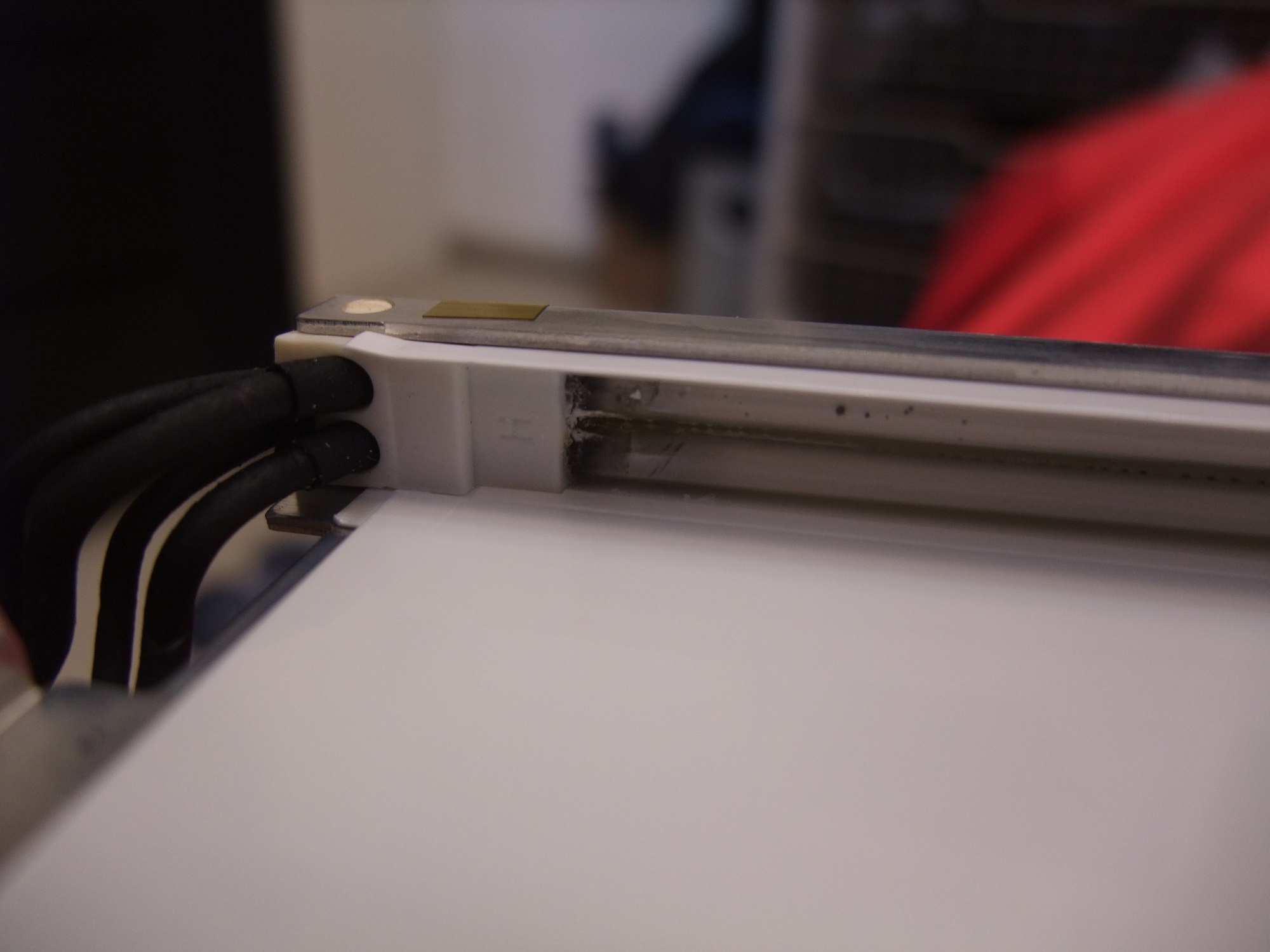

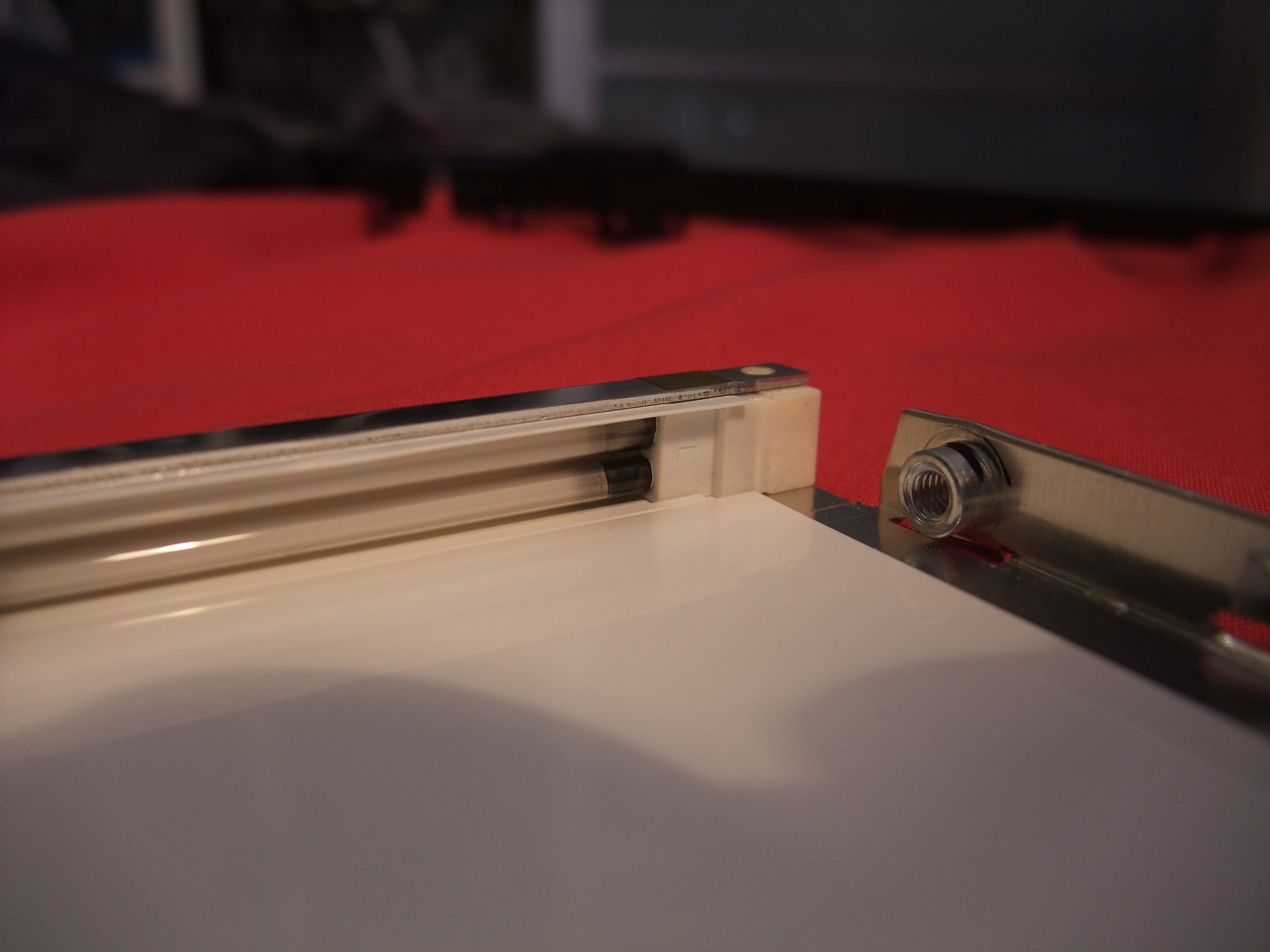

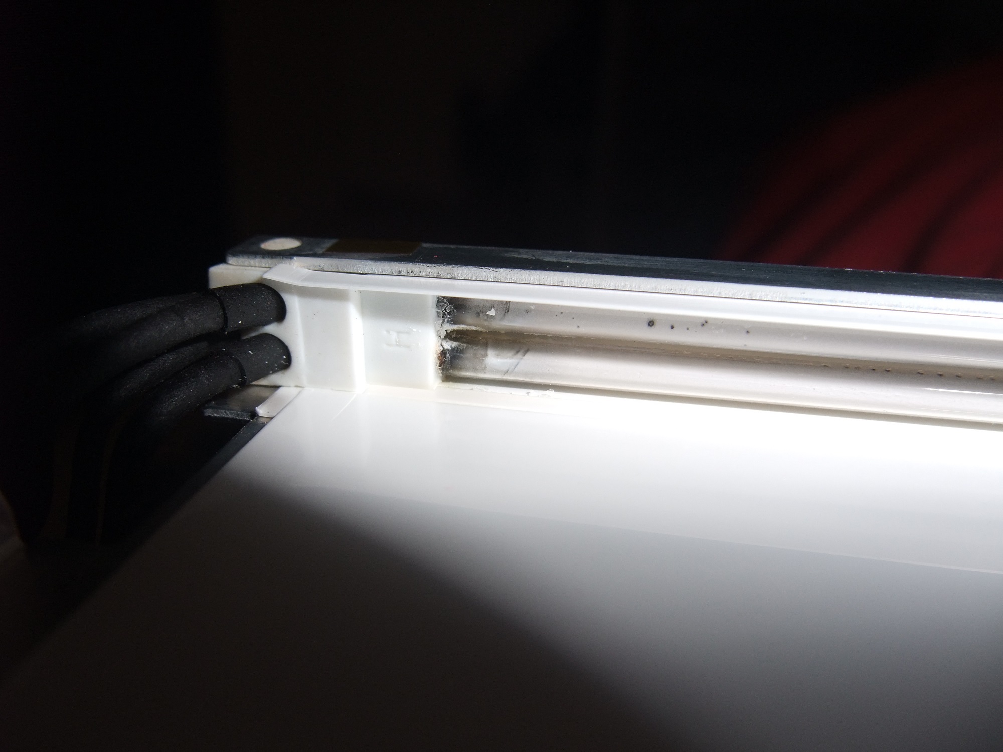

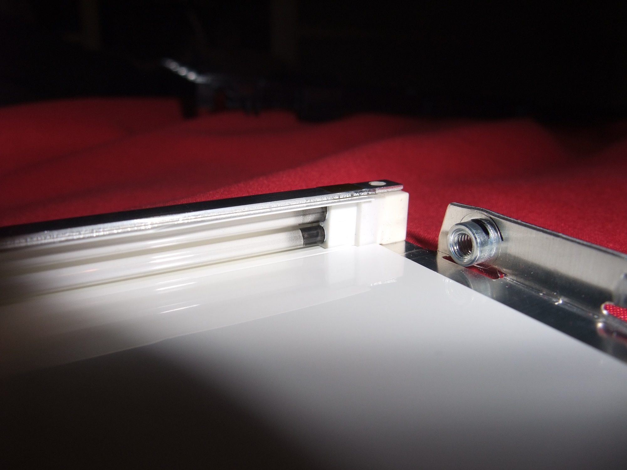

                  hello
                  I disassembled the panel.
                  and the bottom pair looks like this. I think it is not good.
                  I have another samsung 19" monitor.
                  can I try the backlight from this one or must it be another 24" backlight? have the manufactures different voltages or are they all the same and the just get more current?
                    You can try the 19" one for Test ONLY,as if you try and fit it to use permanently, you will get a large shadow on the Screen.So its either buy new,or an old 24" from somewhere with a set of good lamps.
