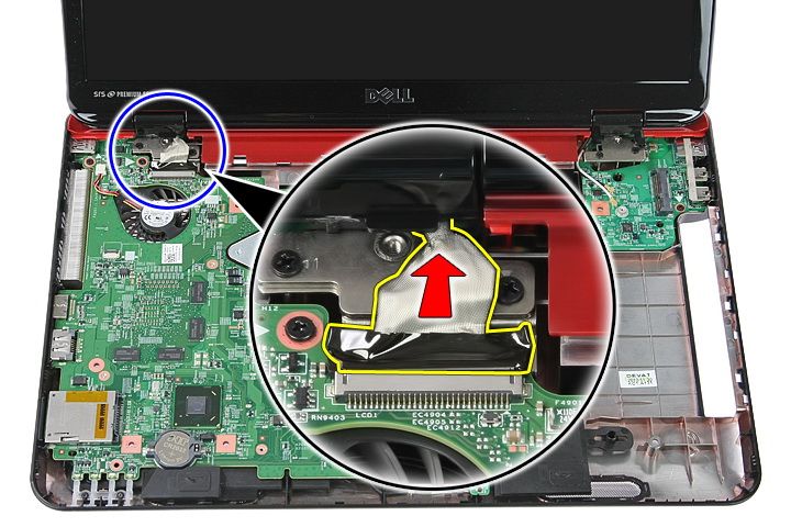

    I have this dell N5110 that powers up nice but no backlight, but when you put a
    Flashlight behind the screen you can see that there is video.when connected via HDMI to external monitor, it has nice and sharp video.what could be the problem please

          Re: Dell Inspiron N5110 No LED backlight
          The N5110 doesn't have an inverter board, so it's either the panel or motherboard (can also be cable, but is rare). If you turn the system off and hold down the "D" key on the keyboard while powering the system back on, the LCD BIST will run and test the LCD independent of the video controller. If you see the same result the panel is bad.
            I didn't realize the model when I posted yesterday. I have probably seen a dozen of this particular model with a dim backlight caused by the LCD cable being slightly unseated at the motherboard. Before you buy replacement parts I would highly suggest that you take the palmrest off and re-seat the cable.
            The LCD cable doesn't have any slack on this model and the rocking off opening the LCD over and over tends so unseat them quite a bit. I'll attach a picture of it in its native habitat. If you re-seat it and it works, I "kapton tape" the hell out of them and they seem to hold up well.
