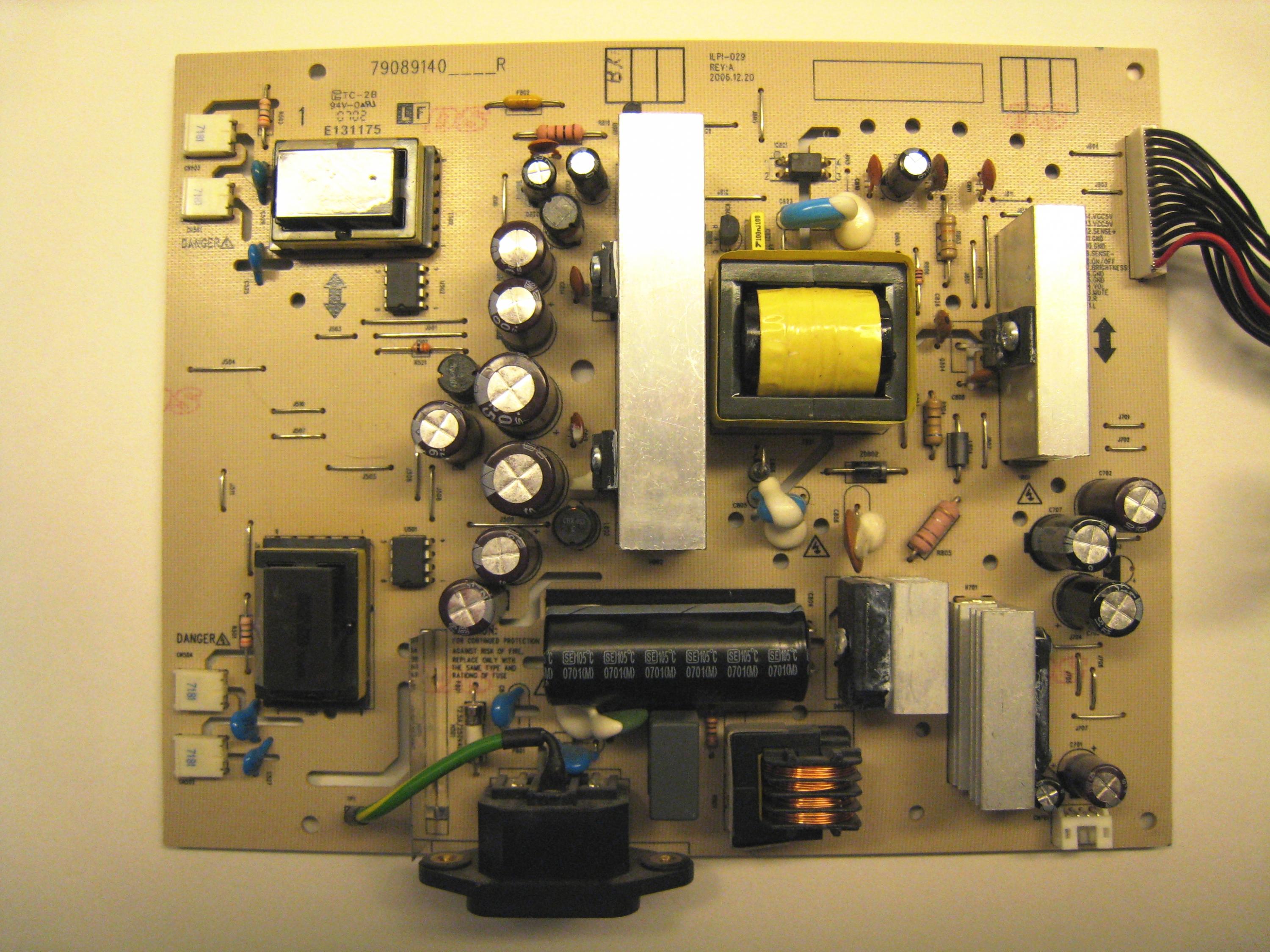

    Picked this up dead, opened it up and found some bulging caps. I always recap the whole thing to make sure, with low-ESR caps I get from Mouser.
    When I started listing the caps, I found some 125° caps in with the normal 105's. I went to Ebay and looked at 3 different cap kits to see what they included. None were the same as my board, and none had temp ratings other than 105° for all the caps in the kit. Some kits listed less 680 caps then I have, one listed an 820 cap I don't have, so I am now confused as to what is proper for this board.
    The power board is what seems to be the standard IL-PI-029 Rev:A.
    It doesn't look like any caps have been replaced, and they all are the (hated) Suscons. But, if someone replaced some caps on this board with the wrong ones, I want to make sure I use the right ones, and since I am going to replace all of them, I want to make sure they are right.

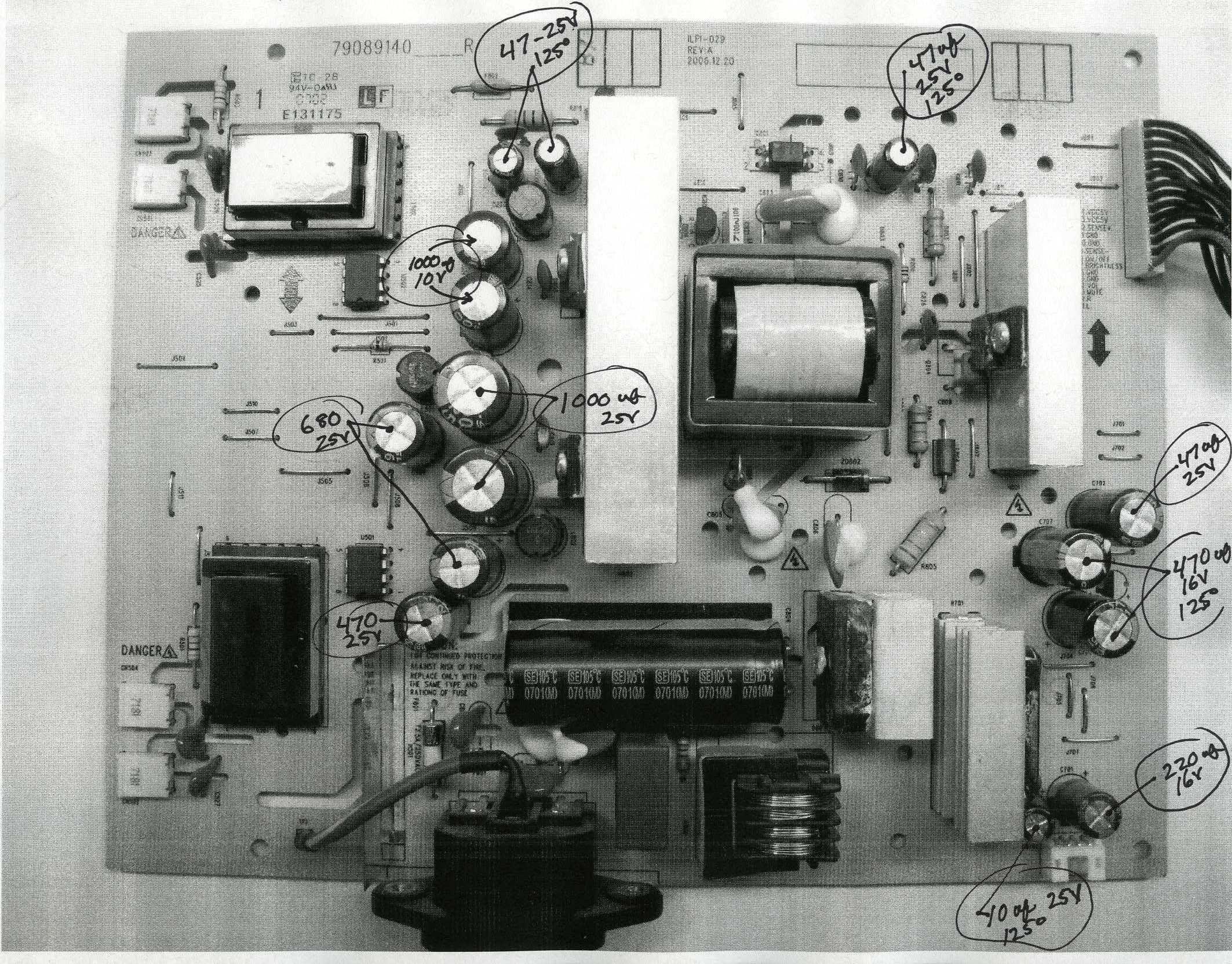

    So, I tried to write what these caps are on a photo, had to write on it and scan it in - I hope it is legible.
    I noted where the caps are 125°. They are: (3) 47uf 25V, (2) 470uf 16V, and one 10uf 25V.
    I have seen a bunch of posts from people familiar with this display, so I hope someone can help.
    My questions are:
    Are these the right caps on this board? Correct uf's?
    And, do I need 125° replacements, or just use the more readily available 105° ones and not worry about it?
    My hesitation is that the manufacturer probably used as cheap caps as they could, so if they felt it needed the higher temp caps in those spots I am concerned that it won't either be stable or last if I don't find the 125° ones. Or someone just used what they had.
    Thanks.

    Someone probably fixed that monitor before and used 125c capacitors instead of 105c capacitors.
    Usually, capacitors rated for higher temperature are more expensive and the cheaper ones don't have as good specs as the top 105c ones.
    I think you would be fine replacing those with 105c capacitors from good brands.
    I see you use Mouser and you seem to know what you're doing.
    Nichicon PW should work fine for 47uF and 10uF 25v - I would however just use 35-50v rated capacitors as I'm sure there's space on the board and those are usually rated for more hours compared to 16-25v caps from same series (different diameters).
    If you really want higher temperature, I can recommend Rubycon RX30 series (Farnell/Newark stocks them), they're usually rated for 2000h @ 130c or more... for example a 1000uF 35v capacitor is rated for 4k hours @ 130c but it's about 4$ a piece and doesn't match Panasonic FM or FR specs.
    For 470uF 16v, I would just use Panasonic FR rated for 25v, or FM. FR is better, more hours @ 105c but may be a bit taller.
    If it saves you money, use 1000uF 25v instead of 1000uF 10v as well, maybe it's cheaper to get a pack of 5 x 1000/25 instead of 2x1000/25 and 2x1000/16.

          Thanks for all your help. What I am wondering about is if the 680 cap is the right one or not, when the cap kits listed an 820 I don't seem to have but it's the same board.
          • selldoor
            Slow Learner
            • Dec 2010
            • 7870
            Re: HP W2207 What are the right caps?
            Doesnt really matter, As long as it will physically fit you can use an 820 uf in place of a 680uf (but not the other way round). As long as the voltage is the same or a step higher.

                  I think you are failing to grasp the fact that the boards in these monitors vary as they are produced. Following a lot of fail reports they will randomly change the value of caps and other components - resistors - diodes. Some boards have extra caps some less
                  (all these boards have the same number though a big change may make them add a version number. In addition they may run out of say 10v caps so they will just use 16v caps - similarly they could use 50v instead of 25v or 68uf instead of 47uf.
                  Schematics tend to reflect only the initial board plan and they often have extra positions for components which are left blank but are there in case of need.
                  They also use the same board for different monitor manufacturers and so the same board can have different spec components depending on what was agreed.
                  So the answer to your question is nobody really knows.

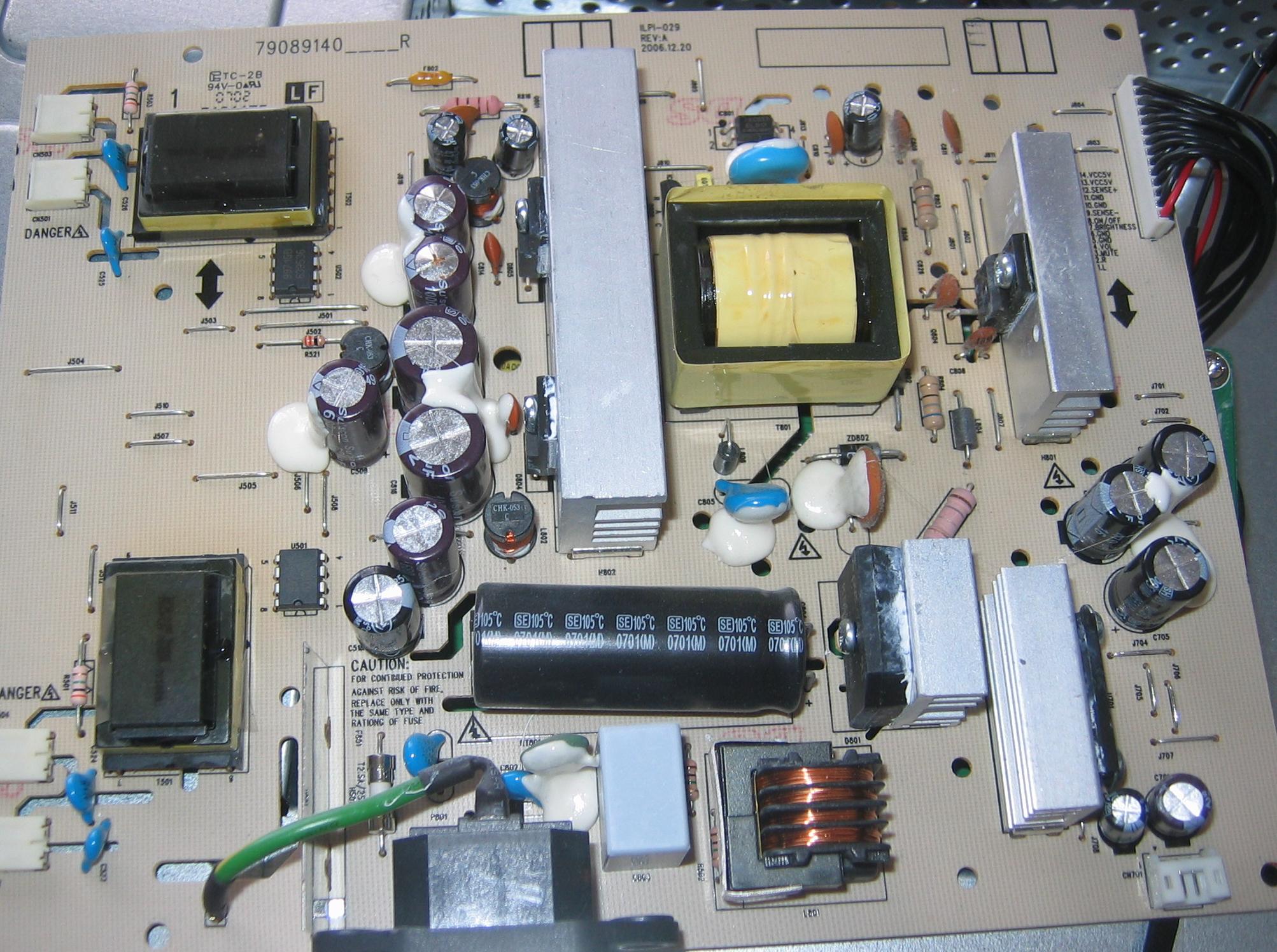

                        I took this picture almost 3 years ago. The angle doesn't show the values, but judging from the color, vent, and markings it appears you may have the original caps in your lcd.

                          Thanks again. Selldoor, that all makes perfect sense to me now.
                          I will go ahead and use 105's and just match what's there. Now I just need to get some 1000 caps; I hate having most but not all of what I need and have to pay for a short order, and I don't have those.
                          I did read most of those threads, probably missed a good list of caps, but in light of the comments, I'm going to do it as above, just match what's there and see if that works.
                          It's really great to get the comments from all who have experience in these topics to make me feel comfortable in what I'm doing with learning this stuff.

                            Hey, thanks for the photo, retiredcaps, it looks exactly the same, down to the same two bulging caps as mine.
