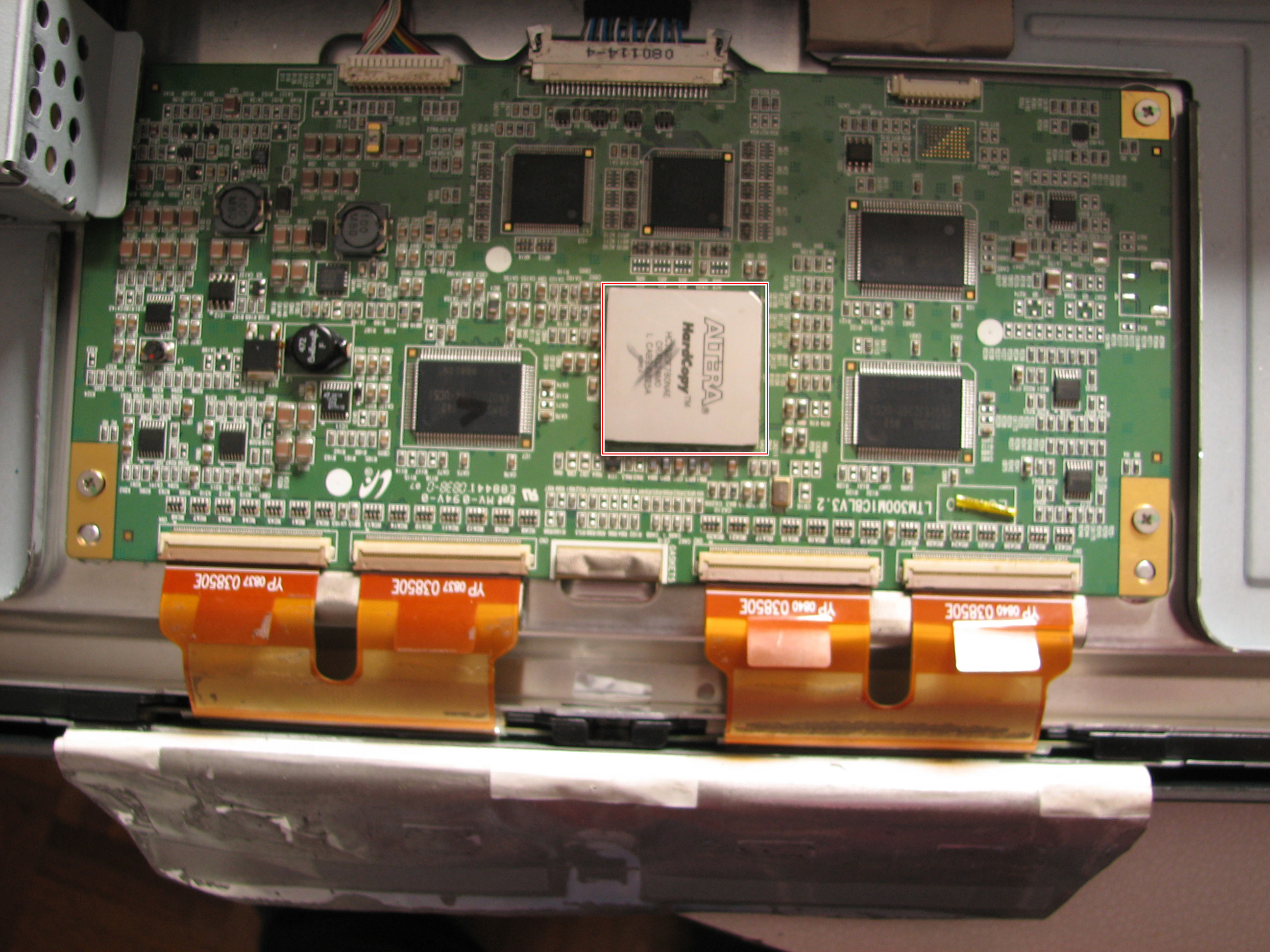

    Hi. I got vertical lines on right half side of monitor, I suspect flat cable. Is any chance to fix this issue ? or replace this cable with new-used etc ?
    video is here http://tinypic.com/r/2u92xhc/6
    i reflow marked chip but no chenges
    Thank you.

    Re: Samsung LCD lines problem
    If your lucky it is the cable but could be panel fault.
    Try removing and cleaning the lvds cable.
    If you move the lvds cable while the monitor is up and running do the lines move- if so it is likely to be cable - if not likely to be panel.
    Also try different pc - to monitor cable
    Also try on different pc
      I will try remove-clean LVDS cable and see what happen.
      But I think I was un-lucky I disconect side vith vertical lines, and I get horizontal lines on other (health) half side
      video is here http://tinypic.com/r/2jecck/6
      omg there is 99.99% bad LCD panel ?
