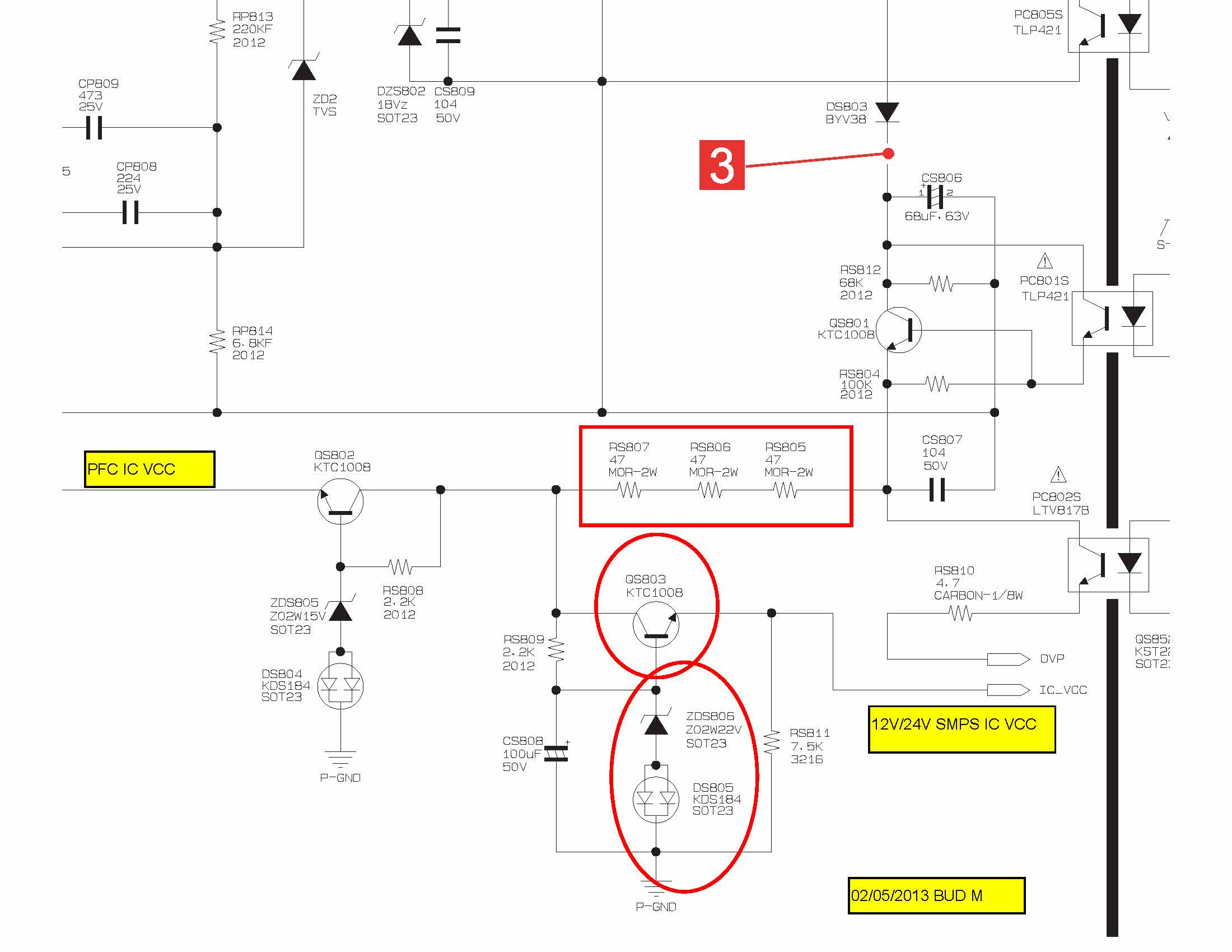

    I was not sure which one of the 3 caps is connected to pin2 (not 7 as I said) of the IC. I will look at the board to find the switched transistor that supply the voltage to pin2 next.
    Pin 2 is VCC.

      Re: Sun 24.1 LCD / Samsung 244T
      OK, check the ZENER DIODE ZDS806 for short, check the DC voltages on QP803 (it supplies voltage to VCC pin 2 of the 12v/24v SMP IC)

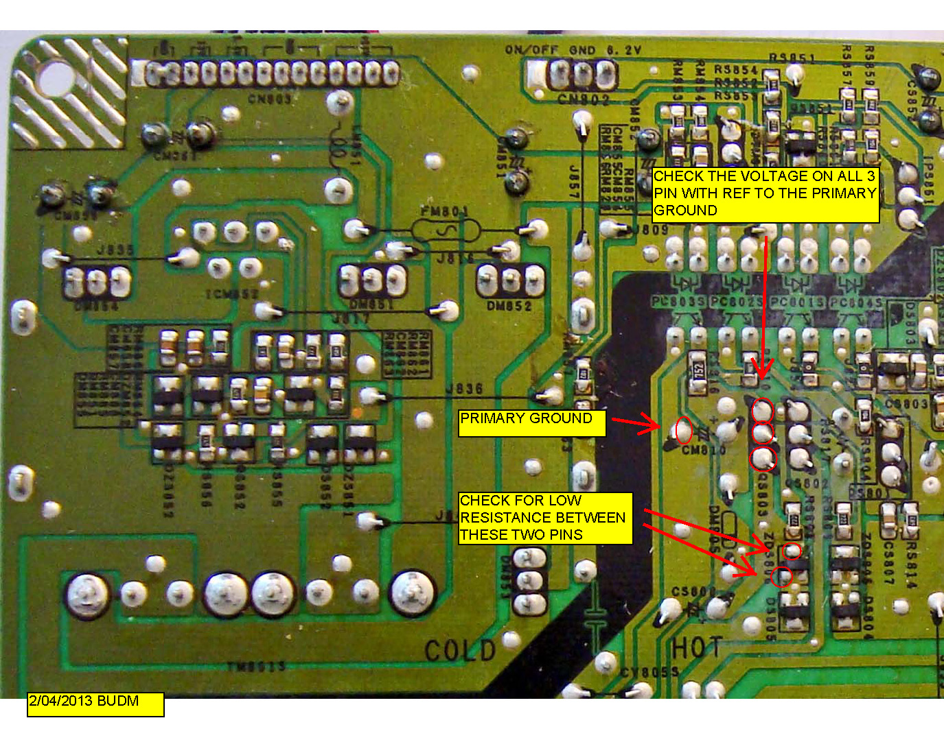

        Bud,
        In regard to the 3 pins you had me check. I had VDC at 20 and got
        top pin = 0
        middle pin = .02
        bottom pin= .02
        Bear with me as I'm not a techie, but I measured the resistance with my Greenlee DM-20 starting with 200 up to 2000k.
        At 200, when I first touched the two I would get a momentary reading of 85 up to 155 then it would drop back to 1 again. Again, I would touch it 3 or 4 times and would get a quick reading and then back to 1 again.
          "top pin = 0
          middle pin = .02
          bottom pin= .02"
          Do you have the TV power on with power switch activated? There has to be voltage at the middle pin since the PFC circuits are working.
                If it is not attached to the main board, then the PS_ON will not be activating the power supply to power up the PFC and the 12v/24v power supply.

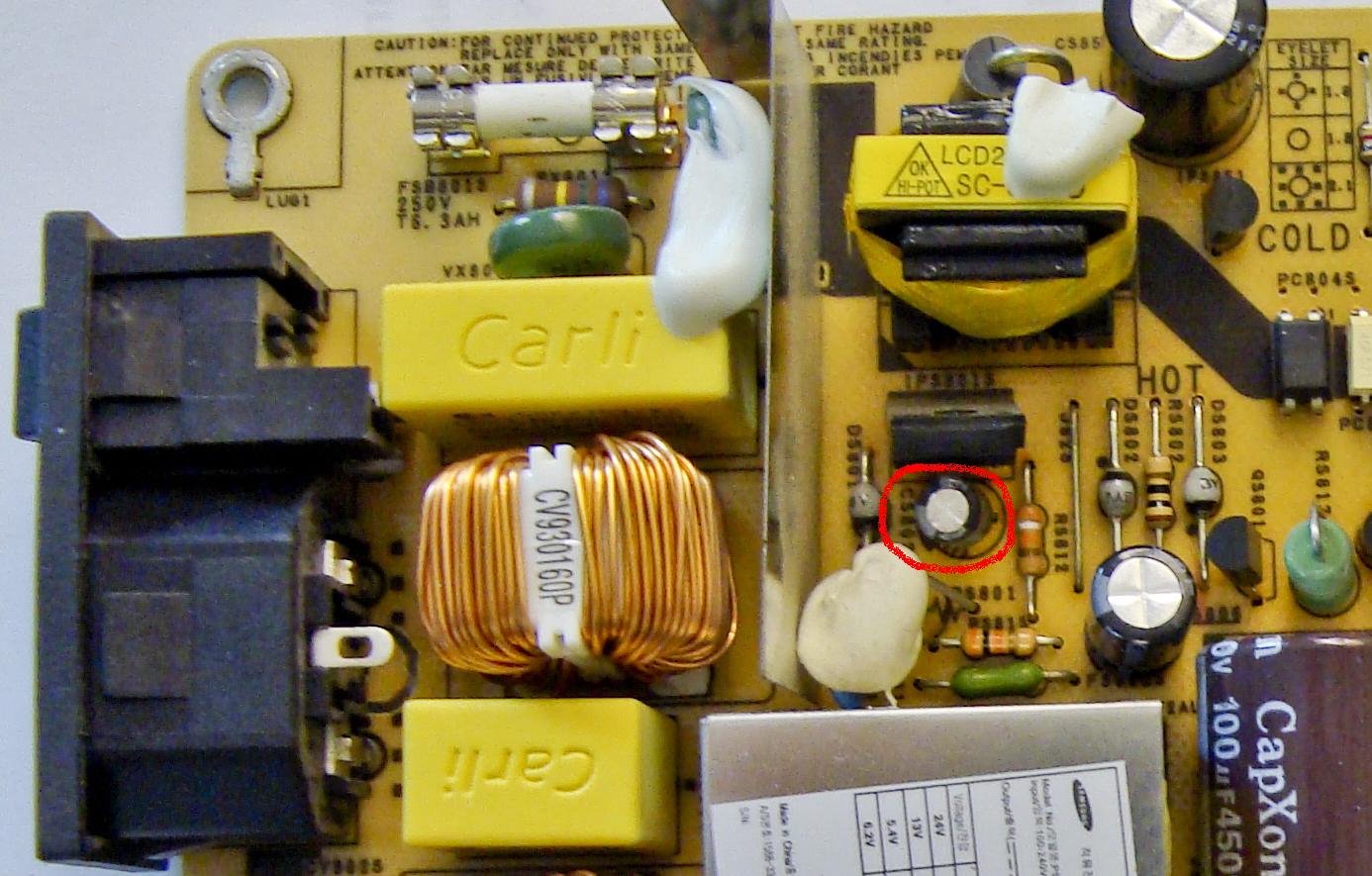

                              I'll take one last stab at this. Try changing the startup cap circled in the photo. I believe it to be 10uf 50V. If you can't get this value, then try 22uf or 47uf 50V. As this is for testing purposes, we're not concerned about getting the right type of cap. If you don't have old circuit boards that may have the cap you're looking for, then Radio Shack or Fry's should have it. Hopefully, you have a Radio Shack within driving distance.
