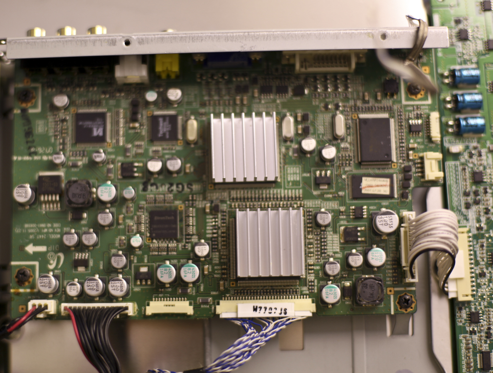

    Hello, This is my first time on here and am greatly relieved to have a "go to" forum with so many knowledgable and generous contributors.

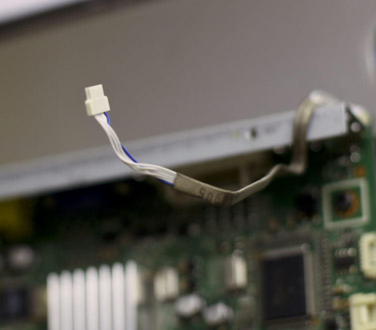

    Ok, I saved up to finally purchase a 24.1" Sun monitor x7203a LTM240M2 L03I've always left it on and let it go into sleep mode when not in use. Then I read an article advising to turn it off at night. (beginning of the end) So I turned it off before bed and Voila...it would not turn on in the morning! There's usually a reassuring blue light on in the lower right corner. No more light of any kind. So, I found several bloated caps and sent it off to a gent on ebay who replaced the caps (hugheric, if anyones used him) However, I was greatly disapointed to find the light was still out along with my excitement.
    1. Is there a way to bypass the 6 wire plug that goes to the frontpanel switches to see if the actual buttons/switch might be bad?
    2. There are 5 white wires with a dark blue one on one end. Which wires would I jump?
    3. When the power switch (on back of panel) is on I get no voltage running across the white replaceable fuse.
    Thank you for any help you care to give.

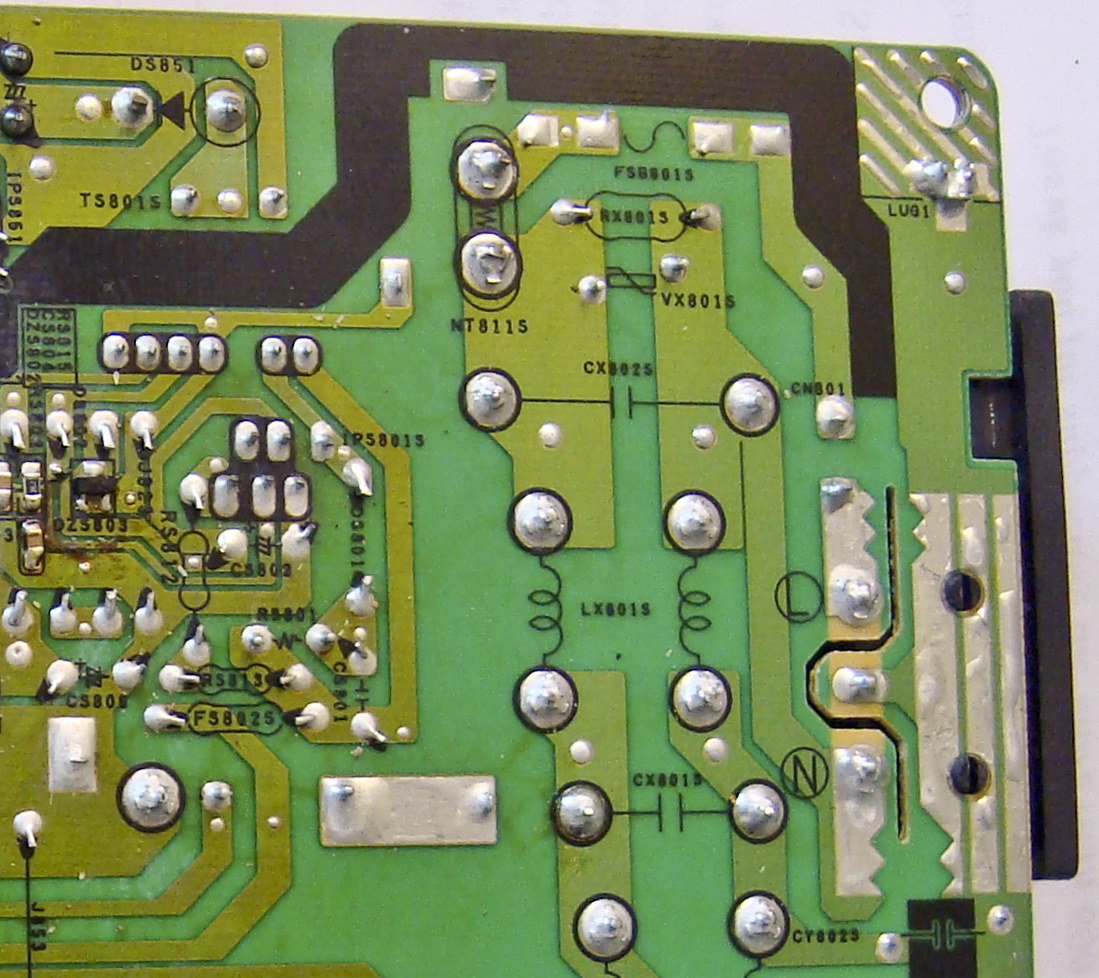

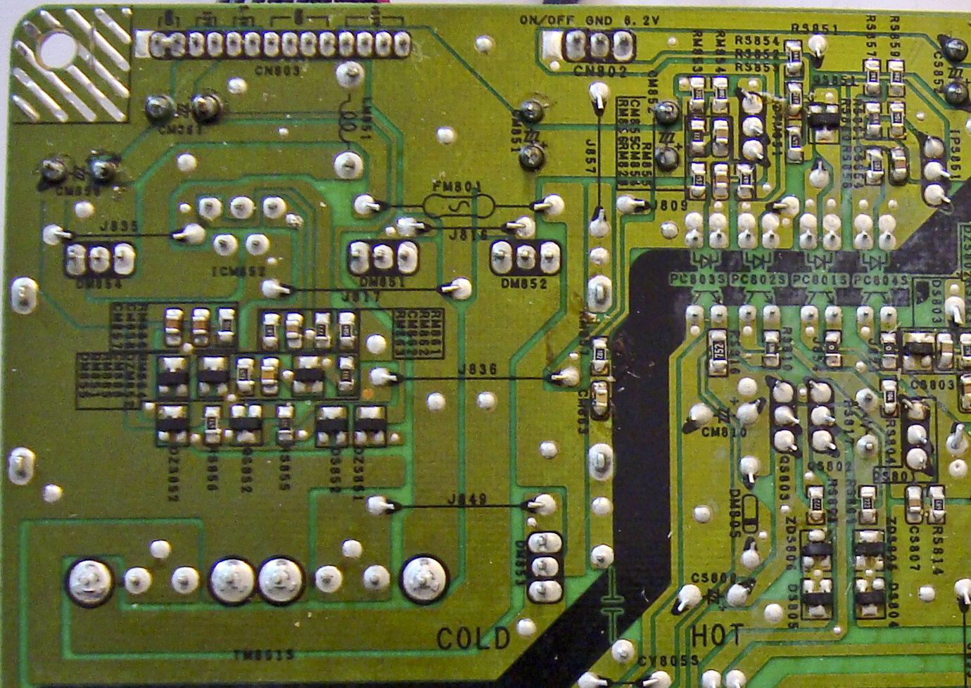

                      The voltage output for each wire should be stamped onto the board itself near the wiring harness. Also, look underneath the board to see if anything is stamped there. If you see nothing, then it just adds to the hardship of trying to troubleshoot an already complex board.
                      Since you had trouble measuring the voltage across the cap, then I suggest you try measuring the voltages at the wiring harness again. If the wiring harness is labeled then list the expected voltage versus what you measured.

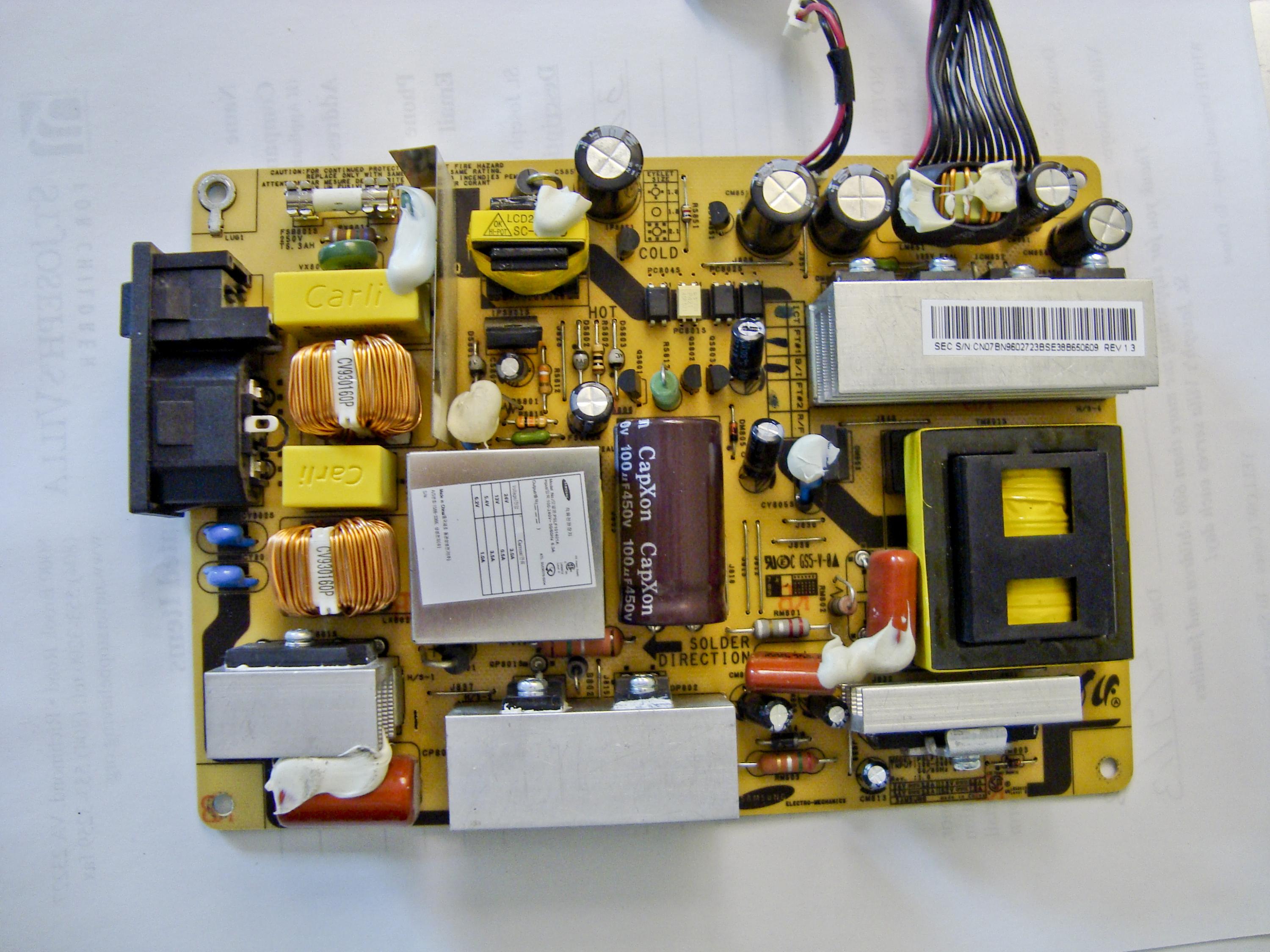

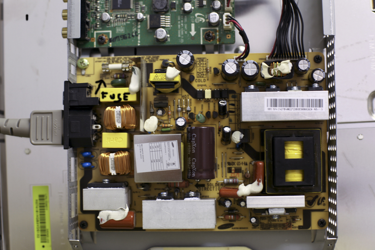

                          Re: Sun 24.1 LCD / Samsung 244T

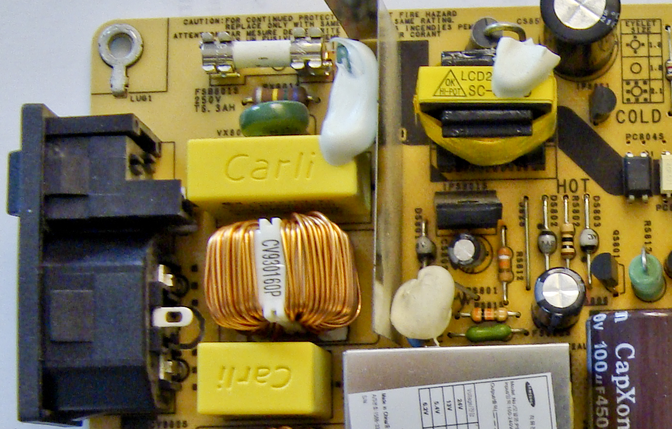

                          On your first photo, to the left of the large 100uf 450v cap is a metal shield. Directly above that shield appears to be a fuse. It's green in color and shaped like the resistor above it. Unplug your monitor and let it sit for a minute or two to let the large cap discharge. Check the fuse for contiunuity.
                              Jet,
                              Ok, that's the all green vs the banded one next to it, right? My meter buzzed happily when I touched the red and black on the ends. The case you kindly send the link to does sound very similar, though I'm no accomplished techie to quickly duplicate everything.
                              Plain Bill said that it is a two part power board- primary and secondary and that the secondary is always on. How do I tell the two sections apart? What should I check next?
                              Thank you for you patience and help.

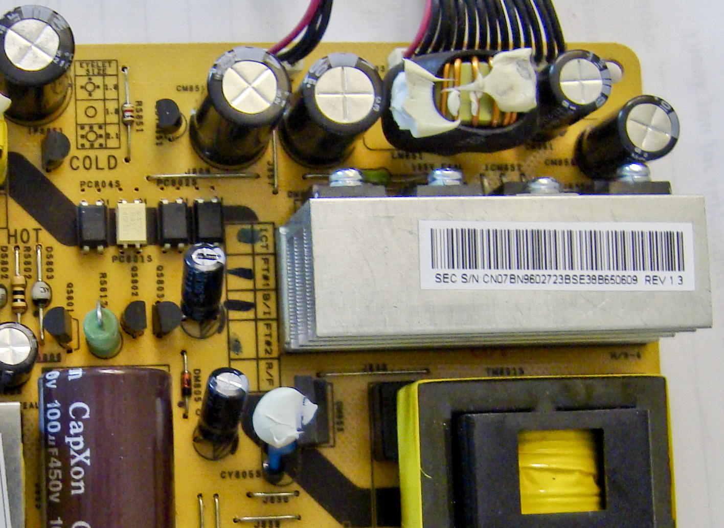

                                Since you are getting about 374vdc on the large cap, it means that the PS_ON is OK, same for the PFC Voltage booster circuits. Can I get good clear pictures of the bottom side of the board, and four 1/4 section of the board so I can clearly see the trace, I need to see how the 24V power supply is made. Do the same for the top side also.
                                If you look at the picture of the power supply board in post 1 you will see large thick black line drawn on the board, the area in the left of the line is the deadly Primary side (the negative leg of that large cap is the ground ref point for the Primary side), the area to the right of the black line is the secondary side (cold side), the ground ref point for this section is tied to the chassis ground.

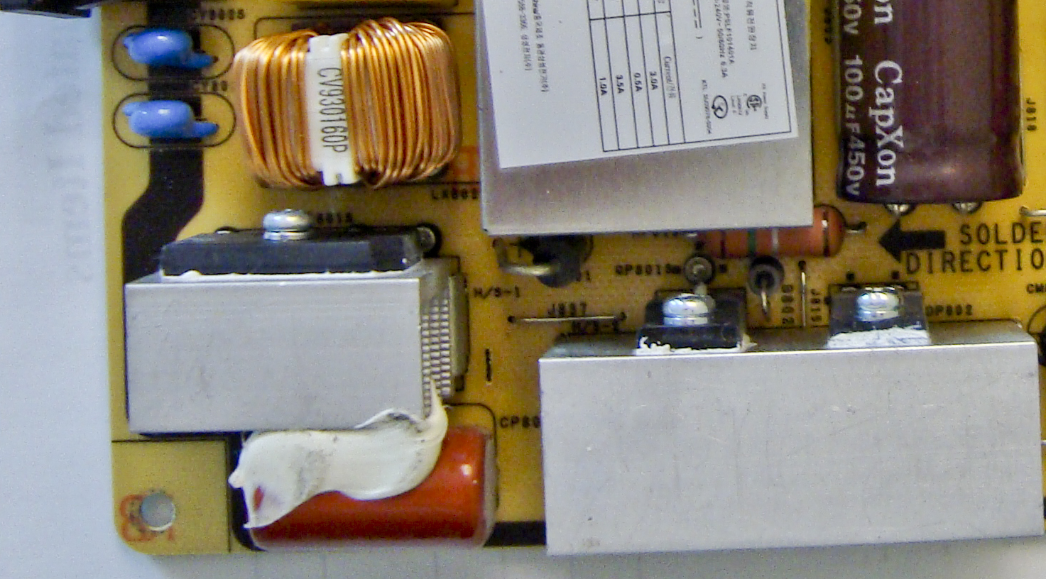

                                  The main thing that caught my attention in that link I sent you was the fact that not all the caps were replaced. Looking at your board, I noticed that one of the caps had a black mark (from a marking pen) on top of it. Typically, this is something done at the factory and leads me to believe that not all the smaller caps were replaced. What brand is this cap? CapXon? Sounds like the repair person used Nichicon caps. Other than the large 100uf CapXon cap, are there other non-Nichicon caps? I'm thinking especially the smaller caps. Hopefully it's something as simple as the startup cap for the 24V section that needs replacing.
                                  As mentioned above, the PFC section is functioning and it looks like the secondary section for generating the voltages at the wiring harness is not working. The 24V section of the supply is what the other voltages are derived from.

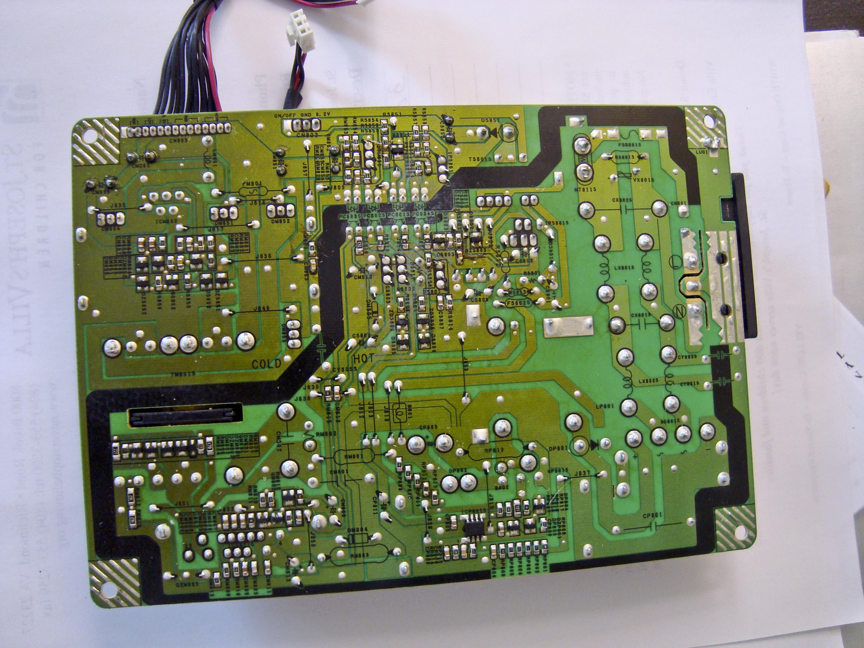

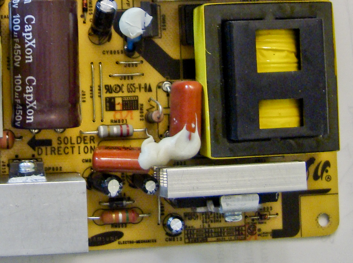

                                    Bud,
                                    Here are the pictures you requested. Let me know if you need any redone. And thanks for explaining the Hot & Cold side for me.
                                    Jet, good eyes. Yes, it looks as though he replaced the cold side caps with Nichicon (5 of them), but nothing on the hot side.
                                    When I asked the cap repair person if he checked the board after replacing the caps this was his reply: "We do just replace the caps and check those components to ensure they are installed and working properly. As for the power supply itself...that board is the power, and it does get power, so the board is working properly..."

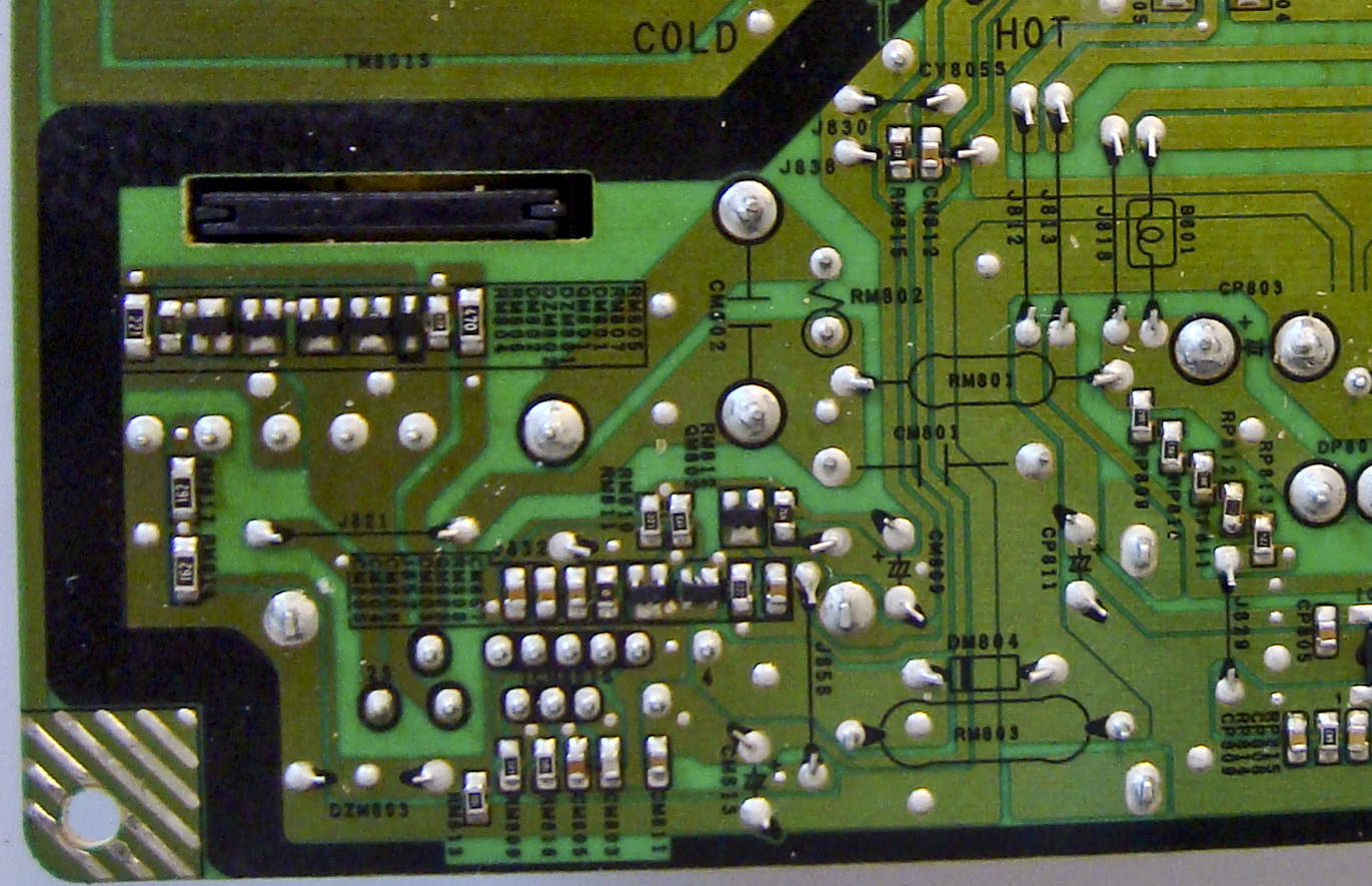

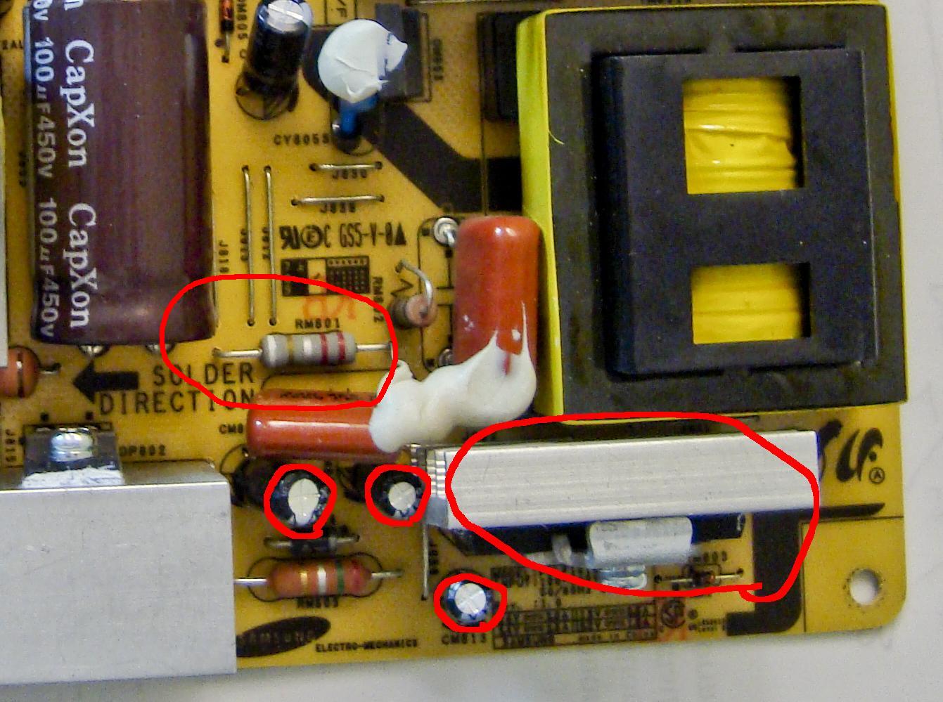

                                      Photos of both sides.

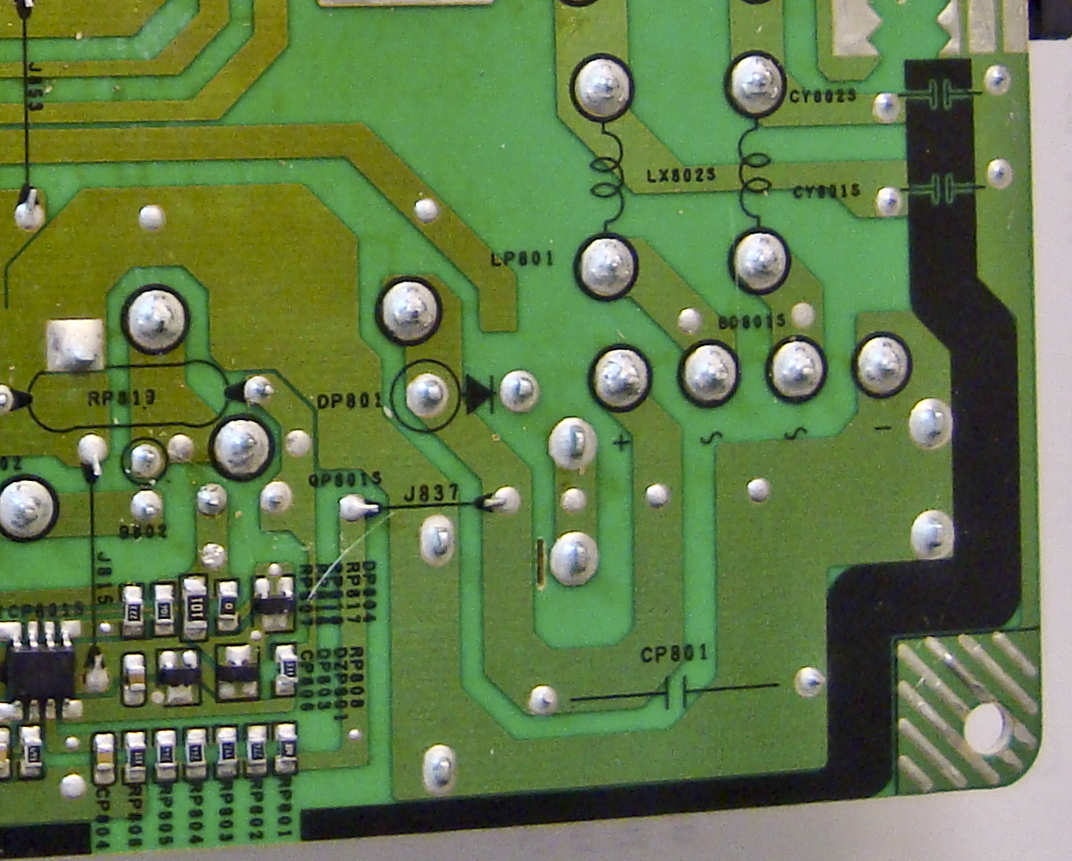

                                        Check RM801 (see picture number 2, 10) to see if it is open.
                                        Check those 3 caps, and need P/N of that IC (mounted on the heatsink) for driving the 12v/24v transformer, I have a feeing that the IC is bad.
