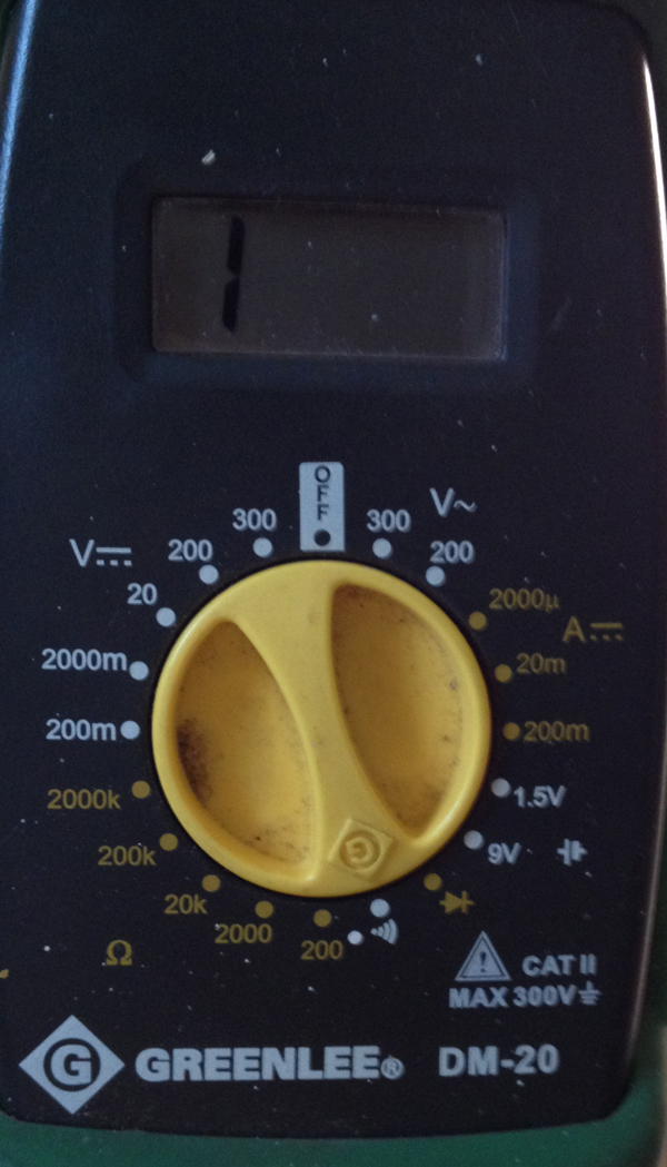

      I just updated the previous post, please see the attached picture. Please use the Ohm mode not Buzz mode since resistance up to 100 Ohm can make the buzz.
        Re: Sun 24.1 LCD / Samsung 244T
        Bud,
        Am just savvy enough to know how to do basics but not good enough to know which setting on my meter to use for
        1. checking the 3 caps
        2. checking the RM's
        If you'll show me which, I'll set it and get it done.

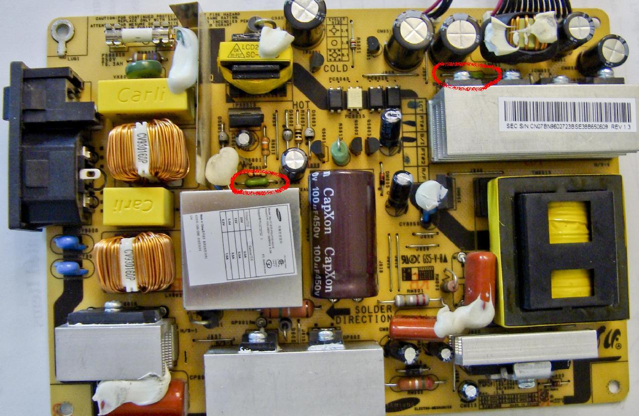

          Check RM801 (see picture number 2, 10) to see if it is open.
          I think budm means FM801 (pictures are blurry and "F" and "R" are close to each other on the keyboard). FM801 is a green torpedo shaped fuse right by the connector.
          A good fuse should measure less than 1.0 ohms.

            You might have another fuse on this board? Same green torpedo. See red circles.

              I think I see what budm's talking about. With power off, two of the resistors RM801 and RM803 I believe are under 1 ohm. Set your meter to 200 ohm and measure across each one. If I'm wrong about the resistance values, then adjust your meter until you get a proper reading.
              For the 3 caps, set your meter to 200V DC, plug in your monitor and read the voltage across each cap.

                It is RM801 (0.22 Ohm) for feeding the voltage to the 12v/24v SMP IC.

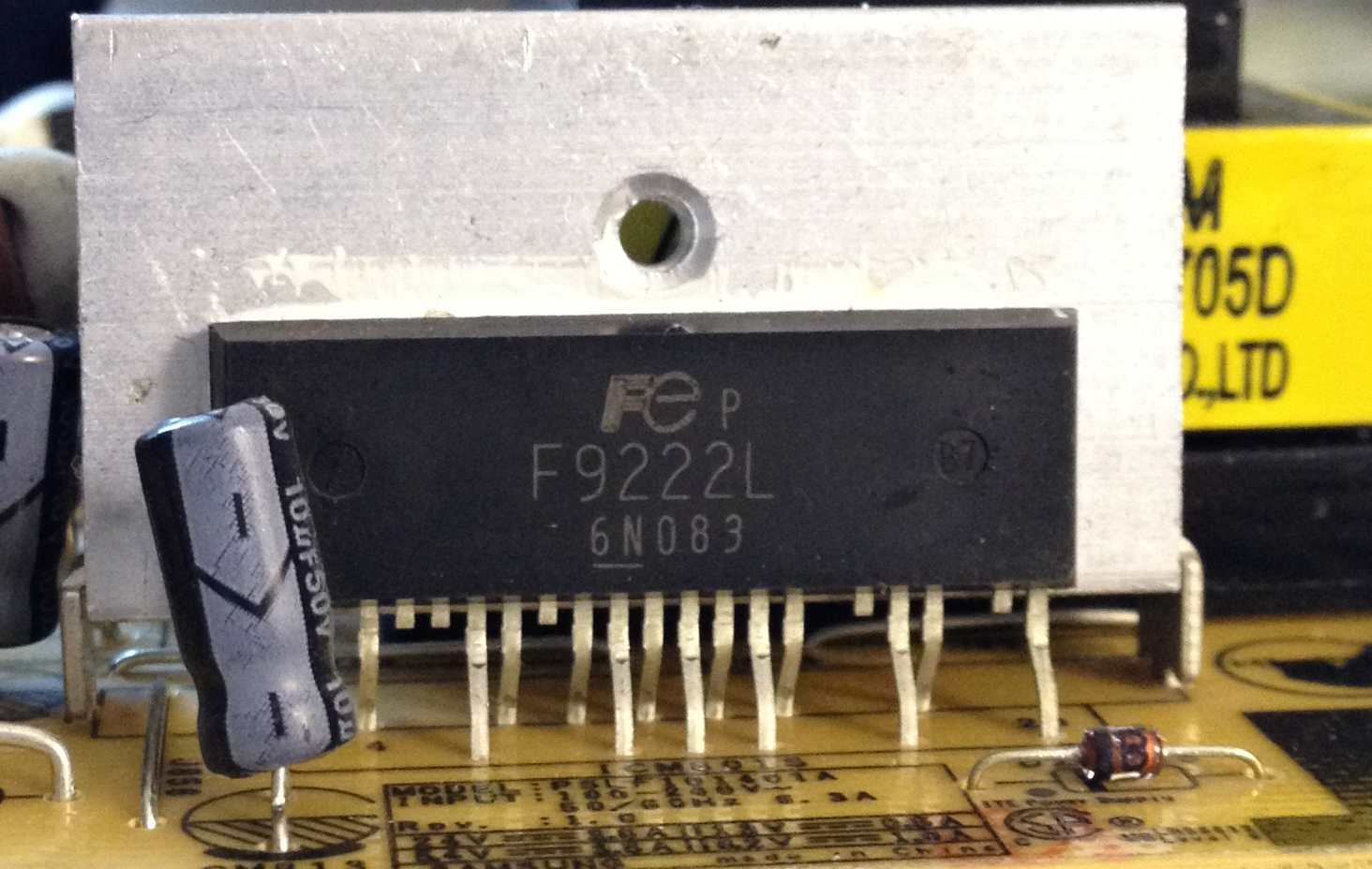

                  By the way, I believe that 10uf 50V cap in front of the F9222L is what was changed in the other link I gave you eariler.

                    I am hoping that it will be those 3 caps I circled.

                          Ok, checking those 3 caps with meter set to 200 VDC I get 0 volts.
                          RM801 .5
                          FM801 .3
                          FS802S .4 (green torpeda fuse)
                          Going back to my first post, does the fact that it died all at once upon turning it on one morning have a bearing on anything? No problems beforehand.

                            For my own curiousity, we can try checking the Vcc (pin 7) of the F9222L for a short. I'm assuming the following: that pin 7 of the F9222l is connected to the positive lead of the 10uf 50v cap (CM813) that's in front of it. With power disconnected and your meter set to 200 ohms, place your probes across CM813. What is your reading?

                                When I set my meter to 200ohms (bottom most setting on above meter photo) I get a reading of 1 before I touch CM813 and the same reading, 1, when I touch each wire.
                                  #36
                                  At 200 ohms, if you touch the meter probes together, you get approx 0 ohms correct?
                                  Try placing your probes across the cap, while increasing the scale: 2000, 20k, 200k, etc. to see if you get any reading.
                                    At 2000k I get 180
                                    At 200k I get 26.2
                                    At 20k I get 4.27
                                    At 2000 I get 564
                                    When I touch probes together I get essentially get 0 on the higher #'s. ie 20k or 200k
                                    Ok, I must be doing something wrong. After waiting about a half hour I retested and all showed 0 readings.
                                    Then I powered up again for about 10 seconds and shut down. Then I retested and got the original readings above.

                                      Looks like there's no voltage input to the Vcc pin of the F9222L controller.

                                        He will need to put the meter in DC Volt mode next to check the VCC at pin 7 and the ground pin.
