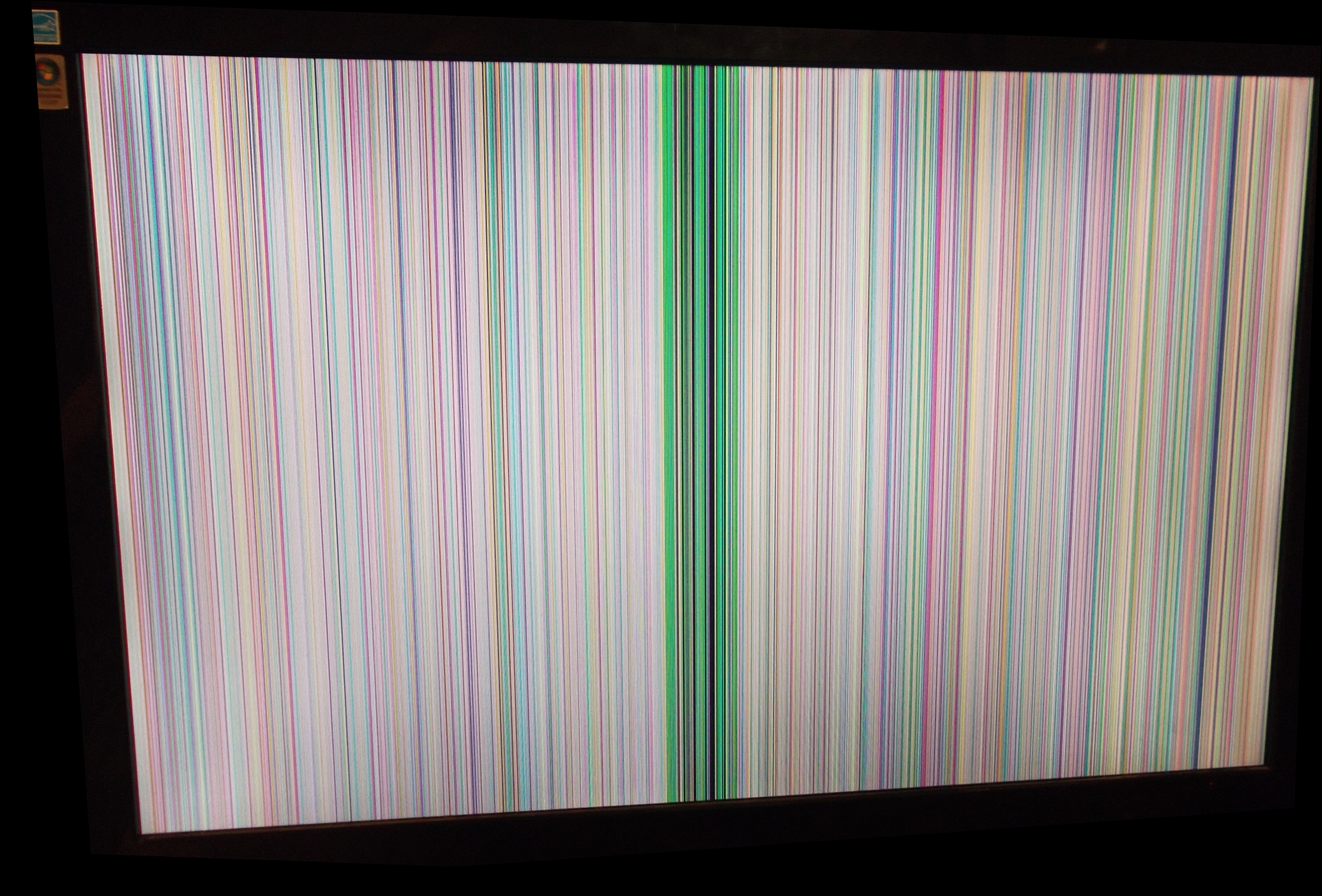

    --Just inherited a Westinghouse L2210NW Monitor. I have not opened it up yet, as I have to many others in pieces at the moment. But, it shows the typical power on problems caused by the original Samxon caps. I finally managed to get it to come on, but the picture is all vertical stripes (see picture). Could this be caused by a bad power supply? If so, I will crack her open, take pictures, and order good Digikey Panasonic Caps, immediately.

    I have seen this in TV due to bad caps in the power supply, but also seen them due to bad T-CON board.

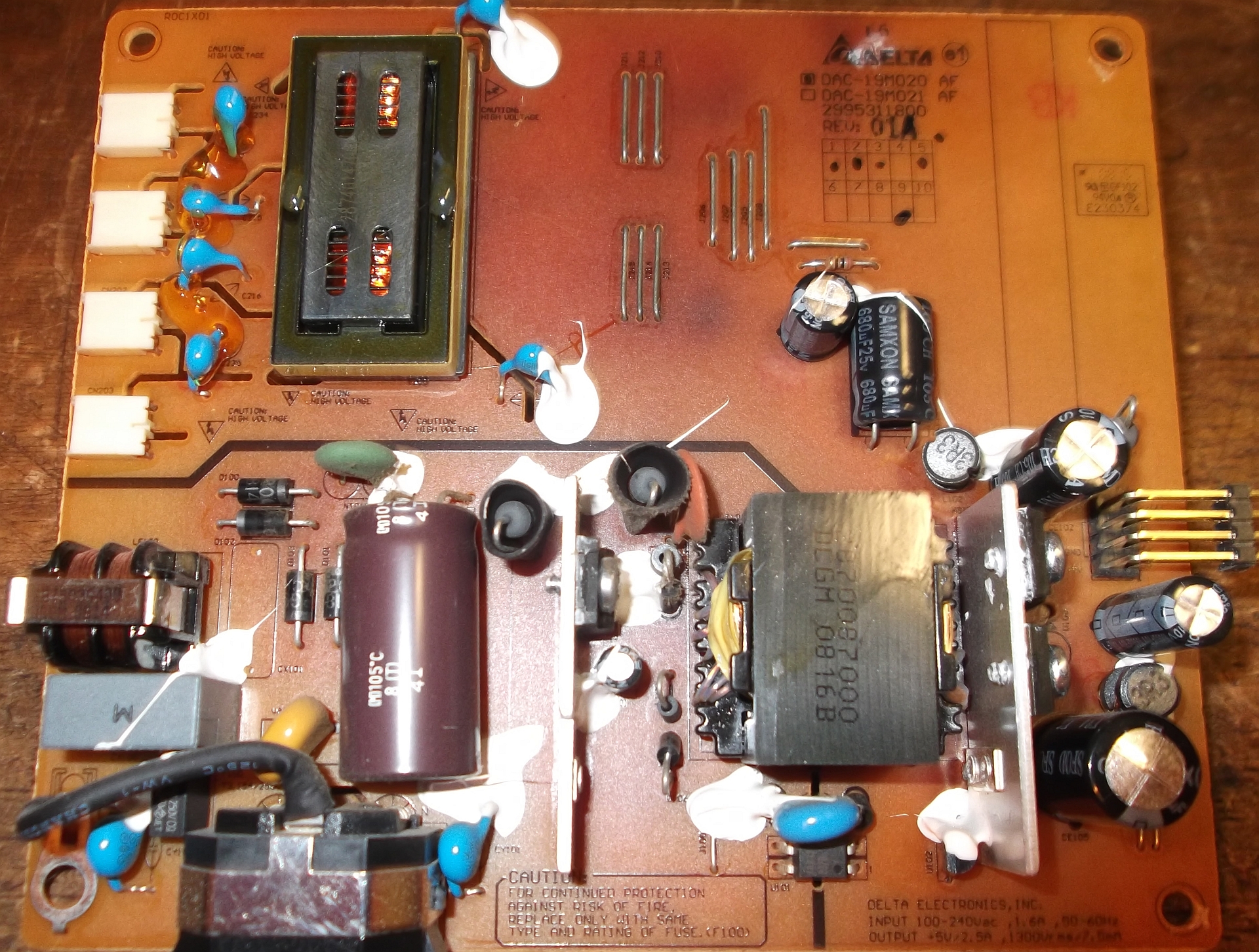

        --Well I opened her up and the P.S. board shows obvious signs of overheating (see picture). The Label for this unit shows May 2008, which I assume is a refurbish date. The 2 Watt 100 Ohm Resistor measures 296 Ohms, and surprisingly only one of the Capacitors (the domed one) measured bad. Of course I was not testing at the actual voltages encountered in the P.S. Below is a list of the results.
        Westinghouse L2210NW P.S. Bad Parts List
        100 Ohm 2 Watt Resistor measures 300 Ohms Bad Replace with 3 Watt.
        2200 uF 10 V Cap measures Unstable&Domed Bad Replace.
        1000 uF 25 V Cap measures 937 uF ESR is normal Good Replace anyway.
        1000 uF 10 V Cap measures 956 uF ESR is normal Good Replace anyway.
        680 uF 25 V Cap measures 600 uF ESR is Normal Good Replace anyway.
        220 uF 25 V Cap measures 196 uF ESR is Normal Good Replace anyway.
        82 uF 400 V Cap measures 76.3 uF ESR is normal Good Replace anyway.
        33 uF 35 V Cap measures 33.2 uF ESR is normal Good Replace anyway.
        --I have placed an order with Digikey good Nichicon and Panasonic Caps and the Resistor. I will report back when they are installed.

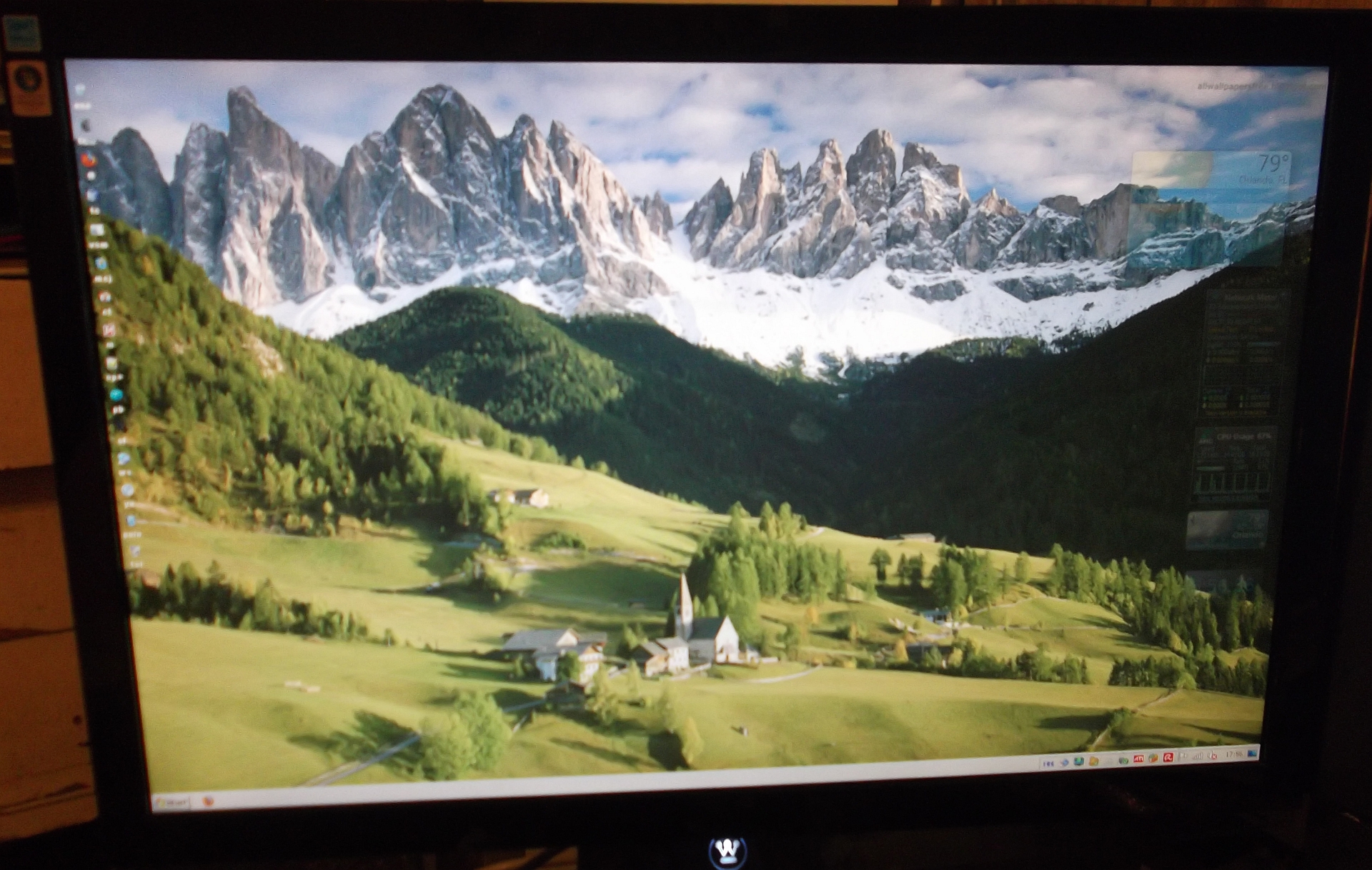

          Replaced the caps and the resistor. Now like new. See attached. Thanks

            Great job and thanks for the good news, it is really hard to be 100% sure that the problem is T-CON or bad power supply.
