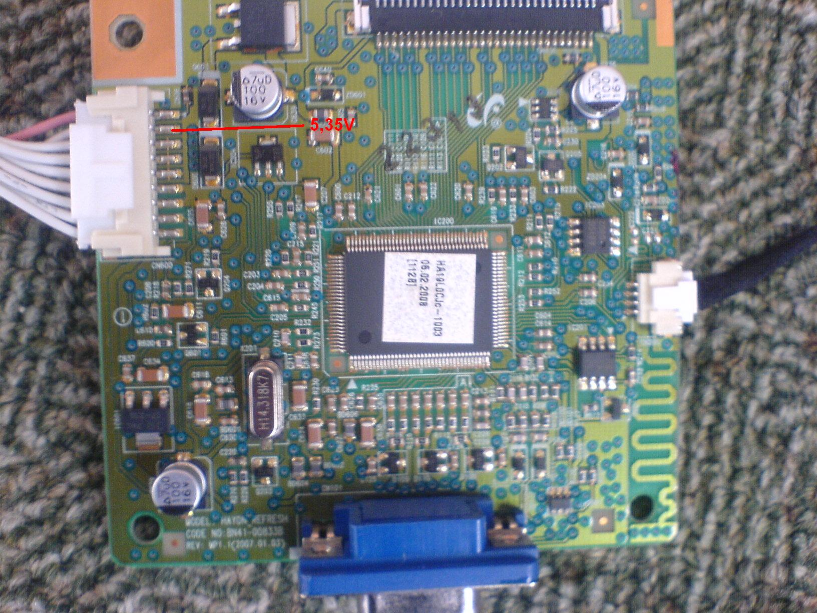

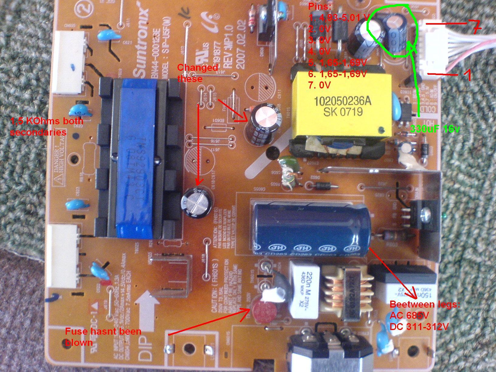

    The power board supplies 4,8V on third pin (pin3: 4,5V) the connector that connects logic board and power board...
    Also I can measure 5,3V on the logic board as u can see in the picture

      Yes based on the voltages you have on the VRs on the board they are
      faulty BUT they can be tested agian off the board with a battery. I will try and find how to do it - it may even be in the guide.

                            Re: Samsung 940n wont turn on
                            The 1,8V gives
                            pin1 0V
                            pin2 1,8V
                            pin 3 7,68V
                            What now?
                            And just to experiment, i put black probe on housing solder and than on pin1 it gave -1,8V so that means the housing is connected to the second pin and thats ok? That means the housing is output and pin3 is input?

                                #35
                                something is gotta be wrong with the power board since the voltage regulators are only getting 0,7V for 18 and 1,6V forr 33...
                                my only idea is to change the capacitor on the picture, and itยดs not even a crapxon :/
                                    So buying a new power board wouldnยดt be a clever thing to do since the problem still could be in the logic board?
                                    • Rtech
                                      • Jul 2010
                                      • 1095
                                      #38
                                      Correct.The problem can be either that the Logic board has a fault which is pulling the 5v input from the Power Supply board down,or the power supply cannot give enough CURRENT out to maintain its 5v output if any load(ie the Logic Board) is placed on it(sometimes that can be caused by a bad cap).To try and pinpoint the problem,then you need to do as I suggested by measuring the 5V output from the Power supply board, when the logic board is connected,and when it is then taken away.
