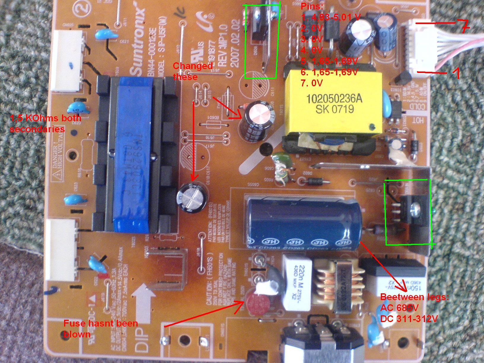

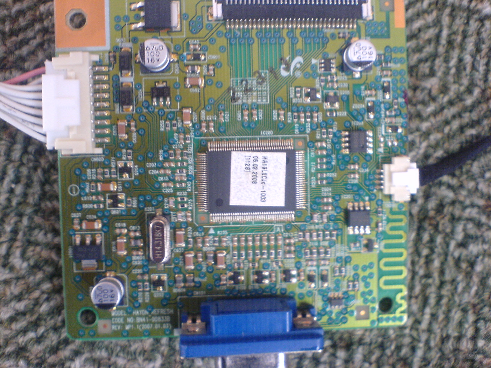

    Before I start typing, I wish everyone merry Christmas and a happy new year...
    My problem is I have a "wont turn on" samsung 940n, changed caps except the big one and the small one right next to the connector of the logic board...
    Also I changed the inverter transformer since I didnt own a multimeter so I suspected the trafo is dead.
    Done that and it still aint working. Just wont turn on.
    In the attachments I put the pictures with the measurments of the main and the connector, also I can do any other measurment with the instrument that I put in the attachment if anyone can help me, thx in advance.

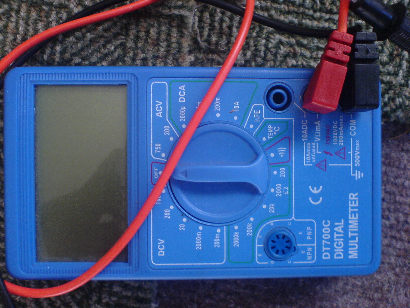

    Ok you say you didnt have a multimeter -Have you got this blue one since then.
    If so can you switch it on and say or picture the reading on the meter, then again with the probes together.
    Haha - just looked at the pics you are now using the multimeter.
    were the boards all connected up when you did the tests
    pic could do with being a bit sharper and do not clip the ends of the boards off

      I said I didnt have the multimeter when I suspected the transformer is dead so i replaced it with a new one... Now I have this blue one and I can measure anything you want me just say what. Iยดve put the measurments on the pic in the attachemnt.
      And sorry for the low quality images, I dont own a camera, I took pictures with a mobile phone.

        The logic board was connected to the power board and the power board was connected to the AC. I only did not connect the screen.

              OK - On the main board there are two voltage regulators. I think the top one may say
              on it 1117-18 the other may be ????-33.
              Can you test them as per this guide written by retiredcaps - just ask if you dont understand.

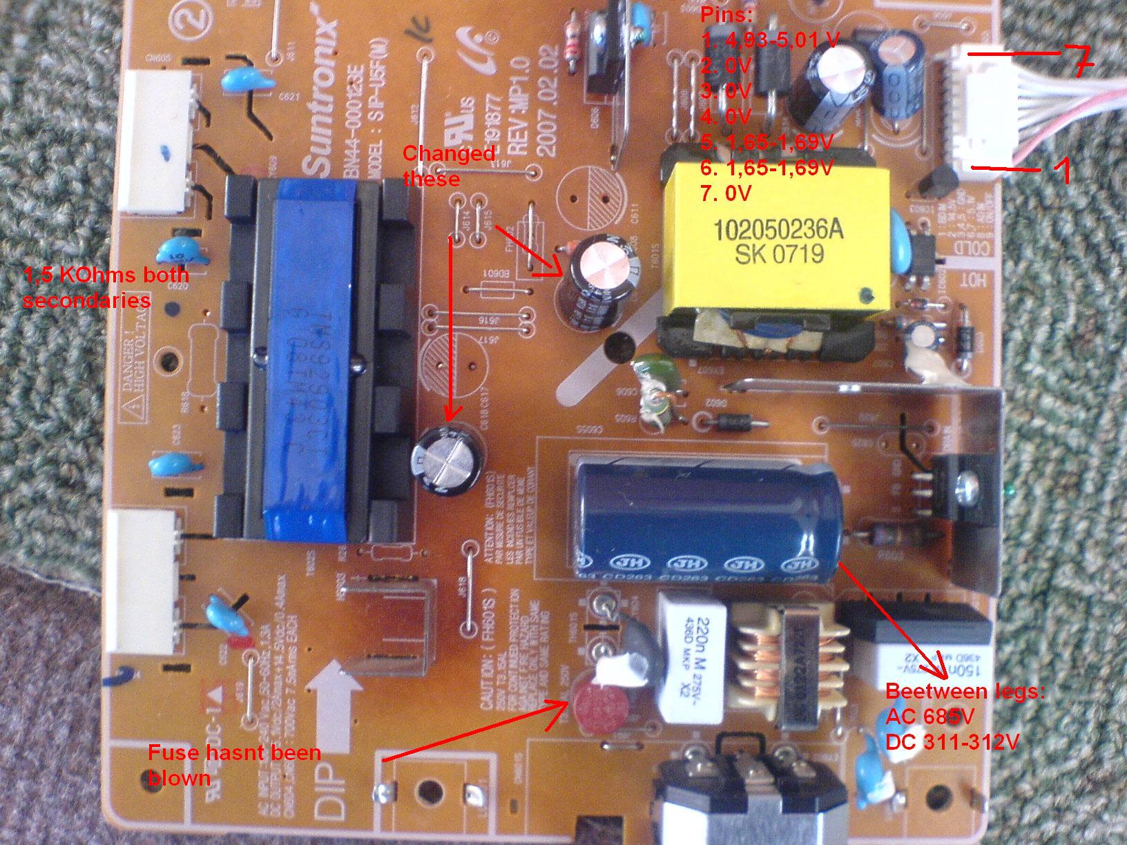

                Re: Samsung 940n wont turn on
                I tested those transistor looking parts circled in green (see attachment)...
                The one right next to the main cap has readings:
                pin1 0v
                pin2 -108,1 to -108,3V
                pin3 (this one goes up and down so i am not sure) goes from -38 to 53V
                The one in the top:
                pin1 0V
                pin 2 4,8-4,9V
                pin3 0V
                • selldoor

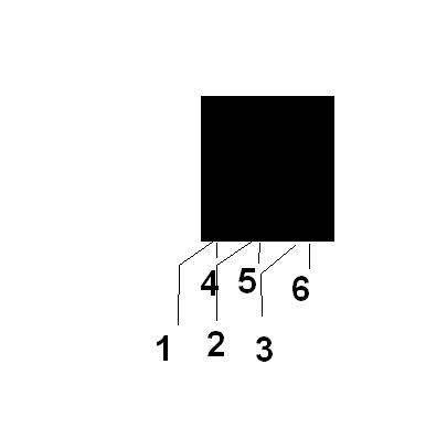

                    sorry, just noticed the one beside the main cap has 6 legs, here is the picture that shows which legs I measured.
                    pin 1 -110,3 to -110,5v
                    pin 2 -110,2 v
                    pin3 -35 to 58V
                    pin4 108,1v to 113,7V
                    pin5 -100,8 to -101,3V
                    pin6 not soldered
                    The one near main says DH22 DM0465R
                    supposably http://pdf1.alldatasheet.com/datashe...SDM0465RB.html
                    The one at the top says EN210A 7525EN
                    cant find nothing on this one

                        The main board? U are refering to the logic board with the VGA connector?
                        I dont understand are the voltage regulators ok or they sholud be replaced?
                        I pluged in the logic board and measured the voltages on the 7 pion connector again and there is no change in the measurments.
                        • selldoor
                          Slow Learner
                          • Dec 2010
                          • 7870
                          Yes Main board = logic board.
                          The two regulators provide a steady 1.8vdc and 3.3vdc usually derived from the 5vdc.
                          These lower voltages are used for signals between the boards.
                          When you plug in the boards should immediately have 5vdc (which you have on Pin 1 on the connector.) When you press the on button the logic board sends a voltage blip
                          (usually 3.3vdc) to the Power supply (possibly on PIn7) telling it to start up the higher voltages. (14vdc)
                          I dont know if the voltage regulators are ok that is why I asked you to test them
                          in accordance with the guide.

                                  Sorry mis-communication voltage regulators are here
                                  • CroTech
                                    Student
                                    • Dec 2012
                                    • 149
                                    • Croatia
                                    The upeer one is 17-18 0743FG
                                    readings:
                                    pin1 0V
                                    pin2 0,08-0,09V
                                    pin3 0,7-0,75V
                                    the lower one is 17-33G
                                    readings:
                                    pin1 0V
                                    pin2 0,7-0,75V
                                    pin3 1,56-1,66V
                                    • CroTech
                                      Student
                                      • Dec 2012
                                      • 149
                                      • Croatia
                                      So? Those regulators are both fixed regulators...
                                      suffix 18 which means 1,8V so pin1 + pin2 should give 1,8V and thats not true, so it should be replaced?
                                      suffix 33 means 3,3V so pin1 + pin2 should give 3,3V which is also not true, so it also should be replaced?
                                      Checked the readings a few times and same results
