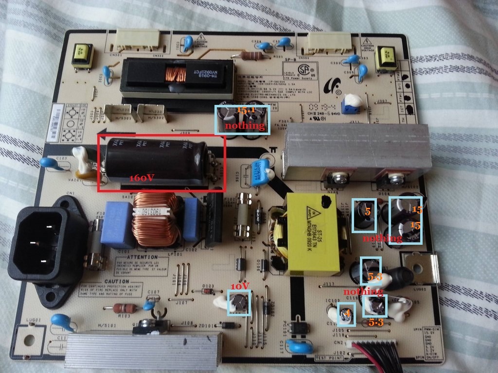

      I thought the main board was the board with all the inputs >.>
      Perhaps it's best to explain everything in Layman's, my knowledge on these things are very limited.
      and I've tested the fuses, they are fine. 0.25 ohms on both

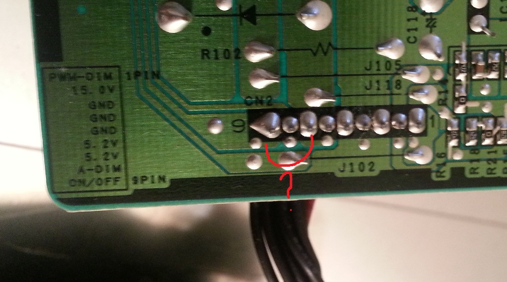

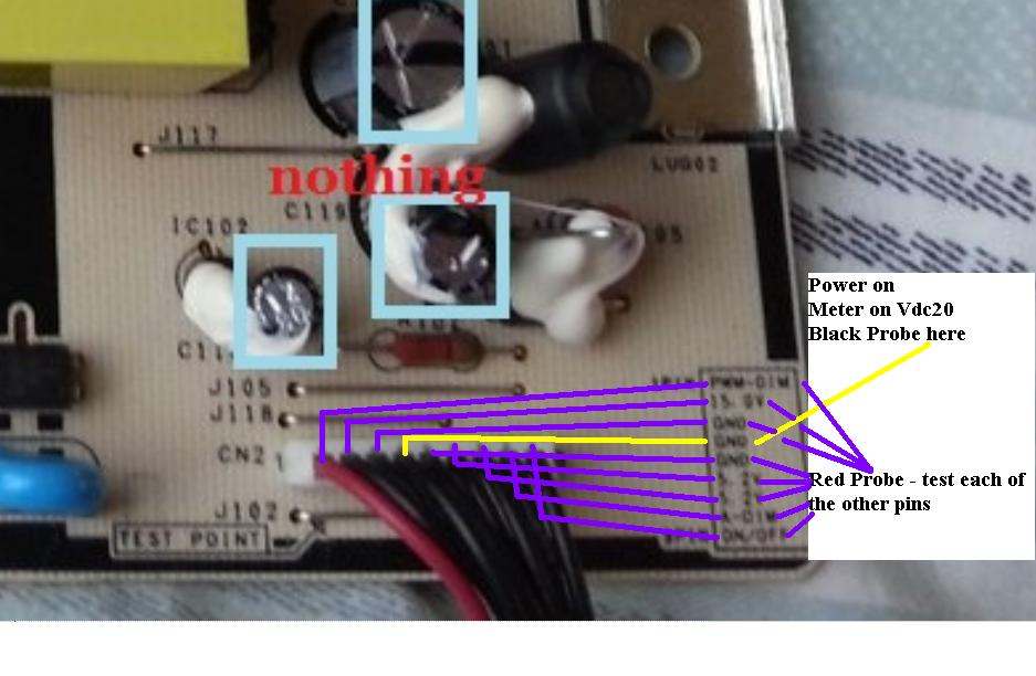

        Originally Posted by selldoor View Post
        OK With your meter on VDC 20 put the black pin on pin 4 and with the red probe touch
        the other pins and report the results.
        Board needs to be plugged in to the mains. Still take care although you are measuring low voltages parts of the board are still high.
        Originally posted by selldoor
        Not really getting through to you are we?
        The above test is to be carried out with only the power supply plugged into the mains - no other boards for the moment.
        The pins are on the connector CN2 in the same corner that the voltage list is
        That is as Layman as I get but here is a picture

          Re: Samsung T240HD won't turn on
          ahhhh that makes so much more sense, thanks!
          I'll get on it and report back.
            finished testing, as marked, one returned 15v and two returned 5.2v
            all others are 0

              So the next step is to connect the other boards,and then take the same measurements again,and see if you still get the 15v and the 5.2v

                they are close to 0 now. might have seen the 15v jump to 1v a couple of times.

                  Looks like it is the Logic Board that is faulty then,you already checked the Voltage regulators on there ??

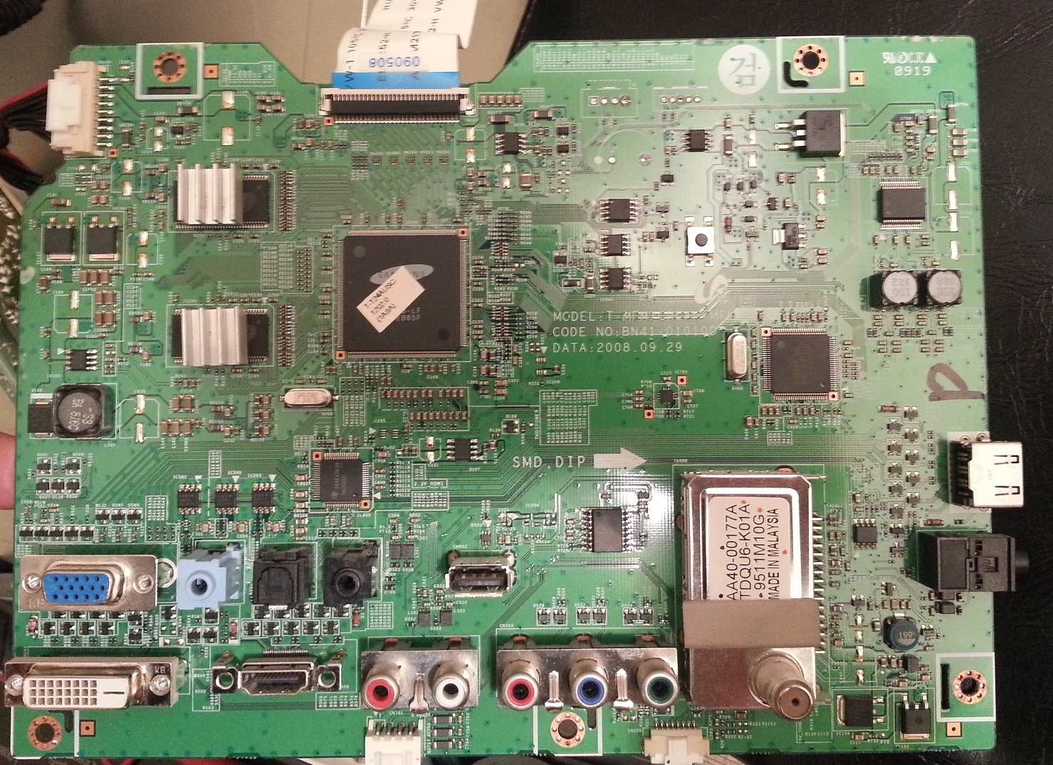

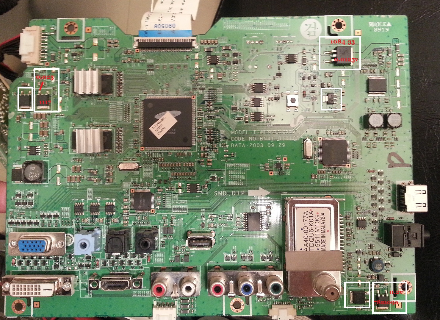

                    No, He has not.
                    In the picture of the main board, thoughtfully placed upside down! on the left hand side bottom just above the screw hole there is a black square component with 2.5 legs.
                    On it I think it has a part number that has "33" in it.
                    I think it is a voltage regulator.
                    If you read this by retiredcaps you should be able to test it and find others on the board - we will need a better picture preferably the right way up to help.
                    https://www.badcaps.net/forum/showthread.php?p=261329
                    I notice in that picture that the board may be on an antistatic bag? If that is so please be aware that the foil on it is conductive and you should not be doing any tests with the boards sitting on it.

                      #30
                      that picture of the board is a picture I found off ebay, don't worry I'm not testing it on a antistatic bag.
                      I've read the guide on testing the voltage regulator, I'm not sure what it means by "Put your black probe on a ground screw". Does it mean I can just put the black probe on any large metal object? I'm not getting any readings out of any voltage regulators.

                          #32
                          Well thanks a lot. Just wasted my time looking at it then. I am off the case.

                            #33
                            I'm sorry you feel that way. When I uploaded that picture I thought it was a faulty power board so I didnt even take off the main board for a picture.
                            thanks for all your help so far, it was very helpful.
                            I've tested the voltage regulators (not sure if I found all of them). Most of the tests returned 0 except for the ones I marked in red.

                              #34
                              Find the pin that the 5v would normally come into the board on, and trace the track to the nearest Voltage regulator,obviously you have to do this with the board dis-connected because it is pulling the 5v down.Also Numbers on all, what you think are regulators will be helpful.

                                #35
                                I was thinking of just buying a replacement board if I can be 100% sure it's the cause of the problem. :\
