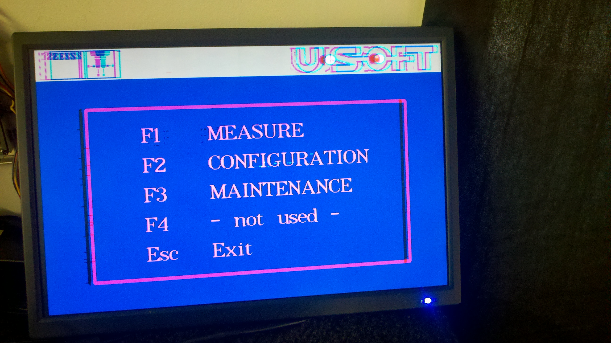

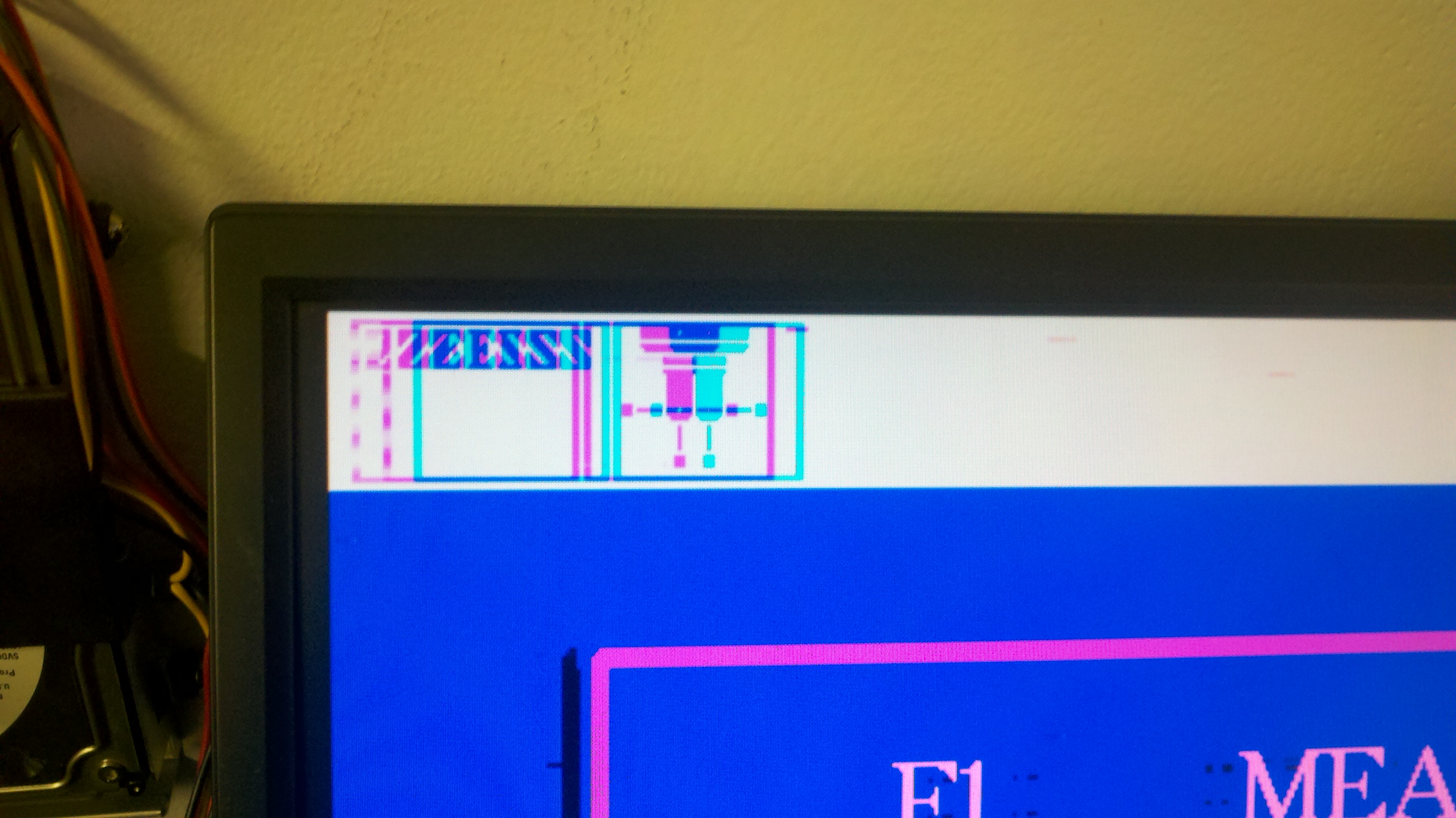

misconvergence in a cheap no name 19"lcd
    see pics.

      funny you are the only one who caught on!
      i will open it up and post the insides.
      problem was 4 22@16 sm caps on the old rage 2c in the system.
      monitor is fine.but the symptom looked so much like a projection tv with bad stk's i just had to do it.
      the monitor is a noname 1440x900. sometimes they are fussy to get set up.
