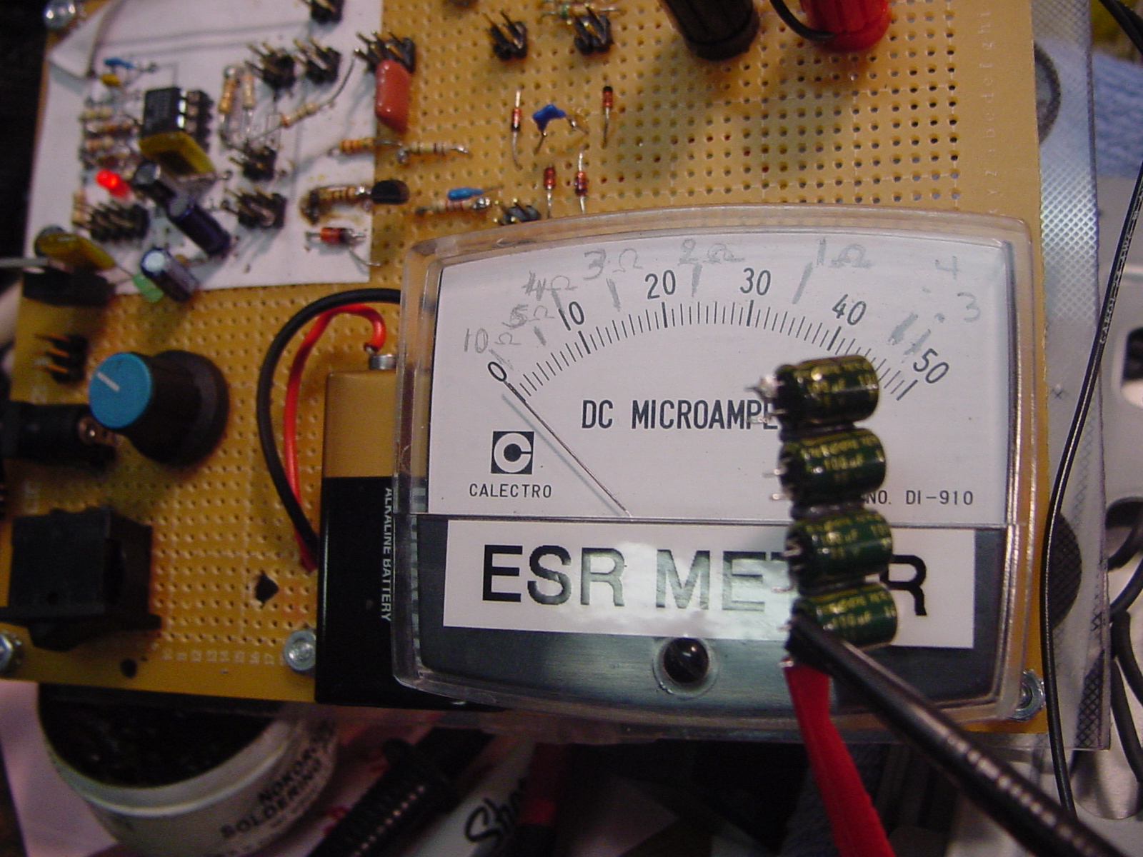

    So I heated up the 10 caps (100uF 35V) on the inverter board with hair dryer, the backlights then stay on.

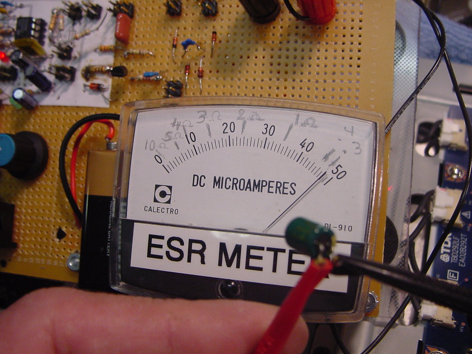

    Removed all 10 caps and check the capacitance, all are within 20%, check ESR with my home made ESR meter, 4 of them has >10 Ohms. I heated them up with hair dryer, then the ESR dropped down to 0.1 Ohm.

    Ahh, yes those EVL caps on the inverter board are always prime suspects.

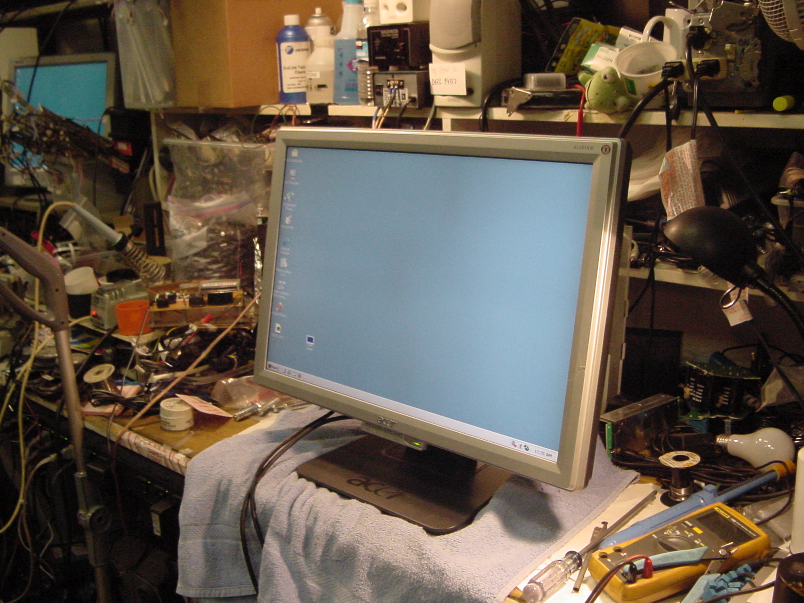

        You got a little lucky because normally the caps on that inverter board take out one of the transistors (P2804BDG or P5504EDG) and at least one of the white smd fuses marked with an "M". I circled them in red for anybody who reads this thread in the future.
        And the last picture with the working monitor made me very happy. Because your workshop looks just like mine. With everything exactly in its right place.

          Hair dryer in one of my best tool, been using it since the 70's, and ESR meter sure help explains what I am seeing. That is my work bench at the non-profit electronics recycle (www.crc.org) place that I do volunteer works fixing electronics every Saturday, I get free pizza, been doing this since 1995, hope to get bigger bench but we do not have that much money. All the stuff I work on (and post on photobucket) are all from this place.
