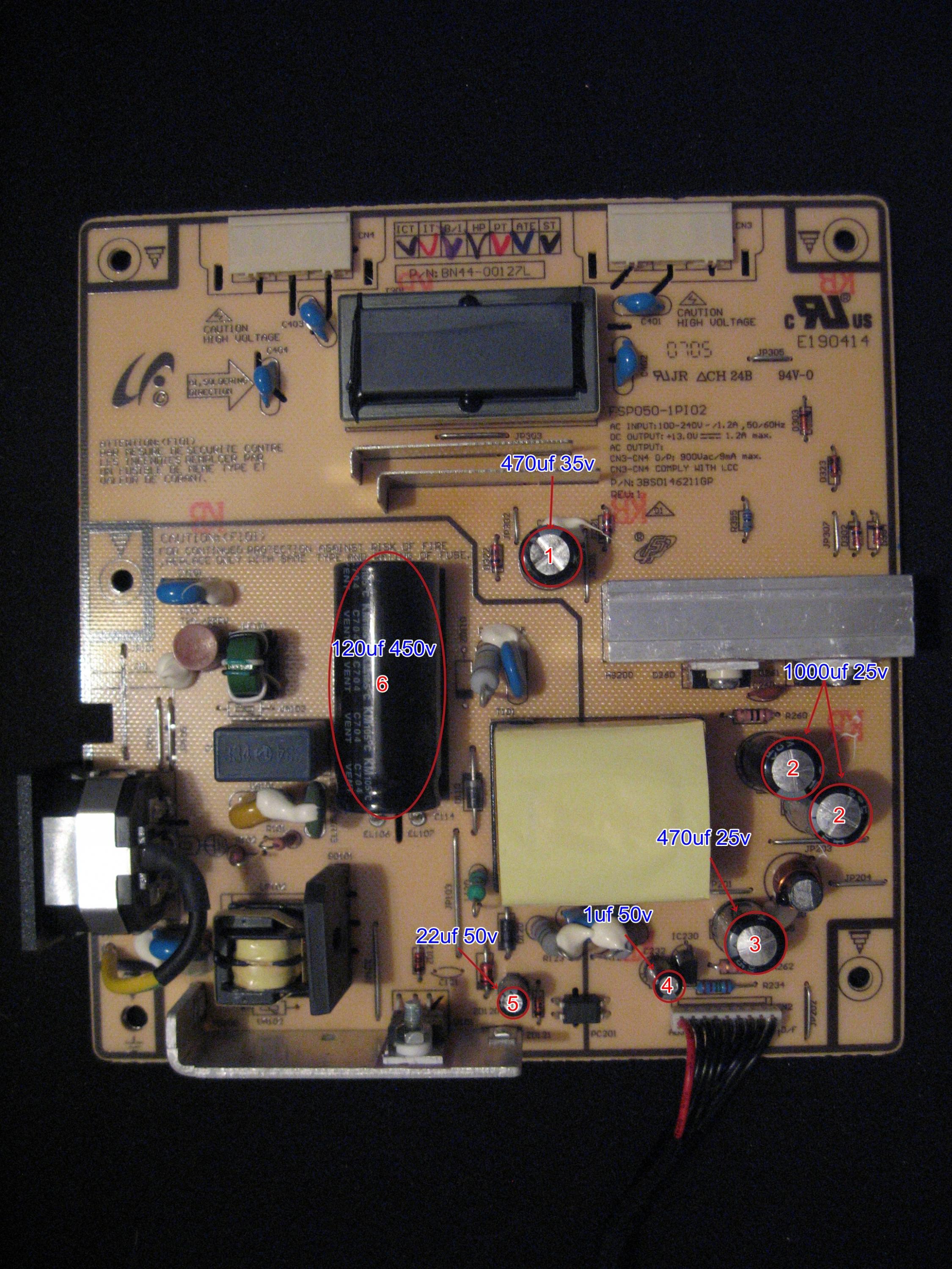

    I have a Samsung "BlinkMaster" 206bw with flicker of death. I have attached a picture with the caps noted. All are CapXon.
    1. 470uf 35v
    2. 1000uf 25v
    3. 470uf 25v
    4. 1uf 50v
    5. 22uf 50v
    6. 120uf 450v
    I am looking at the caps in the attached excel document.
    Have I chosen sufficient replacements?
    Thanks,
    -Chris

    It should work but you don't need to replace the big 450v cap. I've recapped a few of these monitors and never replaced the big one and never had any issues.
      Re: Samsung "BlinkMaster" 206BW Screen Flicker, Requesting cap selection help.
      Whilst Mr Bill has already said you probably dont need the BIG cap the one
      you have picked seems to have odd descriptions.
      It does say through hole but it also says snap in.
      The datasheet indicates only short legs so if it is a short leg snap-in
      You would have to solder legs onto it or use the existing legs -cut off. One problem might be that they are often fatter than a normal cap so you would have to check the space available.
        Yeah its the same as the last monitor I fixed just a different value. I cut the leads on the old cap and just soldered the new cap to them.

            Did you replace the big cap? That can cause the blinking sometimes.
              Yeah I just replaced them all for good measure.
                Did you have to extend the leads somehow for the primary cap, or were they long enough that you could bend them into the hole? Because the one you picked is snap-in... Good choices otherwise... Parts you picked are top notch.

                  I just cut the leads off the old cap and left them on the board then soldered the new cap to them.

                              I intend to try fix my 206BW monitor in a few days. (It blinks, so I guess the problem is with the three capacitors marked 2,2,3 in the image in the first post)
                              Is it necessary to discharge any capacitors prior to desoldering/soldering the faulty capacitors?
                              If it is, how do you recommend I do that?

                                Haggai - if the set has been un plugged for an hour before you start the caps should have discharged. You can check by testing across them with a multimeter set on
                                200 vdc. If they read 5 to 25vdc discharge them with a 1k or 2k 25w resistor. (Some just use a screwdriver! -less than 5v just go ahead and desolder it wont shock you.

                                  What about the other caps? Specifically the 450V one.
                                  If I don't short it and don't desolder it I don't have to worry about it? Can't it still provide voltage/current to the circuit part I'm touching?

                                    Okay, never mind, I just measured the voltage across the capacitors, and none (including the 450V) had more than a couple mV on them. The 450V had 55mV, I guess that's safe...

                                        Yayyy it worked!!
                                        Now let's hope those Nichicons I put there will hold better than the CapXon that bulged...
