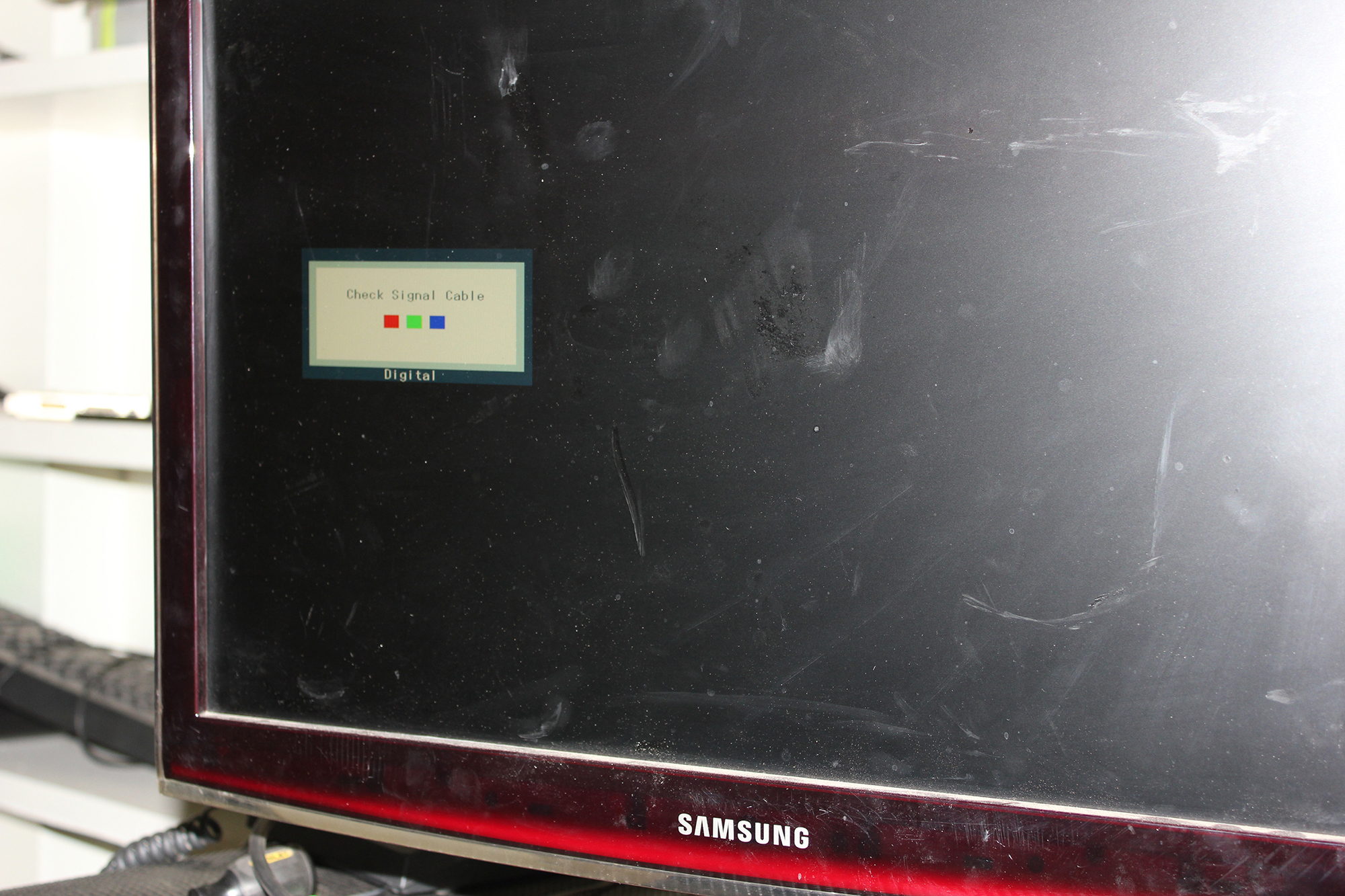

                              My initial issue was the power light keeps blinking and the monitor does not display anything and you need to cycle on/off a number of times before it functions normally. Then at one point it died on me.
                              I have somewhat nearly the same problem with my T220, I have gone and replaced most of the capacitors and re-checked the fuses as done by SuperDuty. The monitor now has power no more blinking red power indicator. It has:
                              -OSD
                              -Self-check
                              But still no display, when you turn on it cycles normally first displays the Samsung logo, black screen, source check, analog, digital, analog, digital then when its like it should now display the desktop screen it just shows a "blank black screen".
                              The menu works so that means it probably detects in the input but sadly no display.
                              Kindly advise what else can I do to check or remedy the issue.

                                Additional: When you press the "Source" button it shows that its trying to detect and it likes it has detected then when it suppose to show the desktop it's still a "blank black screen".
                                Also the "Automatic" works to reset the settings, you can lock or unlock the menu. But still no display coming from the computer. Am currently using the same computer on an old CRT. This is currently all that I've done so far, kindly advise what else can I do?

                                  Have you tried different cables between PC and T220.
                                  Try with the pc on its lowest resolution and turn dow the brightness
                                  to 30% and see if it makes any difference.
                                  Check that the lvds cable between main board and panel is secure.

                                    Tried every assortment of cable types:
                                    - VGA to VGA
                                    - VGA with DVI adapter to DVI
                                    - DVI to DVI
                                    No go, even if I set the computer resolutions differently it will look like its detects and should show the desktop but it still black.
                                    Okay will do post pictures, just need to find a decent camera. TY will post again.

                                        Re: Samsung T220 : no power at all
                                        LVDS cable is somewhat ok, I think but am already in the process of acquiring one.
                                        Below, self-test.
                                        With logo after power on, there is a 3 rectangle glitch on the logo. I suspect the LVDS I will change that as soon as I can find one.

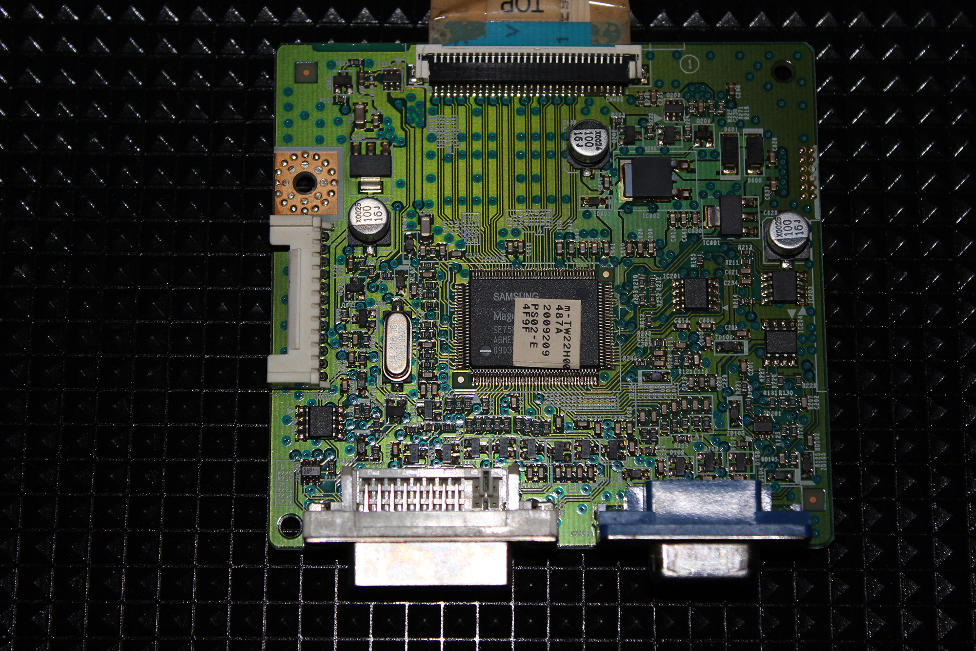

                                        Board that where the video cable connects to (front).

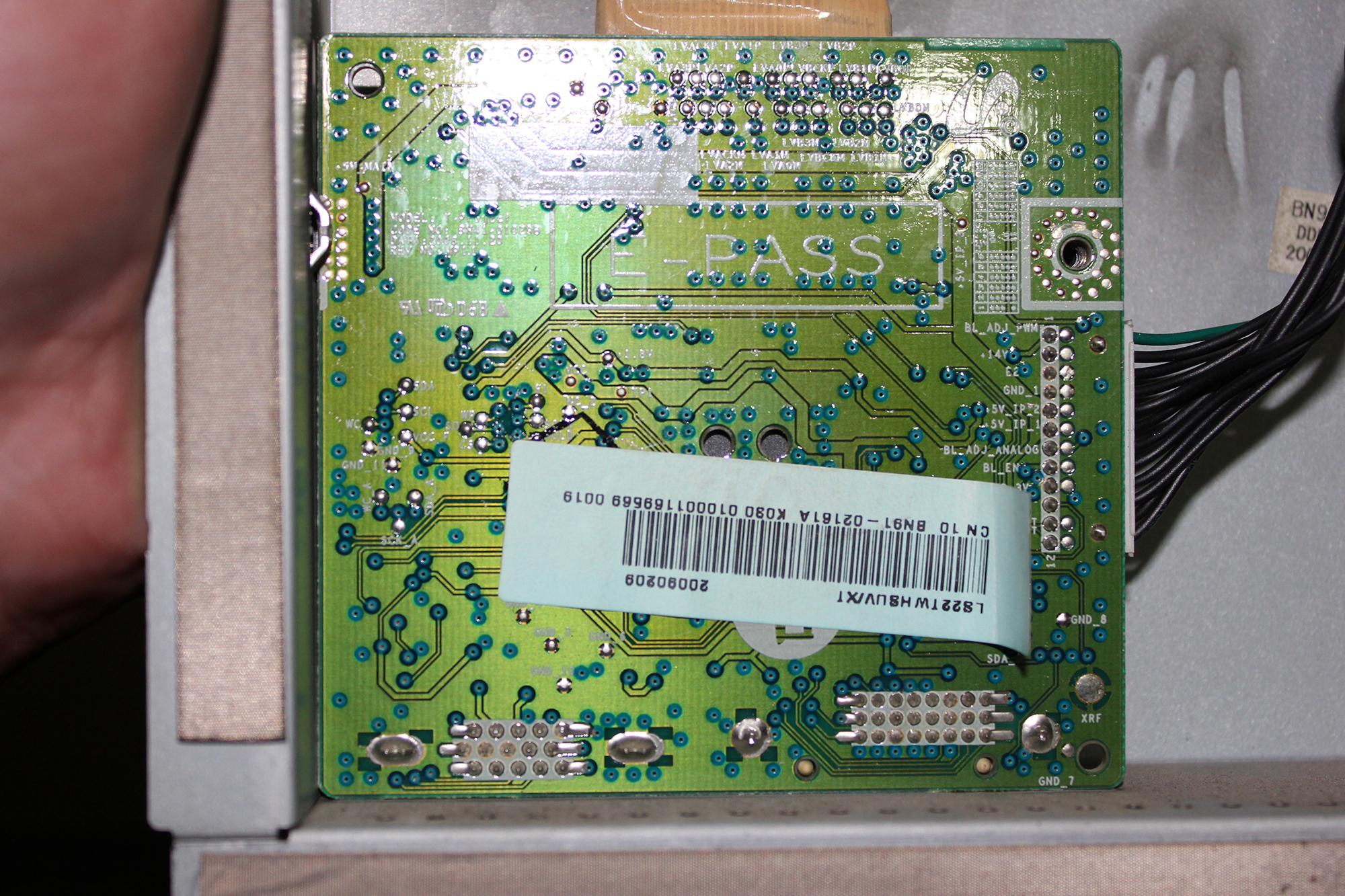

                                        Board that where the video cable connects to (back).

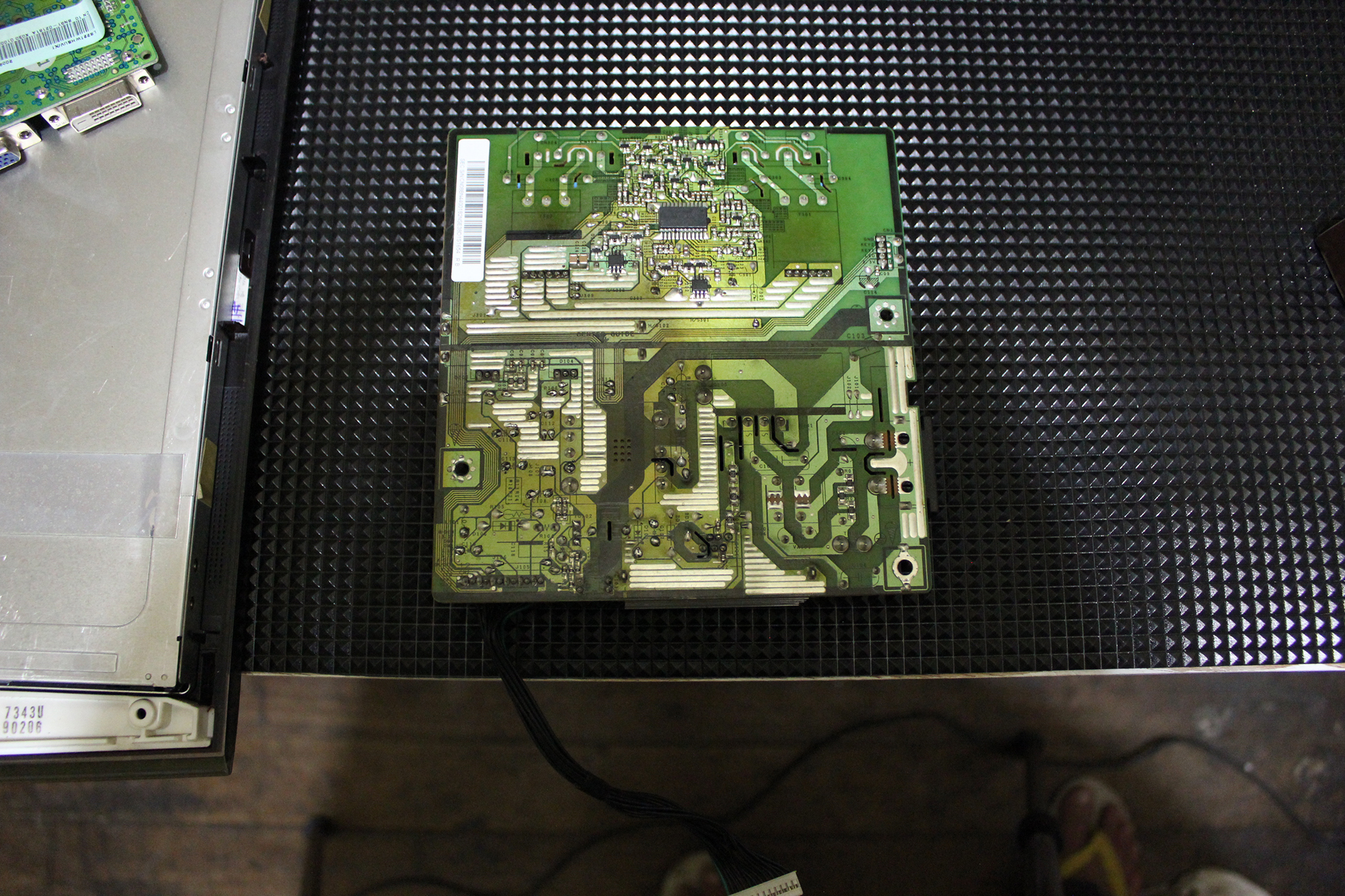

                                        Power board (front).
                                        Power board (back), some darkening caused by the bloated caps they were the 1000's.
                                        I've already replaced all the caps as I've mentioned on earlier on.
                                        Could it be the inverter or the other board, can you suggest how to test if either of those two? Kindly advise other tests I could do or what to replace. Also am testing the T220 along side my old CRT, I've tried changing resolutions and refresh rates to the lowest accepted. The T220 flickers (like it accepted the changes) as with the CRT when changes have been made. After it flickers blank screen again on the T220, but on the CRT the changes took effect.
