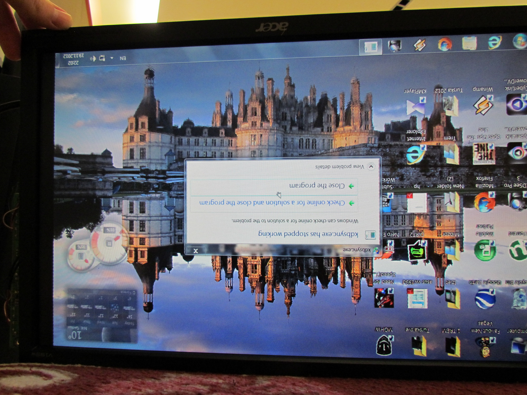

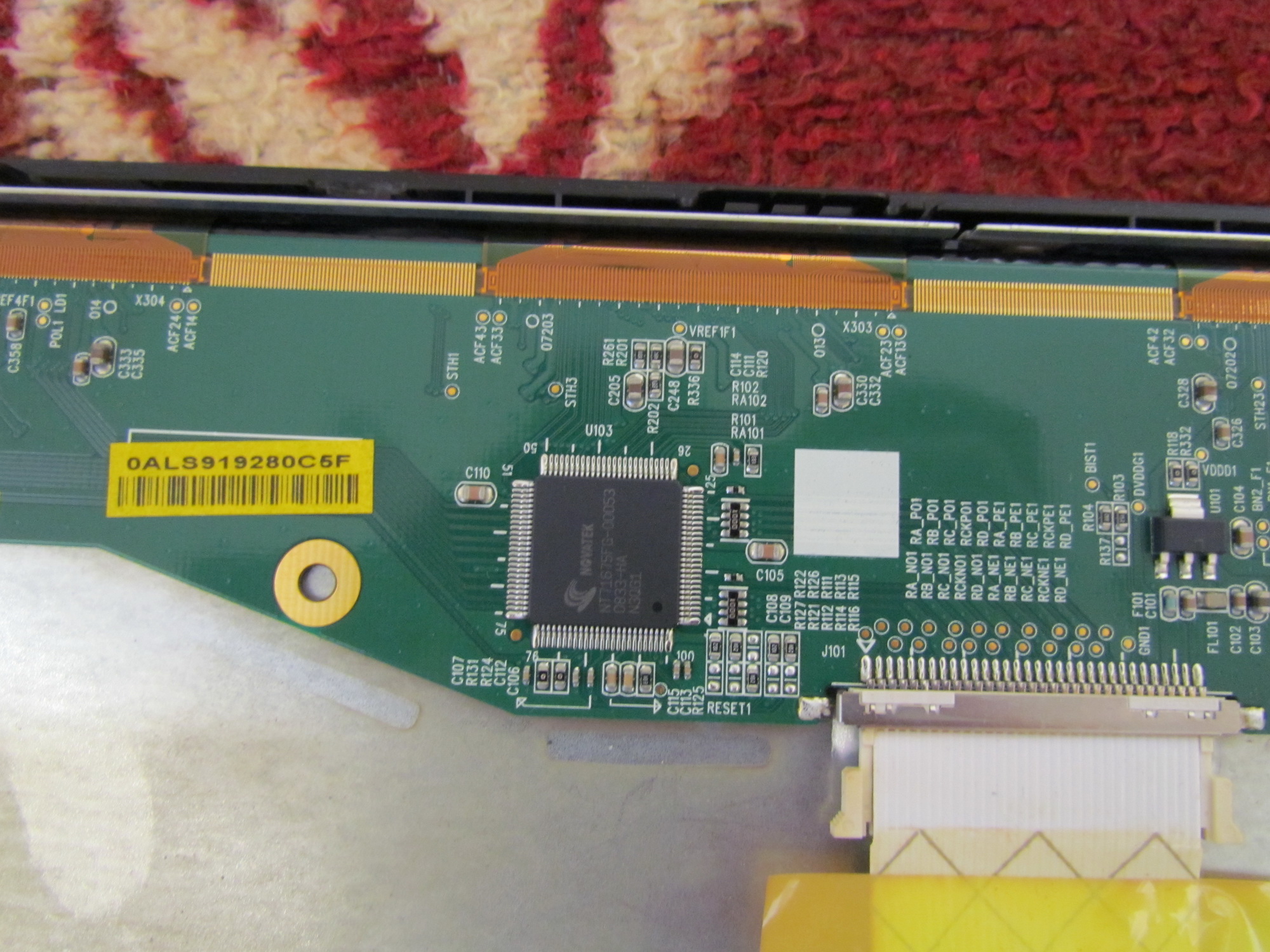

    This monitor has strange problem to me.

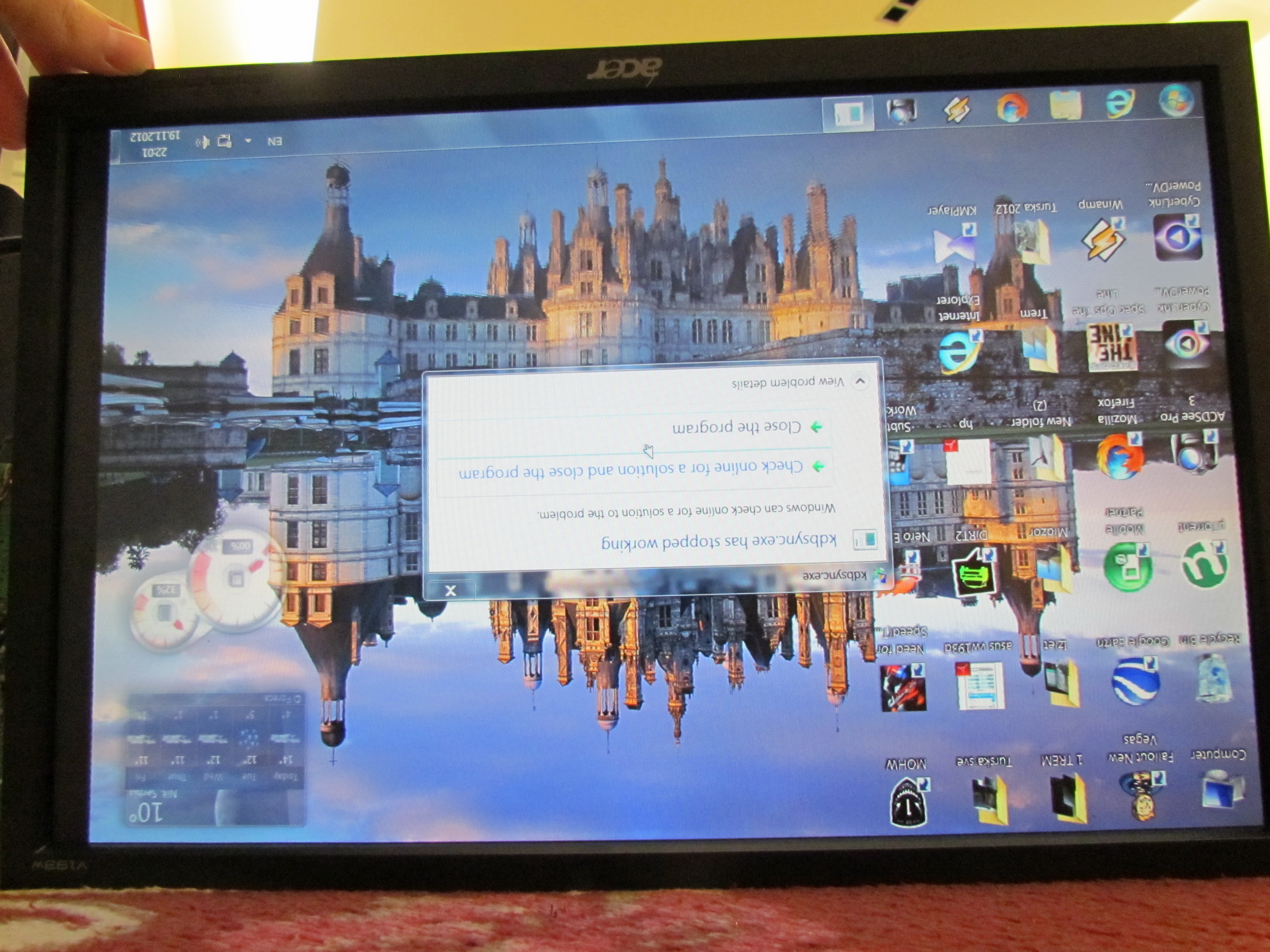

    When computer is booting there is a picture of start up and after that is gone.
    When computer is up I have to press power button twice and I get the picture.
    Picture is not all over the screen and lines are not straight and looks like it's floating.
    I did some pictures of that.
    When I change frequency at it's maximum 75 Hz, picture is gone.
    This monitor was checked from one guy who is fixing tv, monitors, audio equipments etc and he told me that he replaced some capacitors and checked other components as well.
    He suspect on processor and main board.
    I want your opinion and help to solve this problem.

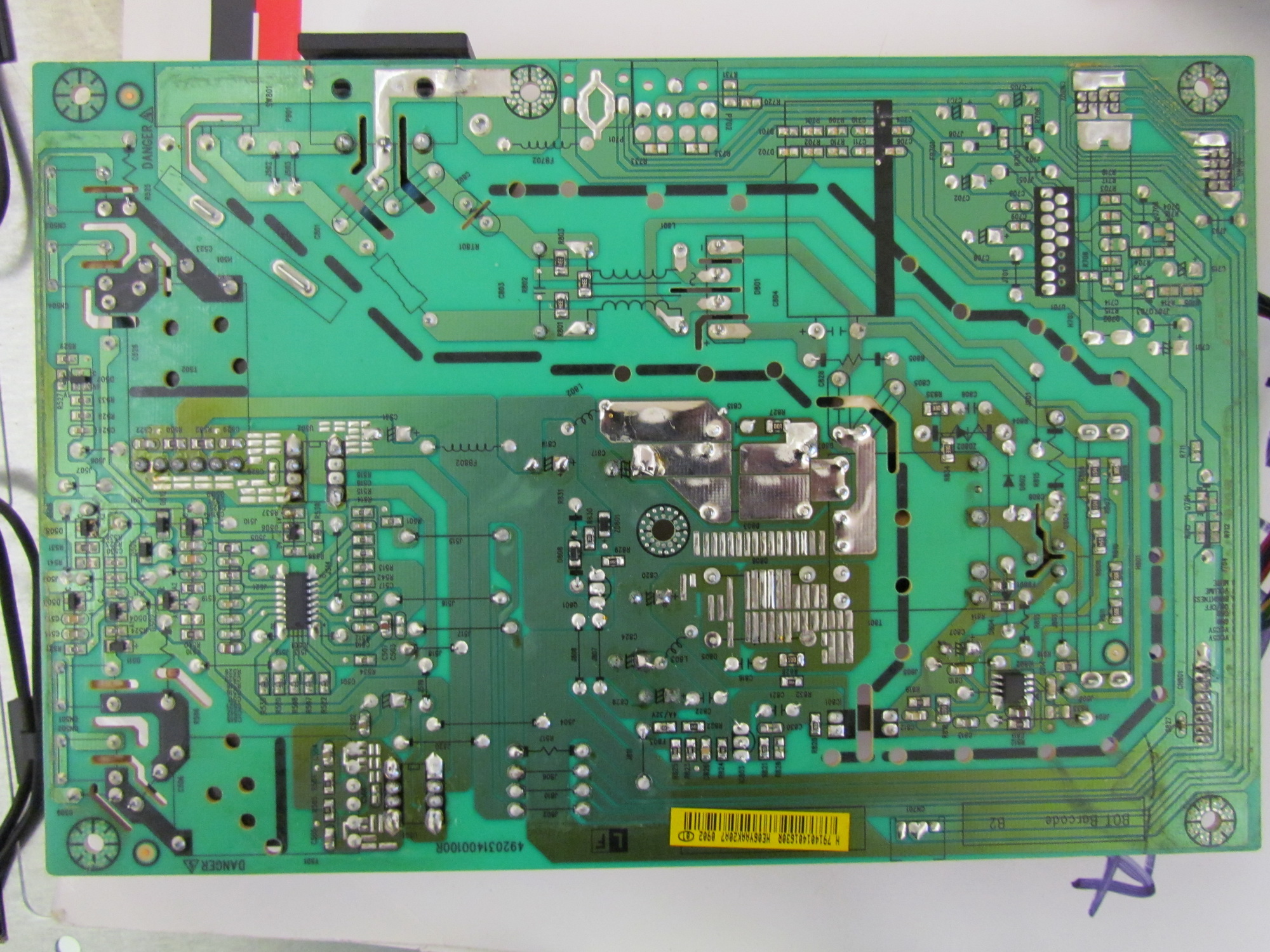

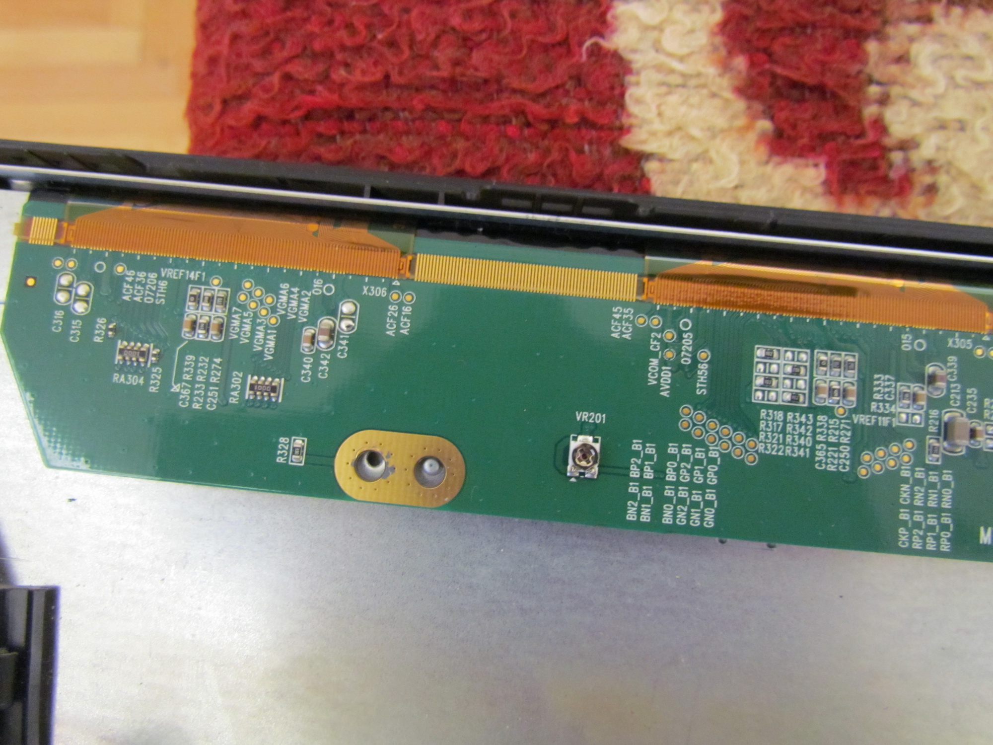

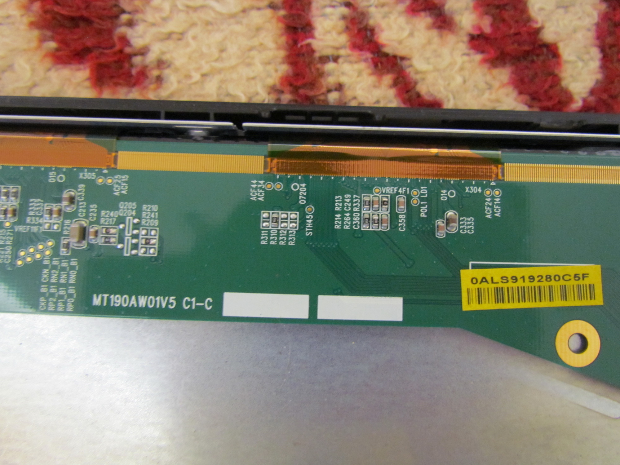

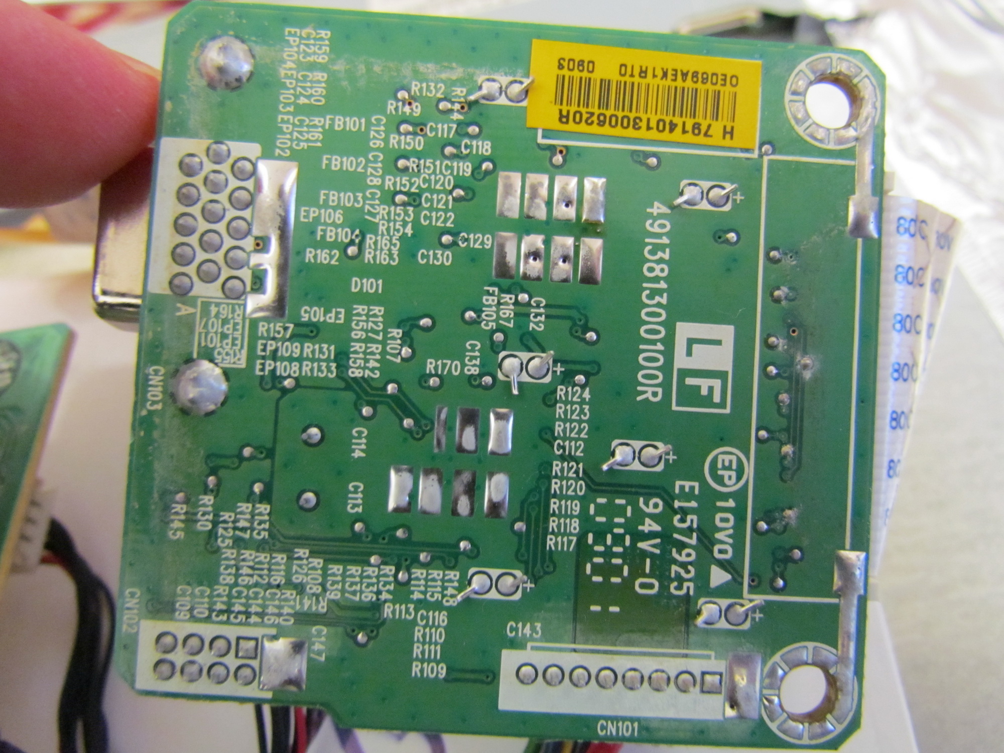

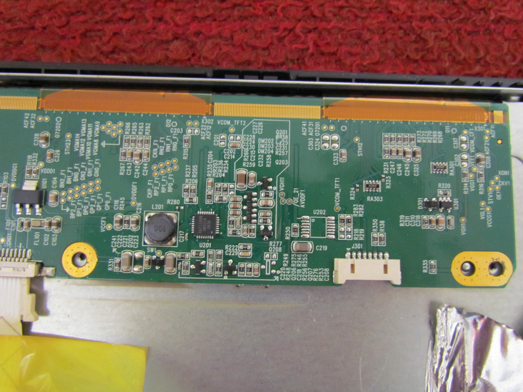

        There is probably another long board on the back of the panel can you post picture of that . to get it big enough do it in 3 sections.
        There may be a flat ribbon cable to this board - if it is removable take it out and clean the contacts then replace and try.

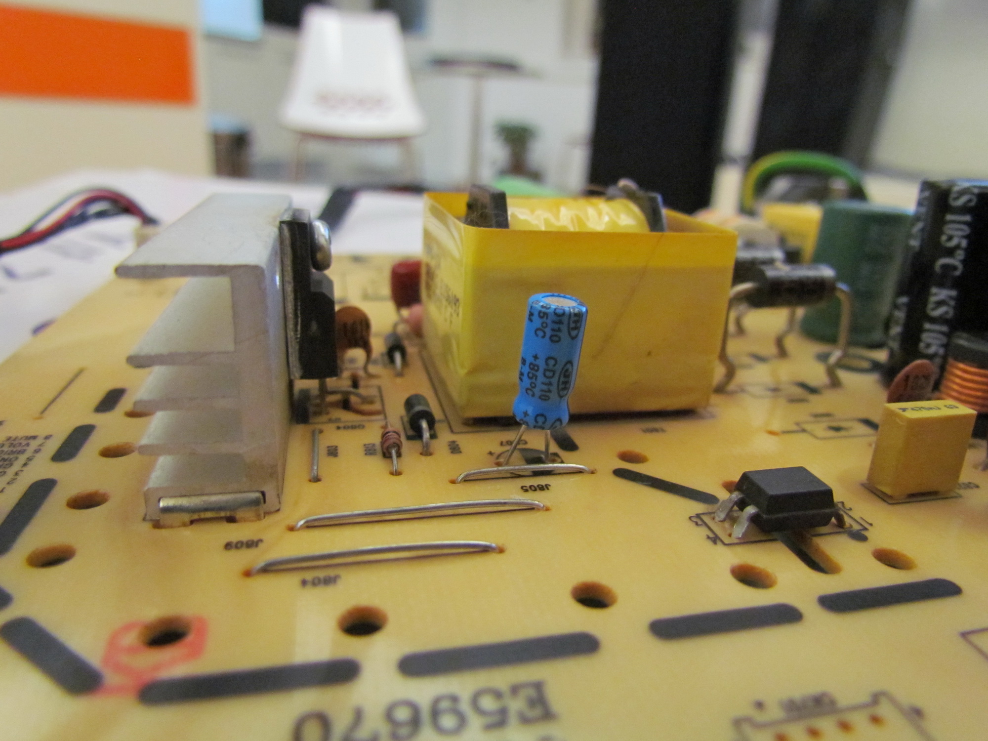

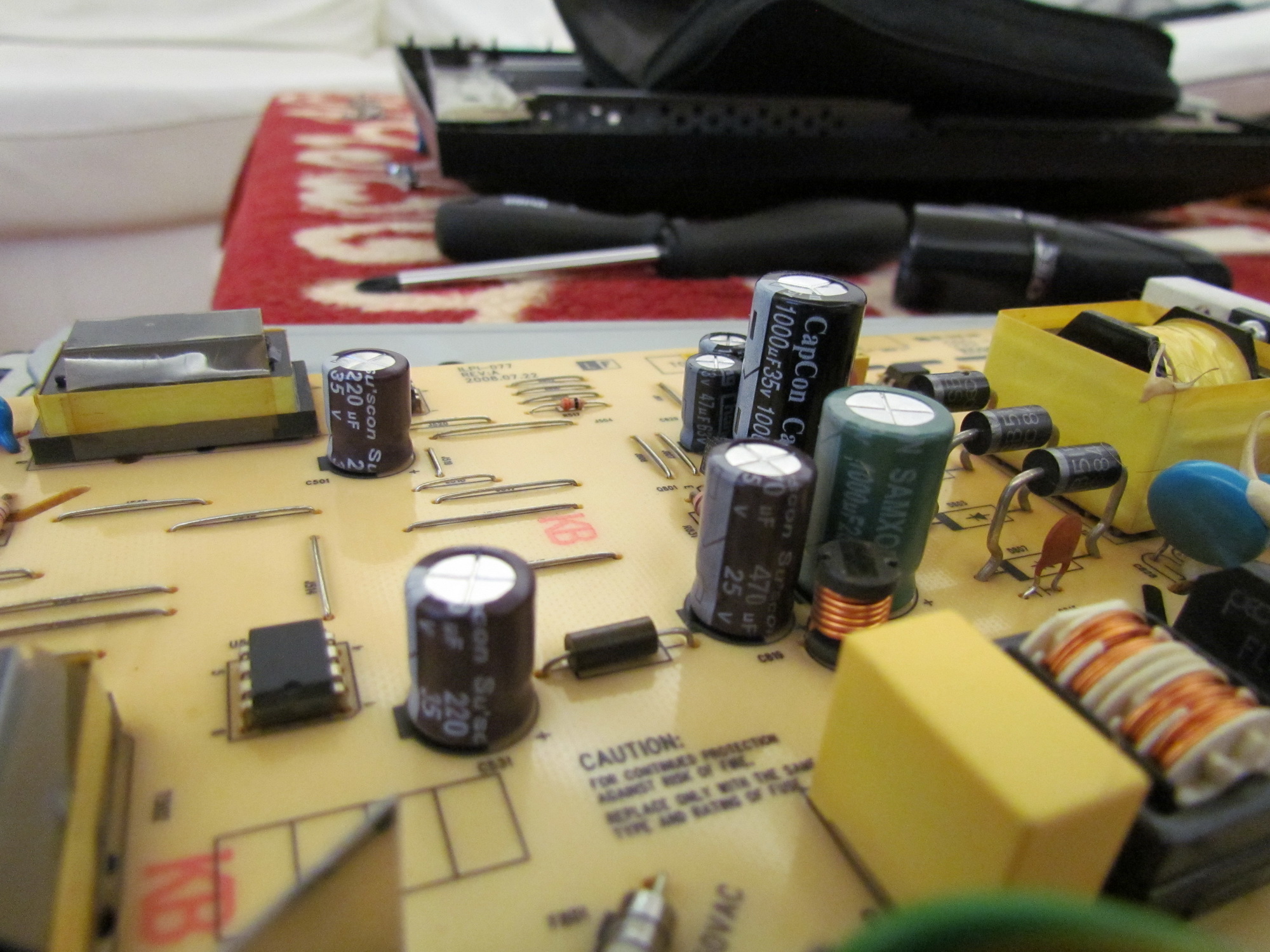

          I'm not sure which caps are replaced. I think that only big one is not replaced and I can't see letters on it.
          I made some pictures of caps. I hope they are good.
            Re: Strange problem with Acer V193W

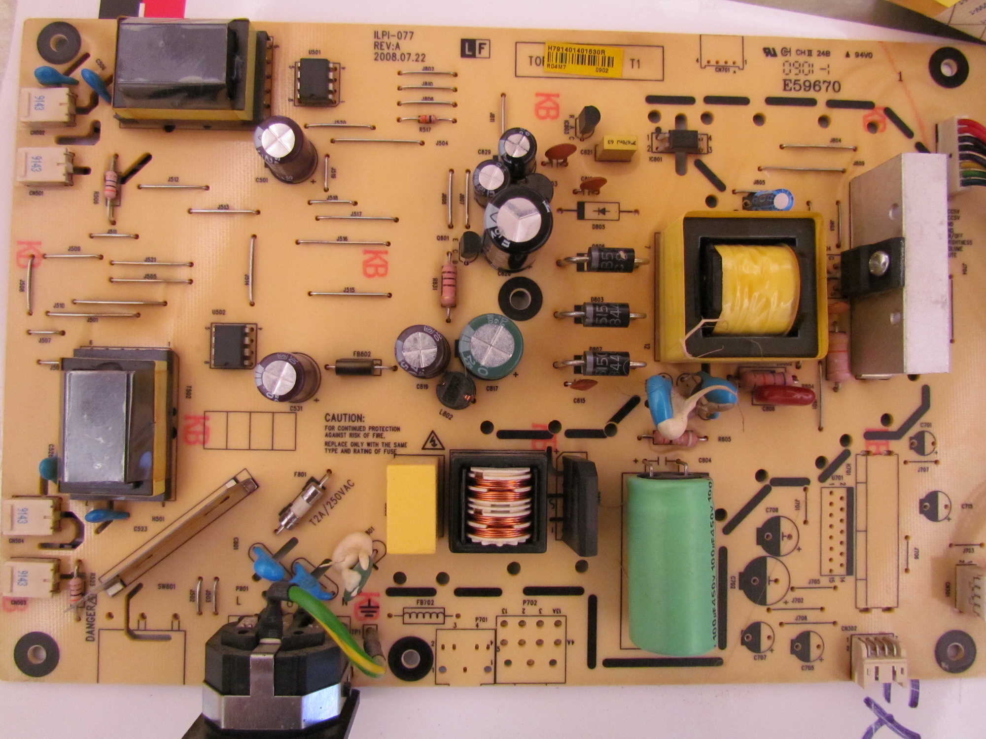

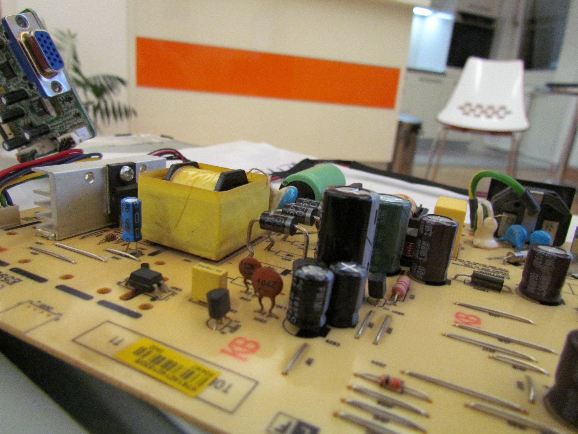

            Wow! that is a horrible set of caps!! I dont think he has changed any or if he has he has changed them for previously used or old ones - its lucky its working at all.
            My suggestion would be to make a list of all the caps on the board with a view to changing some/ most or all of them. Ugghh.

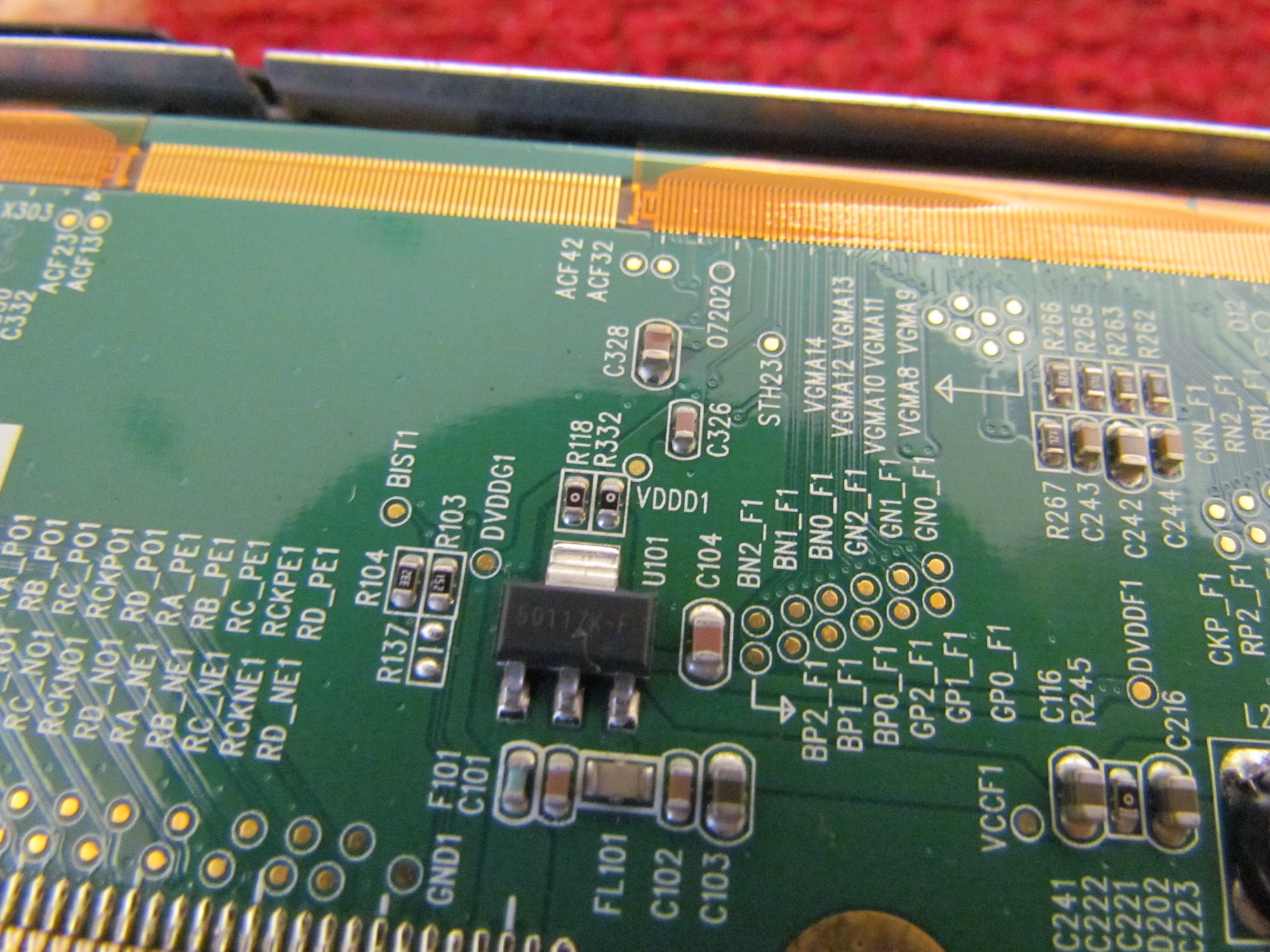

            Right as you will have seen there is another voltage regulator on the panel board.
            Can you test that as with the other one.
              CapCon?! I bet the main cap is a Lelon. I'd replace all of them except the big cap. That JH cap is only 85C, could be dried out...

                I've tested voltage regulator on panel board:
                pin1=0
                pin2=3.31
                pin3=4.95
                pin4=3.31
                Now I worry if those caps has the right values.

                      I bought new caps, Capcon,Capxon and something that I can't read
                      I will replace them all, not a problem.
                        I replaced all caps on ps board.
                        Nothing has changed.

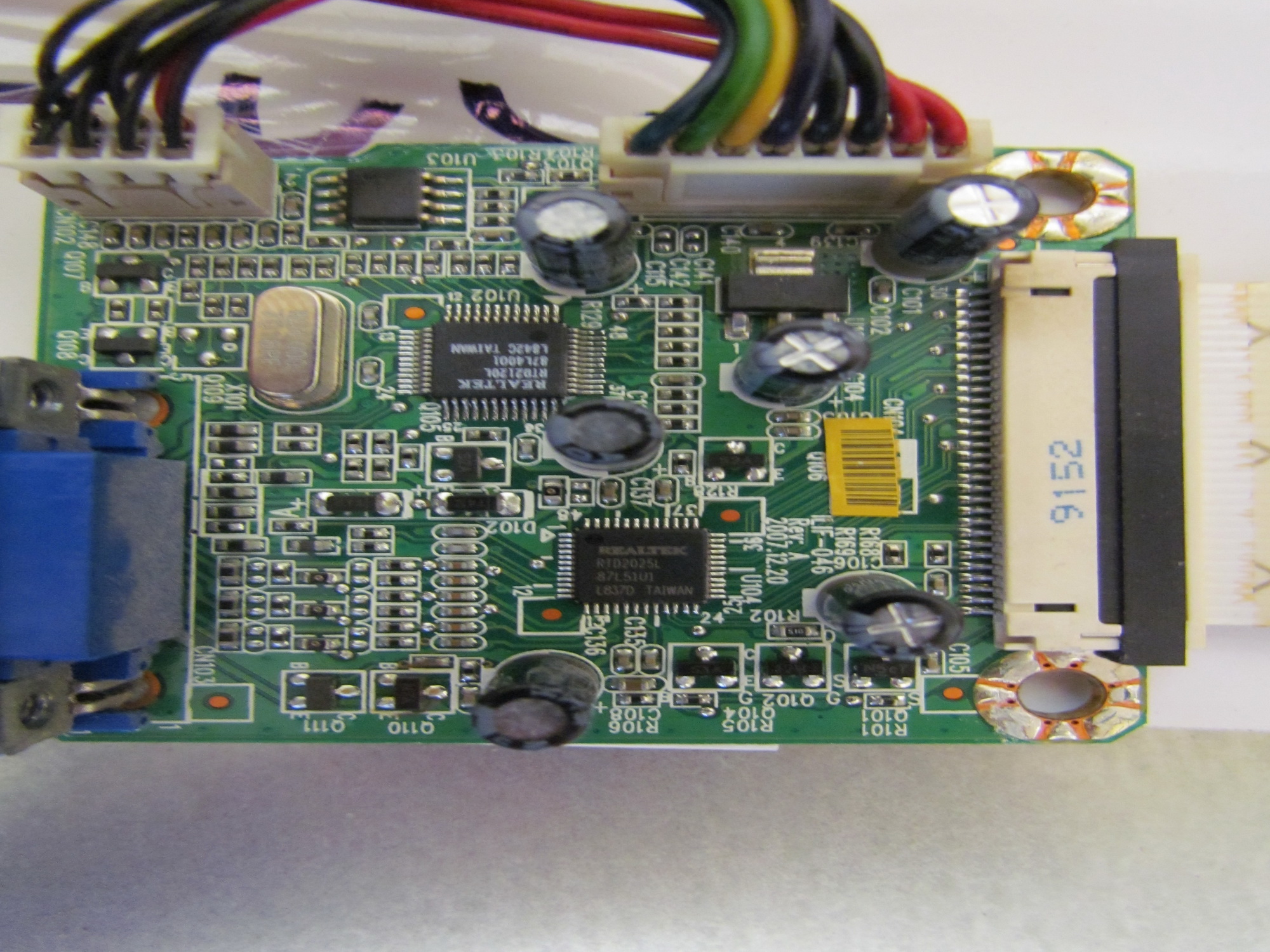

                                    I've done testings.
                                    Voltage regulator on main board:
                                    pin1=0
                                    pin2=3.29
                                    pin3=5.09
                                    pin4=3.29
                                    AS1117L-33
                                    Voltage regulator on screen panel:
                                    pin1=0.06
                                    pin2=3.38
                                    pin3=5.08
                                    pin4=3.38
                                    50117K-F
                                    when it's not working because of resolution there is some slight variation of voltages on both voltage regulators and on contacts below.

                                    I was reading this post and maybe I have similar problem:
                                    https://www.badcaps.net/forum/showth...ghlight=SCALER
                                    Should I change some caps on logic board or all of them?

                                      It would be easy for me to say change them all but if your store is easy to get to and you can buy a few at a time perhaps buy 2 or 3 and try them on the part of the board that seems most connected to the screen cable socket.
                                      ( you have cleaned that thoroughly both ends and checked for bent /broken pins.)
                                      If that doesnt change anything you could either buy another 3 or put the old ones back and try them in the places on the board
                                      Sorry I have assumed all 6 are the same size if not that plan is sunk
                                      perhaps buy 2 and so on.
                                      P.S Voltages on the VRs are reasonable they are both 3.3v VRs

                                        I changed all caps.
                                        When I powered on monitor, it's behavior was the same as before.
                                        After a while he began to behave differently.
                                        Now lamps are working all the time, but there is no picture.
                                        I even haven't "no signal" with disconnected signal cable.
                                        All voltages are there.

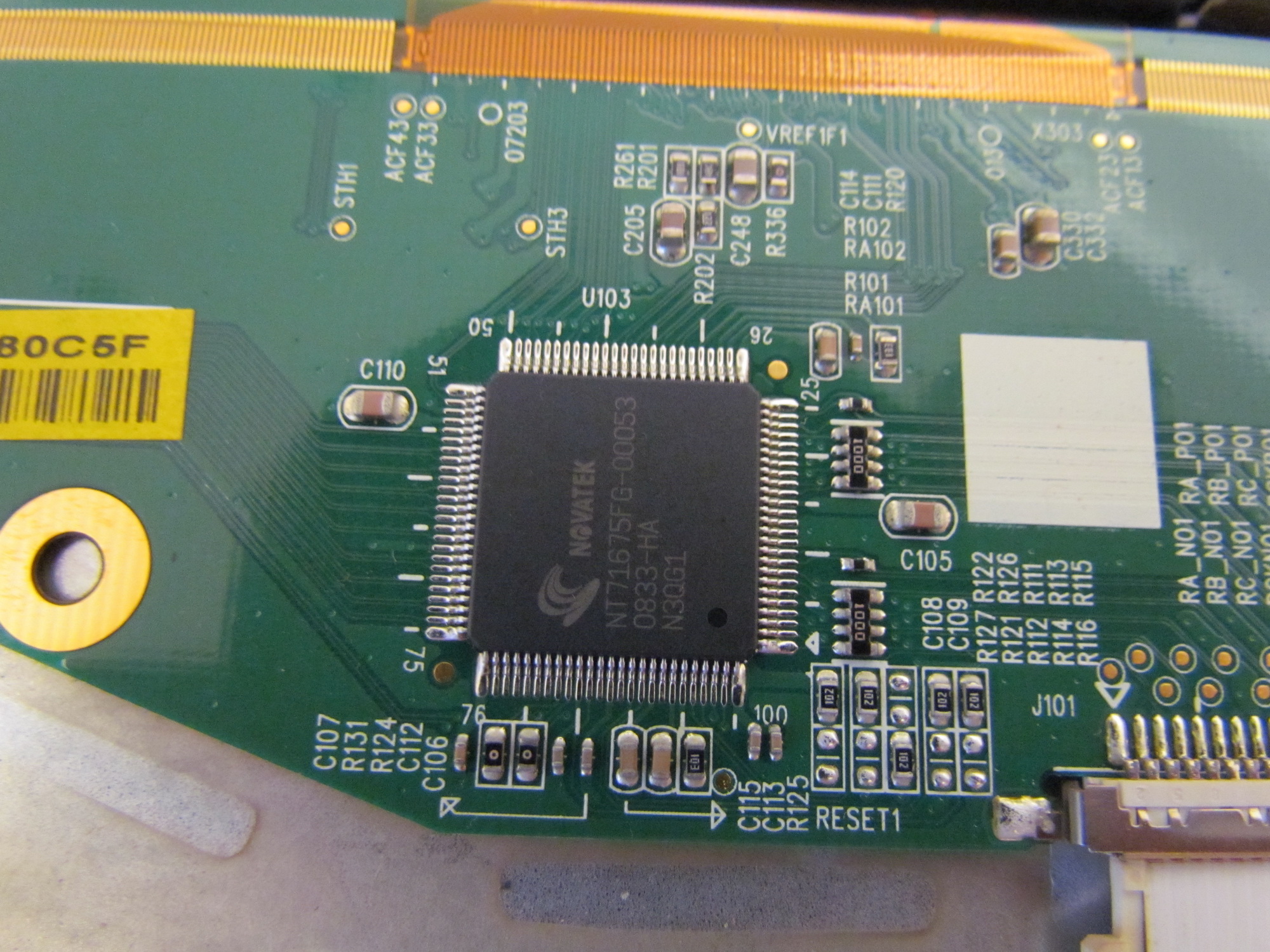

                                        When I was measuring voltages on logic board, I noticed that, when I was touching only one pin of oscillator, lamps started to blinking.
                                        I tried to measure frequency of oscillator and I got very unstable values, from 5 to 50 Hz.
                                        Is it possible to measure it like that and is it normal behavior.
                                        What else can I check or do?
