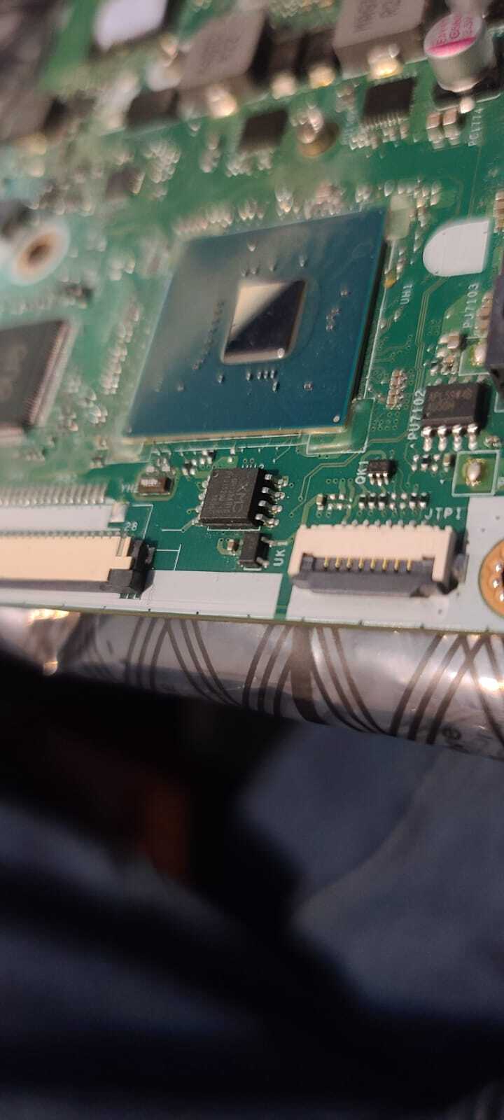

                        I think this might be the one given that it appears to be a 16 mb
                        QH128AHIG
Name:	WhatsApp Image 2024-03-27 at 10.00.21 PM.jpg
                        here is the pinout in the boardview:
                        What do you think?

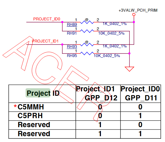

                                https://www.badcaps.net/forum/troubl...-1b-schematics
                                This is for the intel variant LA-E911P, maybe it's set by Project_ID0 and Project_ID1 resistors, i don't know for sure
                                RH89, RH91, RH93, RH95
Name:	project id LA-E911P.png
                                Try to match those with the original board
                                OCMan, which board number? Same advice could apply, maybe those resistors are labeled differently, check the schematics and boardview to be sure, don't touch VGA_ID resistors

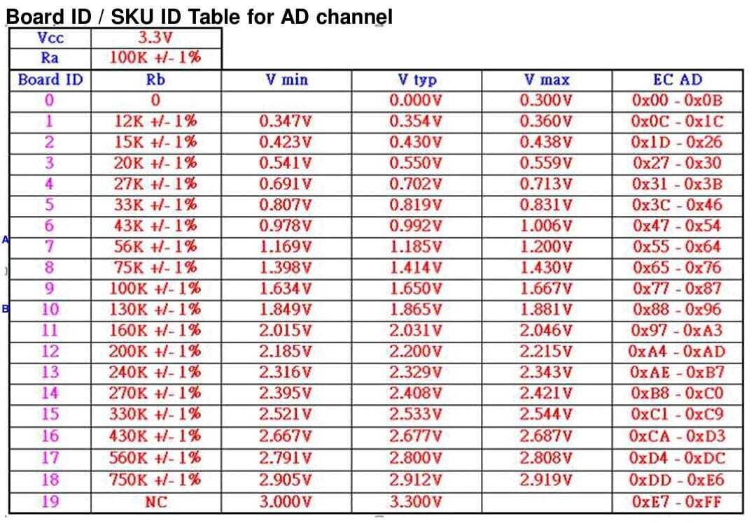

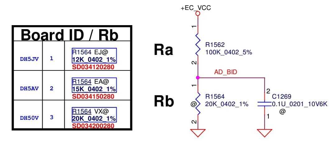

                                  I will try that, in datasheet, in datasheet for DH5JV, its written R1564 ( and interestingly on the ENE KB9022 page! ) but resistor set board ID to : DH5JV / DH5AV or DH50V and when I flash bios , it tells me my bios ID is EH5JP
                                  there is no mention of the EH5JP variant in the DH5JV datasheet , but even if its a EH5JP variant, on the board its written DH5JV .... compal/acer are really weird !
                                  • m1ch43lzm
                                    • Mar 2019
                                    • 377
                                    • Peru
                                    In your case it depends on the value of resistors, if the value is wrong then anything can happen
                                    Measure both R1562 (Ra) and R1564 (RB)
                                    Your board is LA-G021P?
