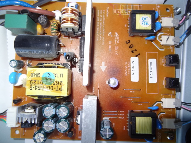

    Hey everyone, read around the forums and everything, but due to my limited knowledge I figured I would probably need some help!
    I know the basics, how to solder/desolder and I know my parts pretty well, but I'm not very good at the troubleshooting part!
    Anyway, onto the actual technical end of things:

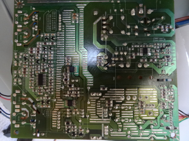

    Recently my x20WG monitor just started going black for no reason, image was still visible with a flashlight or other (followed all these steps) and I don't know where to start. I took it apart (what a hassle) and now have the board out, and there are some burn spots on it. I have some pictures, hopefully of adequate quality.

    The Purple capacitpr on the right hand side ,standing on its own,looks 'bulged'at the top, and may well be the cause of your problem ??

      It does appear a little bulged, what would be a good replacement 150 μF/25V capacitor?
      Rather, which company would you suggest as a replacement?

        Change the green SamXon GF ones aswell

          Yes, the Samxon GF are "known" bad series of caps.
          Most recommend digikey.com and use Panasonic FR/FM or FC series. An example is provided (regulars may skip)

            I had the same problem with that monitor. That same cap was bulged.
            I substituted a 220 mf Panasonic FM series of the same voltage until I could get the correct value.
            My problem turned out to be a bad lamp.
            I have some spare lamps with plugs attached for testing. The monitor uses four bulbs and the bad one was number three.
            Good luck - hope your problem is only the capacitor.
