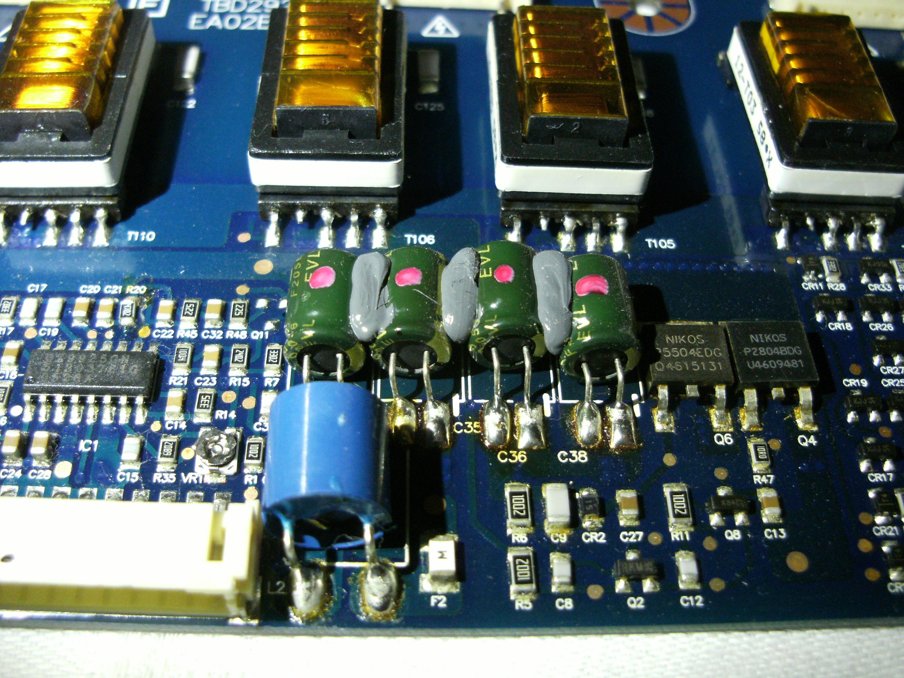

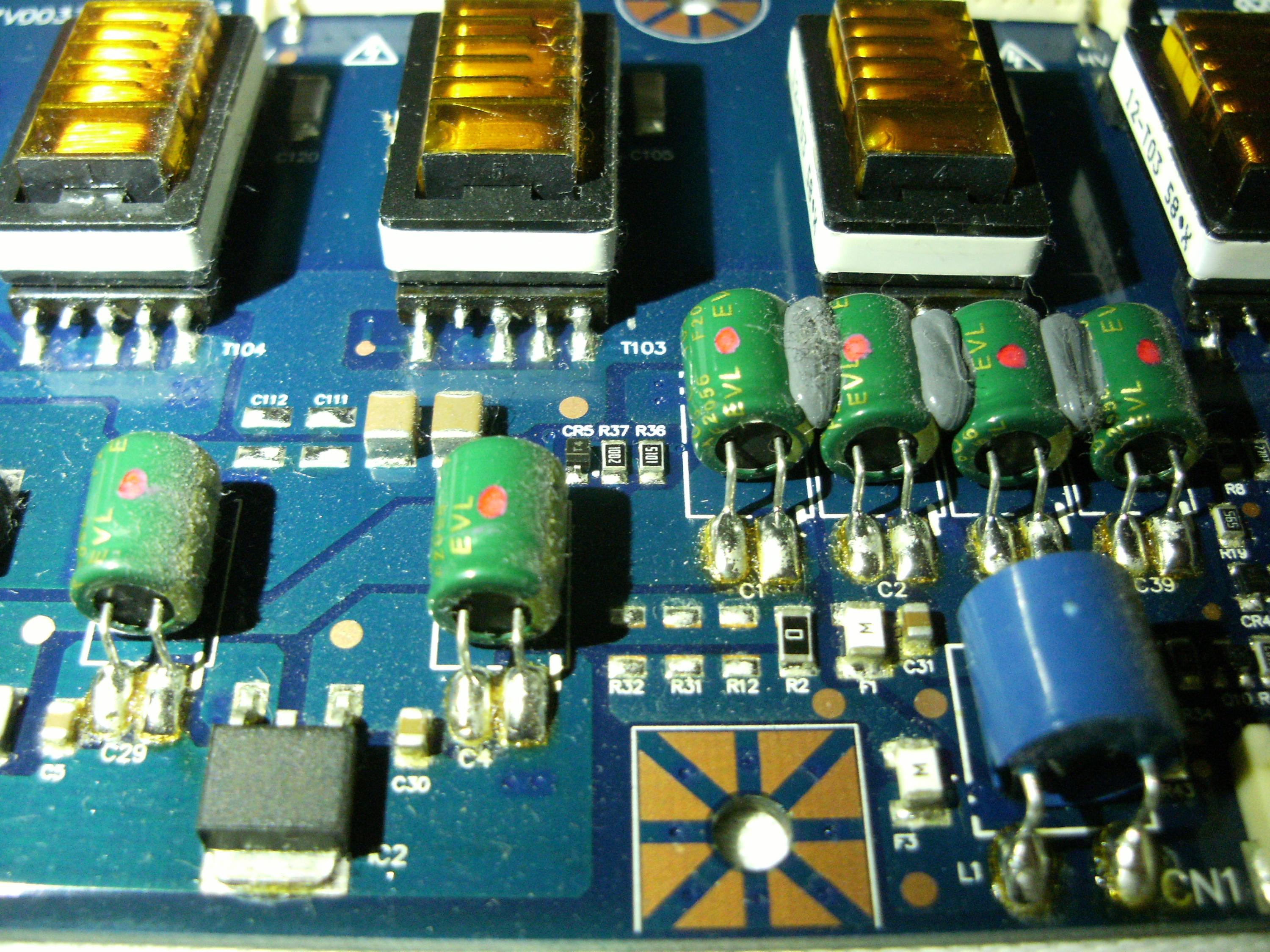

        Attached are two pictures from the lower and upper side of the inverter board, viewing the caps from the top side. These were taken last weekend; at the moment I can't access the monitor, but I'll post pictures of the bottom side of the caps tomorrow. I think I might get away with using slightly longer caps, as there's some room left.

                i would start with ALL the caps.
                the ones you show on the inverter are prone to going high esr and can cause your symptom.but so can a bad tube,transformer,ect.

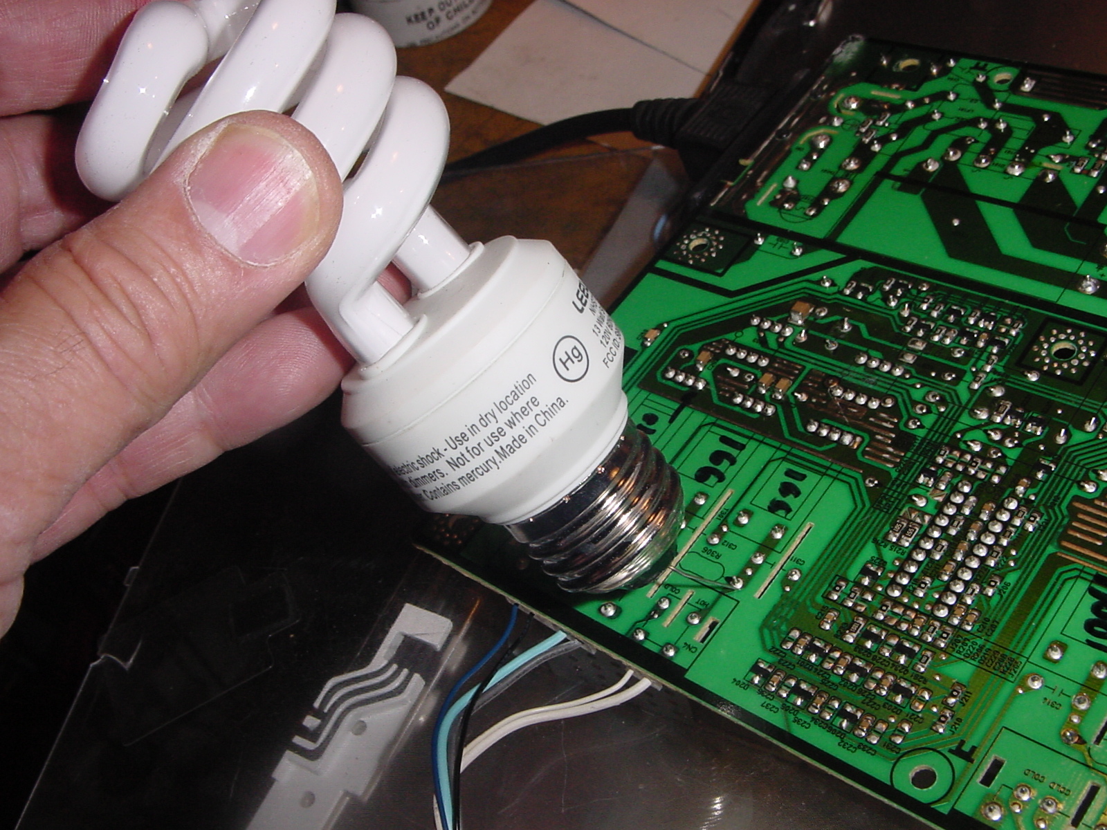

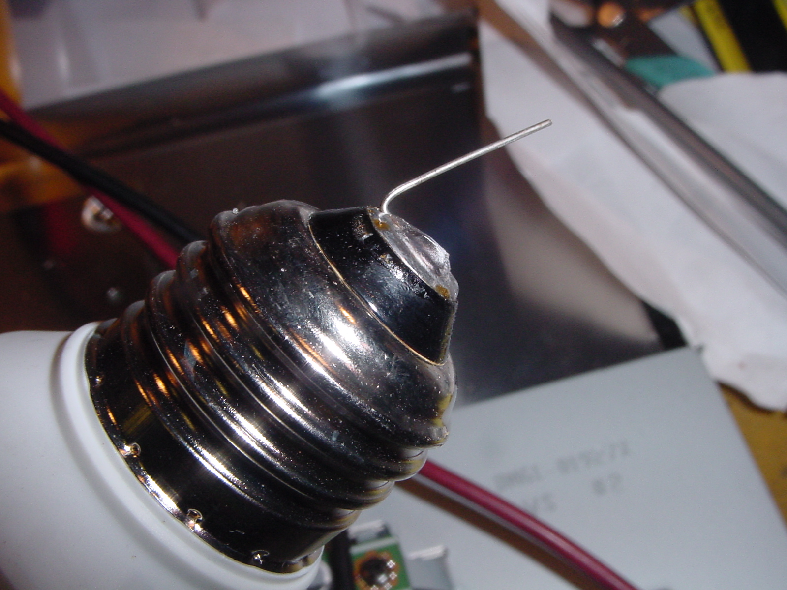

                  Re: Dead Acer AL2416W monitor, need help choosing replacement caps
                  The CCFL will still flash on even if the wire is not making contact but sitting real close to it with the end connection of the lamp, the high voltage will arc over to flash the lamp on but it will not be able to sustain the current flow through the lamp so the inverter circuits will shutdown.
                  http://s807.photobucket.com/albums/y...klight%20lamp/
                  I can use the CFL to check and see if the HV is present at the output of the transformer or not but it will not tell you if the transformer is good or not since bad transformer can still put out the voltage but not sustaining voltage.
                  http://s807.photobucket.com/albums/y...t=DSC01236.jpg

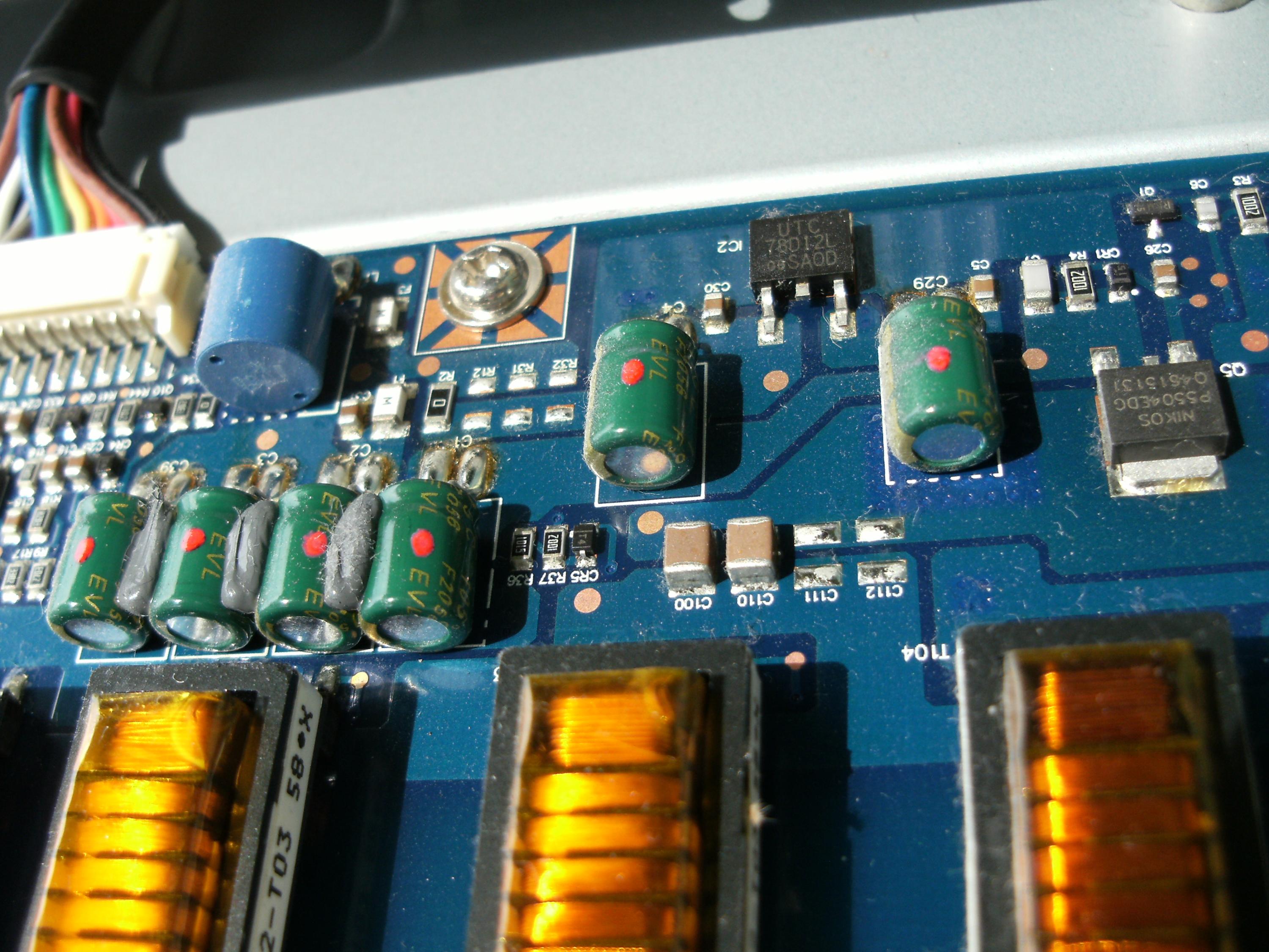

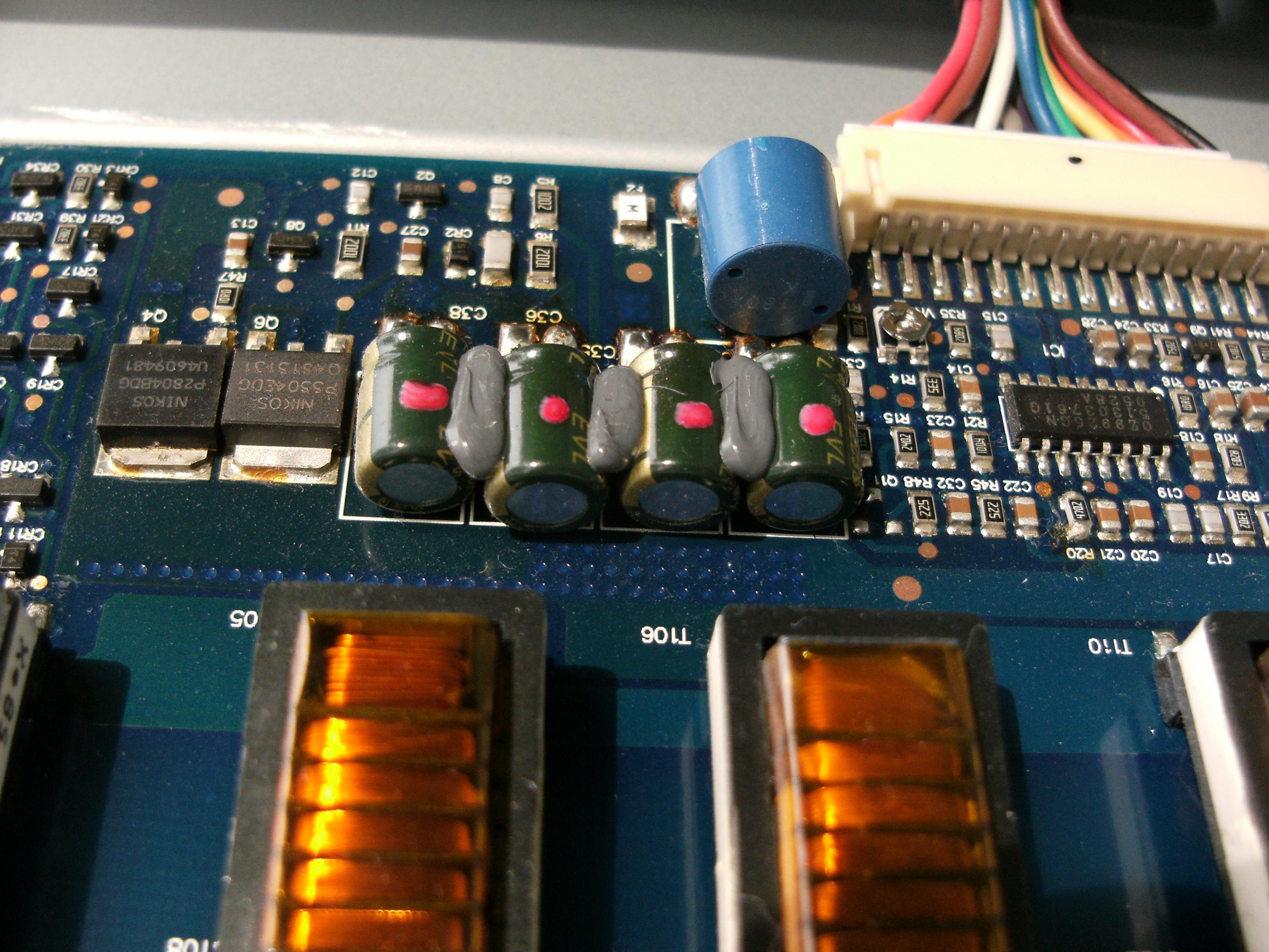

                    I've removed the inverter board and took some closeups of the bung side. Looks normal, no popped bungs, but as they're prone to failure and relatively easy to replace, I'd like to swap them for good ones anyway.

                        With great pleasure I can now announce that I've successfully fixed my monitor!
                        I figured I'd replace the suspicious caps first, as they can relatively easily be replaced by known good ones. Electronics shop AITEC (aitec.be) told me that they order regularly through Farnell, and so they could include my preferred caps in their next batch. I went for Rubycon 35ZLJ100M6.3X11.
                        I replaced the caps one by one, forming the legs of each new cap with needle-nose tweezers into S shapes suitable for soldering on the pads. Cleaned off the flux residue with isopropyl alcohol. After final inspection I put the inverter board back in and wired it up. And sure enough, it worked flawlessly!
                        I'll keep the bad caps in case I get around to test their ESR. Thanks for all your support, and let's hope that the second life of this monitor will be a long one!
