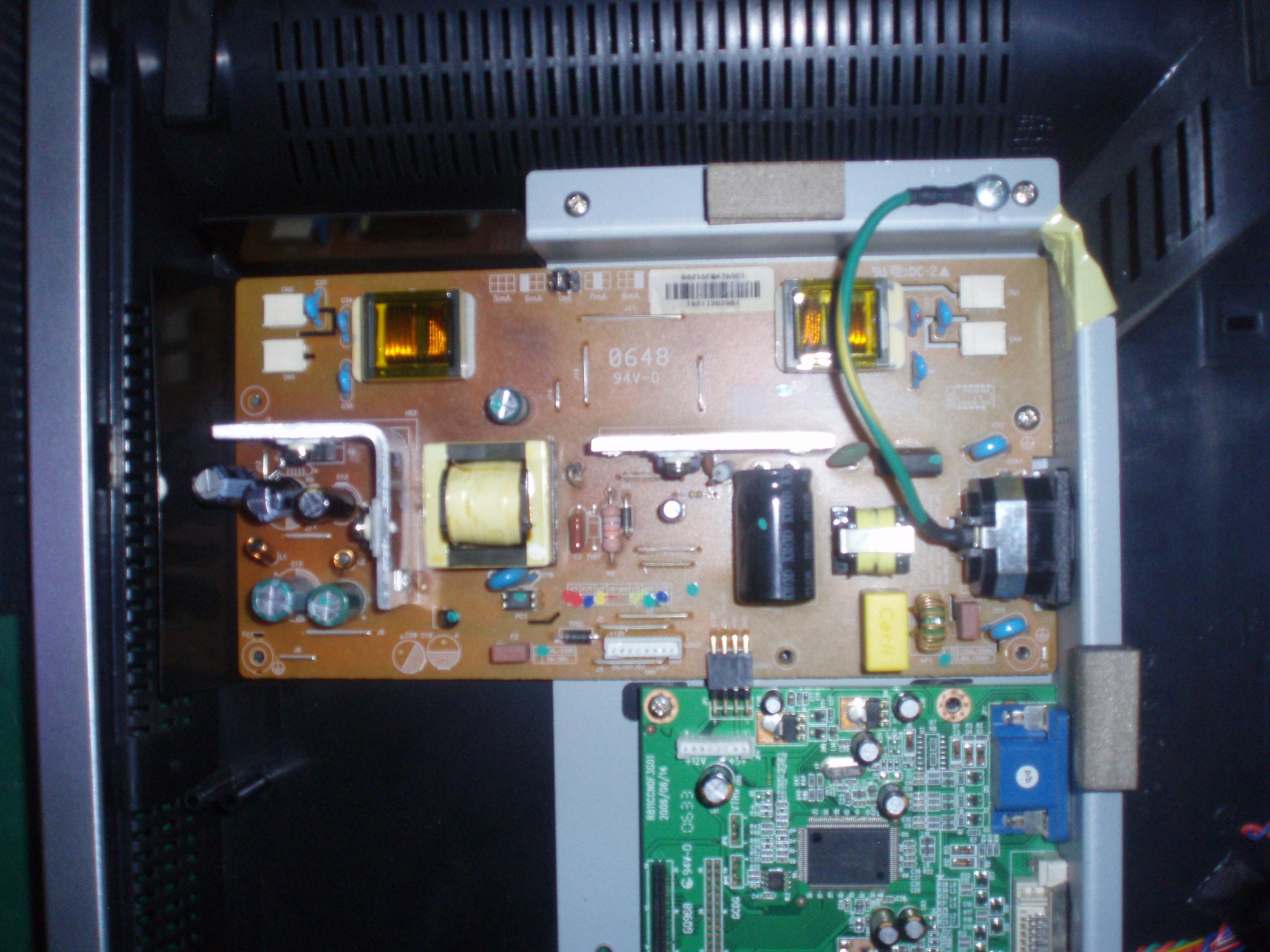

    I recently bought a faulty 19" monitor off ebay with the view to repairing it and using it in my office as my new workbench monitor as it has DVI which i now need for PS3 repairs.
    I replaced 2 of the bulged capacitors then the monitor worked fine for days so i thought it will last a fair while so i went ahead to mount it on my wall mount.
    That was where it all started to go down hill.
    I mounted it and plugged it in, I then heard a small pop and all my computers etc. went down the RCD, and the room fuse went. The monitor would no longer turn on.
    I looked inside the monitor and notised that the bolts where touching the back of the PCB. I have opened the monitor again and can't see anything obvious.
    Could somebody please help me diagnoise what is wrong with it, hopefully its something easy and cheap to fix.
    Re: DGM 1931WS Monitor repair Shorted
    I have just checked the fuse in the photo and it is open i would assume it has blown due to the board being shorted?
    Hopefully the fuse has protected the circuit and i will just be able to replace it?

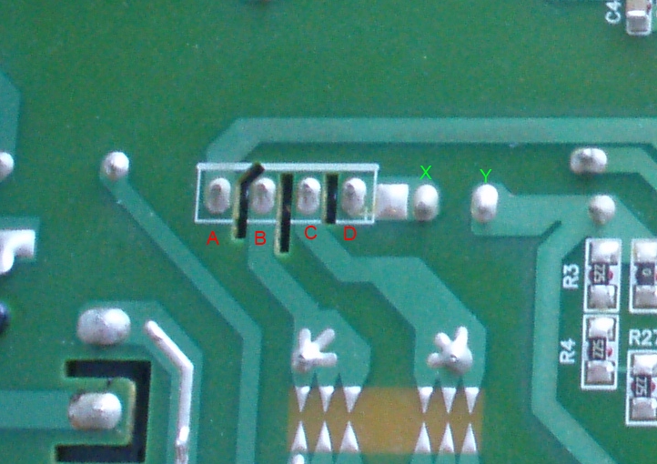

                          Can you get a good picture of the back of the board, so I can show you which pins to check on the bridge rectifier?
                              Here is the best picture i could get, i took it in front of a window to get the best light.
                              Is it good enough?

                                  Test the bridge rectifier:
                                  Turn your DMM on, in Diode check mode.
                                  Each diode is tested two times. Once in the forward direction, once in reverse. Normal readings would be:
                                  Forward - ~0.6v
                                  Reverse - OL (No conduction!)
                                  Make sure the PSU is unplugged!
                                  1:
                                  Forward
                                  Red probe on 'A'
                                  Black probe on 'B'
                                  Report reading.
                                  Reverse
                                  Red probe on 'B'
                                  Black probe on 'A'
                                  Report reading.
                                  2:
                                  Forward
                                  Red probe on 'A'
                                  Black probe on 'C'
                                  Report reading.
                                  Reverse
                                  Red probe on 'C'
                                  Black probe on 'A'
                                  Report reading.
                                  3:
                                  Forward
                                  Black probe on 'D'
                                  Red probe on 'B'
                                  Report reading.
                                  Reverse
                                  Black probe on 'B'
                                  Red probe on 'D'
                                  Report reading.
                                  4:
                                  Forward
                                  Black probe on 'D'
                                  Red probe on 'C'
                                  Report reading.
                                  Reverse
                                  Black probe on 'C'
                                  Red probe on 'D'
                                  Report reading.
                                  That is how you check the 4 diodes in the bridge rectifier. If any reading is close to '0v' that means the diode is shorted. A good diode should measure about '0.6v'.
                                  Test the NTC inrush current limiter:
                                  Turn your DMM on, in resistance mode.
                                  Make sure PSU is unplugged!
                                  Put one probe on 'X', the other probe on 'Y'.
                                  Report back the reading.
                                  A good NTC will measure less than 10 ohms.
                                  -Ben

                                    When you say "Black Probe on A,B,C or D" where are these test points?
                                      DAMMIT!
                                      I always forget to attach the picture
                                      Sorry about that!

                                        4.2 Ohms
                                        -Ben
                                        Do those numbers make sense?
