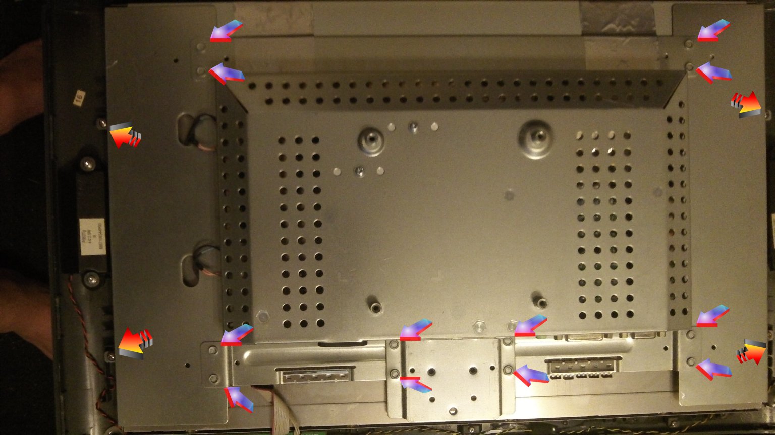

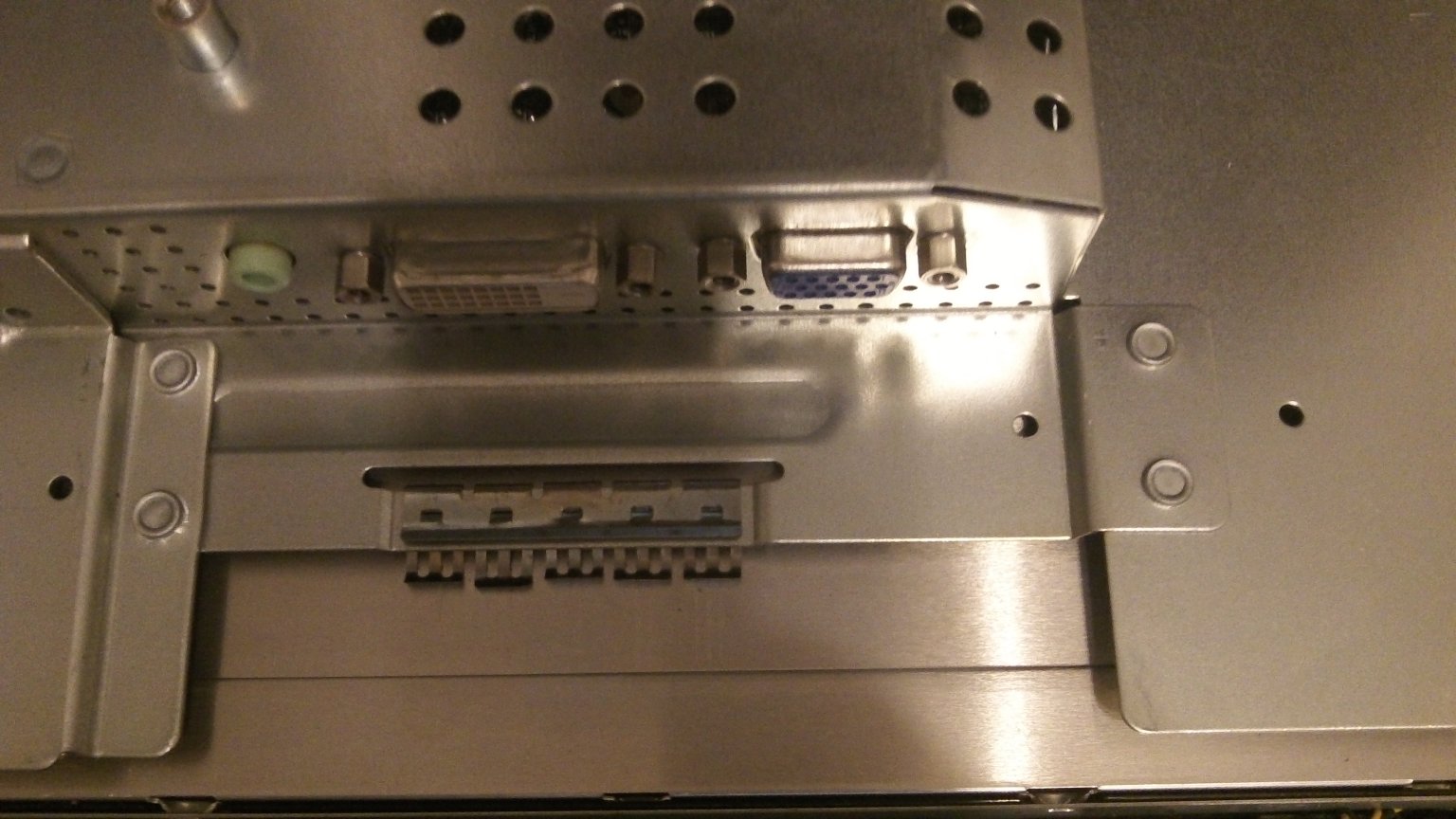

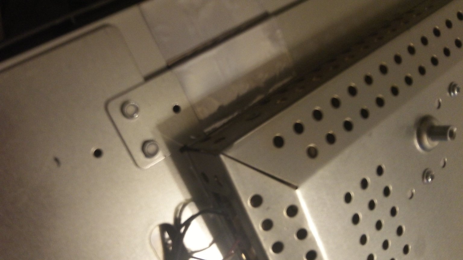

            Ok... got the plastic cover off the back and now I find that the circuit board is rivited behind some metal plates. Photos show what I mean...
            How am I suppose to get to the motherboard without doing major damage here? BTW - The 4 screws around the outside edge only remove the plastic outer cover.

                Re: Help with Compaq WF1907 White Screen Issue
                The prior pics should have been viewable but this time I attached them... hopefully this will explain. The first image shows the rivets pointed out with the bklue arrws and the 4 outer screws in red arrows. (Figured out the problem with the images... forgot to convert them from direct from camera)
                  Oh my. It looks like they've completely sealed it as if to make it completely unserviceable...
                  Never seen that before.
                    On your first photo, you have 4 orange arrows pointing at screws or rivets?
                    That cover looks like one whole unit that may be screwed onto the LCD panel itself. Check along the outer perimeter of the cover for screws.
                      The 4 orange arrows point to 4 screws holding the front plastic cover on... none of them actually hold the metal casing together. I've never seen this before.
                        Some Tvs have screws behind the plastic surround, which could be worth looking at.

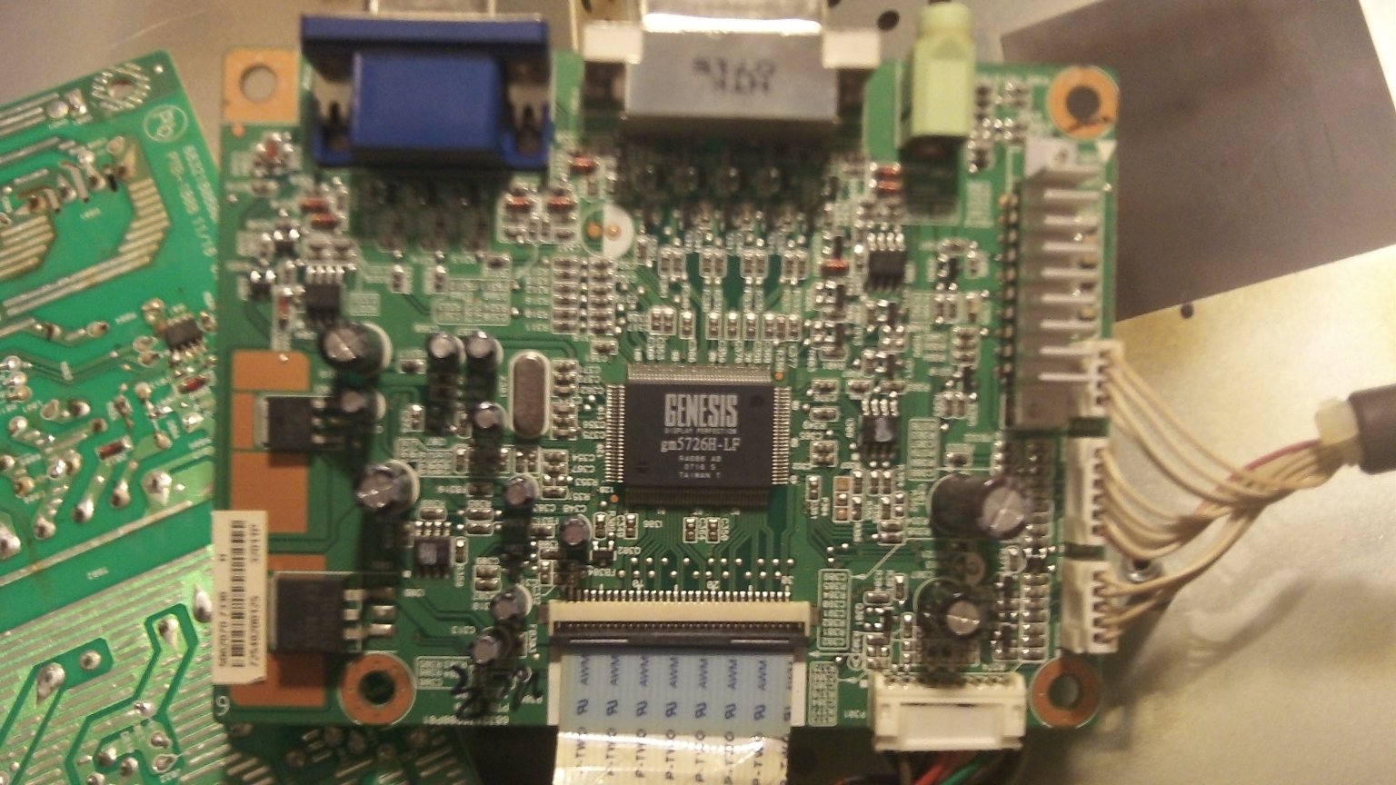

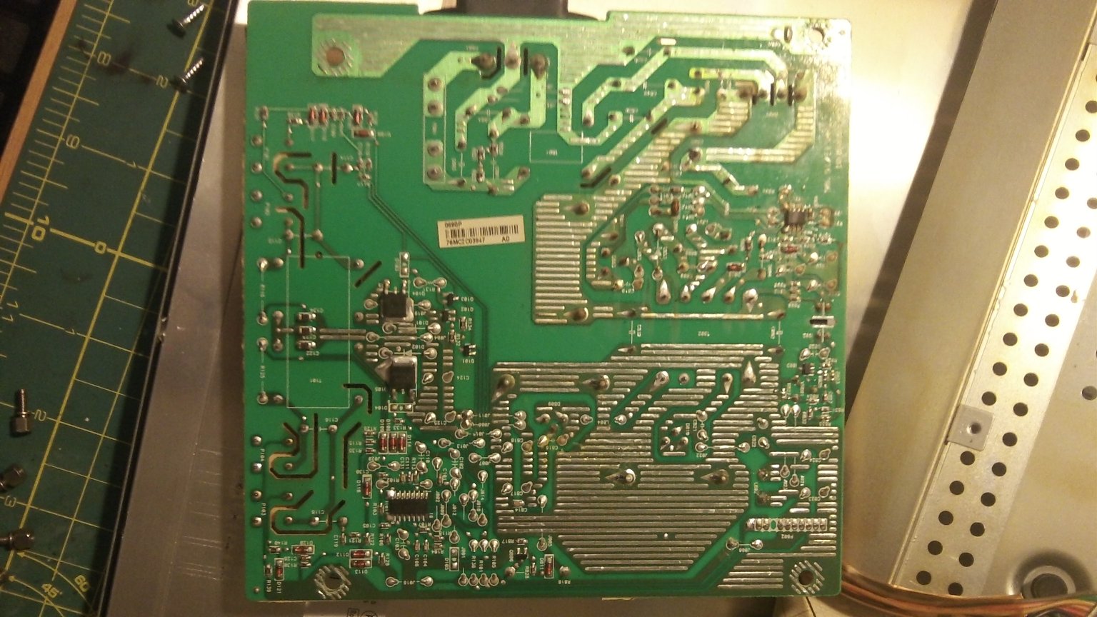

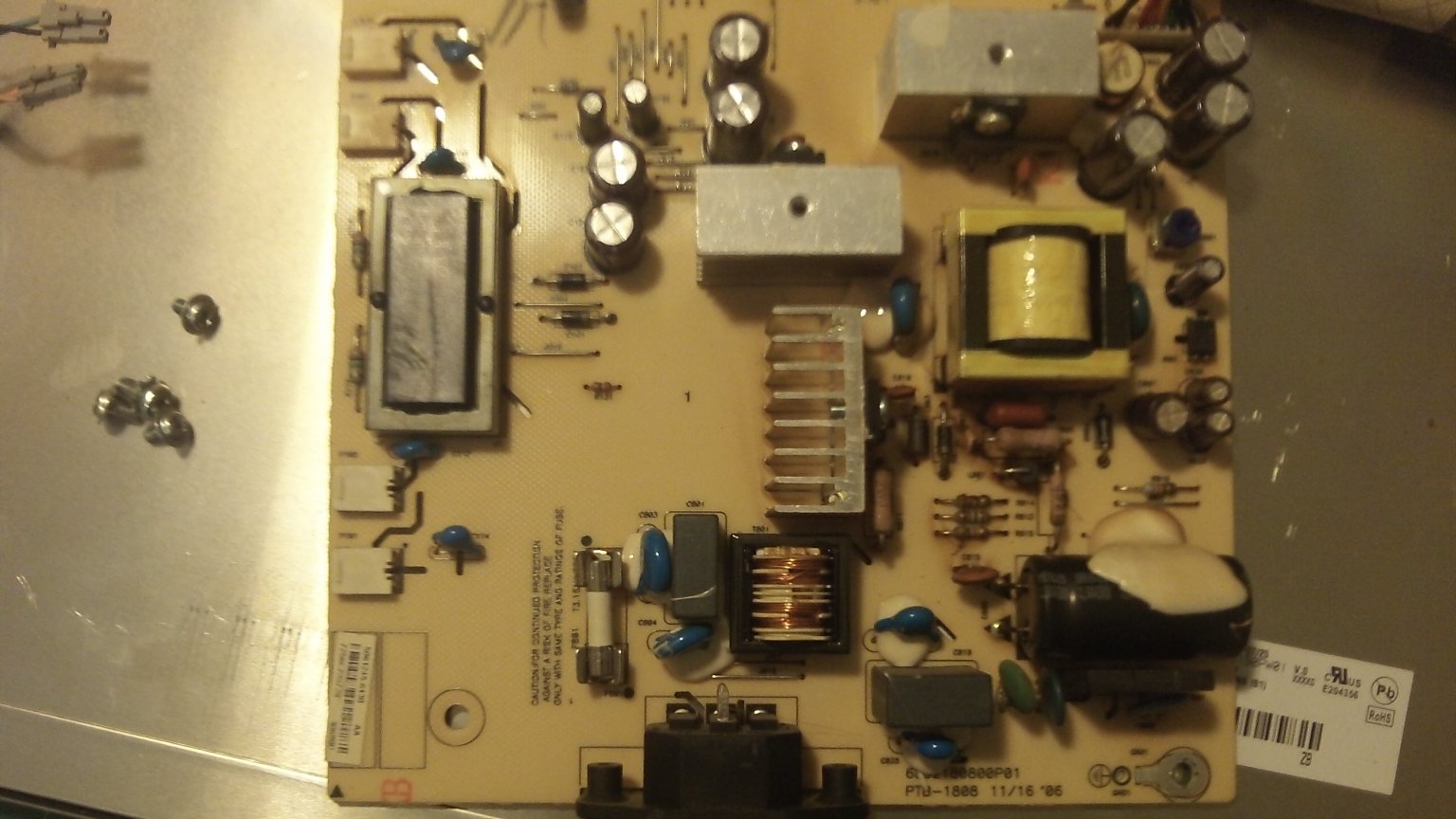

                          Well.. I finally got this puppy open and got to the circut boards. The first two pics are the power board and the second are the main board. I checked the fuse and now problems there. I also used my multimeter on the back of the power board near the fuse and found no problems there either with any of the smd's. Still trying to figure out what might be happening here. BTW - You were right about the screws on the side after removing the the ones that hold the plastic cover on... I find kinda dumb now! LOL

                            That should read "no problems there"

                              I hope those pics were good enough... I can't find any blown fuse or capacitor... any help would be appreciated!
                                Here are the voltage regulators on the main board.
                                Test according to:
                                  Now that you have it opened, there should be another board under a thin metal cover on the top of the monitor - this is the t-con board. On it, you will see a small SMD fuse near the connector, usually marked Fx or similar (where x is a number).
                                  Can't find it yet???
                                  Let's use this pictures as a reference:
                                  https://www.badcaps.net/forum/attach...9&d=1348777759
                                  follow the thin ribbon cable at the bottom of the board, and this will lead you straight to the t-con board.
