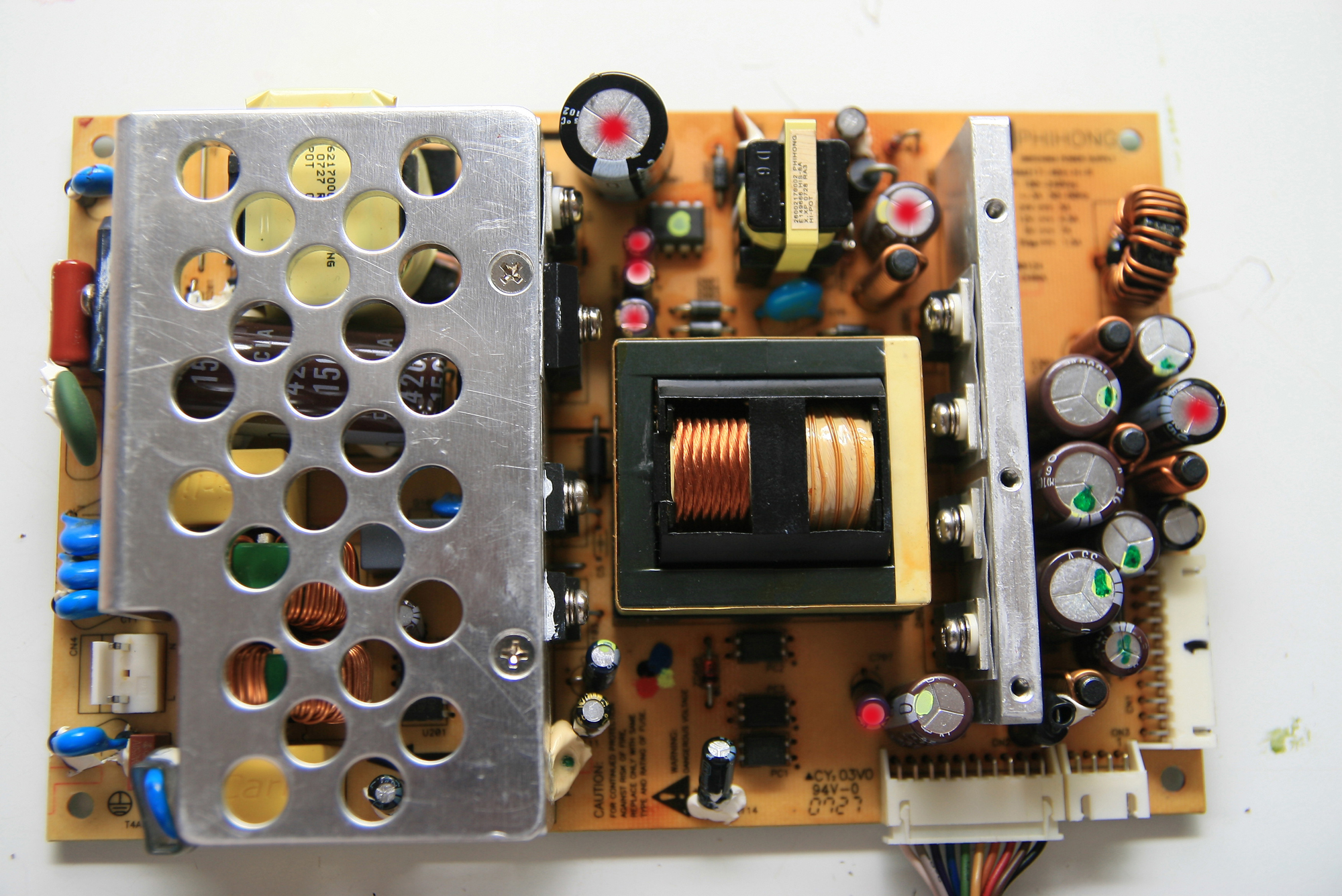

    Hello all
    Has anyone experienced an arching between power supply and lcd panel ?
    I bought 3 Non working viewsonic 28” monitors VX2835 wm with a no start no power problem , tested all caps and replaced the bad ones. Put it back together worked great for after about 4 hours I heard a pop like a fire cracker. Opened it up checked for popped caps, I get no power but I did find a burned mark on the back of the lcd panel. Power supply has burned marks near some resistors and Mosfet solder looks bad.
    I can only think that heat expanded monitor or power supply to touch the back of the LCD panel.
    Would I be able to put a non conductive material behind on power supply as a shield With out over heating power supply?
    I repaired another monitor same model as above and place masking tape on
    the back of lcd panel just under power supply hope that works.

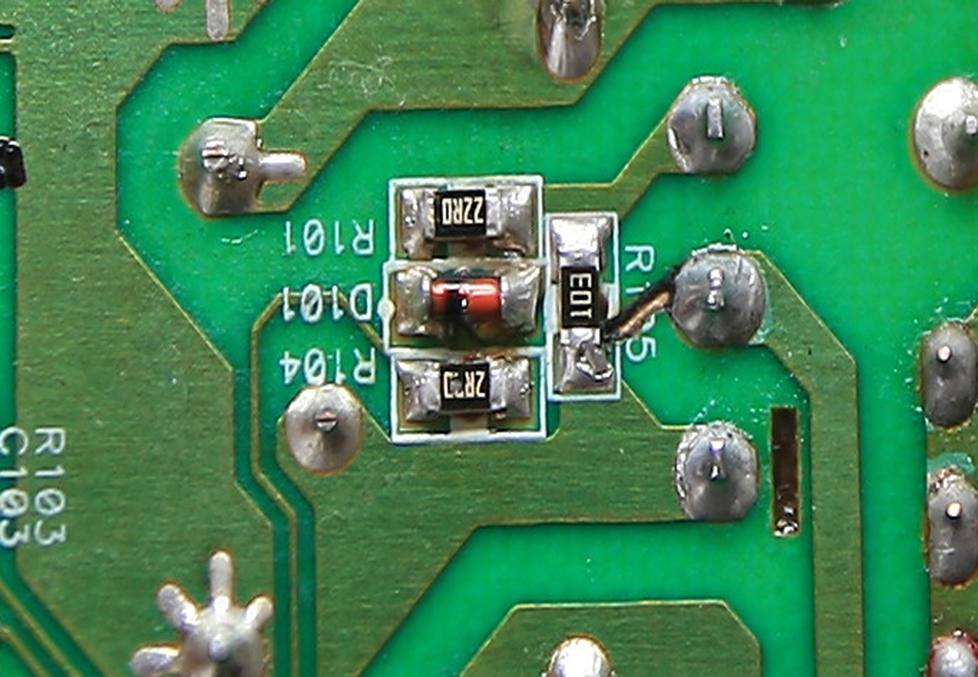

    was there once a trace in that third pic or did that board carbon track?
      It's a carbon track

        If forgetting to put heatsink back on power supply will it cause the power supply to blow. Will it hurt if I put a plastic shield betwwen power supply and lcd display.

          Was the carbon track under the mosfet?
          If so, maybe the snubber circuit failed, and a high voltage built up and arced over. Looks like one 2R2 resistor is fried, so I would say that the MOSFET is shorted now too.
            Do you thing it was due to forgetting to put top of heatsink back on?

              I'm thinking that big MOSFET is for the PFC. Maybe the PFC diode went open circuit. If it did, it might have done so b/c you left the heatsink off.
