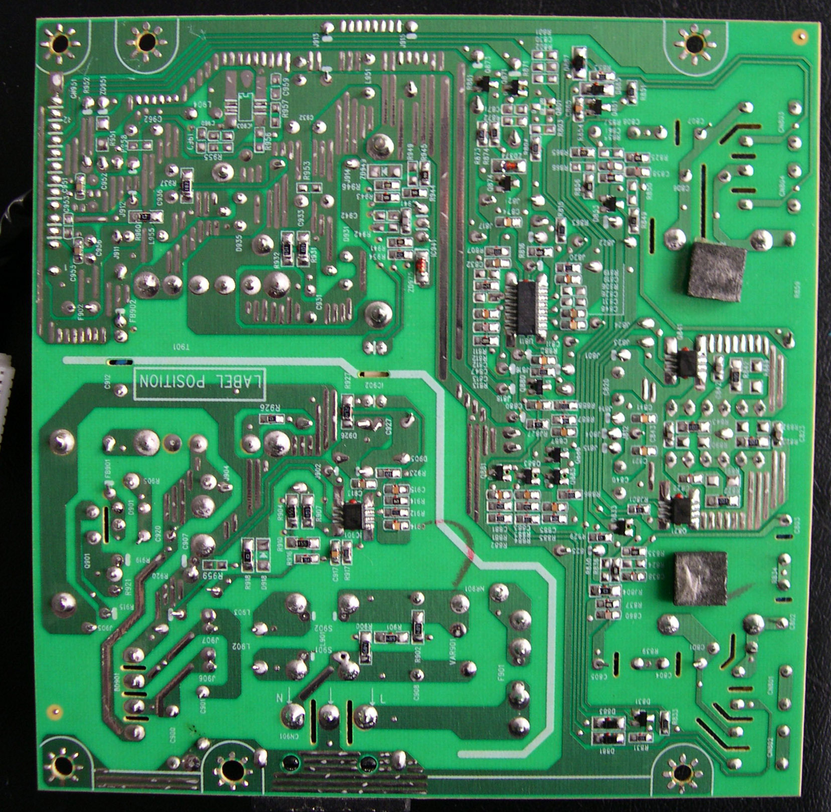

    I have a HP L1940T LCD Monitor that doesn't power up & doesn't make any sounds. I looked at the circuit boards & I visibly see no signs of damage. I measured the voltage coming from the socket where the power cord is plugged in & it had the proper voltage. I do not no what to do next & would appreciate any help provided.
    Re: Hp l1940t no power

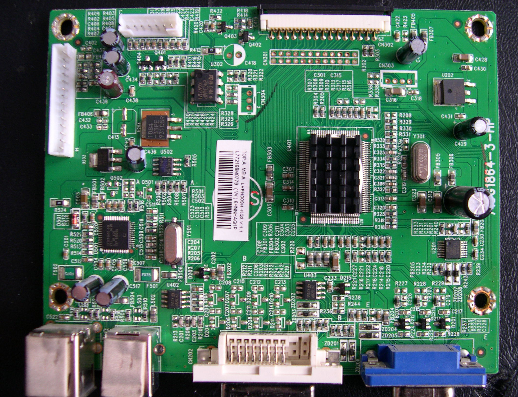

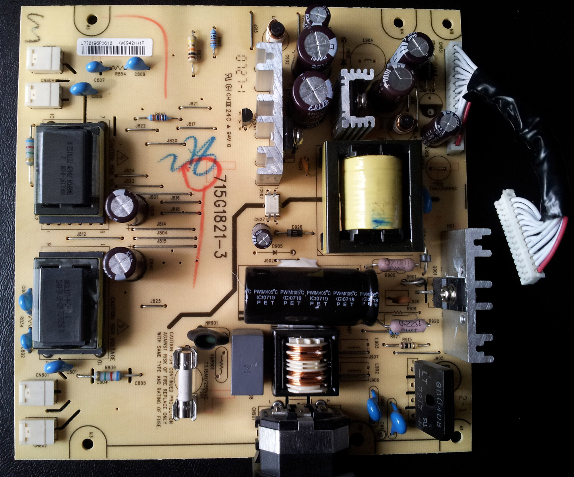

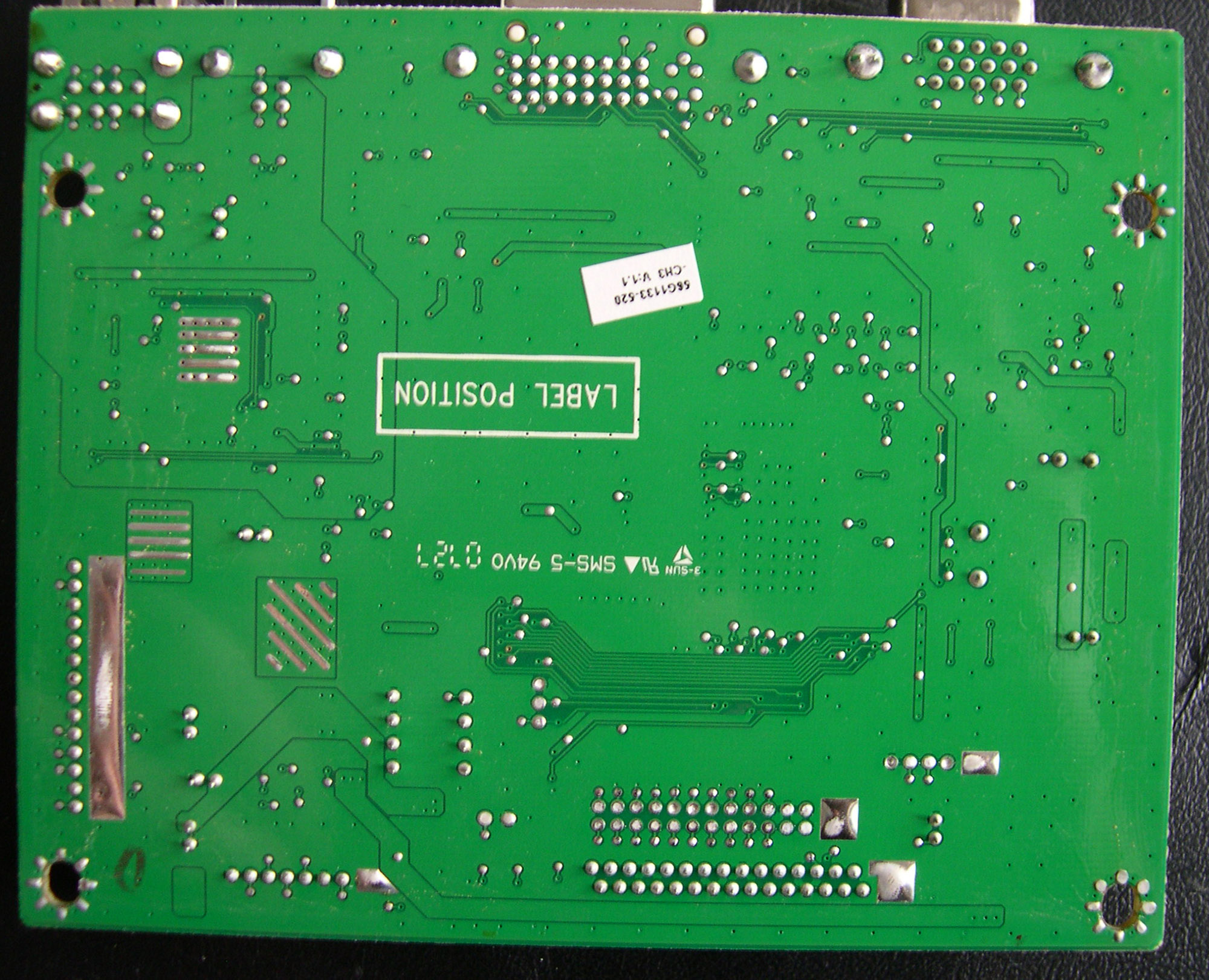

    OK, I need in focused pictures of the bottom side of the board and the Main board again.
    Chek the fuse (white cylinder), and then check the voltage on that large cap, be real careful since you will be working on the hot (line) side of the circuits.
    Post picture in the using advanced, attachment function.
      Here are more photos for you. Let me know if you need more. I will check the fuse.
        I tested the large ELCAP 100UF M 450V as you have suggested & the DC voltage was 171.7 Volts. The 3.15A 250 vac fuse when I set my multimeter to ohms read 000.0
                Try measuring the voltage across the small cap c927 located in the middle of the power board.
                    I went back and measured the small cap c927 located in the middle of the power board and I got a result of over voltage 0.L. Thanks to Budm providing the service manual I also measured the voltage for the pin8 of IC901 and got a result of 0.L over voltage. Does this mean my board is toast?
                              I went & remeasured C927 (results 0004 V) (which is a 68uF 25V capacitor) & IC901 pin8 (results 0162V). The capacitors on this board are from the manufacturer Elite. I removed the decimal in my auto range multimeter.
                              • jetadm123
                                • 2169
                                Retiredcaps is more an expert on meters than I am, but since you indicated no decimal points in your readings, it appears that the meter is set to too many signifcant digits. In other words, pin 8 should show 162.XX Vdc and C927 something like 4.XX Vdc.
                                4 volts across C927 is too low a start voltage for IC901. You need a minimum of 10V. I would try changing C927 to see what happens.
                                  I finally had a chance to get back to the power board & replace C927 with a new one & remeasured the voltage. It jumps back & forth from 9V to 10.40V. I have no clue where to go from here. I would appreciate any input that could be provided.
