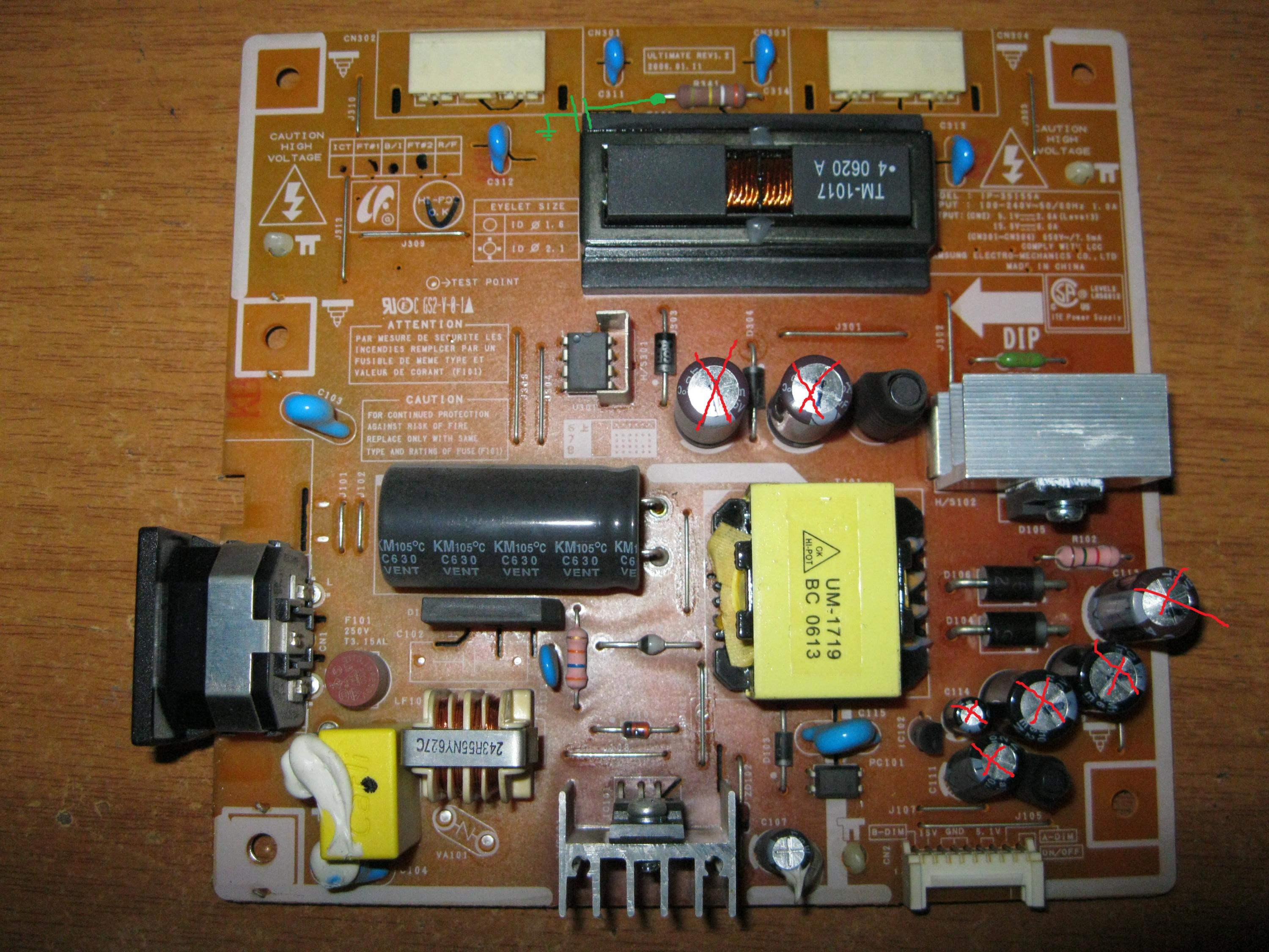

    hello
    i have an lcd monitor,samsung 731bf that goes off from illuminocity almost imediately.i changed the bulged caps from the power supply board,yet the problem insists.i found accidentally that if the voltmeter is in paralel on the high voltage output,it manages to stay on and show picture normally.
    i tried a 47nF/100V capacitor that laid around instead of the voltmeter and it worked also.
    but i want a more confident solution.why is that happening?will it be dangerous or so?its not mine you see,its for a friend,and i wont be able to monitor it after i give it back.
    here are some info

    the model of the power supply board is IP-35155A

    If I understand you correctly, it sounds like you are describing 2 seconds to black. If yes,
    2 seconds to black can be
    a) bad caps
    b) bad ccfls
    c) bad ccfl wiring (especially the return wiring)
    d) bad secondary windings on the inverter transformer
    More details starting with post #19 at

      thank you for your reply.
      yes it is the "2 second to black" problem yet now it became almost imediately.0,2 sec max. i suppose.so,i attached a picture that is taken right after i opened the screen.
      the caps marked with red x are all changed with equals and higher volts some of them.
      the childish draw with green on the top of the picture is where i connect the cap (and the voltmeter also) and it works.one end here other on the ground.
      i checked diodes,resistors,smd diodes on the other side and all seem ok.also checked the parallelogram black transformer on the top.3 windings one primary 0,6 ohms and two secondaries at 1K each.
      the lamps that the monitor has light equally,with good brightness.visualy also the cables seem ok with no burn markings,and the board is also clean from any mini explosion

        So you hook up the lamps of this monitor to another board and all four lamps light up and stay on?
        "i found accidentally that if the voltmeter is in paralel on the high voltage output,it manages to stay on and show picture normally." This make it sounds like it is not seeing one of the lamp and you meter becomes load and cause the inverter to stay on.
        There are 4 High voltage (3000V) at the output of the transformer, do they show any resistance reading at all?
          edit for budm.
          There are 4 high voltage (3000V) blue ceramic tuning (C311, C312, C313 and C314) caps at the output of the transformer, do they show any resistance reading at all?
          They should all read open circuit. If you get any resistance reading, it is likely bad.

            the blue 3kv caps on the end all seem ok.i've checked them with the ohm meter.also and some others that are smd have checked.
            the lamps arent tested to another board.but with the "cap trick" stay on for at least 20 minutes.no heat no something weird,even though the cap was 100V rated,at a place that has 650V theoretically.

              some info is that in the input of the inverter is 14,29V (the schematic says 15) measured now that works (with the cap hooked on) and in off state (with the lamps off) goes up to 16,82V.
              some guy also told me that with the cap trick i bypass some kind of built-in leakage detection of the inverter so it doesnt shuts down.
              anyway can be the problem before the inverter on the smps part of the power supply?
              i attach a much more cleaner schematic i found on pdf.
              PS:i just saw that the cap also does the same effect even in paralel on the resistor we said so (R341) and with another value i had,22pF at 6kV.

                        so..i bought a small ccfl lamp.F6T5/D says.
                        i tried all the four outputs of the board.in the first position (cn302) the monitor stayed lit.in the second one (cn301) shut down.so did to the other two (cn303 and cn304) but with a little "hesitation" after 2-3 secs did fade away.
                        now?i need a new lamp?or 3 of them? :P

                          The ccfl connected to CN302 is bad.
                          My guide explains why and budm as provided pictures of either a bad ccfl or bad wiring.
