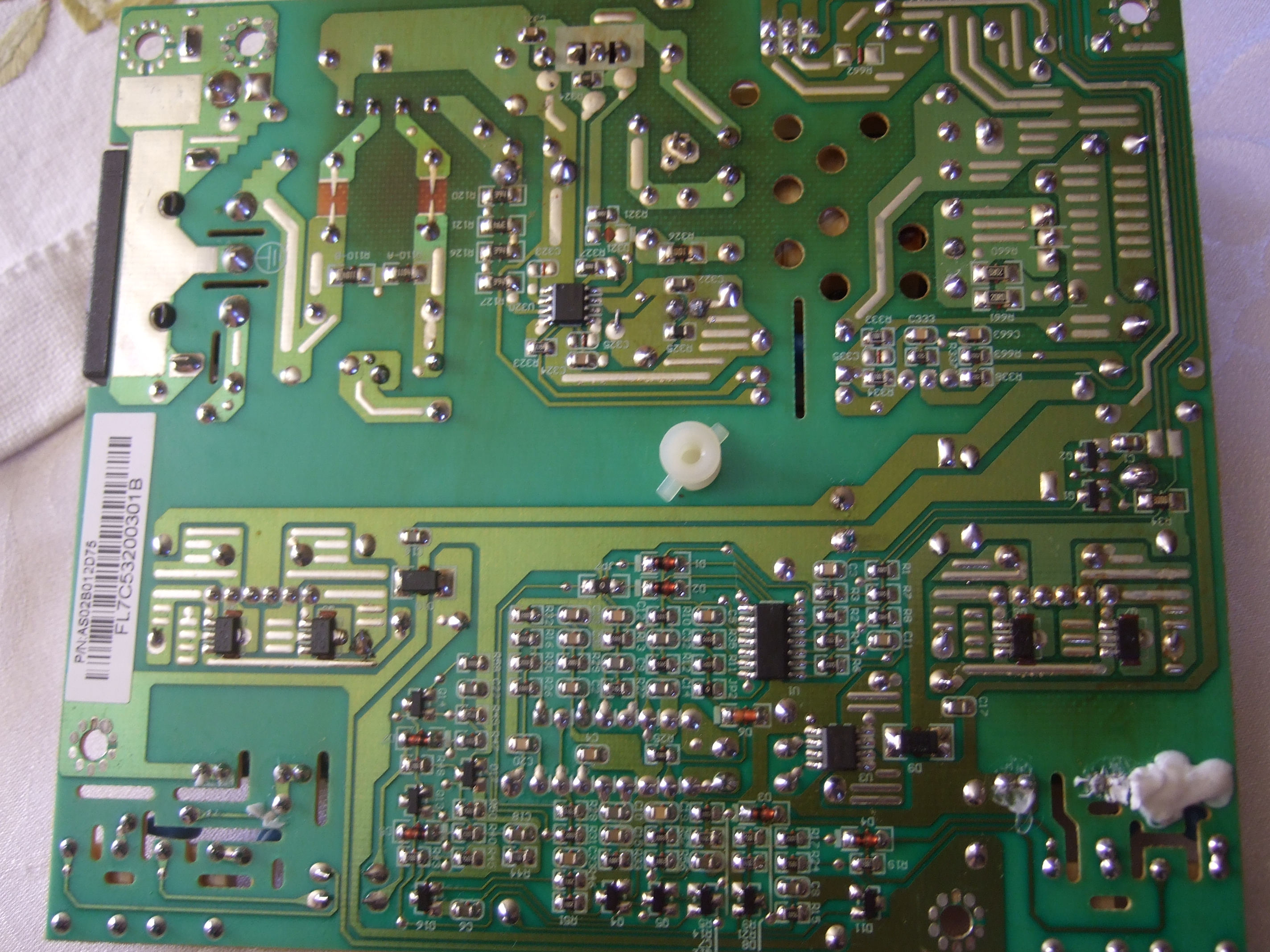

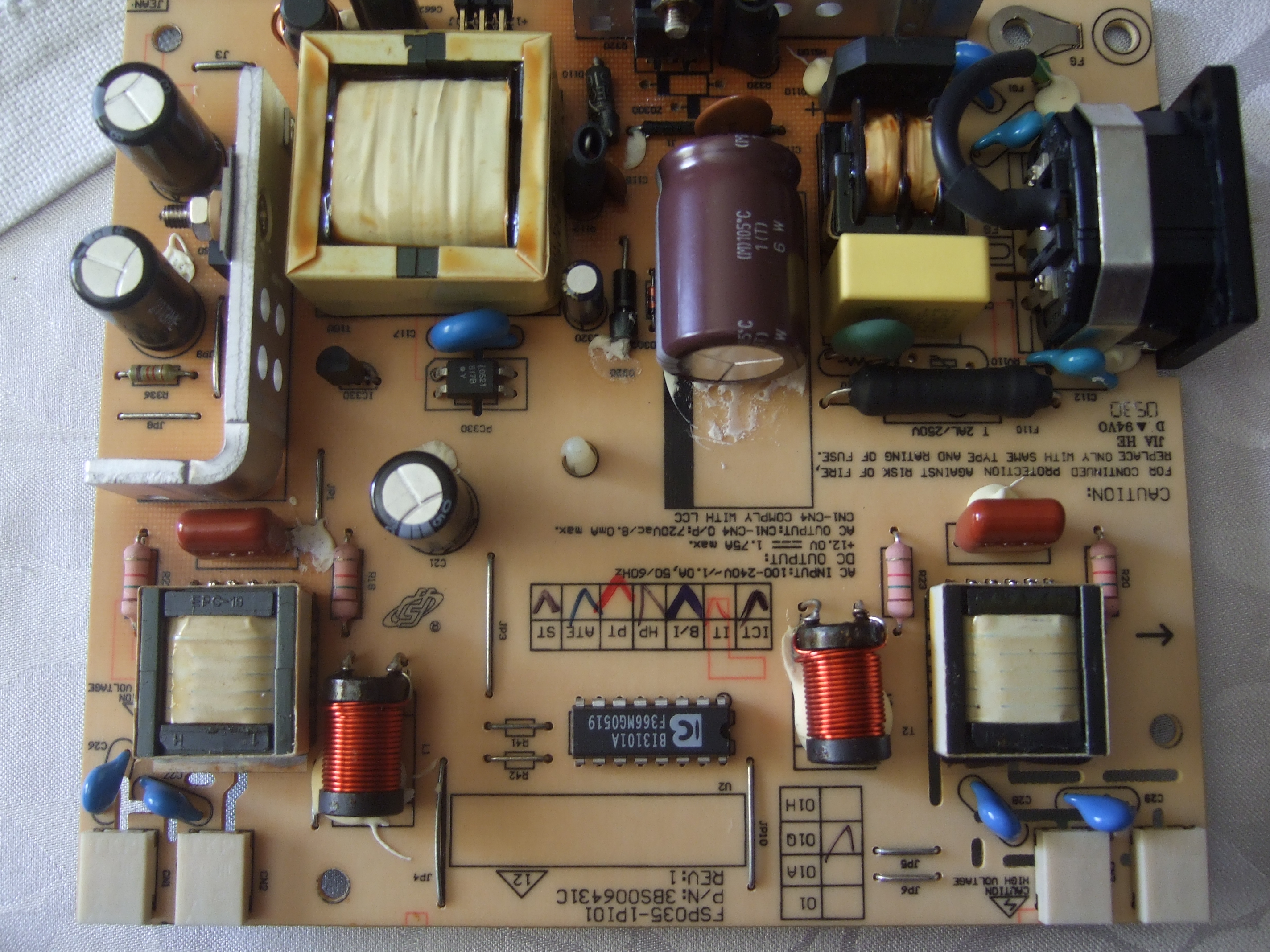

      Back with pictures of the overall areas.
      If you need pics of specific spots please tell.
      I am getting stable voltage at the mains cap (around 330V which sounds correct since we have 230VAC here in Finland)
      I was thinking - what would cause the Schottky to fail? Heat, high ripple current from the primary side since the mains cap was a goner?
      And (in circuit - havent desoldered it yet) the Schottky measures open in all directions (from both anodes to cathode and from cathode to anodes) - that means its a goner? Or should I test it out of circuit?

        Shottky doesnt sound good - yes take it out and re-test. When a Big Cap goes it can take out other components, my guess that is what has happened.
