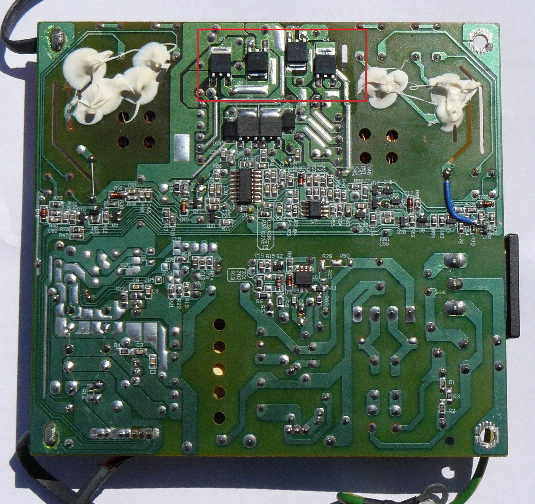

    On the back side of the power supply there are 4 C5706 transistors that i put a red box around. 2 of them read in circuit shorted. I replaced the 2 and i am still getting the same results. I rechecked the 2 i just replaced after trying the monitor out and in circuit the new ones are reading shorted. I have not pulled them off the board to verify they are shorted yet.

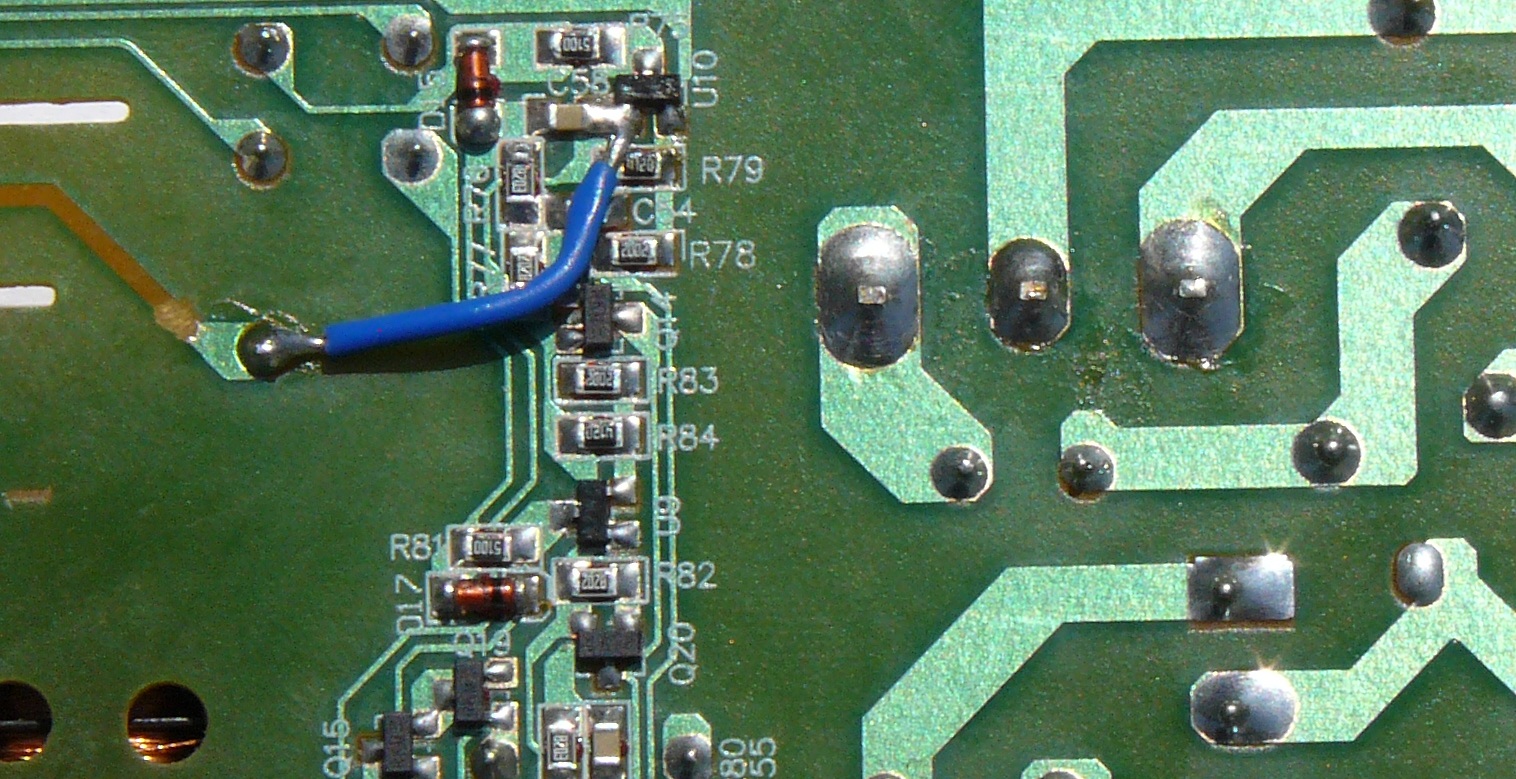

    The one thing i find very odd is on the back of the power supply there looks like a jumper wire was added from one a transistor to one pin of the inverter transformer. It almost appears that this was done from the factory, the soldering is very neat and clean.
    Unlikely but worth checking ,is the wire just soldered to the transistor or is it soldered to the resistor as well. If not has the insulation got hot and shrunk allowing it to touch?

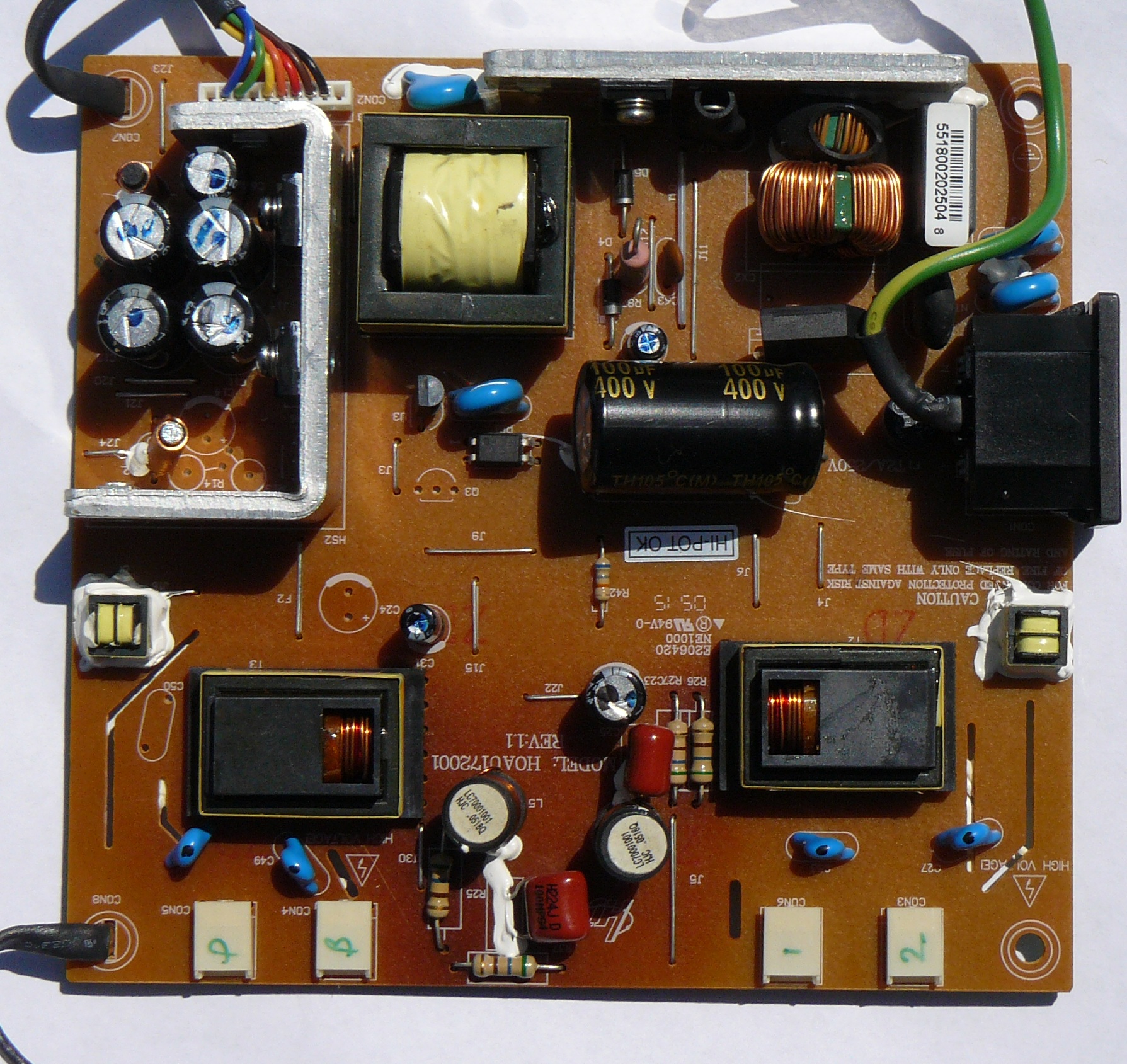

      I suggest you resolder all the pins on T2 and T3. Also, look for bad solder joints and check the values of the two small orange caps marked "H224J" at the bottom of your first photo.

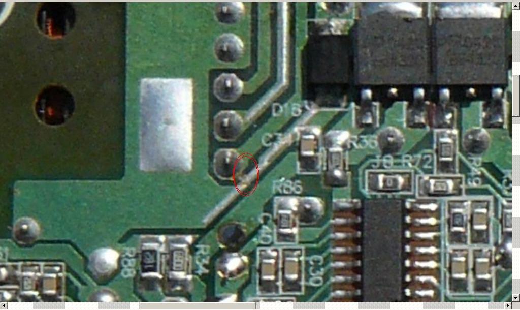

        Also can you check the area in the red elipse on the attached to see if it is solder/shorted?

          Its soldered to resistor too. I did find a service manual for this monitor but the power board schematic is not included
          I follwed the flow chart for no display and you get to a point where it says flashing led check I/F board (main). All the voltage regulators check out and the lelon caps are within spec. I did notice that my 12v is over 13 so that may be what is causing the protection.
          From the 30+ monitors i have repaired to date i have never seen a jump wire unless i put it there from boogering up one of the ringlets and didn't have any room to scrape the board to expose the copper. I think with this board i am experiencing sloppy seconds
            I lost count of the monitors, but I have never seen a jumper wire either. It doesn't mean it can't happen, but I have to wonder.

              Yes it is neat soldering but the U10 looks a bit scorched - is it still functioning?
              There is also a wire link on the other transformer but as its not isolated doesnt
              hit the eye.
              Did you check out the " short" in the red circle?
