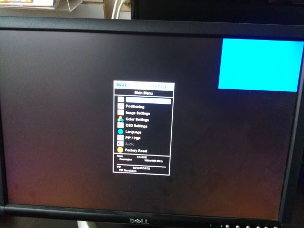

    Hi Badcaps folks,
    A local individual is selling a 22 inch Samsung with the following output as shown below. There is a blue box in the upper right hand corner.
    Bad cable perhaps? Bad connection?
    Available for the princely sum of $20.

    Be careful... The model shown in the picture is a Dell, not a Samsung... I smell the old bait and switch.

      Yep I agree with mocking bird that definitely looks more like a Dell than a Samsung
      Not sure if that can be a bad connection because it would be a full strip right down the screen. I might be wrong though.

            Bad panel or bad logic board. I'd suspect the logic board (or tcon if it has that separate), because when the defect is in the tab bonds of the panel the defect will span the entire screen, either horizontally or vertically - the display is driven as rows x columns. You could get several thin colored lines that stay on, half the screen white, or similar things, but i've never seen a panel making a blue box like the pic shows.
            I'd pass, unless you have a similar one with a broken screen. Would be an idea to check how much a logic board/tcon costs tho.

                osd setting on monitor maybe? seen a tv with that, an it was an id 10 t error! simple click changen osd settings got rid of it!

                    I've got the feeling that TJ gets a gold star for this one.
                    The monitor is across town, so I had a local buddy of mine swing by and buy it for me. The actual model number is a 2005FPW, and since it was advertised as a 22", I had him squeeze the owner for a few bucks. Total was $15.
                    Attached is a second photo from the Craigslist ad. If you look closely, the PIP source is 4Composite which I believe to be unplugged. It should say unassigned or something to that effect. I'm betting on an easy adjustment for a fix.

                        Yeah, it has PIP/POP - and it is trying to show the second source in the small window.

                          Update on the Dell 2005FPW...there were a couple of issues going on. First was the aforementioned blue box where the PIP should be, and this was rectified in the first few minutes.
                          The second issue was the often-reported issue in other threads where there is a rolling, not unlike a TV's vertical hold. It went away after a few minutes, which made me think it was a caps problem.
                          I went into my bag of tricks and found replacement caps for most everything on the power card, with the exception of the 1uf 50v. For that, I used an FC 2.2uf 50v. If anyone thinks that was a bad move, please advise.
                          Well, the problem was mitigated somewhat but didn't go away completely. So upon further research, the culprit was previously identified with some bad caps on the logic card. So I did some esr testing, and saw that the 470uf caps were all registering about .50, while new FC caps were more like .03. So I changed the three of them, and I am pleased to report that the issue has not gone away completely.
                          I will test the usb functions most likely tomorrow but I have high hopes for that.
