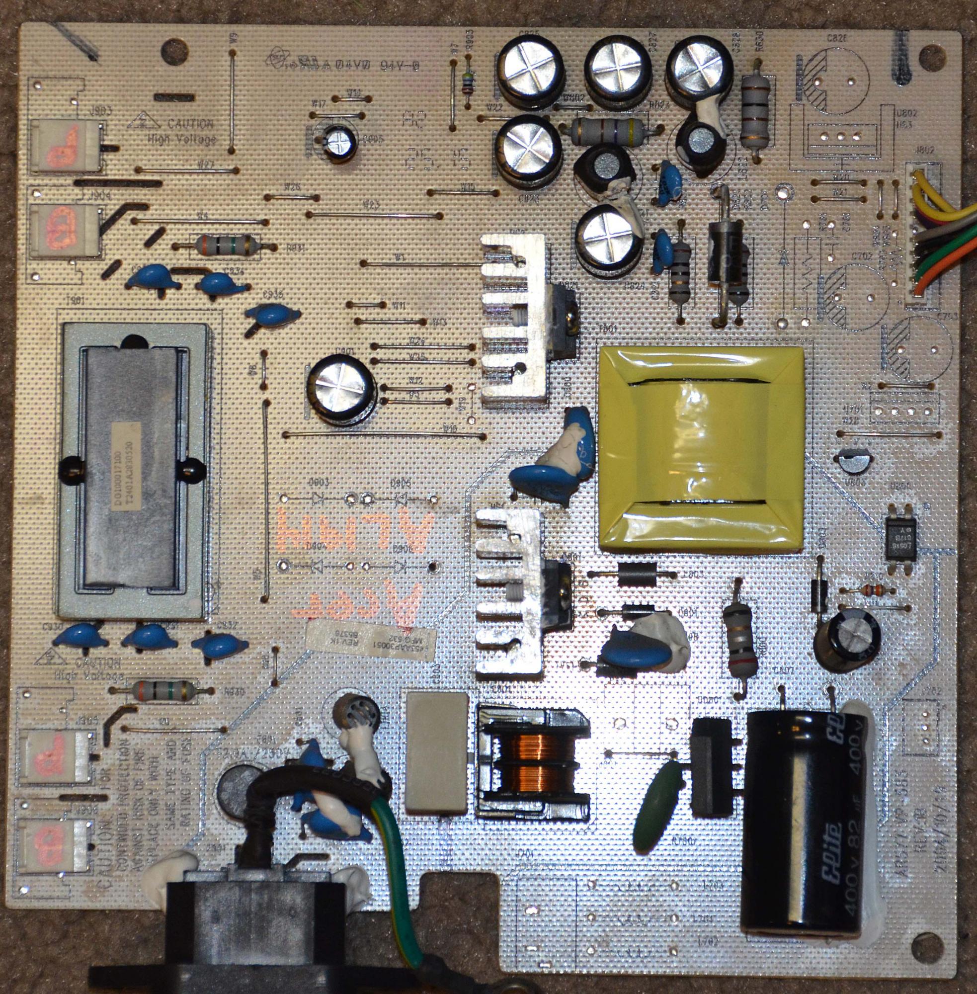

    Let me start by saying thanks for this wonderful resource. I have managed to repair half a dozen monitors with help from the site.
    I think I have a bad transformer on the inverter board but I want to try and confirm this and maybe find a source for a replacement.
    The monitor power light will turn on and off with the switch but I see nothing on the display. There is no image even with a flashlight.
    I have proper 120v in and can measure 165v across the largest cap on the board.
    I am measuring 79v on one side of the transformer and nothing on the secondary side. I am also showing no output voltage going to the other board in the monitor.
    the numbers on the transformer are DG100017200 YUVA 0520
    Is my assumption correct that the transformer is bad or can something else cause these measurements?

    If your power led comes on and off by hitting the power switch, that implies that your power supply and main board are likely good.
    If you are not getting a display (not even a brief flash of backlight), that implies the mosfets (Q904, Q905, Q906, and Q907) on the backside are possibly shorted.
    To test them, see the section on mosfets at

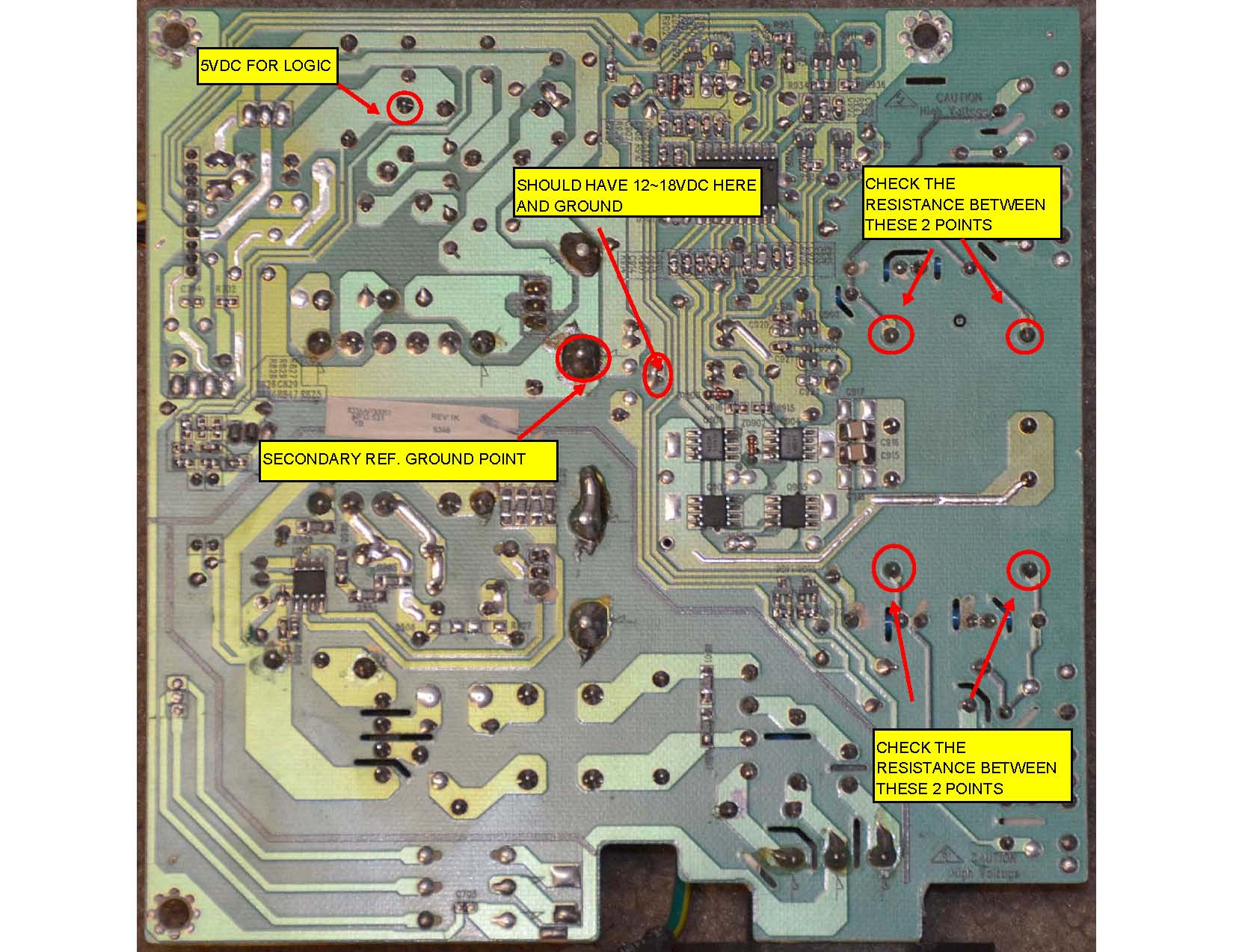

        If you can see that the power LED is on then the power supply is working because the 5V and the 12v are generated from the same transformer.

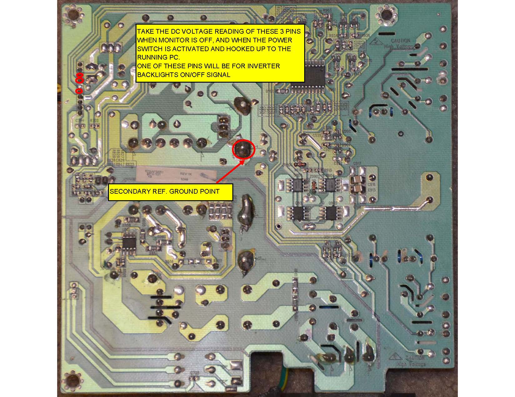

        Please take some readings per attached pictures.
        Also, do you have test lamp for inverter testing?
        Otherwise look here:
        https://www.badcaps.net/forum/showthread.php?t=19987
        We need to know if the lamp even flash for a second or not.
        Last edited by budm; 05-10-2012, 10:57 PM. Reason: Found PIN 7 is for backlights ON control pin

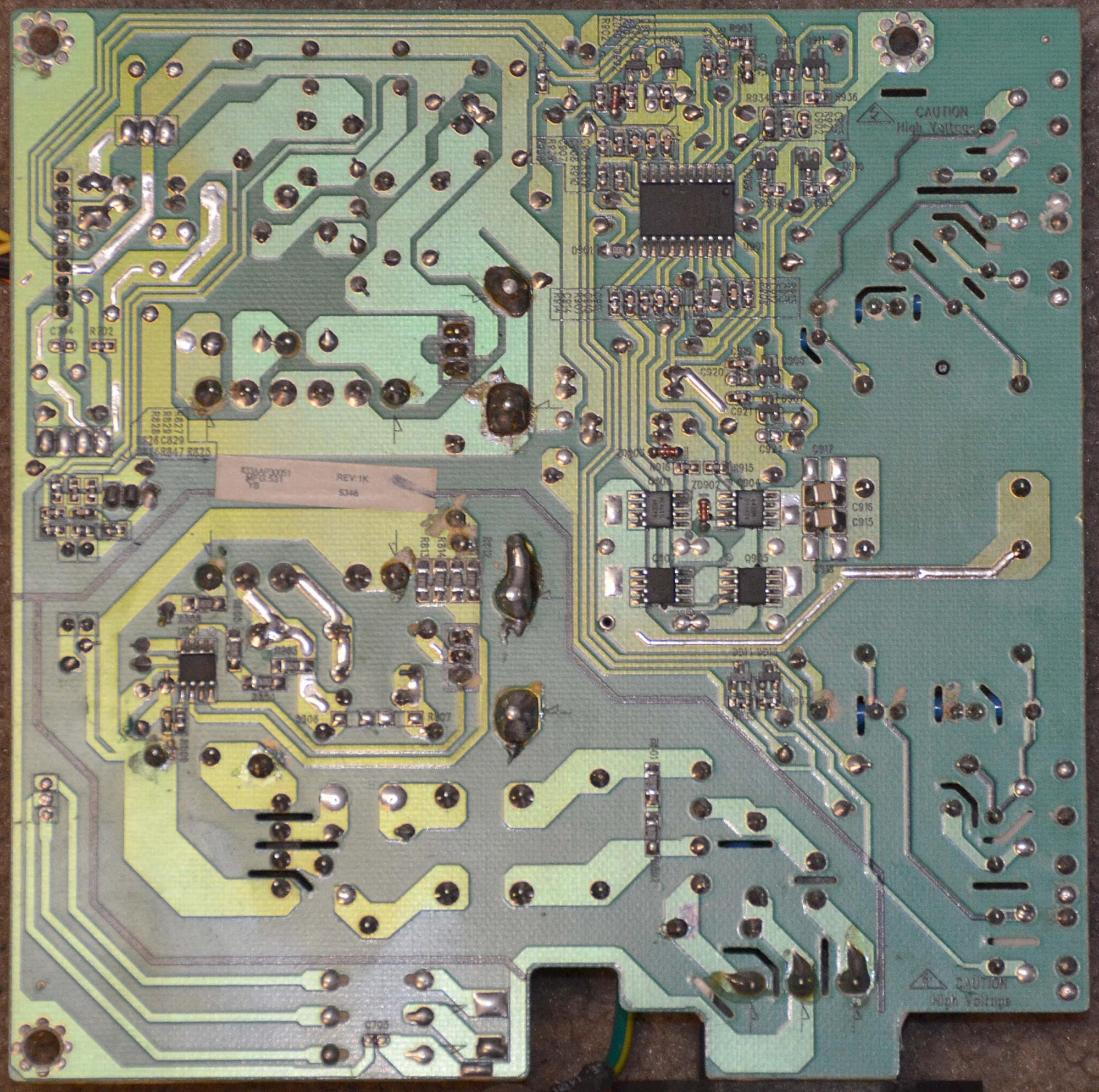

          Ok the results of My Testing.
          1. The monitor will display the acer logo for a fraction of a second when first plugged in and turned on. Will not if you turn the monitor off and on with the switch. Power light does go on and off with each press of the switch.
          2. 5VDC for Logic is Present 5.17VDC
          3. 12 to 18vdc in Picture 1 shows 19.1VDC
          4. Resistance between top two points is infinite. (Meter is on correct Scale)
          5. Resistance between bottom two points is infinite.
          6. Voltage measurements for the three points in Picture2
          -----ON -----------OFF
          Top--5V -----------5V
          Mid-- 3V-----------0V
          Bot-- 5V-----------5V
            Re: Acer AL1914 Power Light on No Display
            OK, your power supply is fine, and the control signals are fine. The strange things are that both high voltage winds are showing open! It does look like you have open windings, may be look real close at those solder joints just to be sure they are not bad.

                                More Accurate Transformer Readings. Meter Scale set to 2k
                                Top transformer Pair .566 k
                                Bottom Transformer Pair .569 k
                                Tested all of the mosfets on the Back for shorts.
                                All the three Pin mosfets show no shorts
                                U801 however shows a short between pin 1-4 and pin 6
                                Part Number of this chip is SG6841SZ
