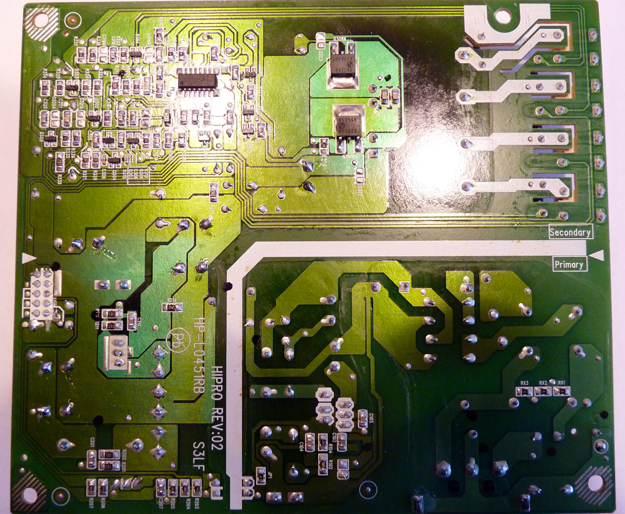

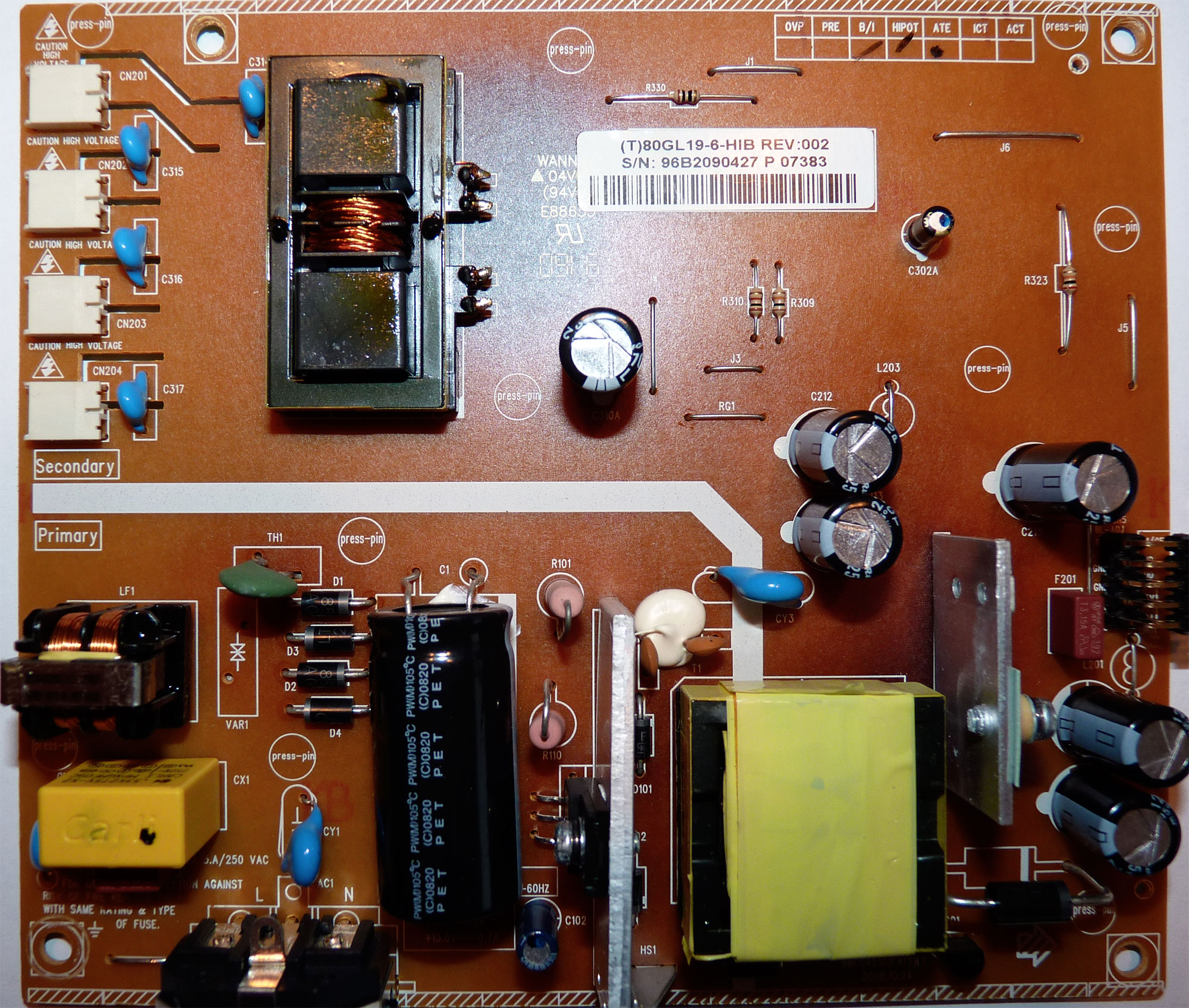

    Hi everyone,
    I'm trying to fix a Viewsonic VG2230WM-3 with no power. I replaced 6 bulged teapo 470uf 25v with brand new Rubycon capacitors and nothing change. The only new thing that has emerged is a ticking, like a clock, clear and regular.
    I checked few things with my multimeter.
    I have 165V at the big cap
    To the right on the power board, to the logic board i made 5 measurements and here are the results:
    BL-ADJ : 0.5 V not stable
    GND : 0
    GND : 0
    + 5 : 1.2 v to 1.5 v not stable
    + 13.(something unreadable) : 0.1 v to 0.3 v not stable
    Below is the picture of both side of the power board.
    Thanks for your help.

    Ticking suggests the SMPS is trying to start, but can't maybe due to
    1) bad startup cap (probably 47uF 50V C102). Measure the DC voltage across this capacitor. It should be stable and enough to power the SMPS IC VCC pin. Measure ESR. If no ESR meter, replace with something like Panasonic FC series.
    2) bad SMPS IC (maybe the IC above C102 mounted on the heatsink?). Find the datasheet and see what the startup voltage should be for VCC. See if VCC is shorted to GND.
    3) shorted diode (D101, D102). Test diodes to see if they are shorted.

      Re: Viewsonic VG2230WM-3 - No Power
      There is another diode in the bottom right hand corner by the word "press".
        1) in fact it's a 22uf 50v and i've got 9v to 14v not stable at all across this one (ltec brand) !
        2) The chip is a STR W6252. It is not shorted to GND
        3) D101 seems to be shorted. D102 is ok
        I'will replace the cap and the diode and see what's next.. Thanks retiredcaps.

              Datasheet is at
              https://cdn.badcaps-static.com/pdfs/...242a347ec7.pdf
              See page 5. VCC(ON) is typically 15.5V. Minimum is 13.9 and maximum is 17.1V DC.
              So it looks like the SMPS IC is starting, but the shorted diode is causing the fluctuation.
