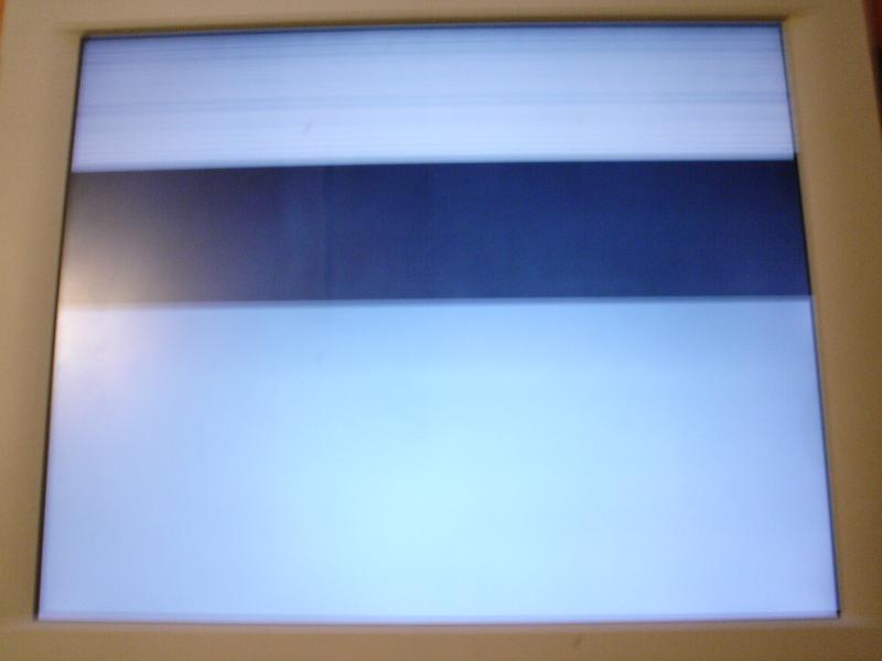

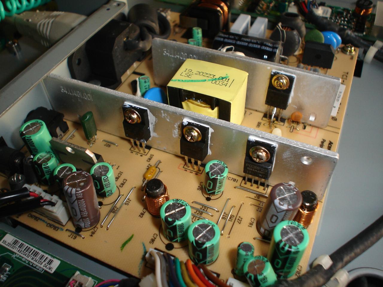

Got this LCD for almost nothing, knowing it was not working
When it is turned on, monitor cable not connected to PC it comes up with 3 horizontal split sections in white grey/black-ish and white, the grey/black-ish fades to white(er) before the monitor cuts power.
The upper secion has some "noise" or black/blue small lines that also fades (to white)
When the monitor cuts power the LED switches from green to yellow (standby)

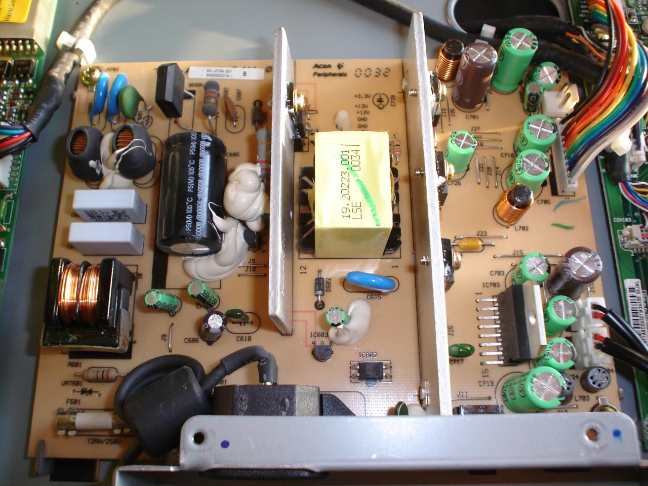

The +3.3v & 5v are stable (untill the monitor cuts power) 3.297v & 5.000v respectivley.
+12v is first at 14.1 for a brief period, then 12.26v next it spikes up but goes back to 12.26v and after a few more seconds power is cut...

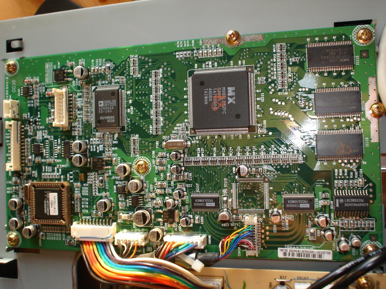

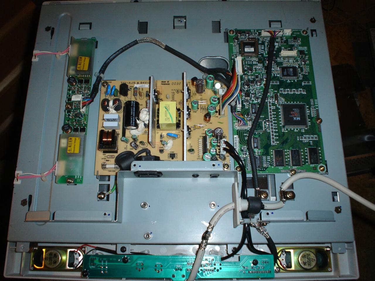

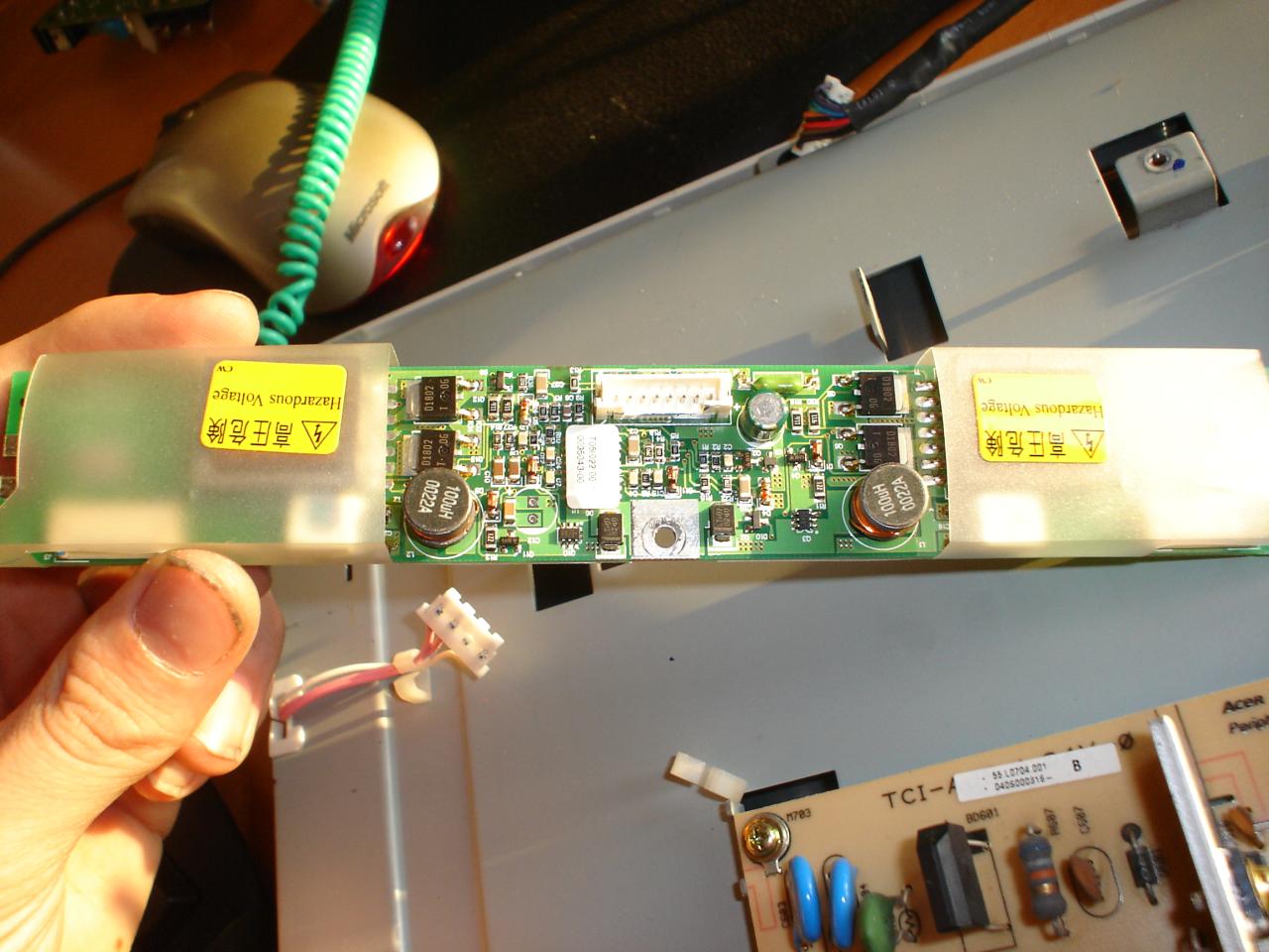

If I remove all cables from the main PCB except the powersupply cable, and cable going to the front PCB with powerbutton the issue is still the same, i.e. without lamps and stuff even being on it cuts power and spikes the +12v in the same manner
So therefore I am assuming the powersupply is faulty and need some help in diagnosing it, it has a 10 pin connector with power outputs, in this order:
5v-fix as the name implies always has 5v standby power, for soft power-on...
P-Saving reads 2.880v and Volume-C: 0.770v
During all this testing (I had to turn on and off the monitor for every reading) it twice stayed on, then the picture was 100% white with what looked like a trinitron line straight across the screen at 1/3 from the top, and that part was also visibly "different" from the white below, can't describe it better than that... Also the +12v reading was stable at 12.26v then...

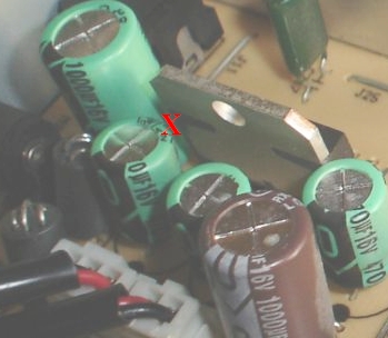

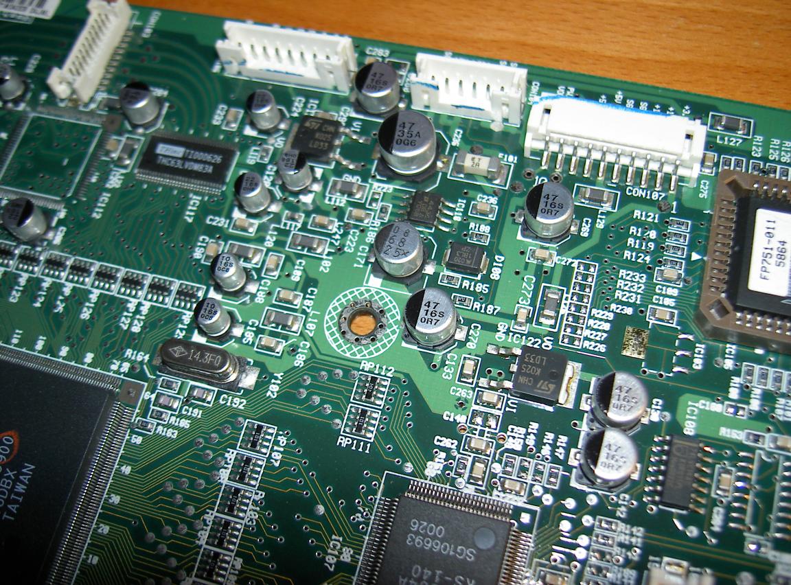

Everything on the PCB looks fine, the caps are all Lelon RGA except for 2x RXJ and one small TEAPO, the bulkcap is of unknown make
All PCBs has the text "Acer Peripherals" written on them...
Can I test the PSU by shorting +5v-fix to Ground and connecting a PC harddrive as ballast to +12v and +5v? Or how do I turn on the PSU on it's own?
EDIT; and learned the hard way that the heatsink with the single mosfet holds 120VAC; touched it with my underarm when probing with the DMM
Fortunantley the power stayed in my arm and did not travel to the other arm where I had my antistatic wrist strap connected
(that is like last time I got shocked by a PSU...)
