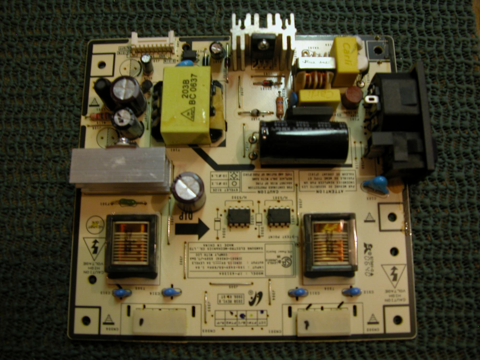

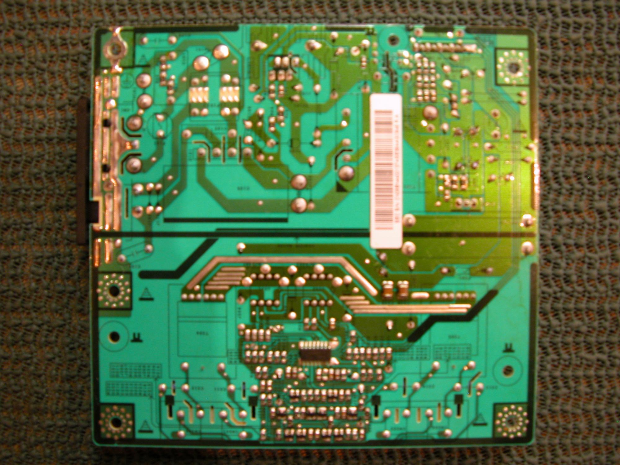

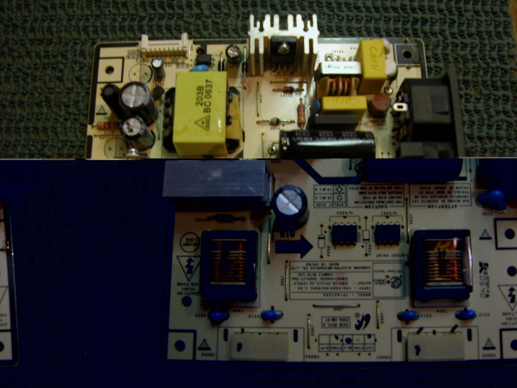

i picked this item up locally for free. when i first plugged in to see whats happening, the blue power light blinked on and off continuously and no display no image dead! took item apart and found 3 bulged caps. 3 x 820uf/25 volt replaced with spares i had 3 x 1000uf / 25 volt. item back together now blue power light powers on stays on NO back light. i can see image with flash light. there is no 2 seconds to dark when powered on no back light activity. directions??
Samsung Syncmaster 203b no back light after cap replacement

Your photo's a little blurry, but try checking the fuse, PF301? It's the green fuse between the heatsink and the inverter transformer on the left side of your photo.
retiredcaps already beat me to it!Comment
