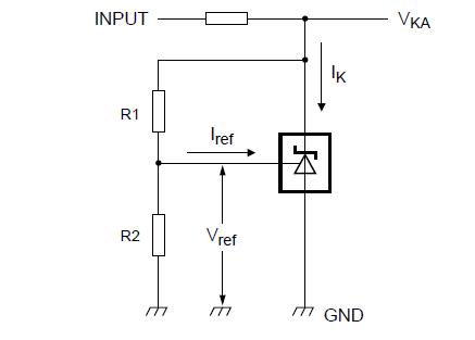

            The TL431 is an "Adjustable Programmable Shunt Regulator". It is commonly used as part of the voltage regulator circuitry. If you look at the board, it is a three lead device close to the optocoupler.
            While it's got a long name, and is fairly complex, it's operation is quite simple. It does not conduct current until the voltage at the reference input exceeds 1.25 volts. At that point it conducts much like a zener diode.
            Referencing the attached drawing, the unlabeled resistor at the top is an optocoupler led and resistor. When current flows through the LED, the output of the optocoupler conducts, reducing the output of the SMPS controller.

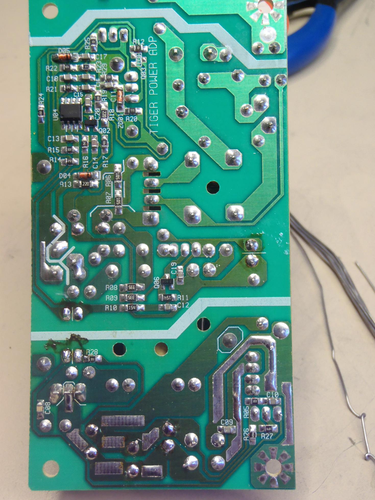

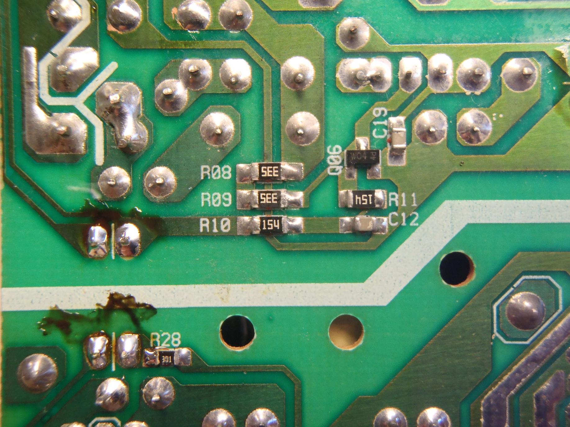

              I think I know which one you mean. I haven´t measured anything yet though, but this time I can supply some photos.
              Is the TL431 situated on any of the attached pictures? There´s a 3 pin chip on both sides near the optocoupler, the hole mounted one is difficult to spot/identify. There´s also a TL431 near the output.

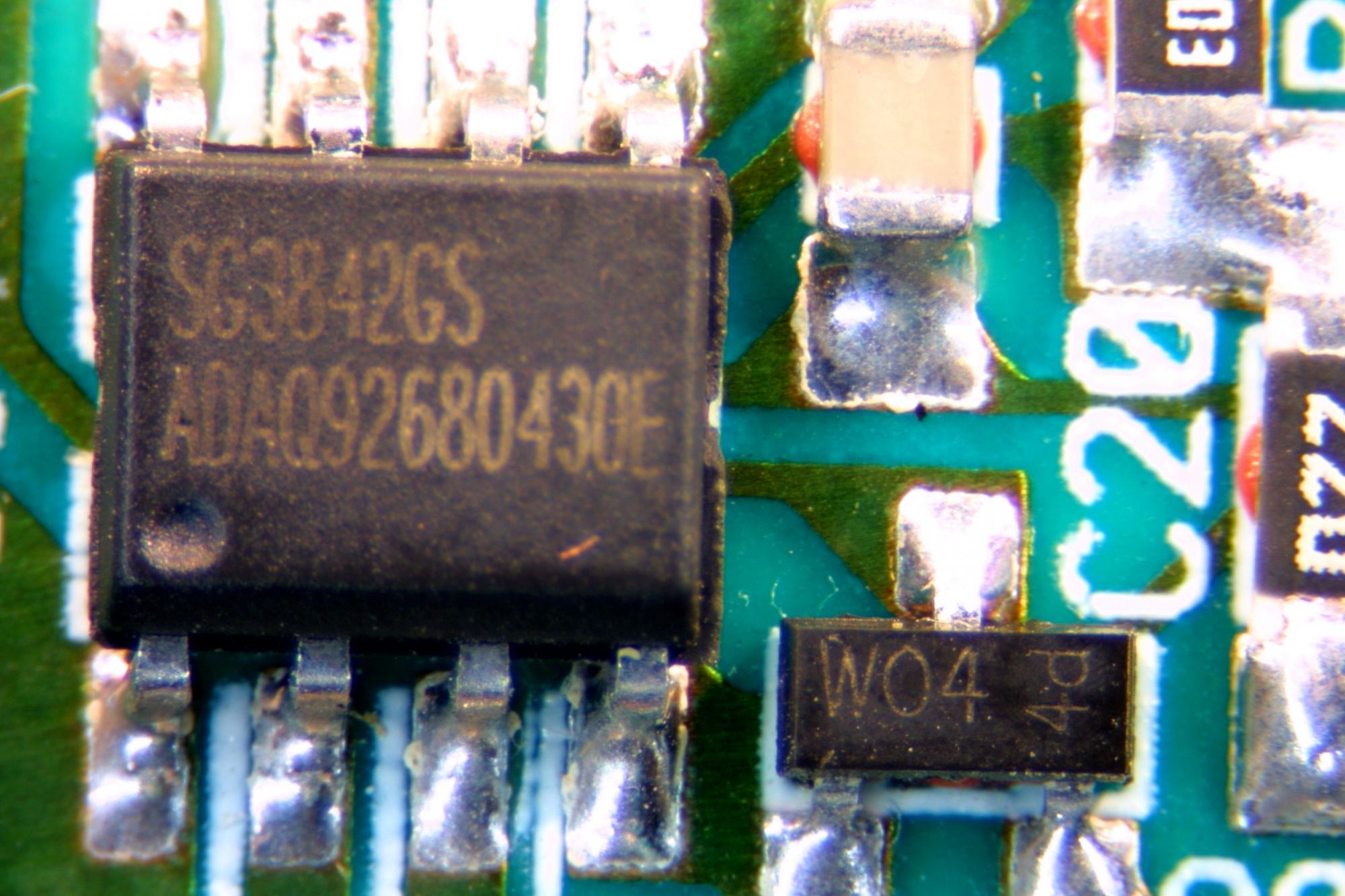

              Perhaps you can do some marking in any of the photos? I´ve also attached a photo of the PWM-chip.
              //Mikael

                It's located on the top side of the board shown in the lower right corner of the third picture. Note that there is a circuit running from one side of the opto-isolator, through R28, and to one pin of the TL431 and C10. R05, R26, and R27 form the voltage divider for the reference input.

                  sorry for being so slow in replying ... I actually replaced the TL431 near the output (since I was ordering other stuff from my distributor), but no difference in operation, the PSU is still slow-started. Now I´m more into that a tiny capacitor (0,5 nF) which I believe is the startup-cap for the PWM-circuit, may be the problem. However, all the datasheet for the PWM-circuit that I´ve found has a different pin configuration than the circuit on my PCB, so I decided not to care about this anymore .... I simply replaced the internal PSU with a external 12VDC 5A one, works perfectly! I was lucky that the monitor only needs 12V from the PSU, otherwise it would have been more difficult.
